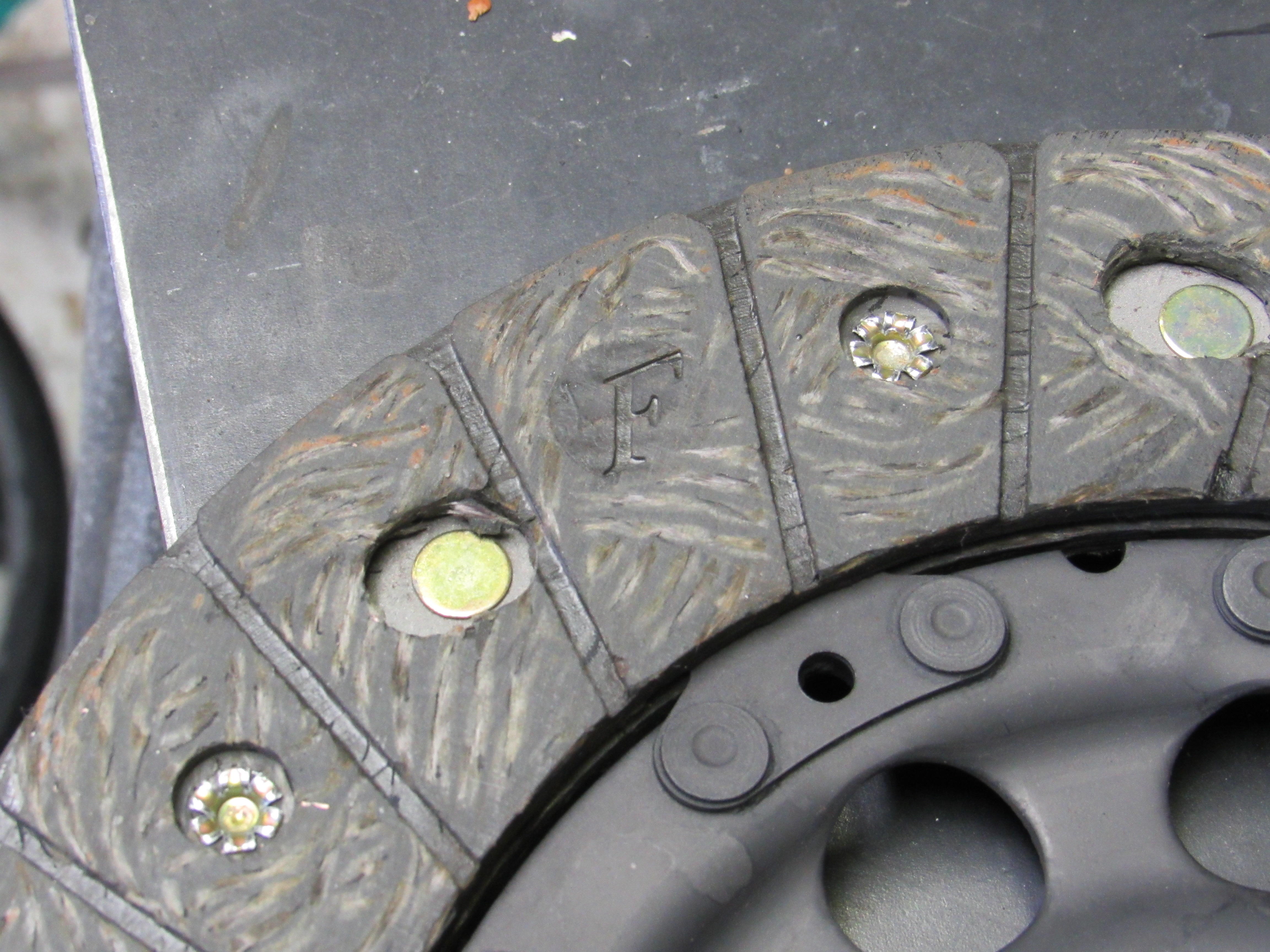

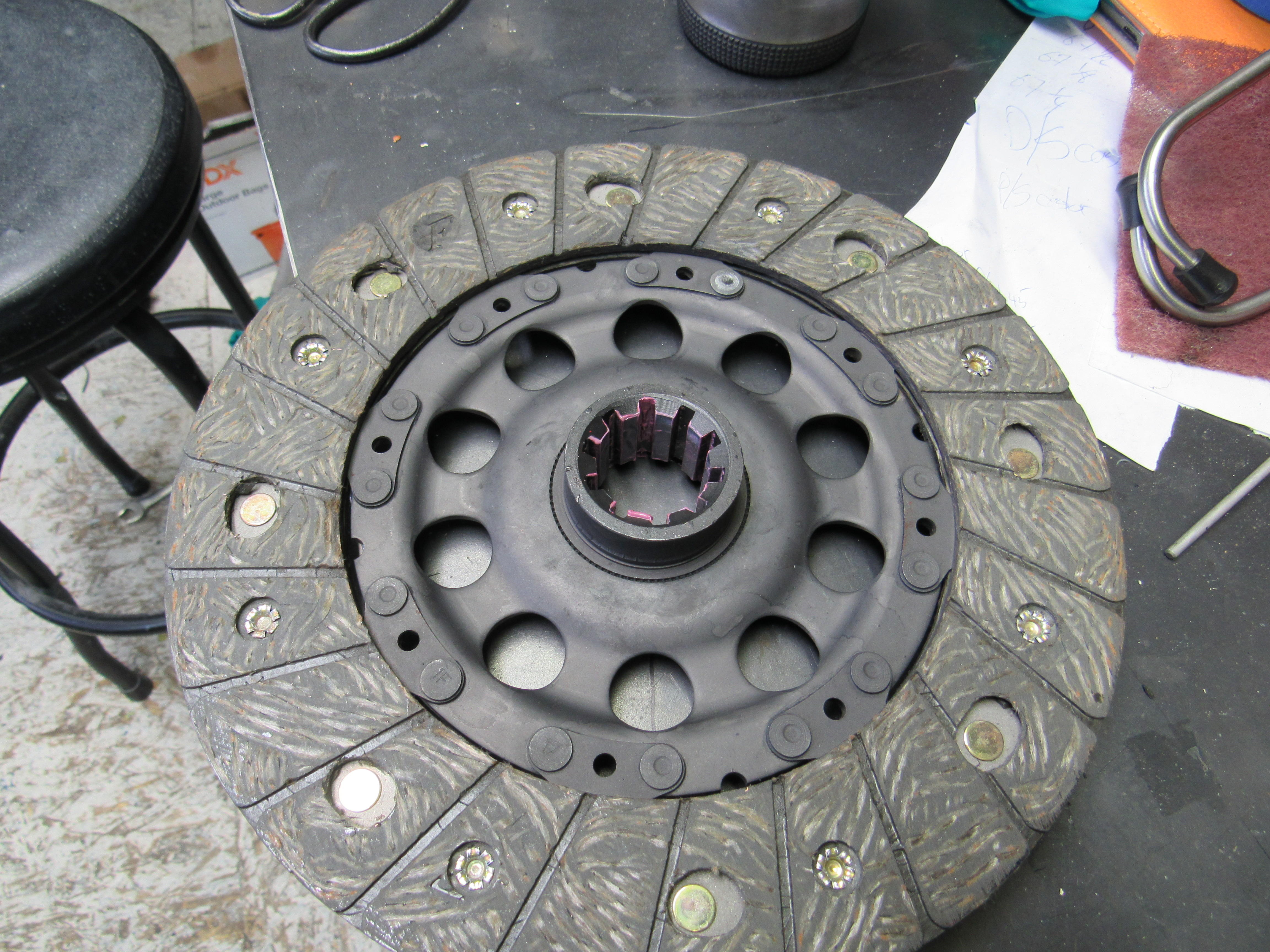

Yup, I certainly did goof up but I have a sort of plausible excuse!  I installed the clutch disc backward but on one side of the disc only there is a large embossed F so I assumed that's the front,  nope, that is the company logo of the manufacturer.  I should have checked my pictures.:facepalm:

1 hour ago, Zed Head said:
You'd think a clutch disc manufacturer would know better.  A big old "F" on the backside of the disc?
So that nose/projection was jammed up against the crank shaft flange?
Yup, I'm surprised it even fit.
Wow, that's pretty bad. There's no way they should be putting a mark on like that. It's just bad practice.
So on the upside... Glad to hear you found the smoking gun, and glad it wasn't inside the case!
But now that's it is all torn apart again I think I am going to replace the dual mass flywheel with a single mass unit, and eliminate another 15lbs.
Thanks for all the help guys.
For a fleeting moment I thought, "could the disc be backwards", but then I thought, No Chris wouldn't do that. Looking at the photos I can understand why it happened.
That is not playing by the rules of common sense. Bad move on the manufactures part. It's not even a special letter type, just a standard F.

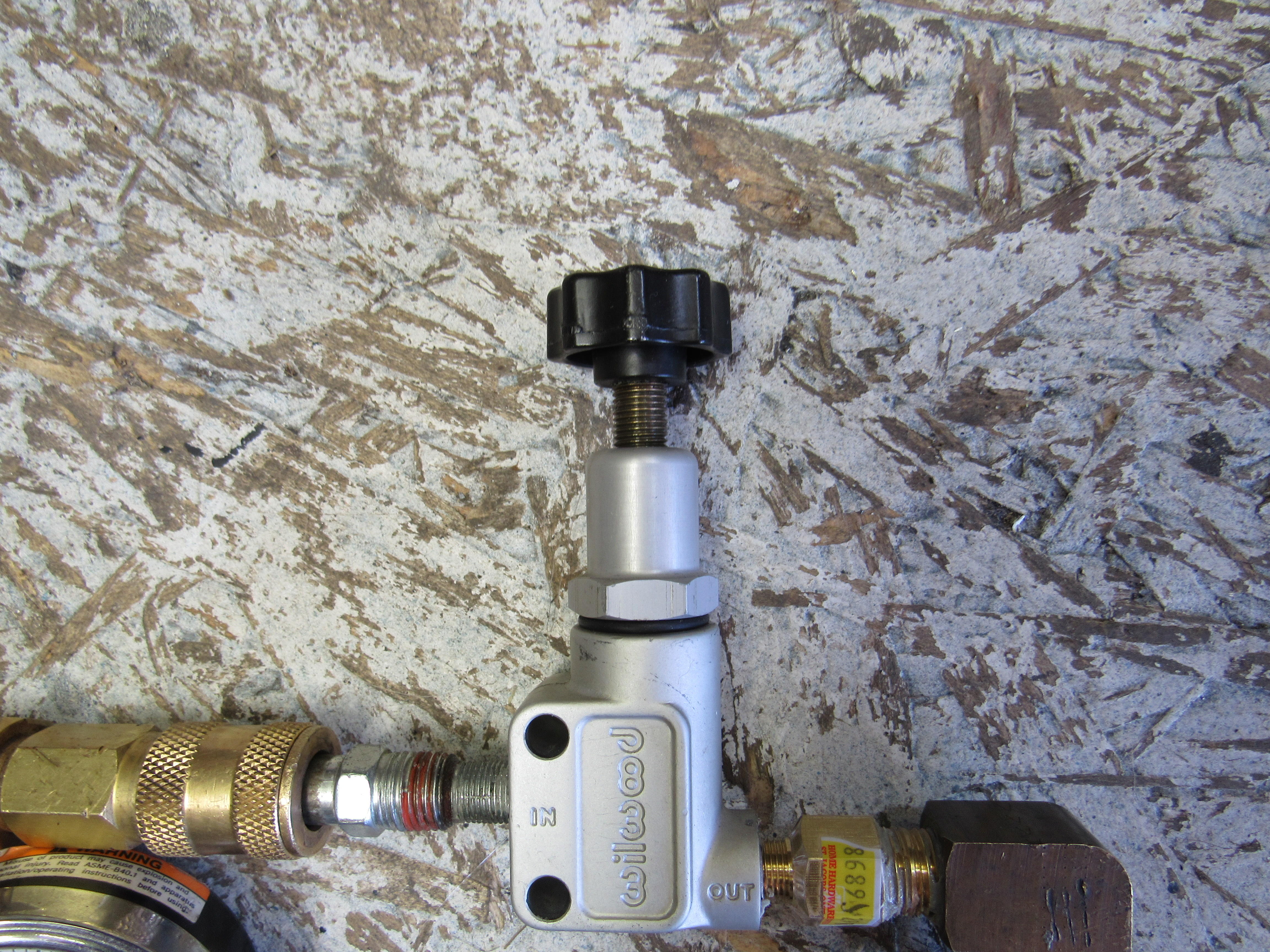

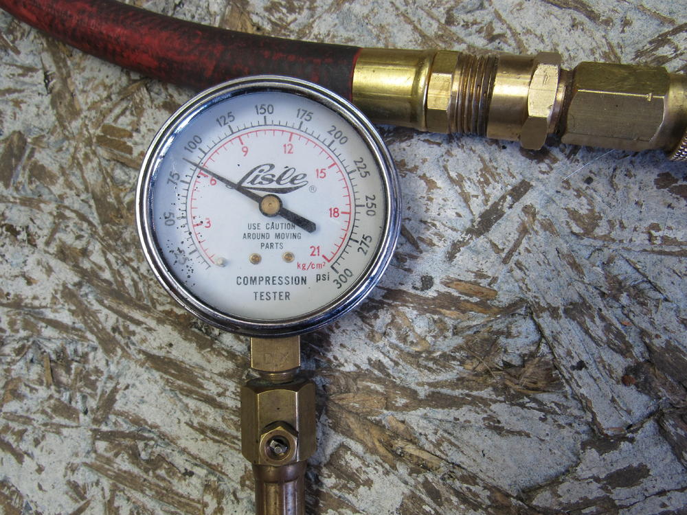

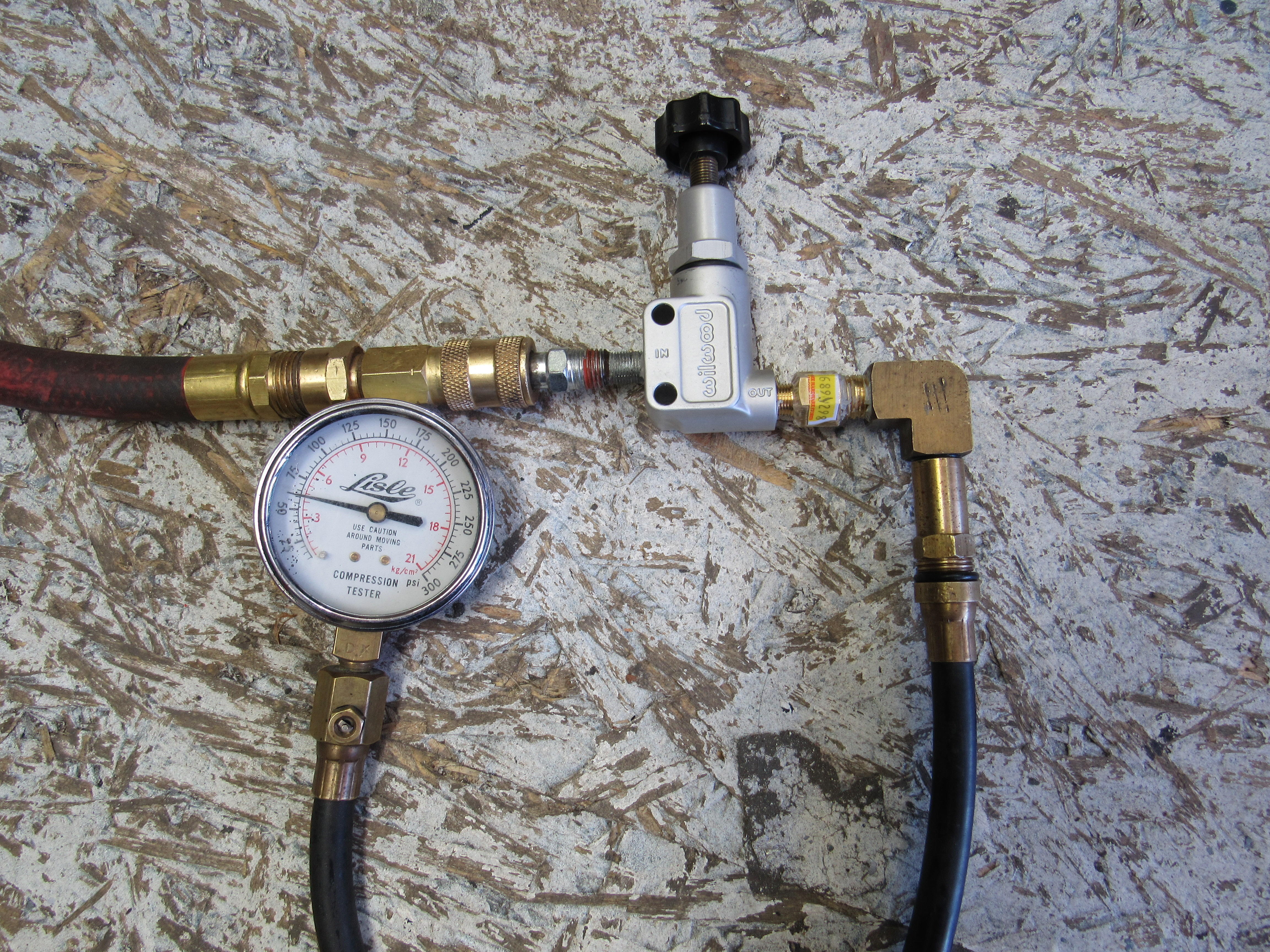

Already though I can tell the there is too much bias to the rear brakes, very easy to lock the rears up. I had a Wilwood proportioning valve on the last setup and couldn't tell if it was doing anything so before installing it on this brake system I thought I would try some testing.

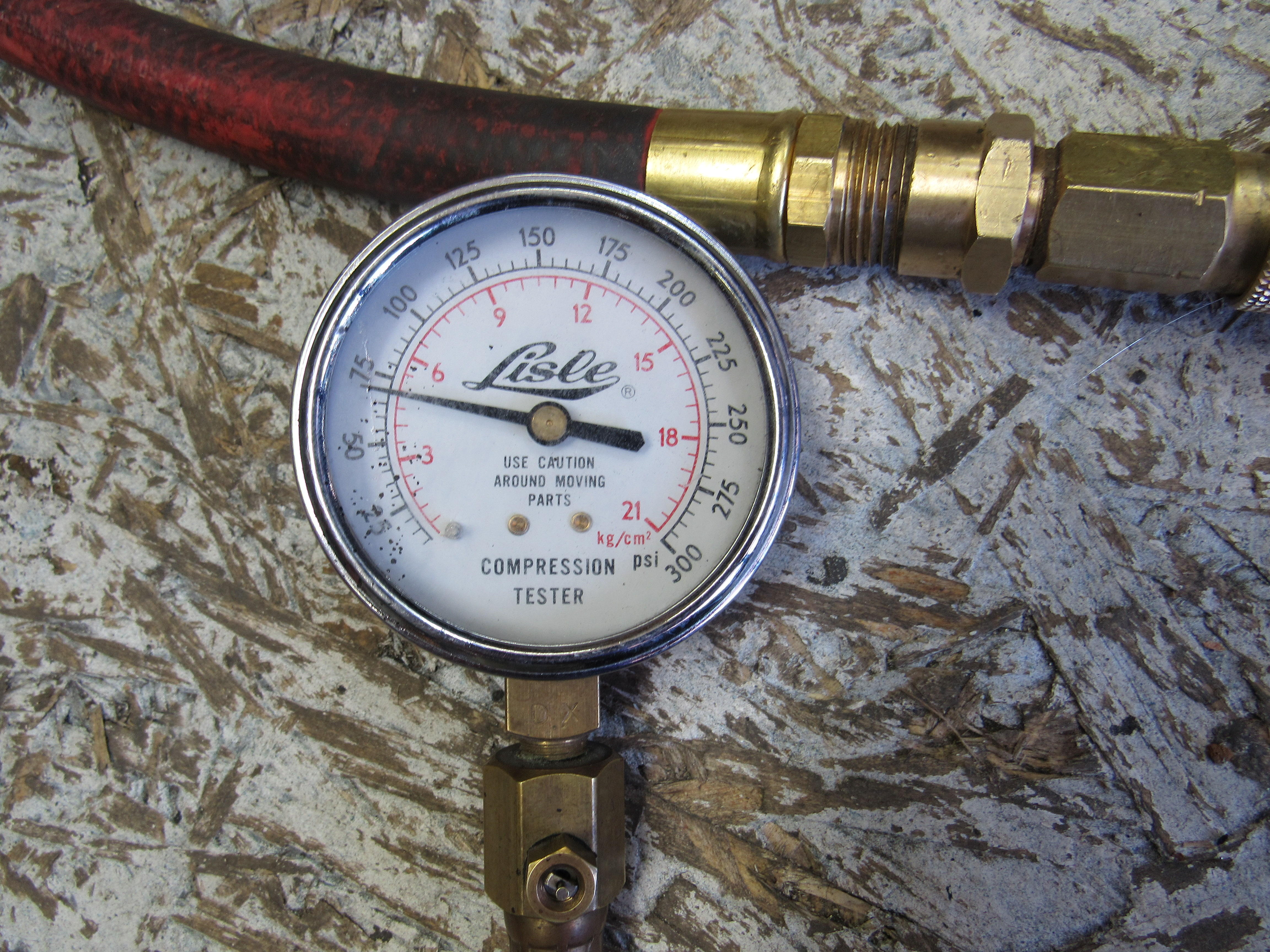

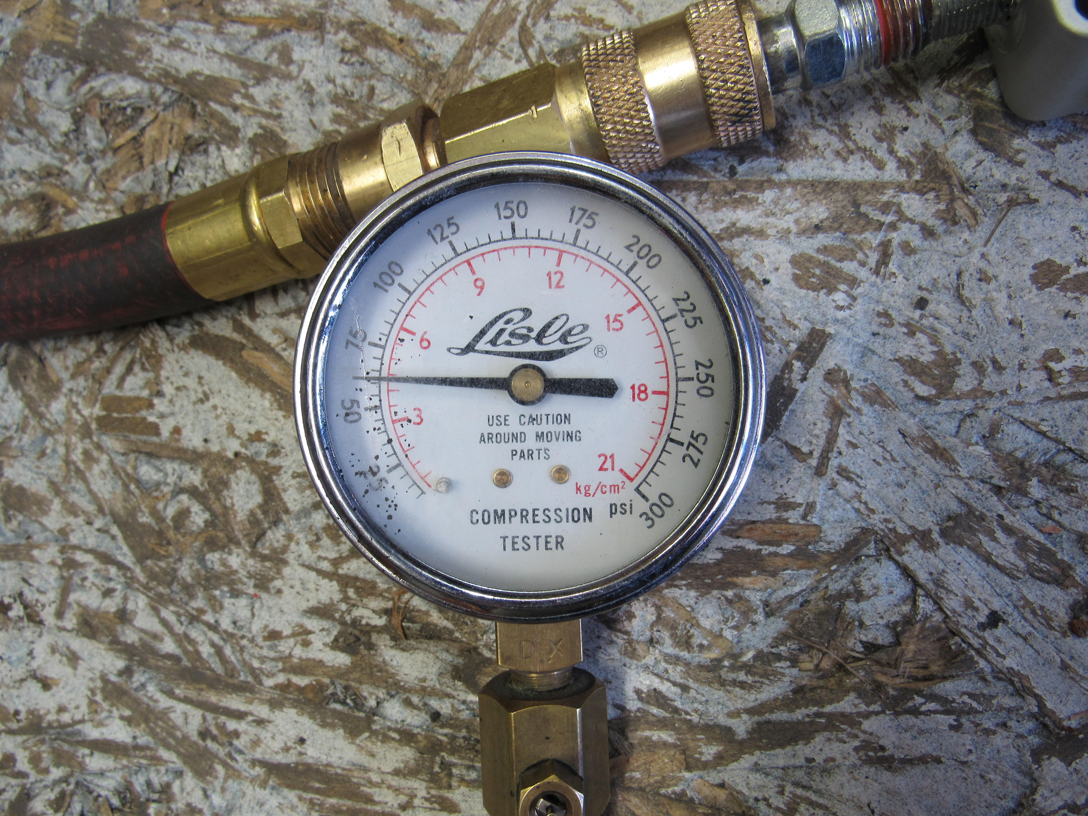

Now fluid dynamics is a big subject and I only understand a bit of it but since compressed air was available to me I used it instead of brake fluid for my test.  I hobbled together some fittings that were air tight,  Wilwood says this unit will decrease the amount of braking pressure by 50% with the knob turned all the way up to the top of the threads, well I found that 33% was the best I could get from it.  The proportioning valve only has a 1000 miles use on it and is very clean inside.  I started with 90psi which resulted in 60psi for the rear wheels, with one full turn of the knob CW the pressure came up to 75psi, with one more full turn brought the pressure up to the full 90psi,  so all of it's proportioning takes place in the top two turn and there is still 9 more full turns left until the knob bottoms out.
So why are those 9 other turns on there? Just to confuse me I guess.  33% is more than enough to work with I think but I'm glad to know where range of adjustment is now, should make the dialing in easier.
3rd pic at 60psi, 4th pic one turn down, 5th pic 2 turns down.
