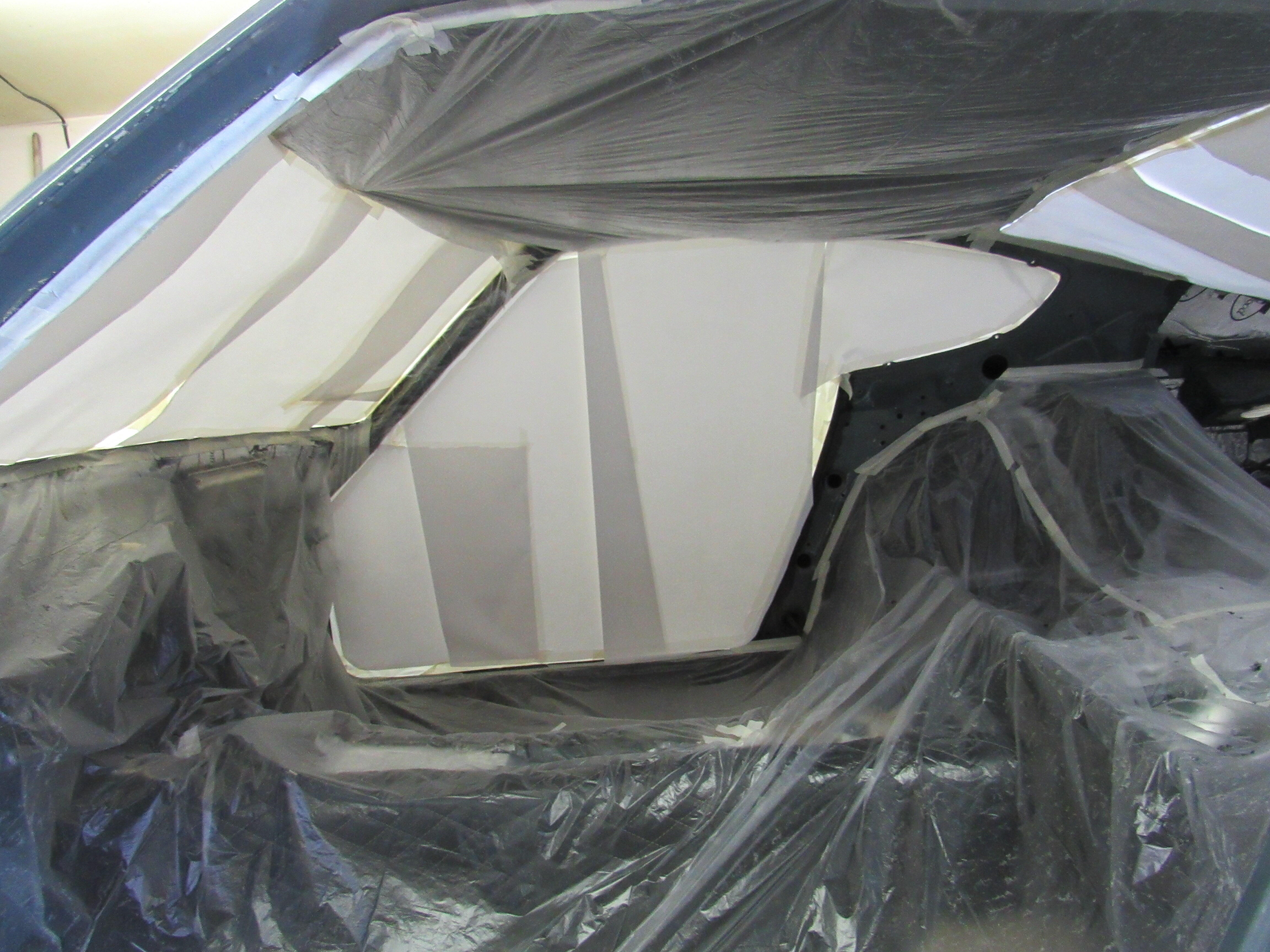

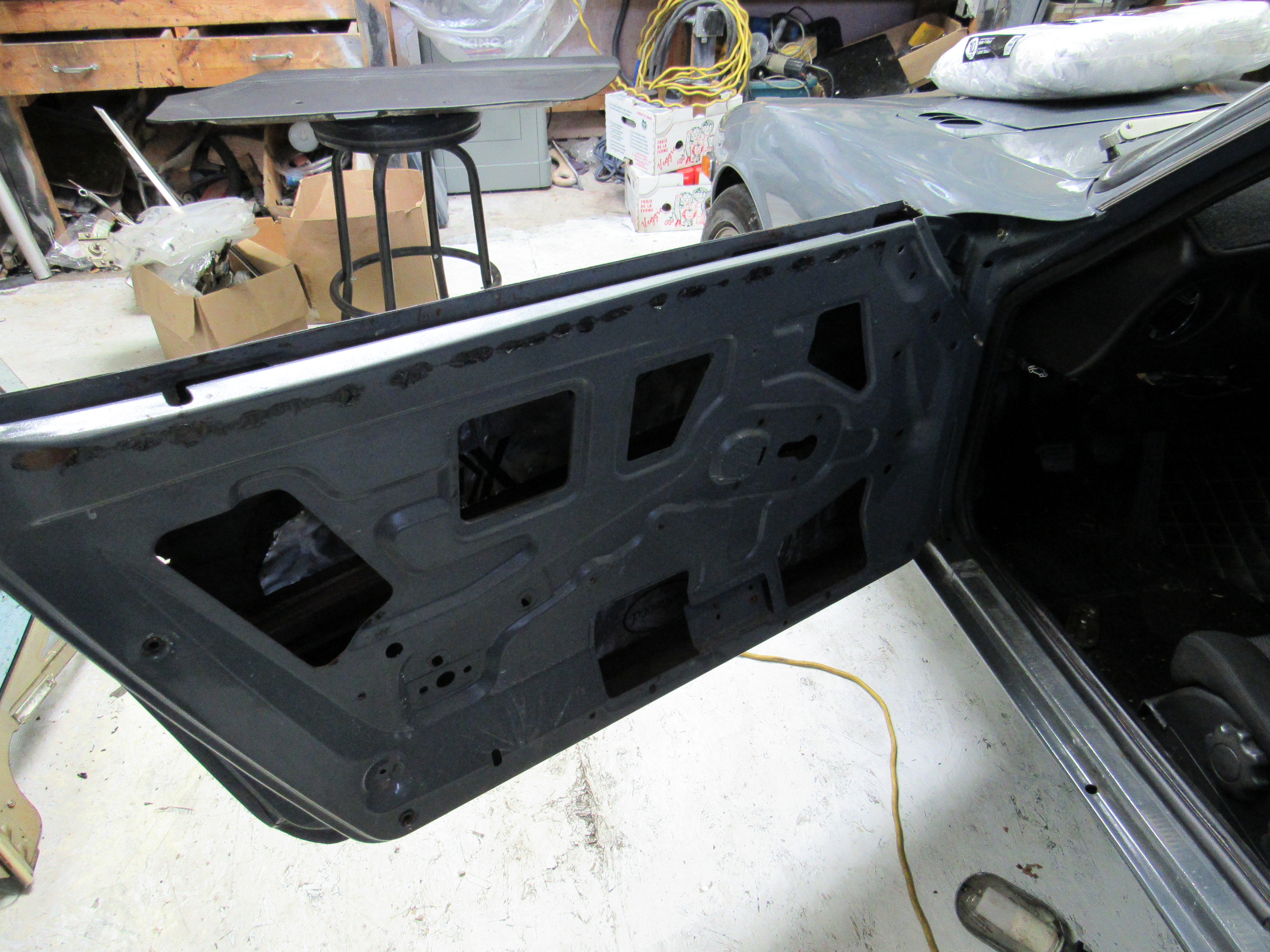

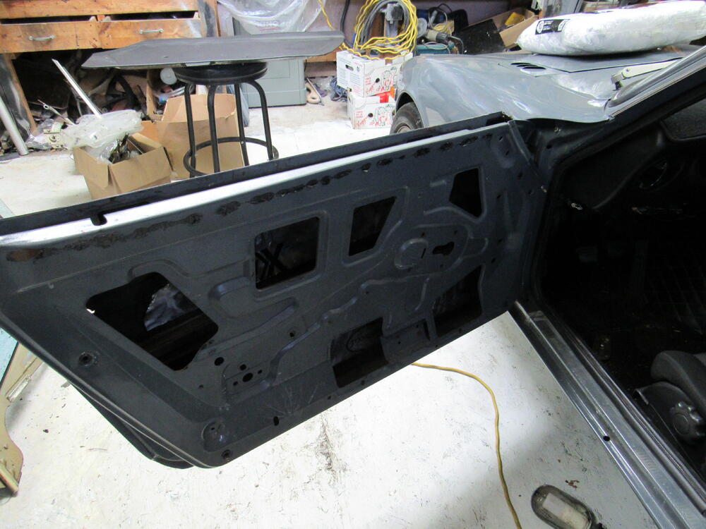

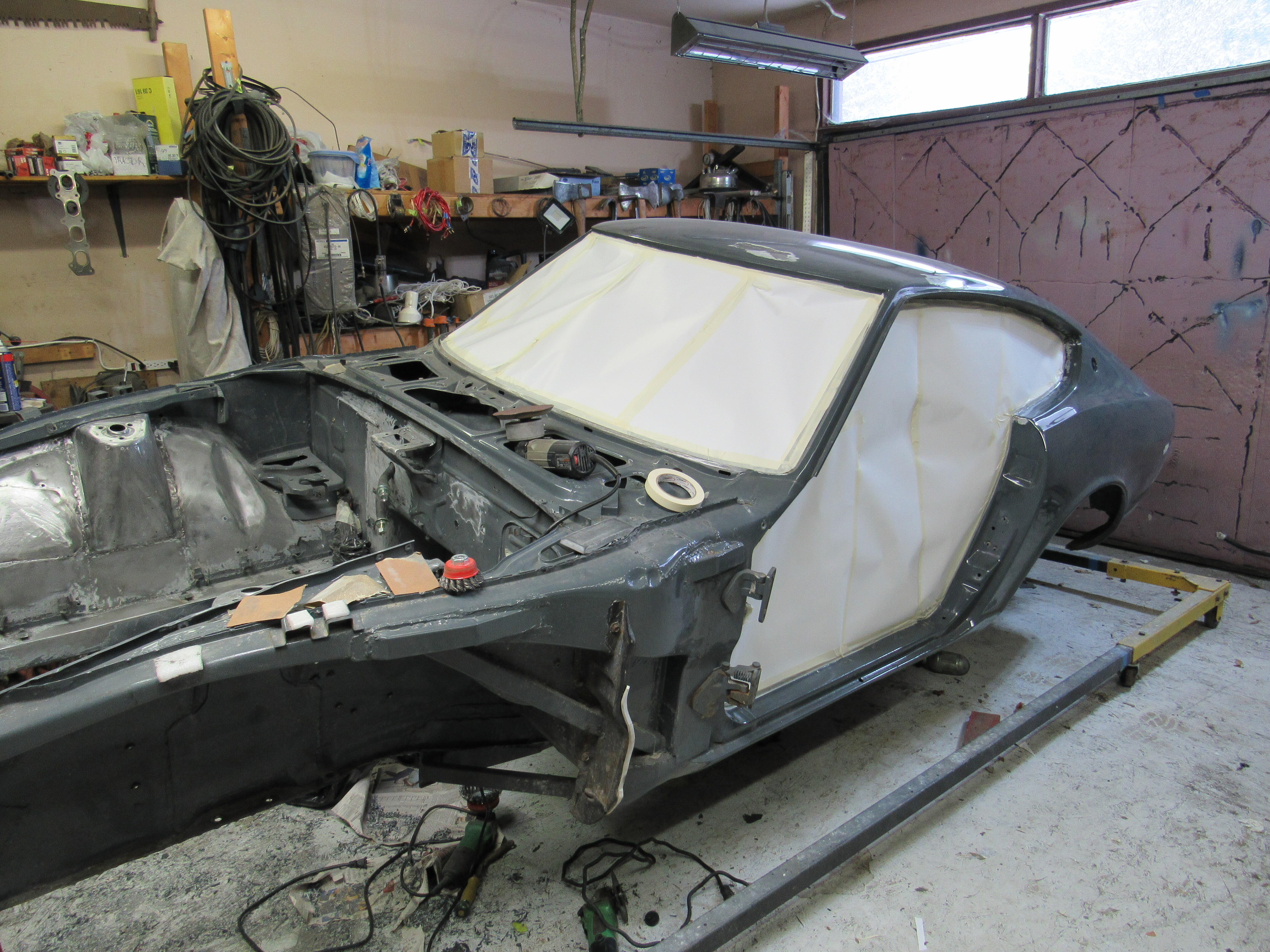

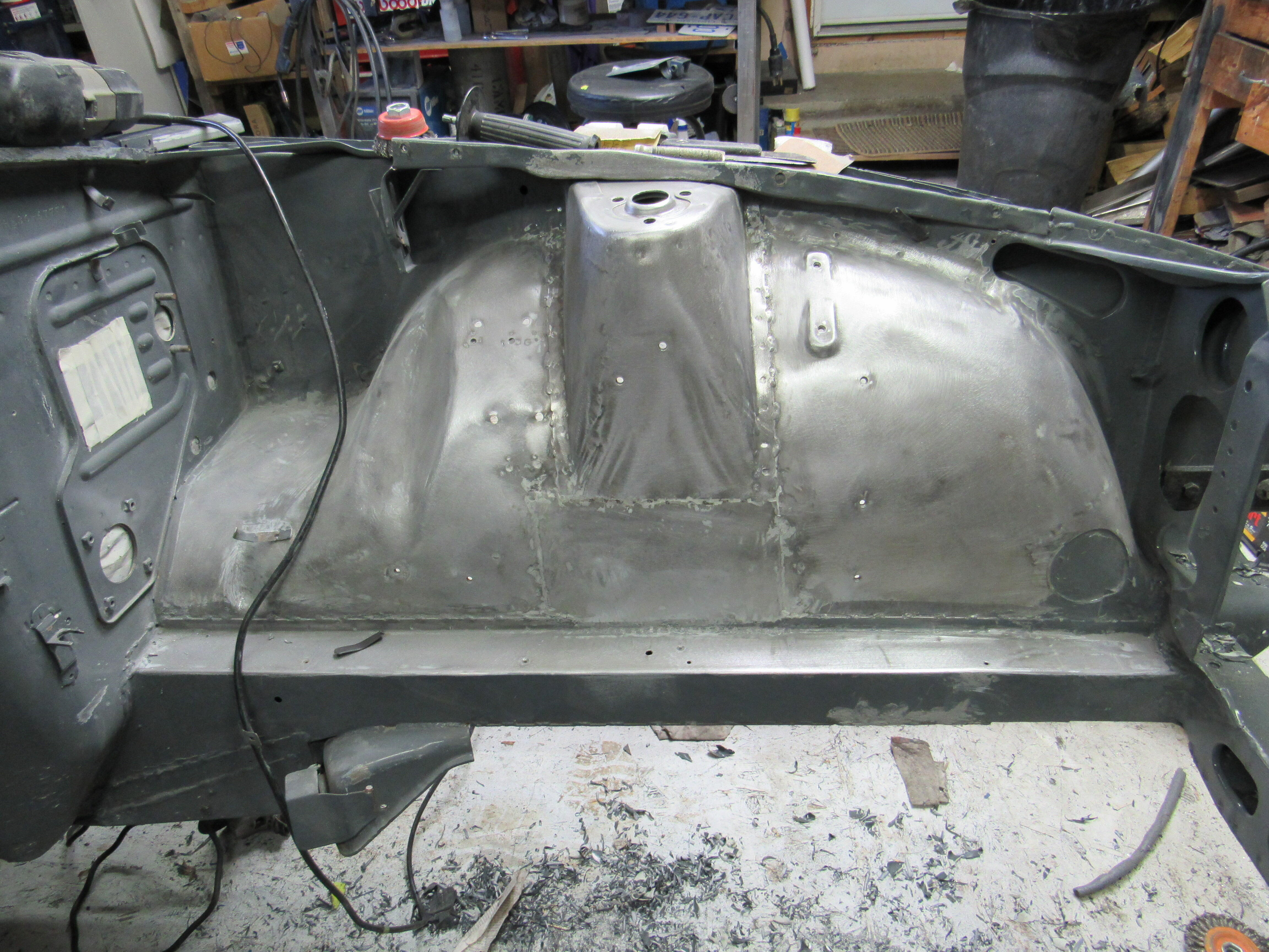

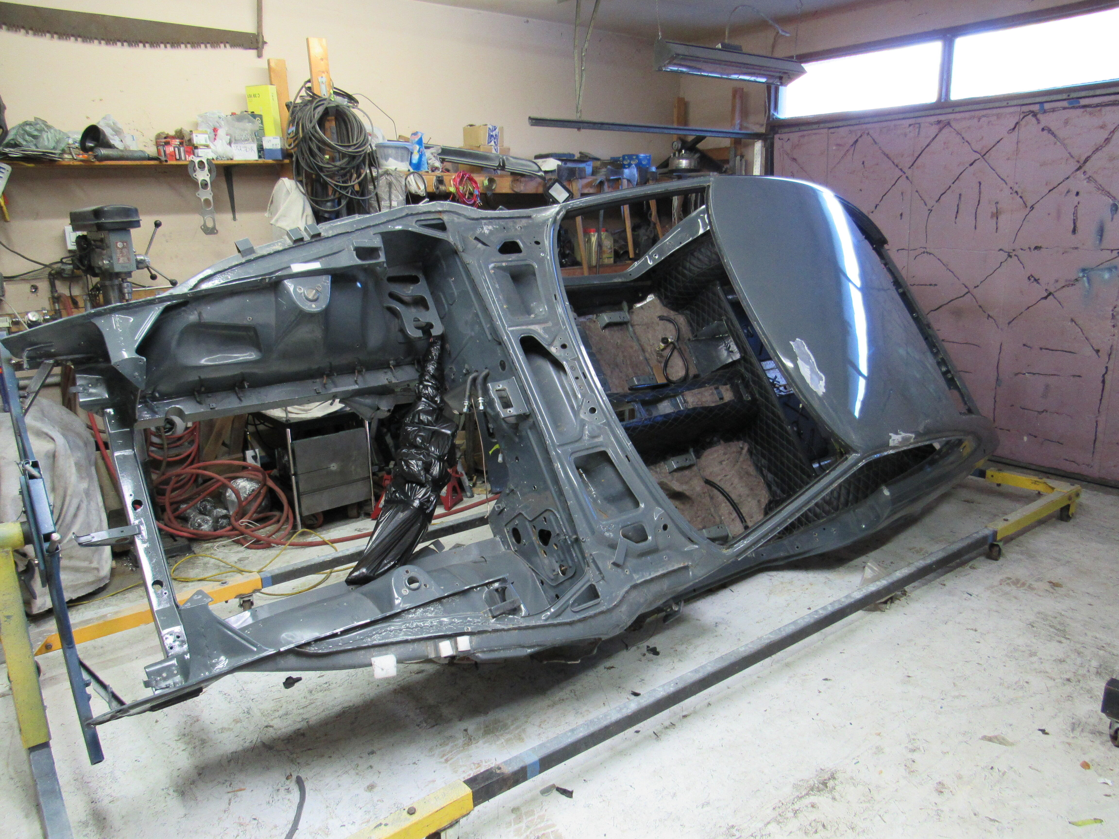

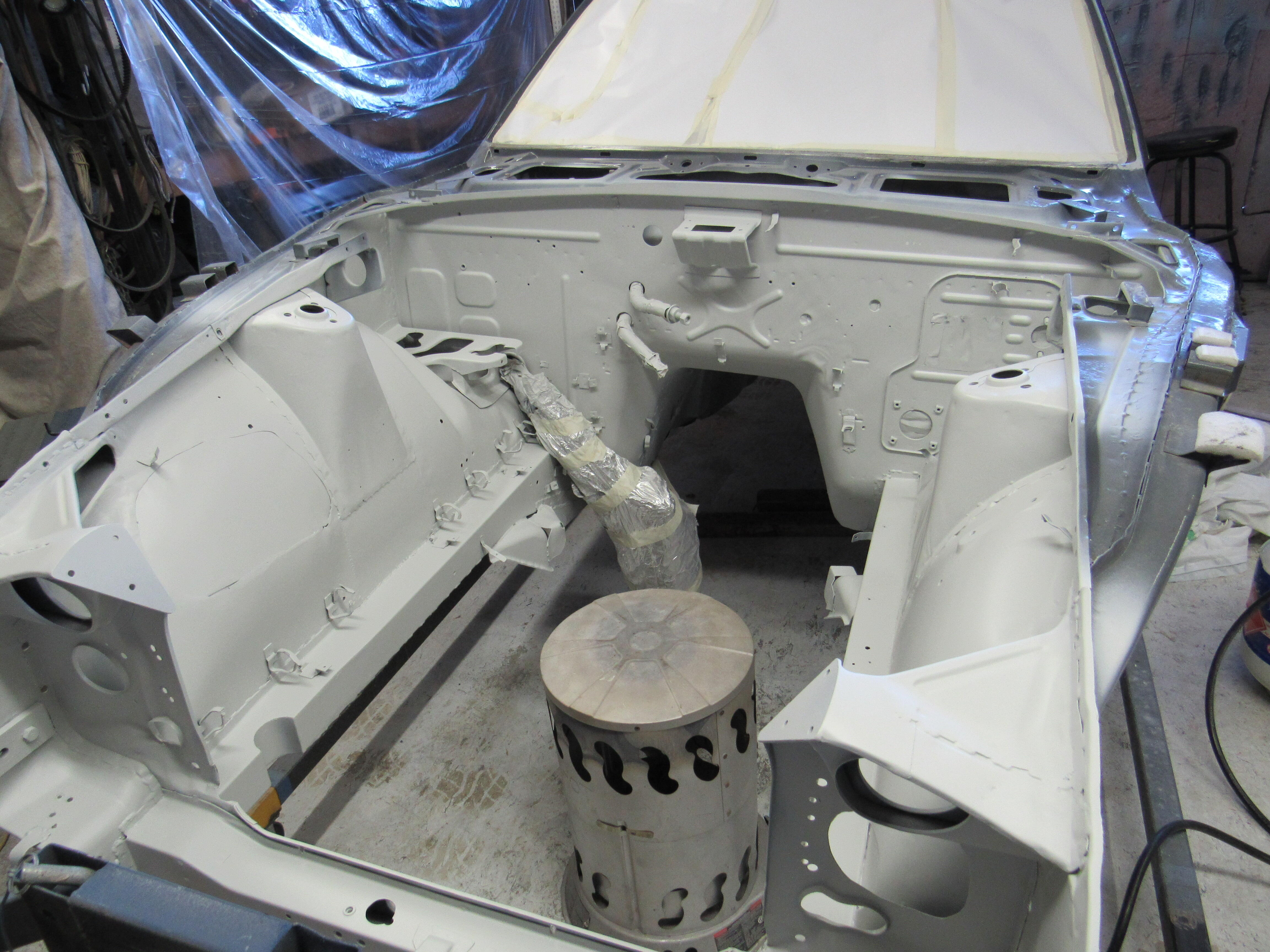

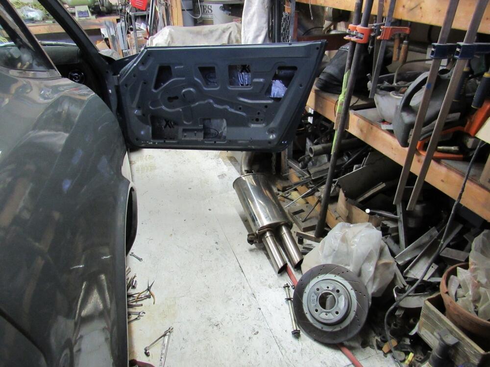

I have the car stripped and mounted on the rotisserie now, the interior mostly stripped out and have covered all the leather and roof with plastic and sealed up the openings with masking paper.   I removed all the paint from the engine bay and before any oxidation could start sprayed 2 coats of epoxy primmer.

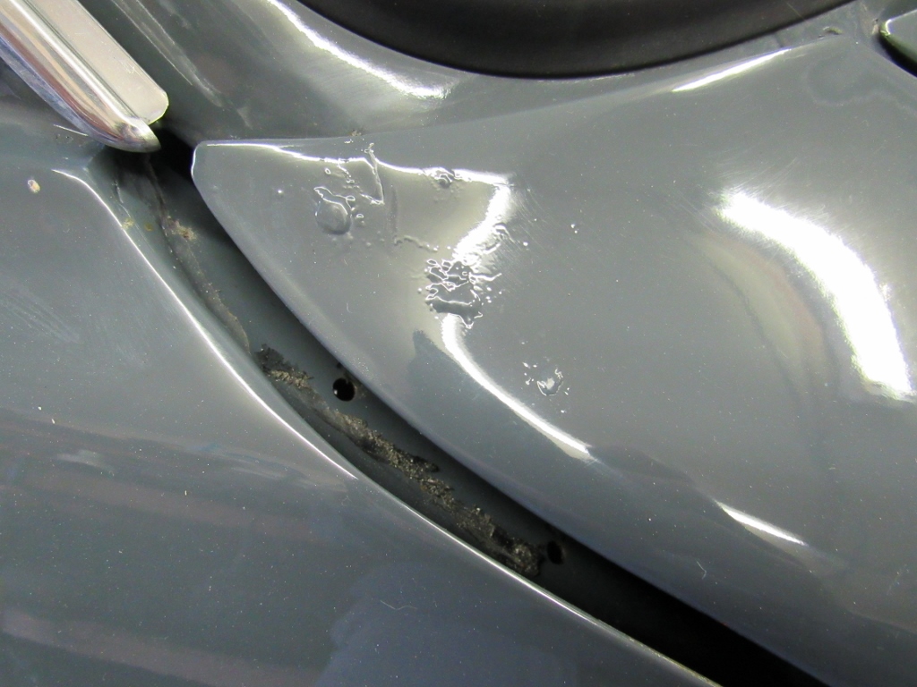

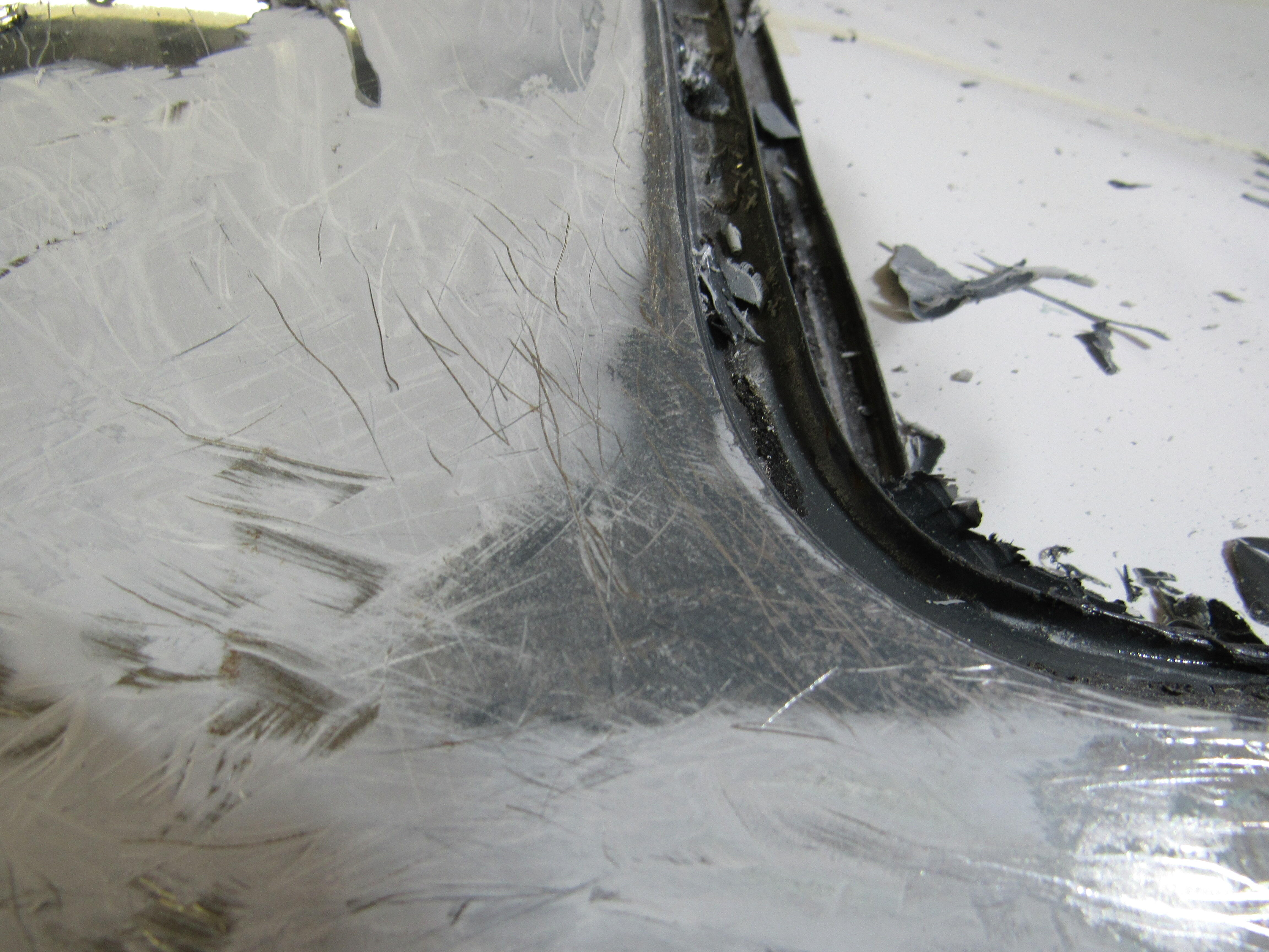

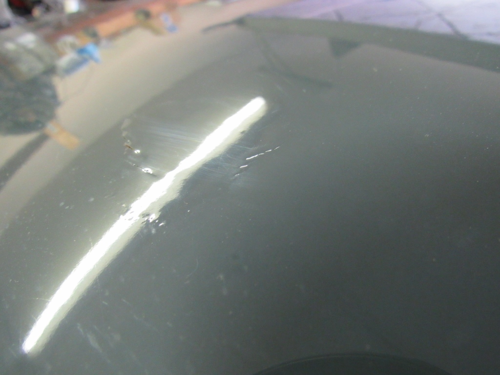

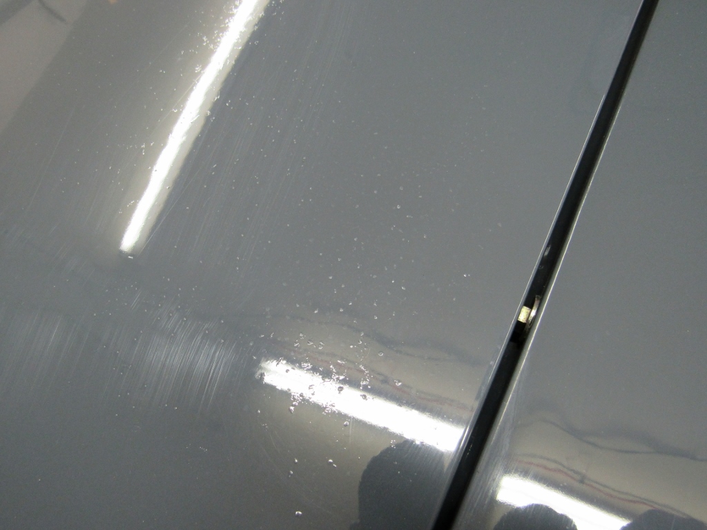

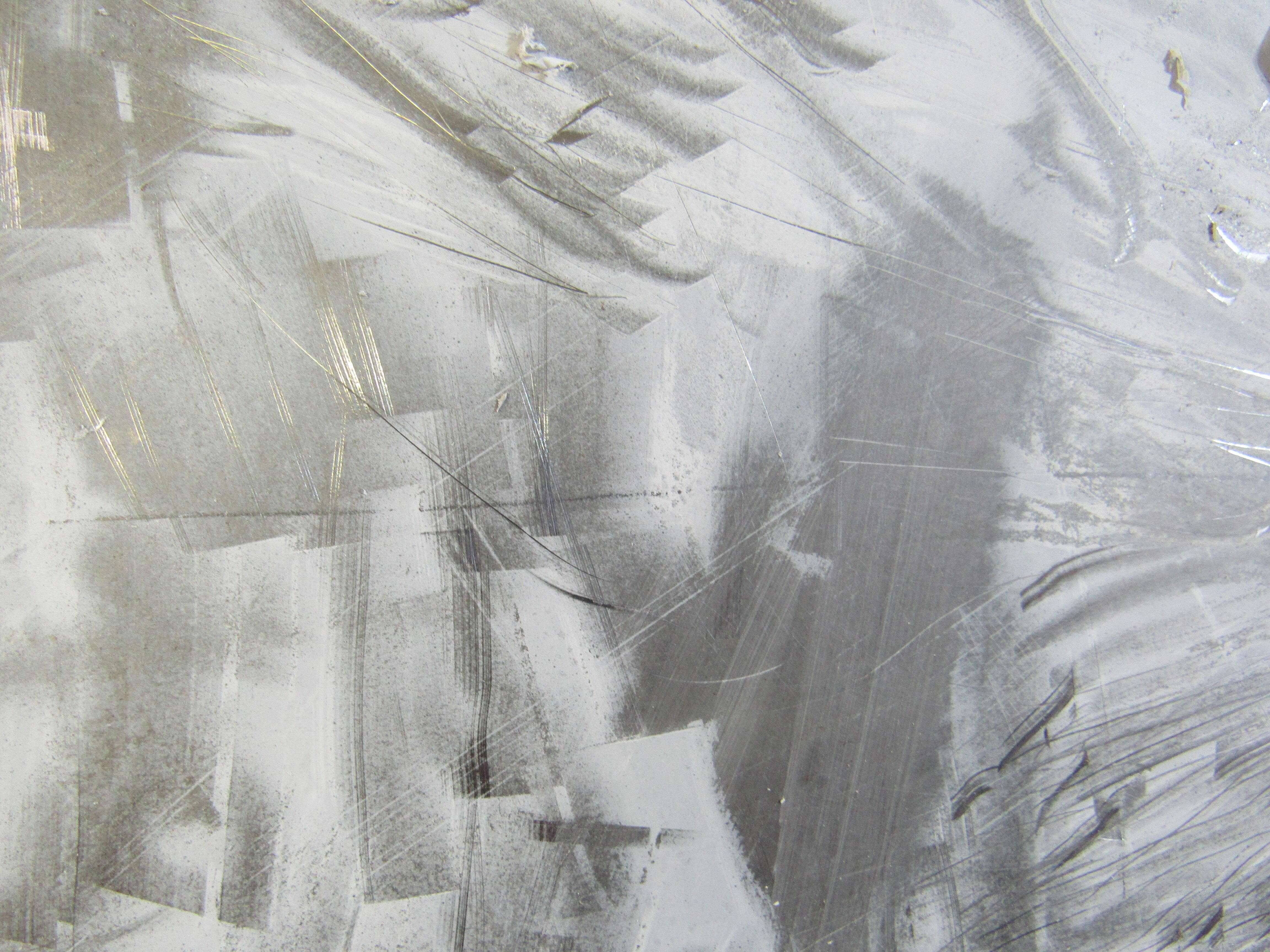

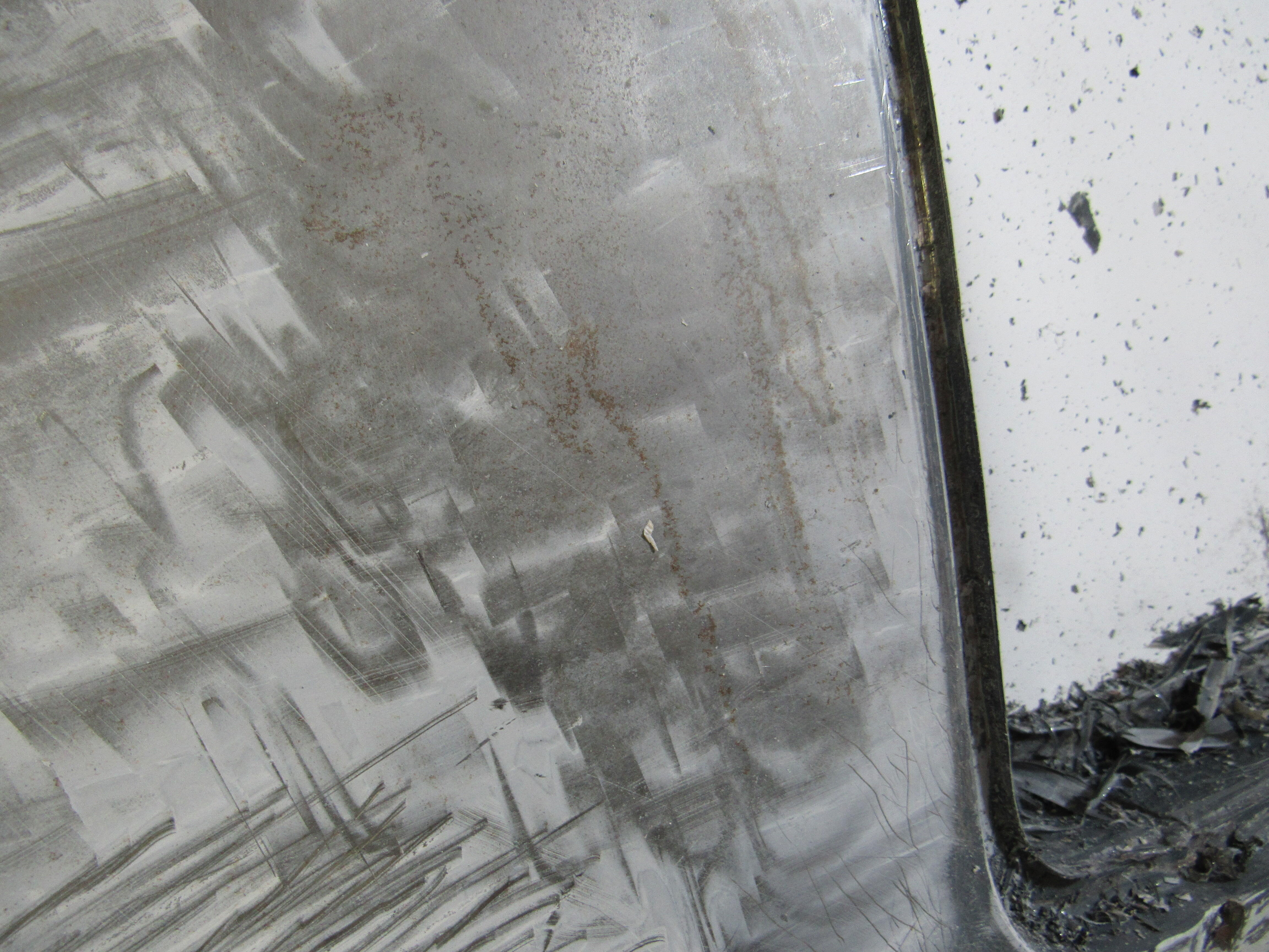

So here's why the paint job failed, first off he applied filler straight on to the bare metal which I asked him not to do and he assured me he wouldn't.  But he didn't sand the bare metal or even wipe it down with solvent/cleaner, you can see in the pics the pencil marks I made circling some of the flaws before I sent the car up to him.  In one pic I have wiped the pencil mark off with a bit of solvent. In fact the only sanding the metal saw was when he burned through the primmer while sanding, then he sprayed basecoat colour straight on to the metal with no primmer followed by clearcoat.😲 I've never seen that one before.
The only good thing about the paint job is that it is so poor that it hasn't taken long the strip it off with a heat gun and scraper, I got half the car done today. Okay, that's it I won't mention the old paint job again, moving on.
The 2nd and 5th pics are the engine bay partially stripped of paint before the primer. The last pic you can see the colour coat straight on the metal with no primer under it.
