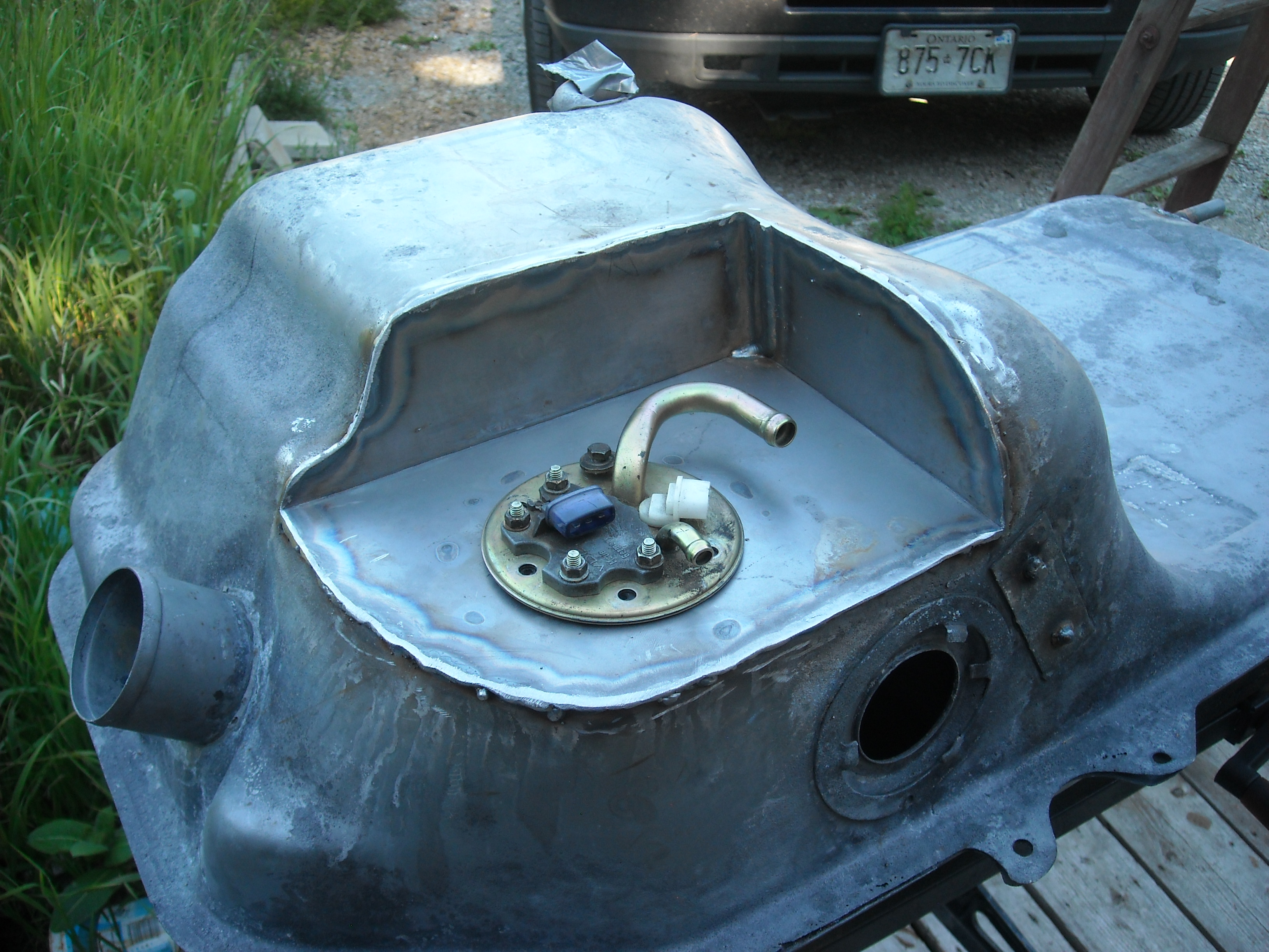

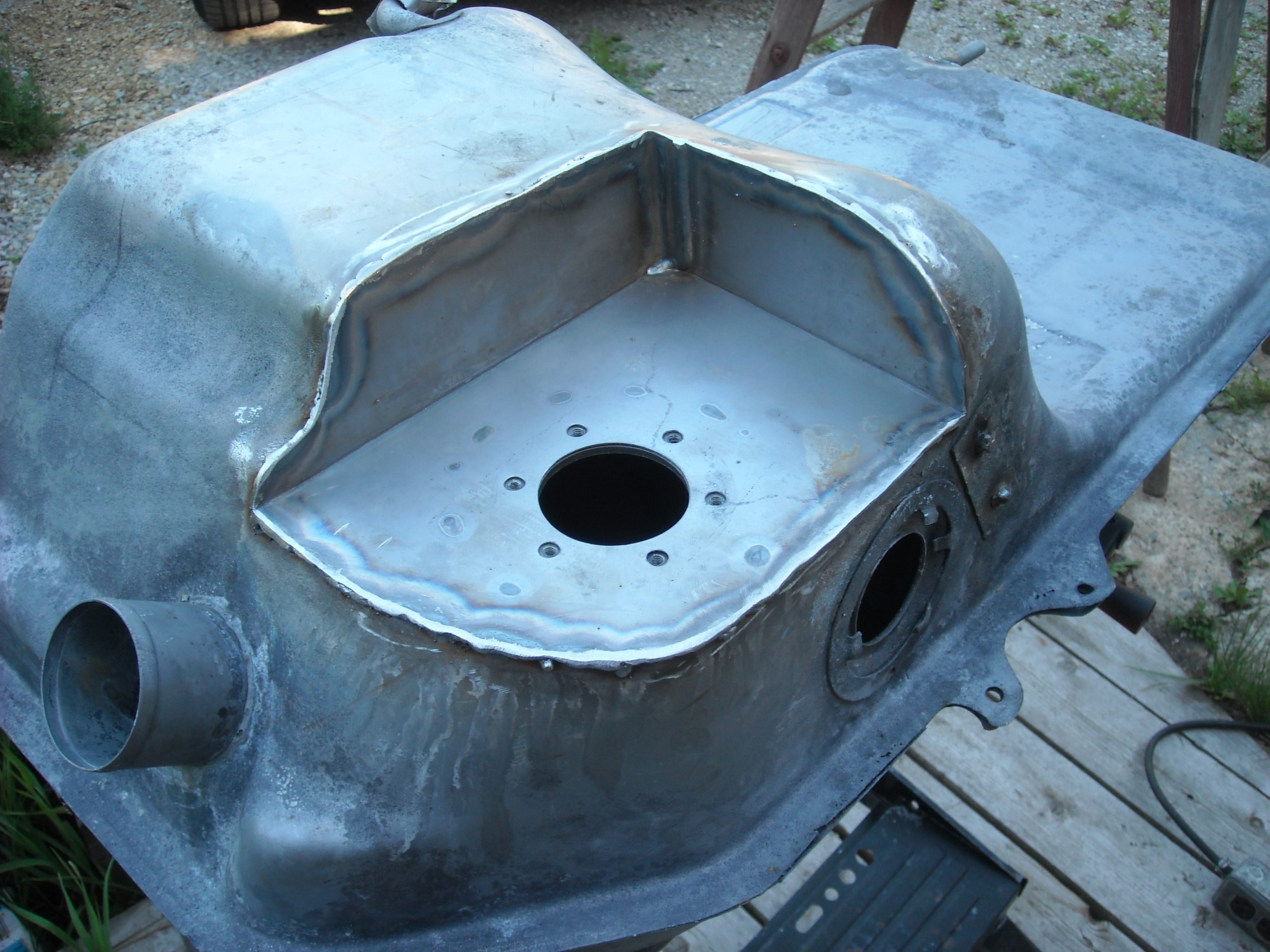

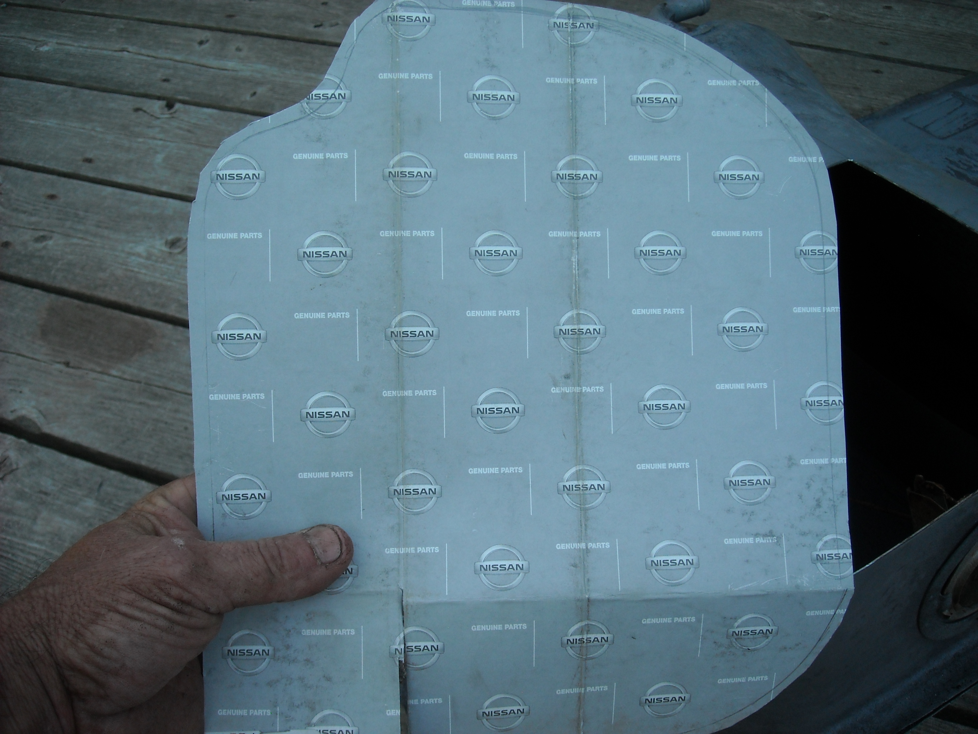

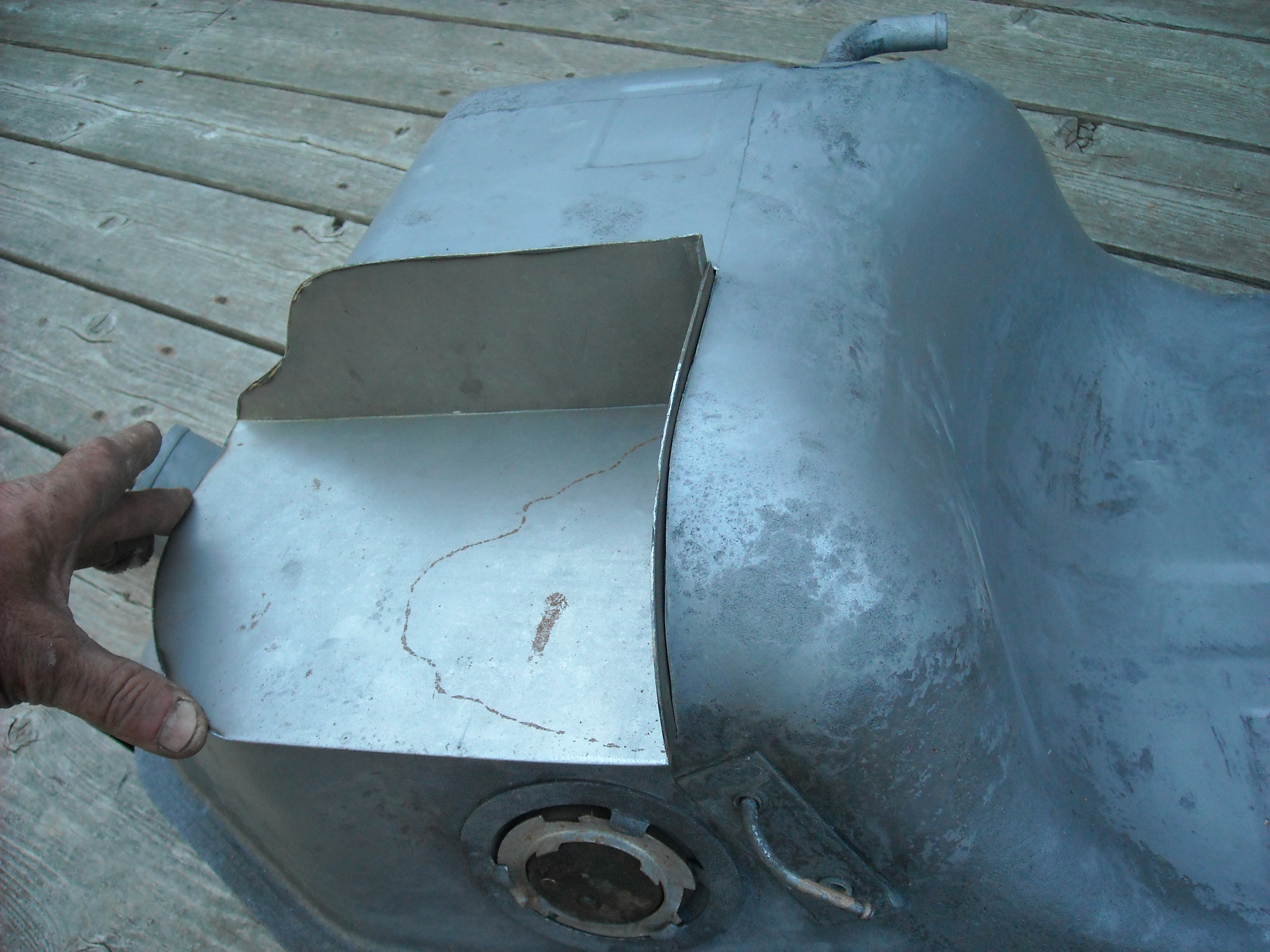

Charles, that reminds me of a thread a couple of years back where one of the members here cut out one of the storage bin lids from the rear deck of a wrecked 240z and welded it in right above the fuel pump he installed in the gas tank. Only another Z guy would know it wasn't a stock access door, I'll see if I can find it.
Thanks for the idea!

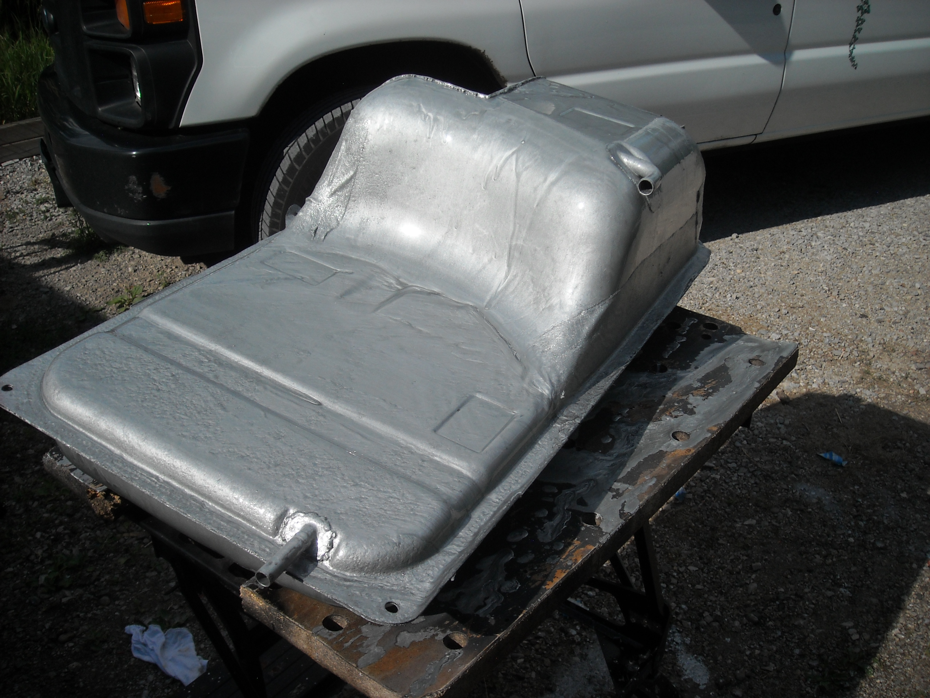

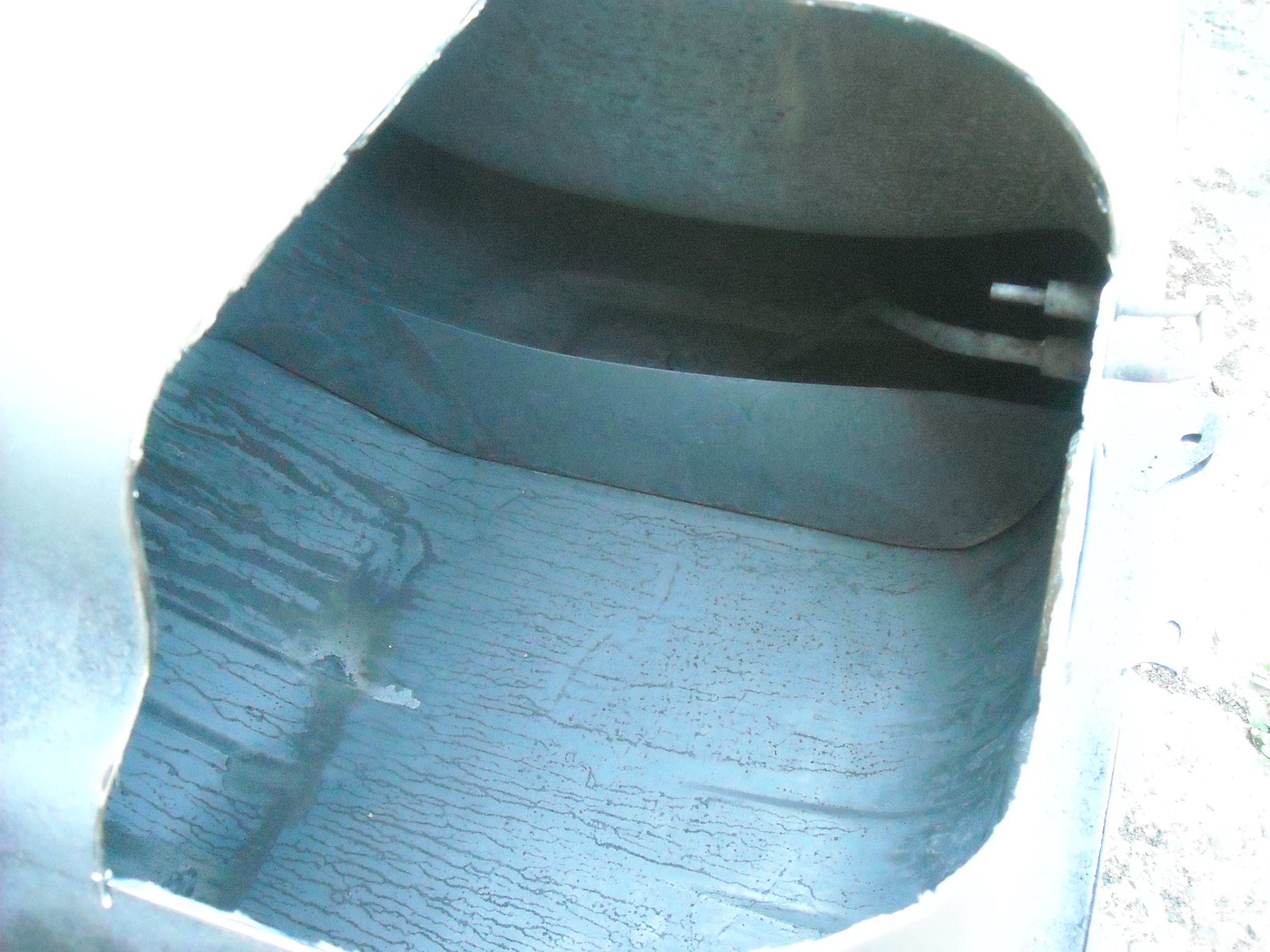

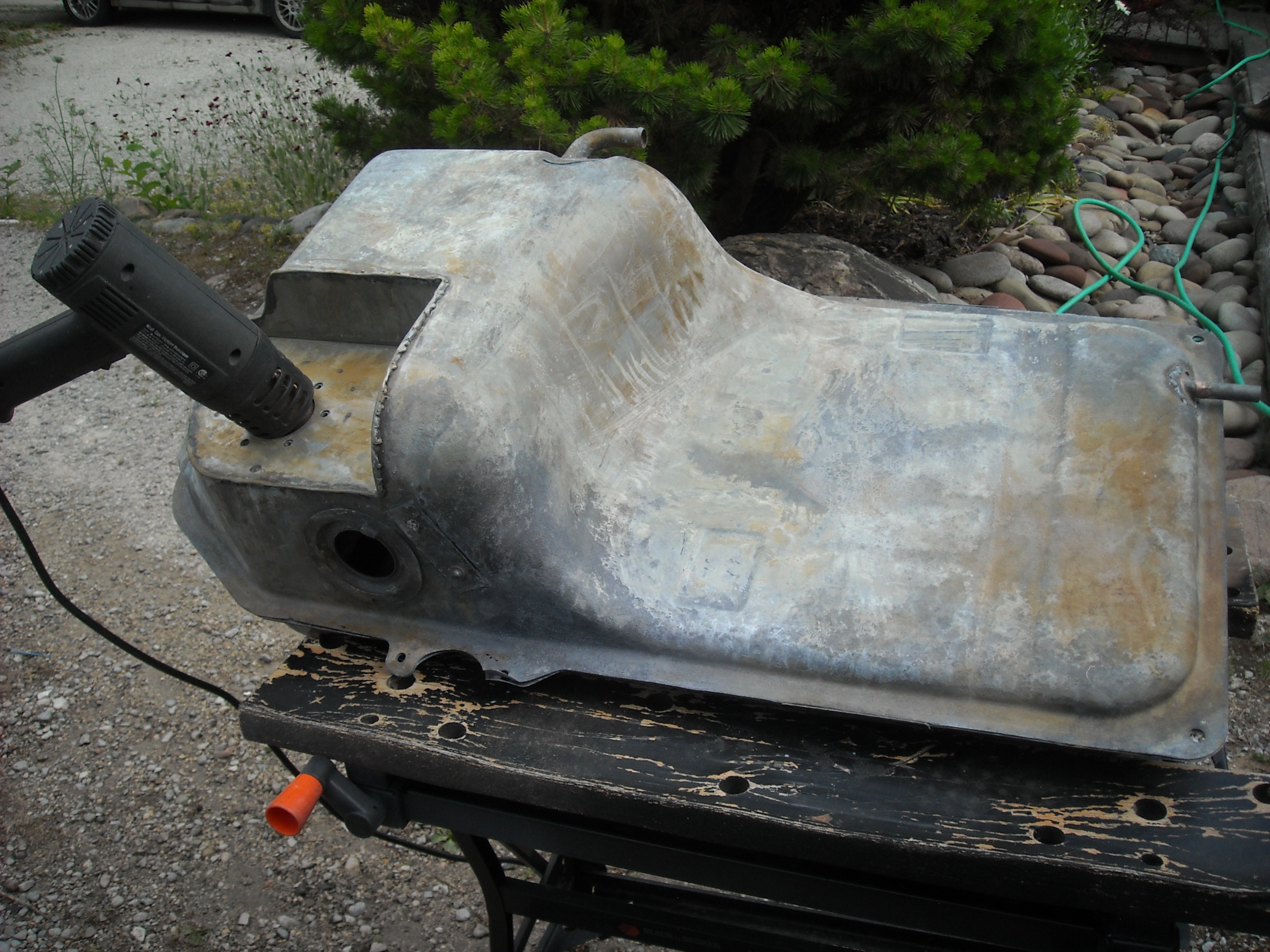

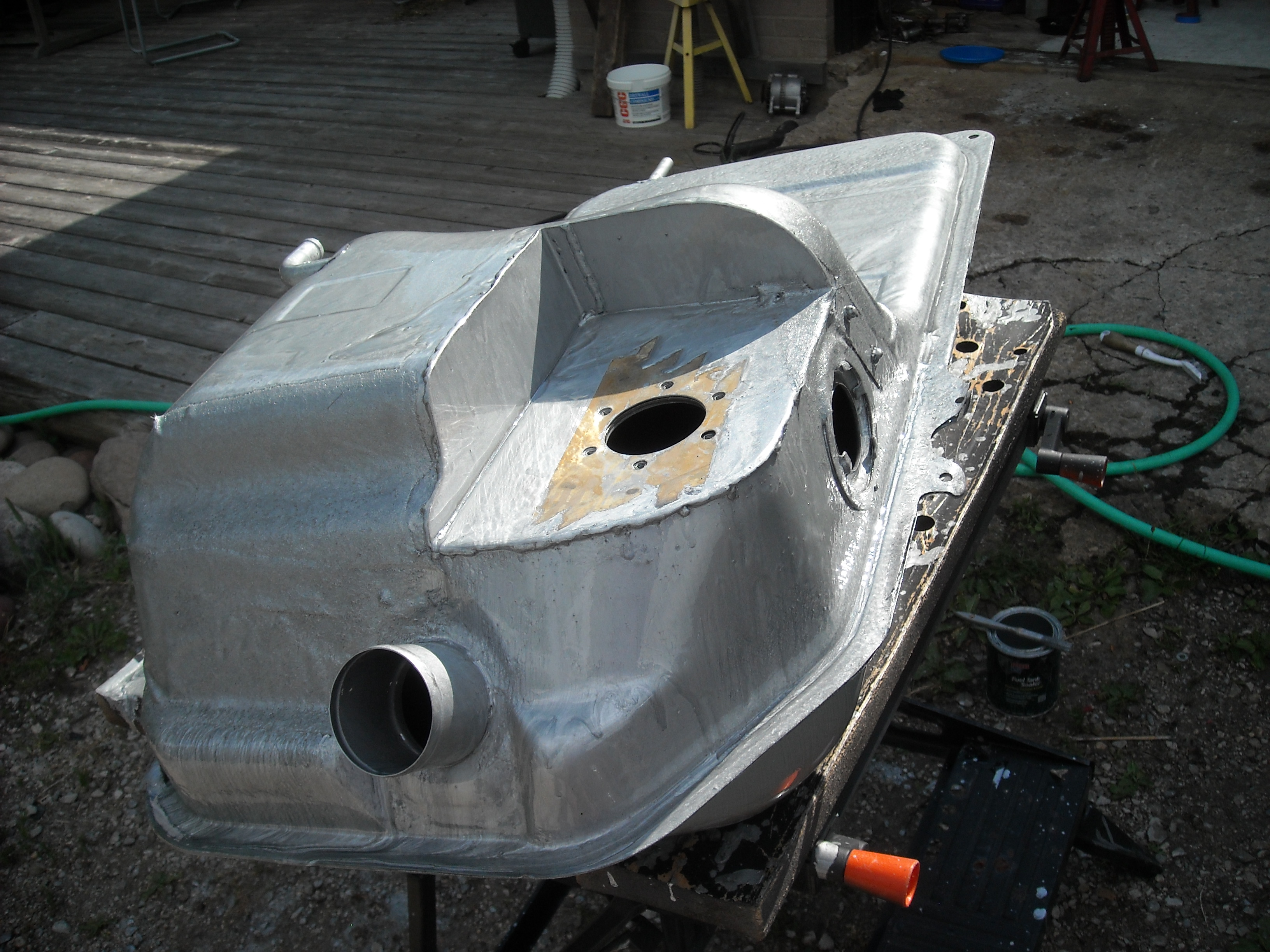

Fedx dropped off my POR15 tank sealer kit yesterday and I got home early today so I thought I would do the degreaser and metal prep stages and leave the sealer for tomorrow but after a an hour with the paint stripping heat gun blasting in it I couldn't touch the steel it was so hot so I guess it was dry enough. Man, what a mess!
If you end up doing this make sure you are wearing clothes you don't care about, it gets everywhere. After draining the the rest out of the tank there was so much left over that I coated the outside as well rather then just waste it.
I used that stuff in the tank. Emptied the tin in the tank, plugged all the holes and rolled it around the backyard for 15minutes. Then tried to drain as much as possible out of it and use compressed air to blow all the tubes clean so they wouldn't block up.
Never thought of using that stuff on the outside of the tank. I just coated mineΒ with black rustoleum.
Neat mod btw.
