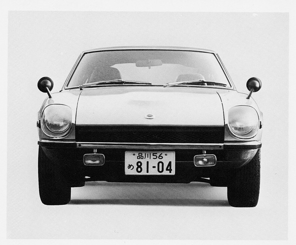

Yes - 35 really did need a donor shell's help. There are certain rules and regulations here about keeping the identity of a car when it is being put into another shell ( they work it on a scoring system based on certain components having more relevance than others ). I wonder if you have a similar system over there?
I think my description of the mounting positions for the Factory Spot Lamps was probably crap, and that's why you don't understand it. Sorry. What I mean is that they mount under the bumper, just on the inside of the two Over-riders ( when fitted ) as opposed to "outside" them ( which would be on the Indicator / Side Lamp side ).
A picture saves a thousand words, so I've dug out this one to illustrate the correct positioning. The car illustrated does not have the Over-riders - but you can see the plastic grommets for their mounting holes and I think you can imagine where they would be. It makes the Fog Lamps pretty close to them I think.

Alan,
The donor shell regulations, I must confess, I have no real idea what happens now. I do know that in Australia, where Zeds have literally evaporated into thin air, to carry out this type of revival, you would need to have a police clearance report at the start, before and after tag stitching on the donor shell, to save problems later, if anyone suspected an illegal rebirth.
Thanks for the picture of the home market Zed with fog lamps fitted. To the second explanation about installation of fog lamps, the word I fashion in response is "crystal".
