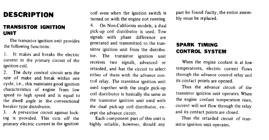

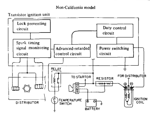

Someone posted on this recently, maybe you're just reposting (?). But one possibility on the dual pickup cars, is a bad advance control circuit in the ignition module. You could test by shorting the water temperature pins so the the engine always seemed cold to the ignition module, and always used the advanced pickup. I think that I posted a different solution last time, I'm not 100% clear on what happens inside the module. Shorting the switch should work though if that's the problem, locking in the advanced pickup control.
Edit - remembered the reason for the PO's solution on my car. On mine, one of the pickups was bad. So the PO wired them together so the module always used the same pickup, no matter what circuit the module was using. So, it could be the "late" pickup or the circuit in the module.
If you only have one pickup, this is irrelevant.
