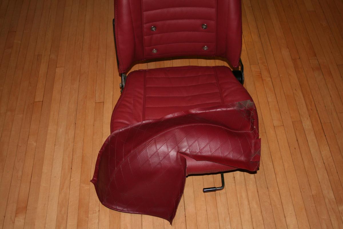

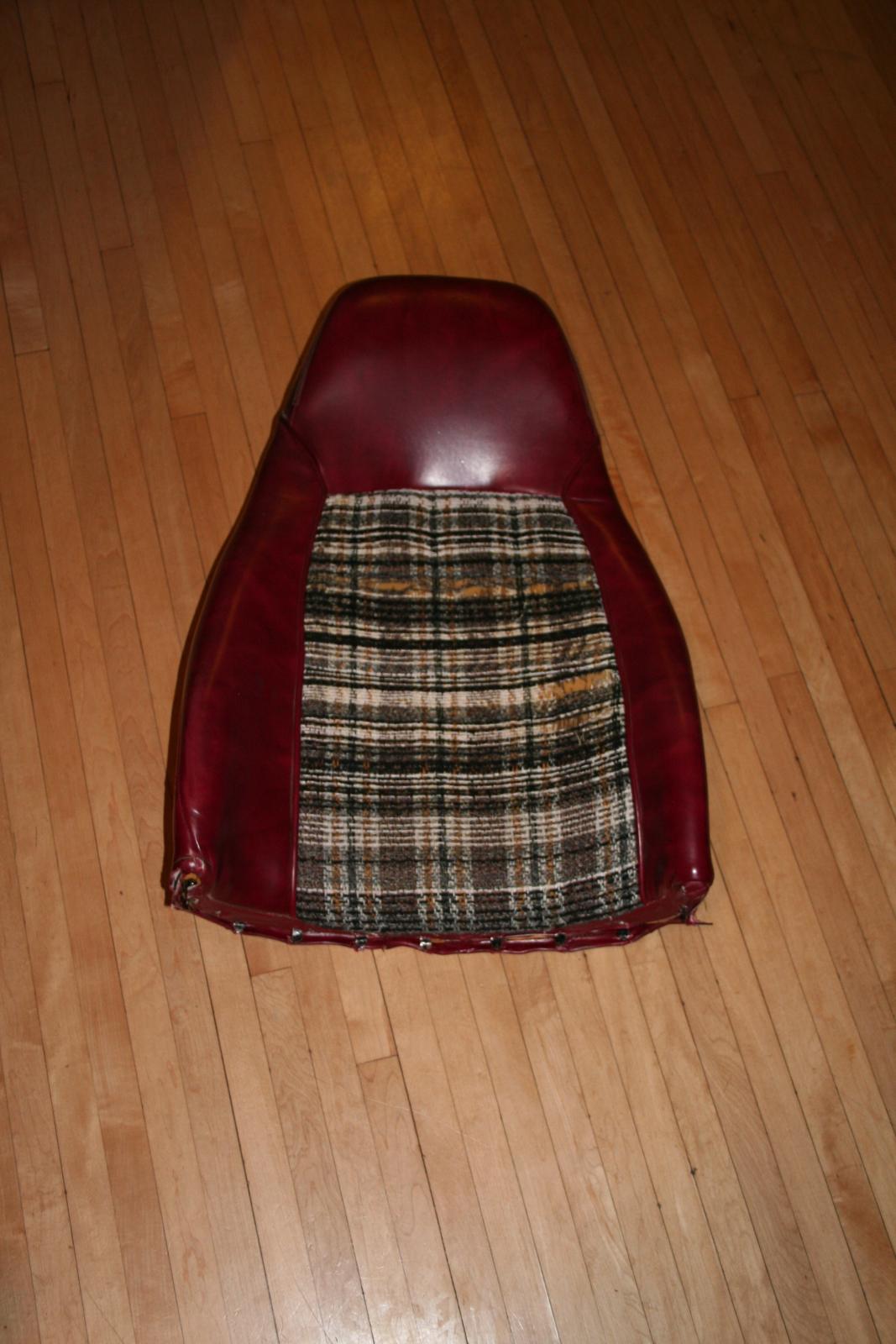

First a picture of my old seat back.post-20701-0-40326600-1415849437_thumb.j
I'm pretty sure the interior was "updated" sometime in the 80's before I got the car.  I considered both leather and vinyl but decided to go with leather hoping it will acquire charater over time.  At $375 for the pair Interior-Innovations was affordable so I sent them an e-mail asking if they could send some scraps of leather so I could check the color.  I got a response within 10 minutes of my e-mail stating that they just needed my address.

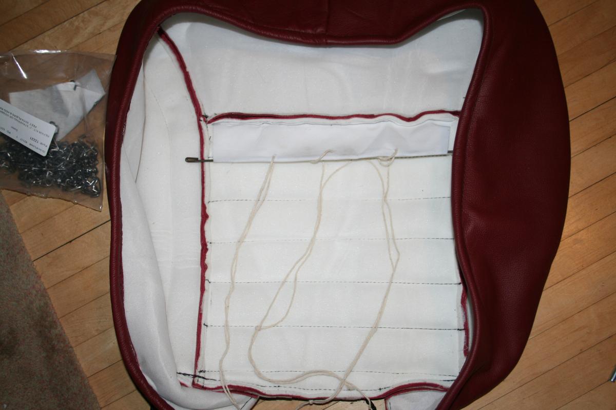

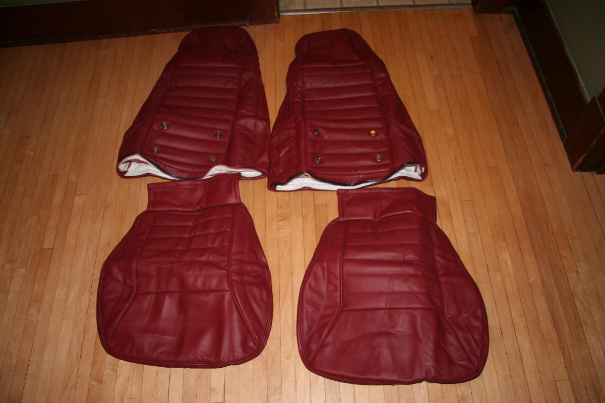

Initial quality seems good, and they are in fact entirely leather.  post-20701-0-08285000-1415850212_thumb.j  The leather is backed in foam on all interior surfaces.post-20701-0-28057400-1415850271_thumb.j

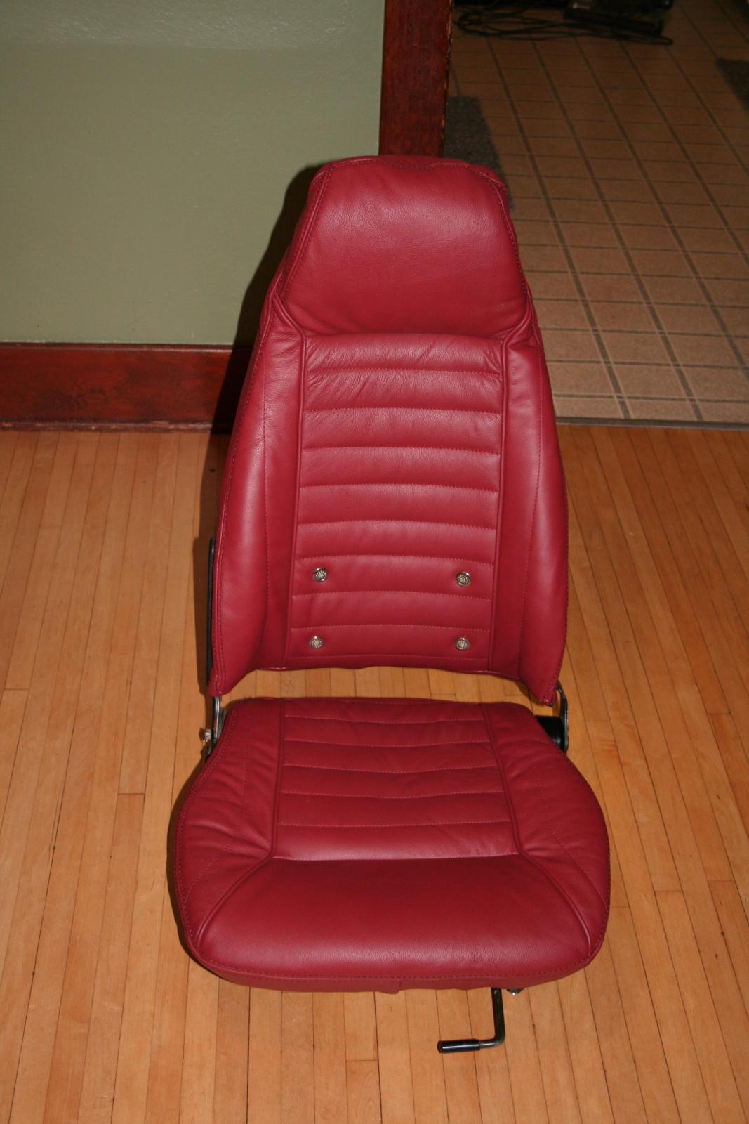

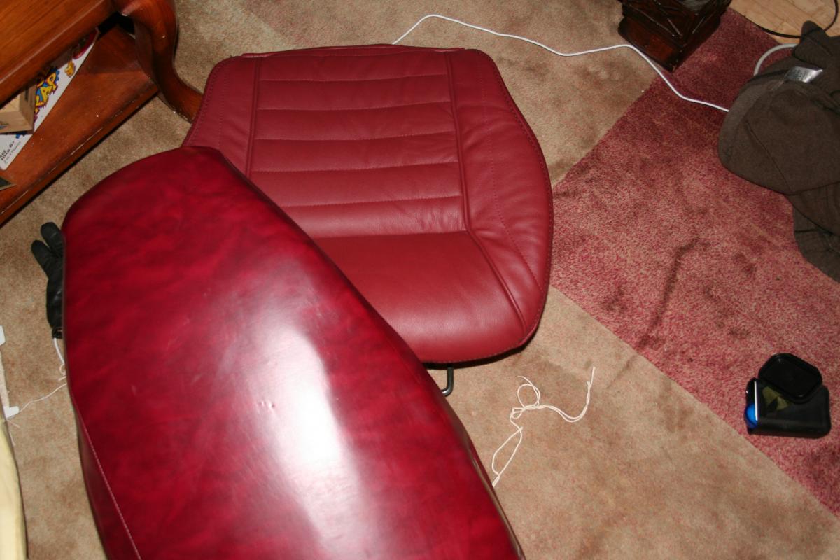

I won't do a compressive install write-up since Hardway already did a good one.  But I will mention a few issues I encountered.  The seat bottom installed just fine.  I imagine a professional could have done better, but it went okay.post-20701-0-31521800-1415850507_thumb.j  You can see the leather is much duller than the original vinyl, but a fairly close color match.
The seat back, however, was cut too generous in the back.  I didn't put the 1/4 inch of foam on the back so that may have contributed.  Additionally I am using "slightly" used seat foams purchased from another forum member so that could have affected it as well.  In the end I got it pulled tight by reversing the order in which it pulls over the tabs.post-20701-0-77115000-1415850765_thumb.j

Thanks guys!  It was a little easier that I had thought.  I would recommend 2 sets of hands to do the bottom portion.  Hopefully I'll get a chance to get the other seat done this weekend.
So I finished the other seat today and need to add some information.  Earlier I said they we cut too generous in the back... I was wrong.  They are cut correctly.  What happened on the first seat is the headrest peace of the foam slipped down about an inch.  To prevent this on the other seat I put the foam in the cover and then slid the metal back in.
Another thing that happened is several of the metal tabs broke.  To fix this I drilled holed in the frame and screwed the cover in place.  I suppose time will tell if this was a mistake.
