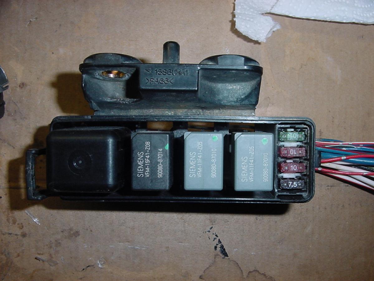

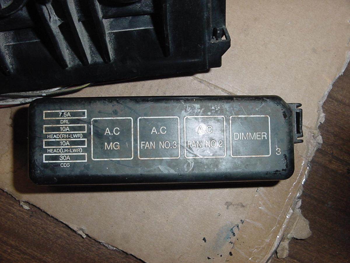

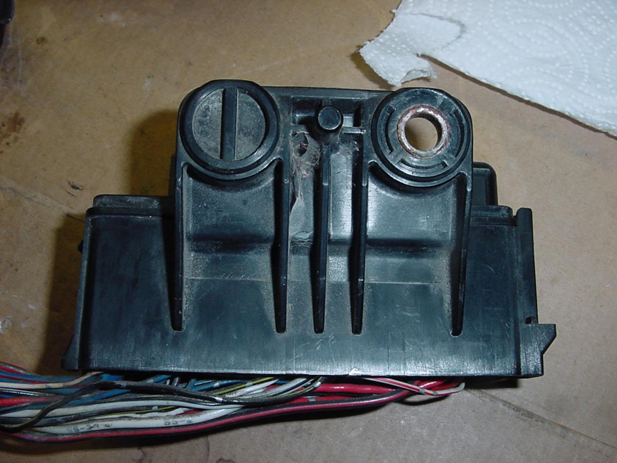

I just got one of those relay mounts from the JY.  It was from a 1998 Corolla LE, not the cheaper car. I think it was neat because it even had a cover for the bottom.  So all I need to do is to document the relays, the wires, and figure out to re-label the cover.

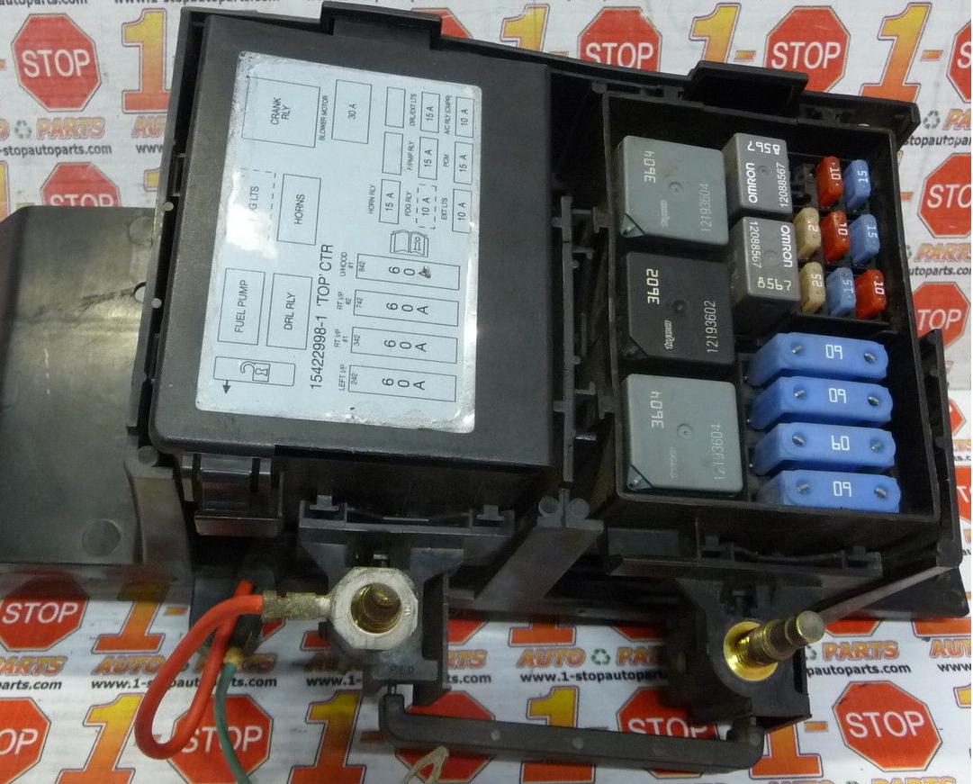

I was looking at the photo of the Impala relay box I sent to Bruce (CapnO) and I noticed what looks like a big relay using two small sockets.  Is that right?  If so, then this relay box has a total of seven relays capacity, plus 10 or so fuses in different combinations.

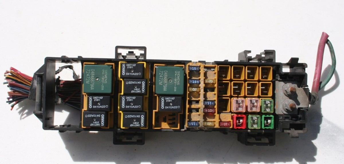

If you wanted  to borrow a fuse/relay box from another automobile, my choice for the most useful one would be from a '99-2000 Jeep Grand Cherokee,  It has what looks like the tight footprint, a good number of relays and fuses, and it's already wired for mains power.
