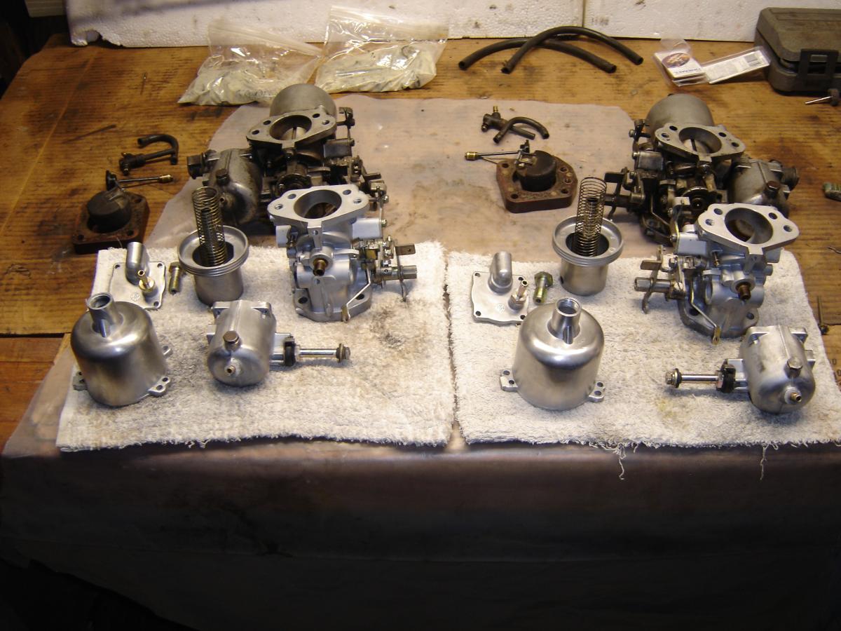

Posted November 21, 201410 yr comment_458982 Cleaned my carbs for rebuilding Saturday morning. Link to comment https://www.classiczcars.com/forums/topic/50464-what-i-did-today/ Share on other sites More sharing options...
November 21, 201410 yr comment_459005 Look great! what was your process like? Link to comment https://www.classiczcars.com/forums/topic/50464-what-i-did-today/#findComment-459005 Share on other sites More sharing options...
November 21, 201410 yr Author comment_459011 Thank you.Took them apart and soaked them in lacquer thinner for a day. Then blasted the grime off with air. Found a video on youtube that had a very simple solution to the soda blaster I'd built but didn't work very well. He put a small nut inside the pick up end to reduce the volume of soda it sucks up. Worked like a champ and only used 6 lbs of soda! That's $3 for 6 boxes at Dollar General. Then slowly blend everything together with 0000 steel wool. Link to comment https://www.classiczcars.com/forums/topic/50464-what-i-did-today/#findComment-459011 Share on other sites More sharing options...

November 21, 201410 yr comment_459041 siteunseen, are you using the ZTherapy rebuild kit? Link to comment https://www.classiczcars.com/forums/topic/50464-what-i-did-today/#findComment-459041 Share on other sites More sharing options...
November 22, 201410 yr Author comment_459058 siteunseen, are you using the ZTherapy rebuild kit?Yes I am. After watching the DVD I thought I had the wrong float valves, they weren't Grose Valves like in the DVD. So after a quick Google search I learned they were no longer available. At first I was going to rebuild a spare set I bought but when I realized how badly they'd been messed with I decided to go ahead and rebuild the original ones that were on the car. After taking them apart I can see I was driving half of a 240Z. About to watch the DVD one more time and go put them together this morning. Link to comment https://www.classiczcars.com/forums/topic/50464-what-i-did-today/#findComment-459058 Share on other sites More sharing options...
November 22, 201410 yr Author comment_459059 Looking good. Wipe all those shiny bits with Nevr-Dull before re-assembly and they'll stay that way!I'd never heard of that stuff, now I'll never forget about it. It's exactly what I needed for the "final touch". Thank you, thank you! Link to comment https://www.classiczcars.com/forums/topic/50464-what-i-did-today/#findComment-459059 Share on other sites More sharing options...

November 22, 201410 yr Author comment_459079 It's so easy to apply and then wipe off I could clean them up every now and again. I now see that the carbs will need a periodic once over anyway. I thought everything was clean until the Never Dull came back darker and darker. Link to comment https://www.classiczcars.com/forums/topic/50464-what-i-did-today/#findComment-459079 Share on other sites More sharing options...
