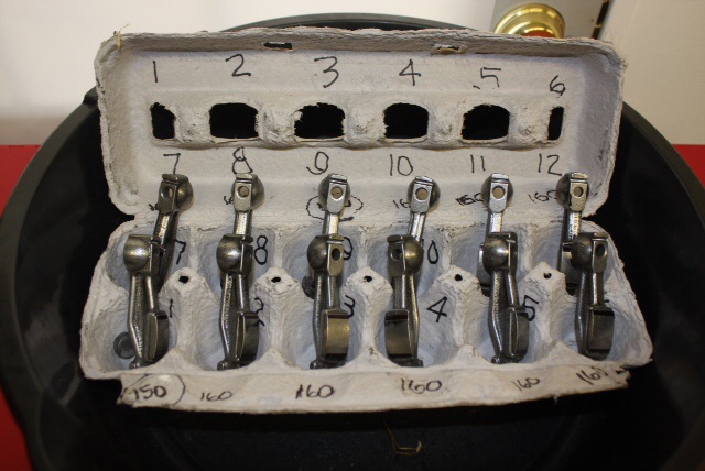

Stock lash pad thickness is just under .120 inches.......they are concave and sit down on the valve stem. New lash pads are usually flat across the bottom. If you were that far back on the wipe pattern, you'll need to start with a thicker lash pad (assuming the builder used a stock lash pad). I'd start by measuring the thickness of what he used ( you have to get inside the concave bottom to the flat top of the lash pad). Then I'd order one of each .130, .140, .150. ......then check the wipe pattern on each valve to make sure they all require the same lash pad. Put rocker and lash pad in an egg carton to keep in order.

finally got all the measurements done - learned quite a bit.
first off, i was surprised to find that the measurements were all over the place.
second, this is a job that takes time and patience, as every .010 makes a visible difference on the wipe pattern.
i was lucky to have a tiny set of feeler gauges, they've been in my tool set for ages, so i don't know if they're still available but they're practically made for this job - they are just the right width to fit in slot at the top of the lash pad and short enough to avoid hitting the perimeter of the head. i pulled out the following shims: .010, .015, .020, .025, .030 to mix/match as required - this gave me combinations to make increments of .010 all the way up to .1 so i could hit standard size lash pads. i used a piece of solder wire to make a loop to hold them together so i wouldn't lose them - the solder wire is soft, easy to open and close as i had to pull/add shims to set each rocker.
the process: black sharpie on the rocker wipe surface, add shims, set correct lash gap, spin the cam, pull the rocker, check the pattern & repeat 'till the wipe pattern is centered, then move on to the next one. it is a quiet, methodical, satisfying project - not difficult or complicated, and it feels good to get the pattern right where it belongs.
after i had the amount of shim that needed to be added to each lash pad, i figured i should check the lash pads to be sure they were all the same.
made a little fixture for my digital caliper to allow me to reach up into the recess in the bottom of the lash pads and zeroed it out, then measured all 12.
i measured flat across the top of the wear surface, to avoid mis-readings from the wear divot made by the rocker arm tip - this is consistent with the flat surface generated by the feeler gauge shim stack i used for measuring as well.
turns out the lash pads were not all the same - they ranged from .117 to .121 and although the difference was fairly small, it matters when added to the shim measurements i had.
adding the measured lash pad thickness to the shim stack needed to center the pattern and rounding to the nearest .010 gave me the final size of the lash pads i would need. turns out i need 2 pads at .18, 5 pads at .19 and 5 pads at .20 for this head setup.
so this head was set up way off - i can only guess that the valve seats were set high or not ground deep enough, or both.
