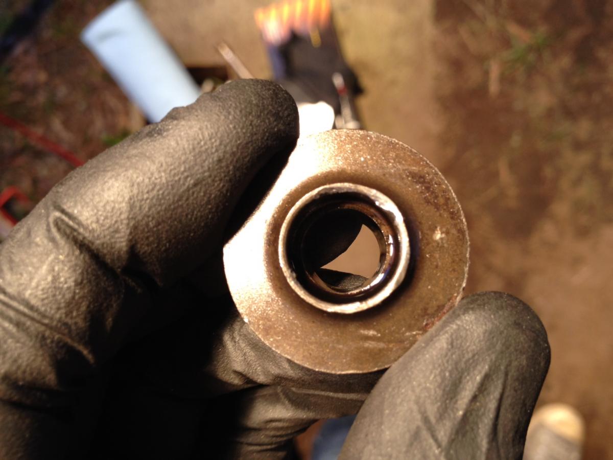

the evidence: the valve guide seal is torn and the little spring that wraps around it holding it onto the guide seat was popped off (that's the little "needle-like" thing in the picture. this makes me believe something pushed down on it hard enough to blow the spring off it and tear the top.

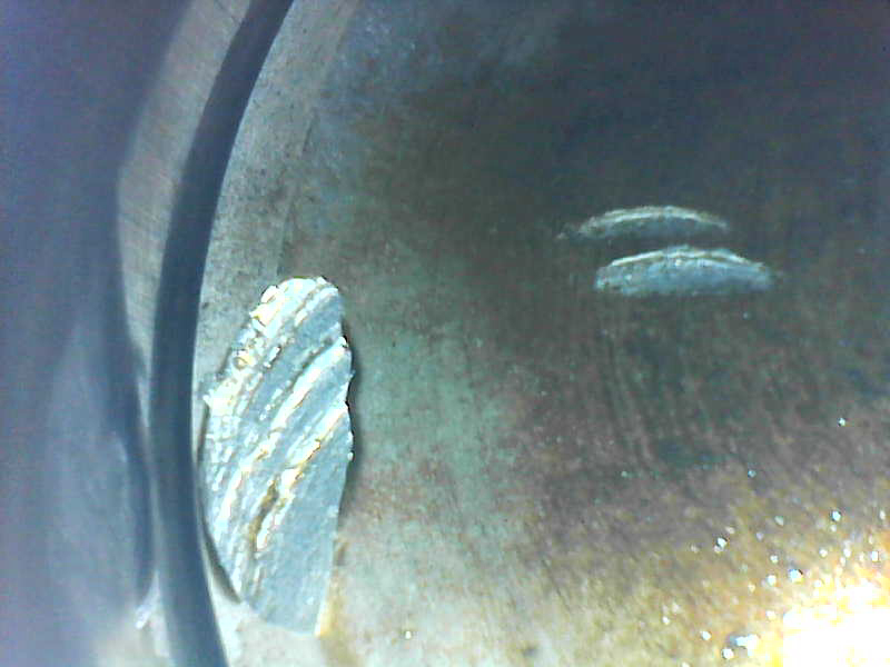

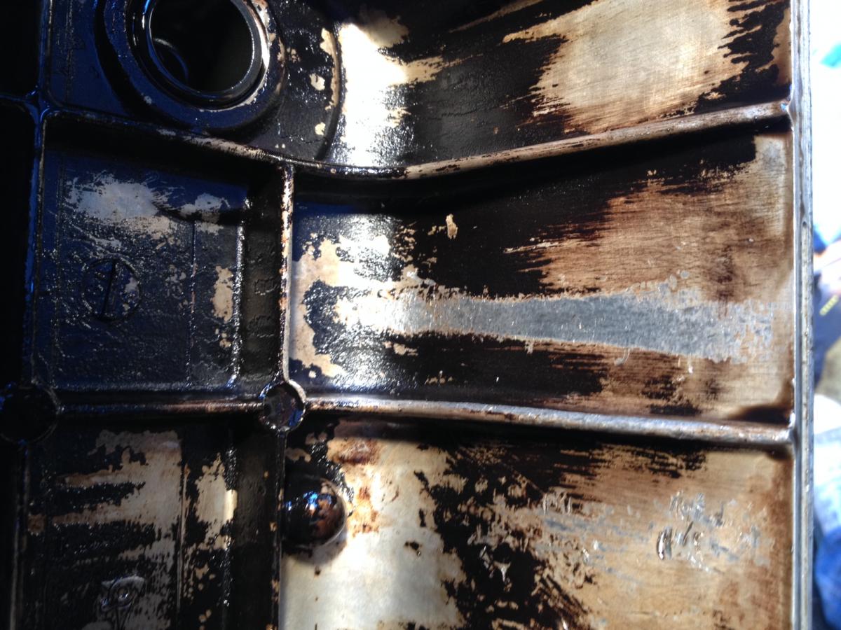

i used the camera in the spark plug hole and saw the evidence of serious impact. there was clearly quite a bit of commotion in there when things came apart, as was evidence by some marks on the inside of the cam cover and it looks like the spring keeper took a beating.

piston impact
post-28907-0-46334500-1422765618_thumb.j
valve cover
post-28907-0-90209000-1422765620_thumb.j
valve spring keeper
post-28907-0-65255300-1422765622_thumb.j

Small marks on a piston crown should not be a problem for a street car. This looks like it took a couple of hard hits and the effects could be more than just piston crown damage. It might have compressed the top ring groove and the groove is now too tight on the top ring.
I would add the piston to my list of parts. I don't think I would feel confident driving with it.
