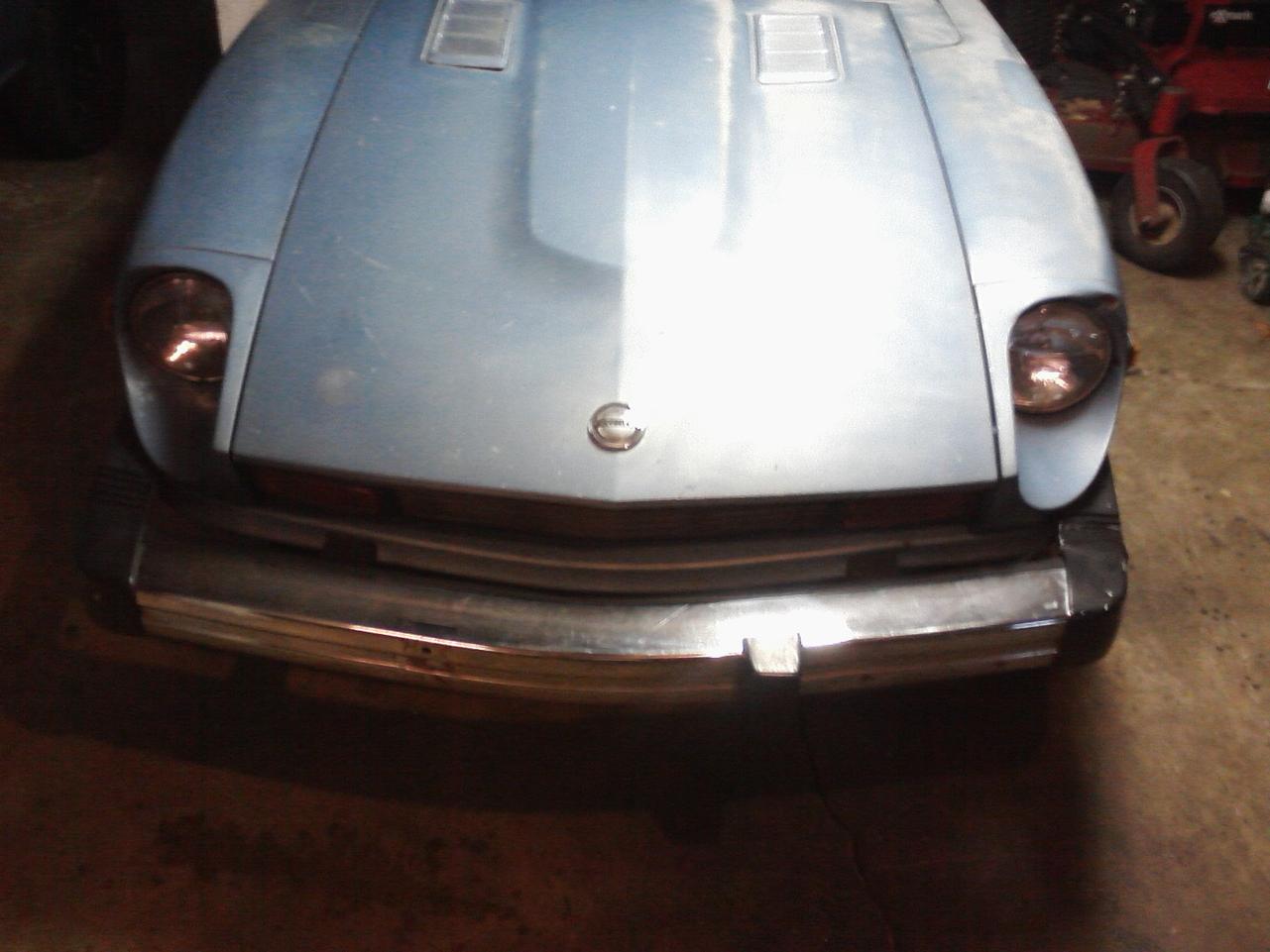

I would like to purchase and install a cold air intake for my 1975 280Z which is currently stock.  I was hoping someone would have experience with this kind of bolt-on upgrade and whether it was worth it and also if they could recommend the best manufacturer out of the many choices out there.
