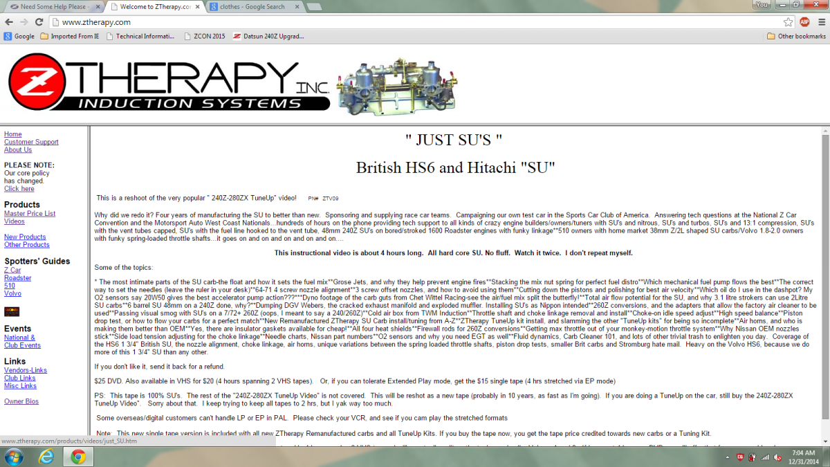

If you're not familiar with tearing down SUs, you might want to consider contacting Bruce Palmer at Z Therapy for the Just SUs video.

Thanks.  Is there any way to unstick short of tearing them apart?  Z Therapy sent me these carbs (years ago)
