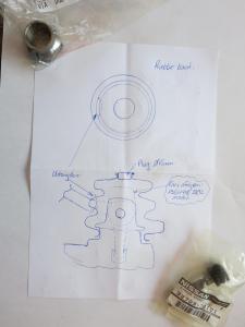

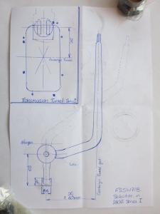

I helped a friend do this on a series 1 a couple of years back. The car has since been sold and I don't have any photos, but I did make some simple drawings of the modified shifter.
We made it according to the drawing, but it required some minor heating and tweaking after to get it centered exactly in the middle of the tunnel opening.
Do yourself a favour and buy new bushes for the shifter. You will feel the difference.
2x http://www.courtesyparts.com/bushing-p-345116.html

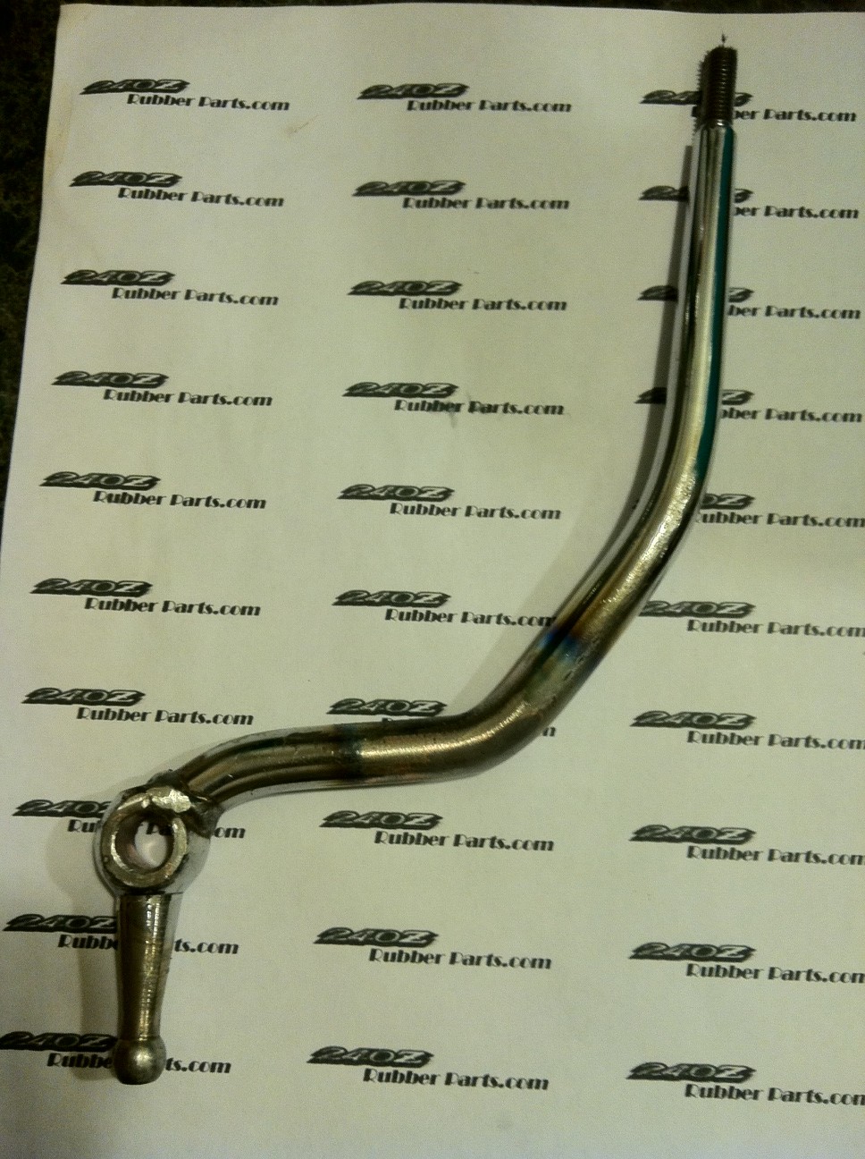

I did a mod to my shifter today for the later style transmission into my 71. 20 years ago I replaced my transmission and I just cut the console.
I found a pic of a modified shifter for my setup, so I set up a jig and did the modification.
