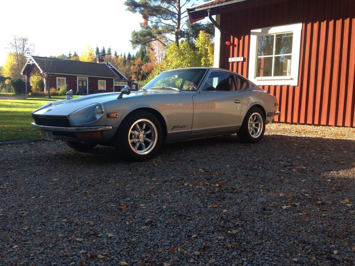

I have a L28 n42 with early e88 head. Don't know much about it. Runs strong. It also have electronic ignition, headers and a 2 1/2 system.
The cost of new mikunis or webers are very high and after i had talked to a guy that races and wrenches old rally cars I went for a weber replica called Fajs. He claimed that they are really good and almost all weber parts fit this carb. Lookes the same to.
I went for 45:s, cost of around $750 for all three here in Sweden. New webers would have set me back $1600.
Then I bought a harada shokai intake from Japan.
Patcon, i dident see that! But i trust the guy i talked to so we will see if it workes or not. If not ill buy the webers and sell these.
Will report back. The guy that helps me install this also installes the same carbes on his 240z and he has had triple webers on 240z before so he will know the difference.
