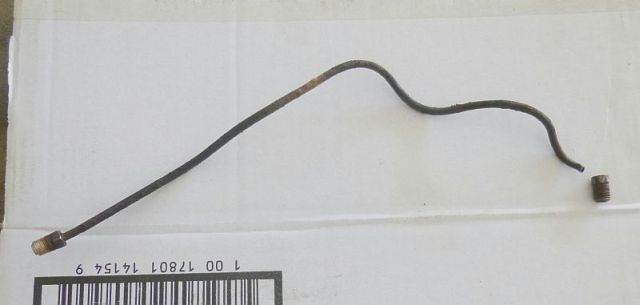

Long story short. Yesterday the right rear brake line snapped off on me while disconnecting it.
I will have to replace it and it goes all the way to the junction block in the center of car.
I likely will have to drop the differential to get at it. I will replace the other side as well as
long as I am that far. After all, they have only been on there for 43 years. Ha.
I was going to drive it to a large car show on the 16th but that may be unlikely now.
Don't have a lot of time available to work on it. Got to order the new lines now.
As a follow up I did get the old line removed from the junction block. It turns out the hard lines to
the left and right rear flex lines are NLA. I made one and worked out good. I also replaced the
original hard lines that go on the drum backing plates. Those are still available.
Finished up by installing braided stainless flex lines. Have to put the same lines on the front yet.

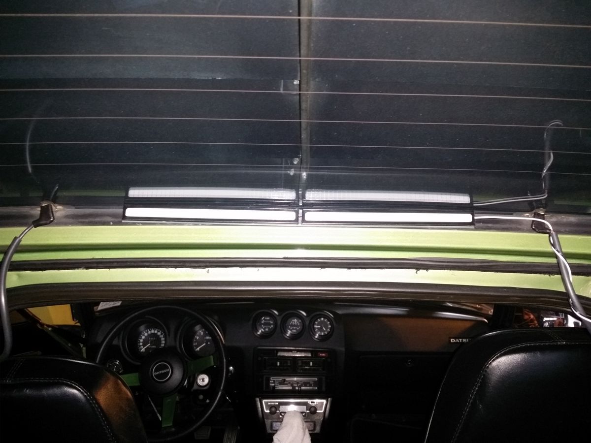

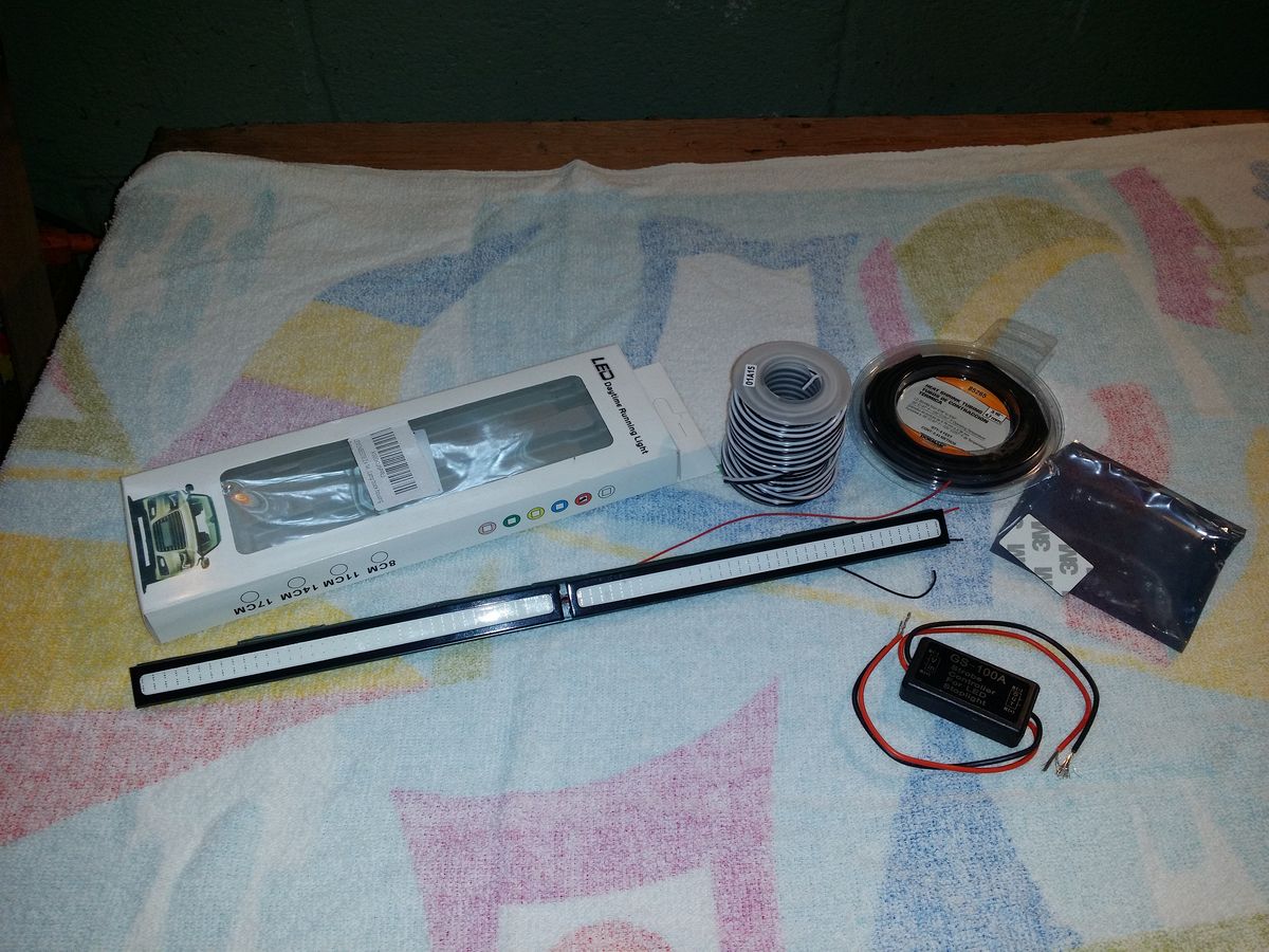

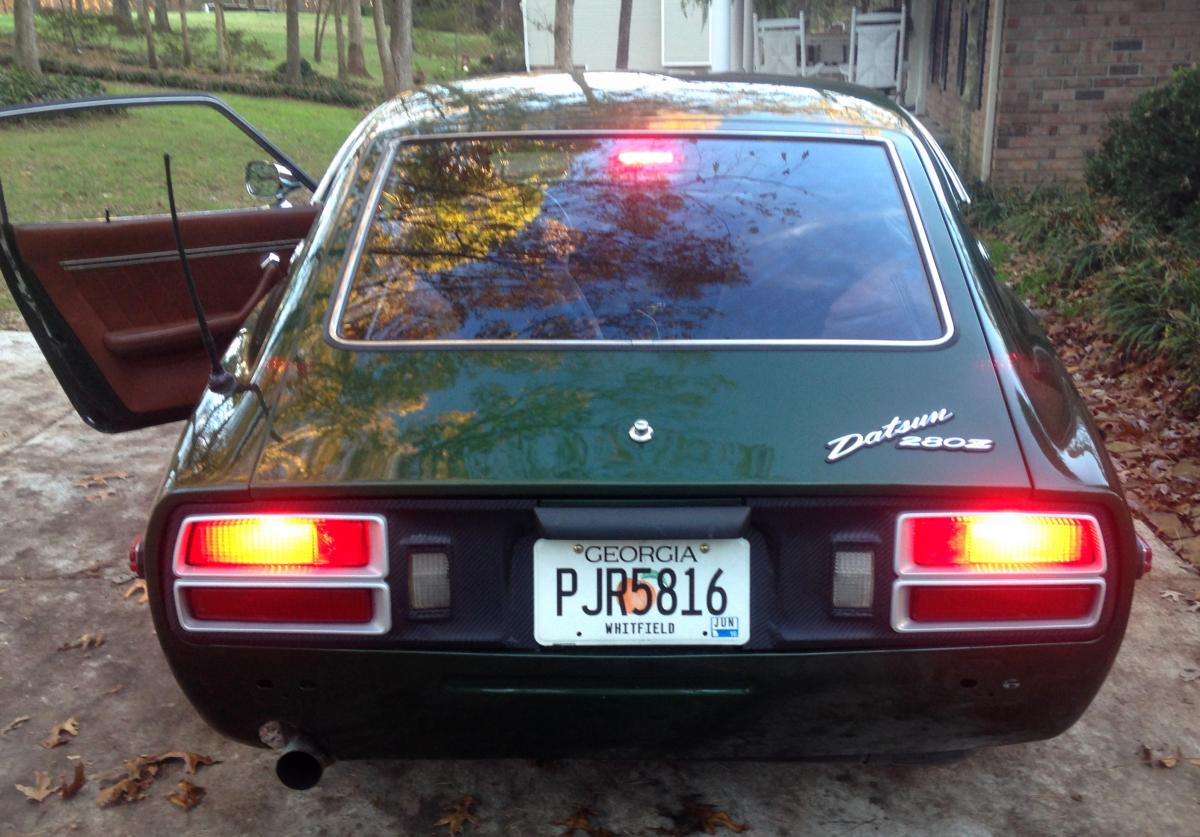

I want to wish my 76 - 280 a happy birthmonth she was born in November 1975.  She is 40 years old and only has 51K miles.
For her birthmonth I add a third light or center light.  Here is what I used.

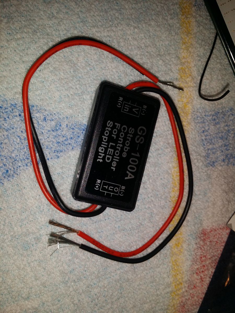

2PCS LED Daytime Running Light 2X6W 17CM COB Bulb Car DRL Driving Lamp RED DIY  found on Ebay for $14. CARCHET Flash Strobe Controller Flasher Module for LED Brake Tail Stop Light  found on Amazon for $4.55
The strobe controller strobes 3 or 4 fast and 4 slow flashed and then full on.  Here is a video, Utube.
I mounted them on a piece of "L" shaped aluminum and drilled a hole in the middle to pass the wires through and added the strobe controller at the far end.  Soldered the wires from the controller into the right tale light.  Black wire was easy, the other was a little harder my two wires coming out were green-white and green-yellow, used the green-yellow.  No plastic panels needed to be removed.  I used the "L" on top cut in three 1 inch pieces (one left and one middle and one right) and slid tham under the rear window rubber and the glass.
