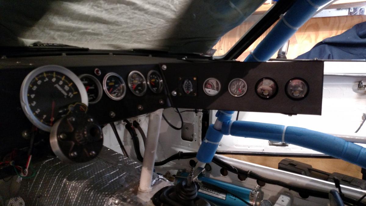

I was supposed to clear the snow off the roof but after hearing the news about Mr. K's passing, the only thing to do was to get back to work on the Z.
A dual EGT (#2 & #5 header pipes), a fuel pressure, tranny temp and two O2 sensors gauges. All to better know when to hit the kill switch before the whole engine is toast.
