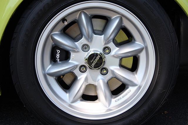

I bought some 15x7 Konigs with hankook 205/50-15 that are fantastic on my 240. No rubbing and leaves the car lower to the ground.
15's wouldn't fit my car unless they had a +25mm offset. I ended up with a set of 17x8.5-0 RKR-F's... Will see my options work out with tires now.

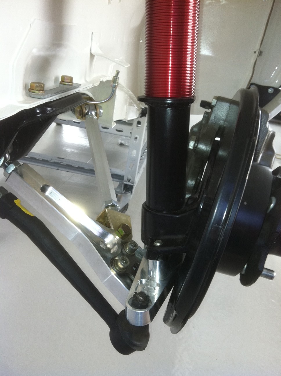

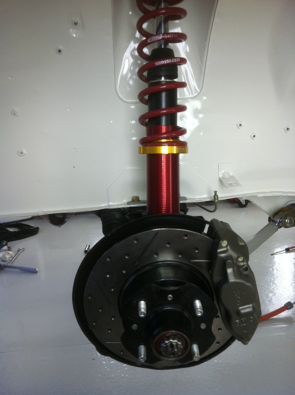

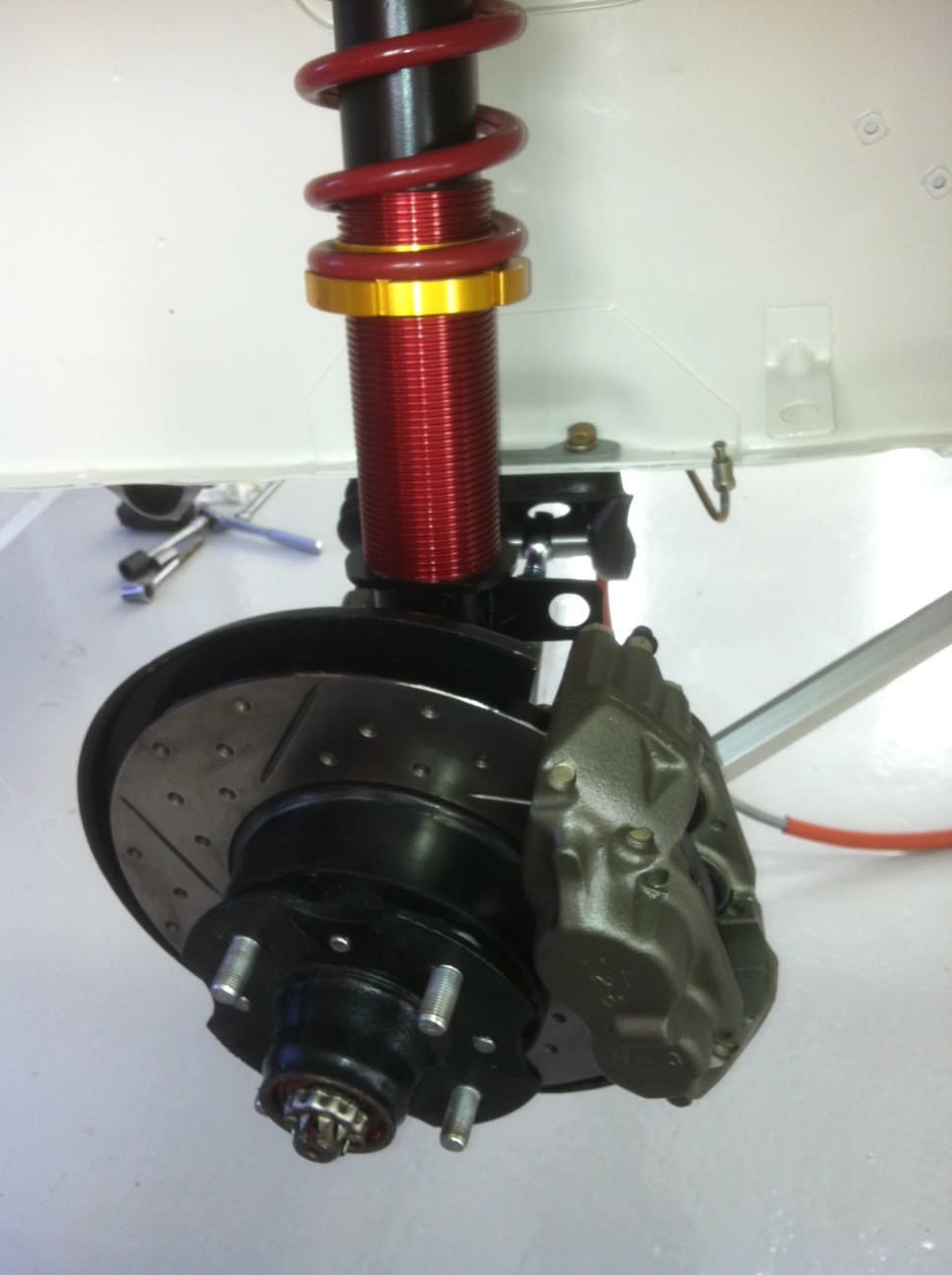

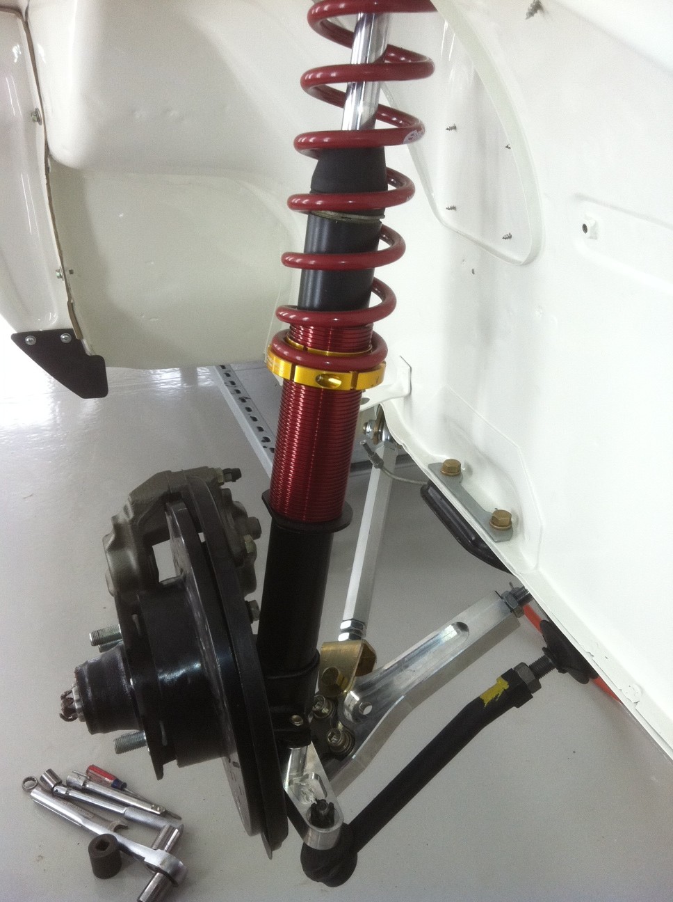

New coilovers, Tokico Illuminas, R1 Concepts rotors, bearings, seals,  calipers, Arizona Z car suspension, tie rods, 555 ball joints  and plated all the hardware.

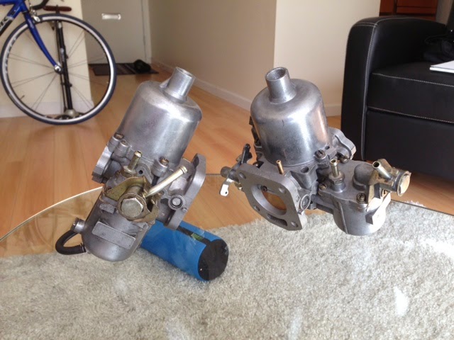

Cleaned and rebuilt my first set of carbs.  Today we see if I did it correctly and I get to start it up.  With the new MSA premium exhaust on stock manifold!
