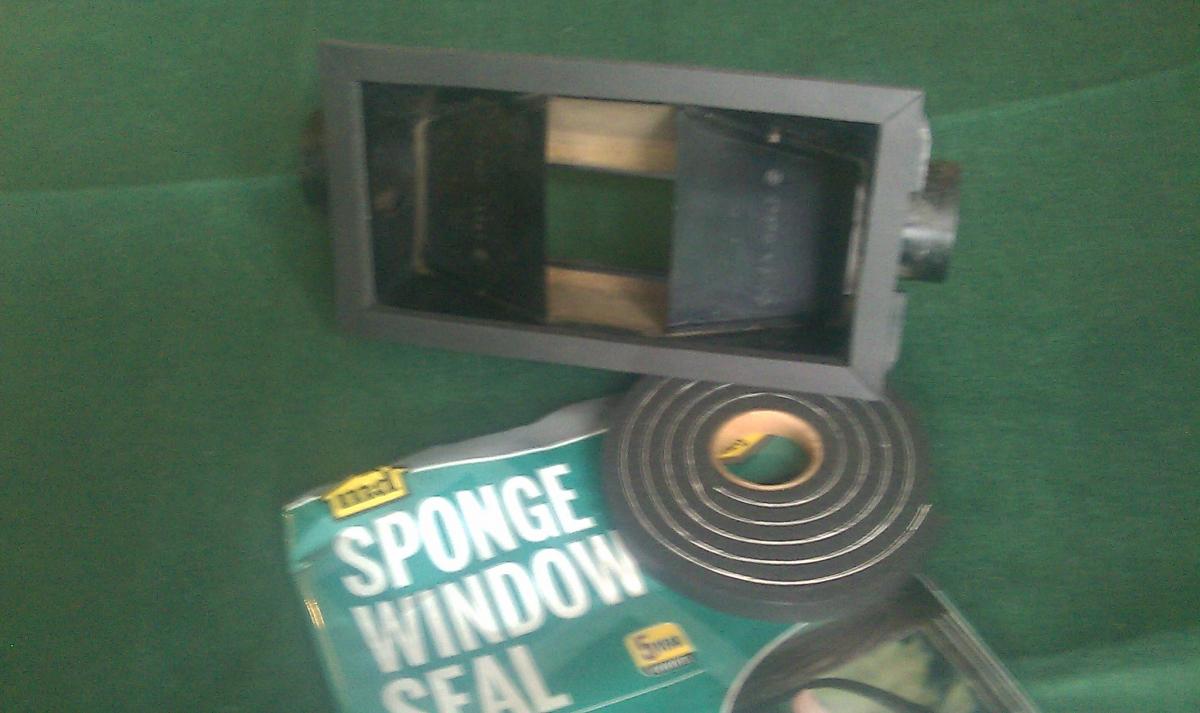

When I was in the dash area doing my lighting refresh, I noticed the foam seals on the vent diffuser were shot.
Picked up some 1/2" window seal at Lowes, has nice memory foam.  Cleaned & replaced the seals.
Another "while I was in there deal".

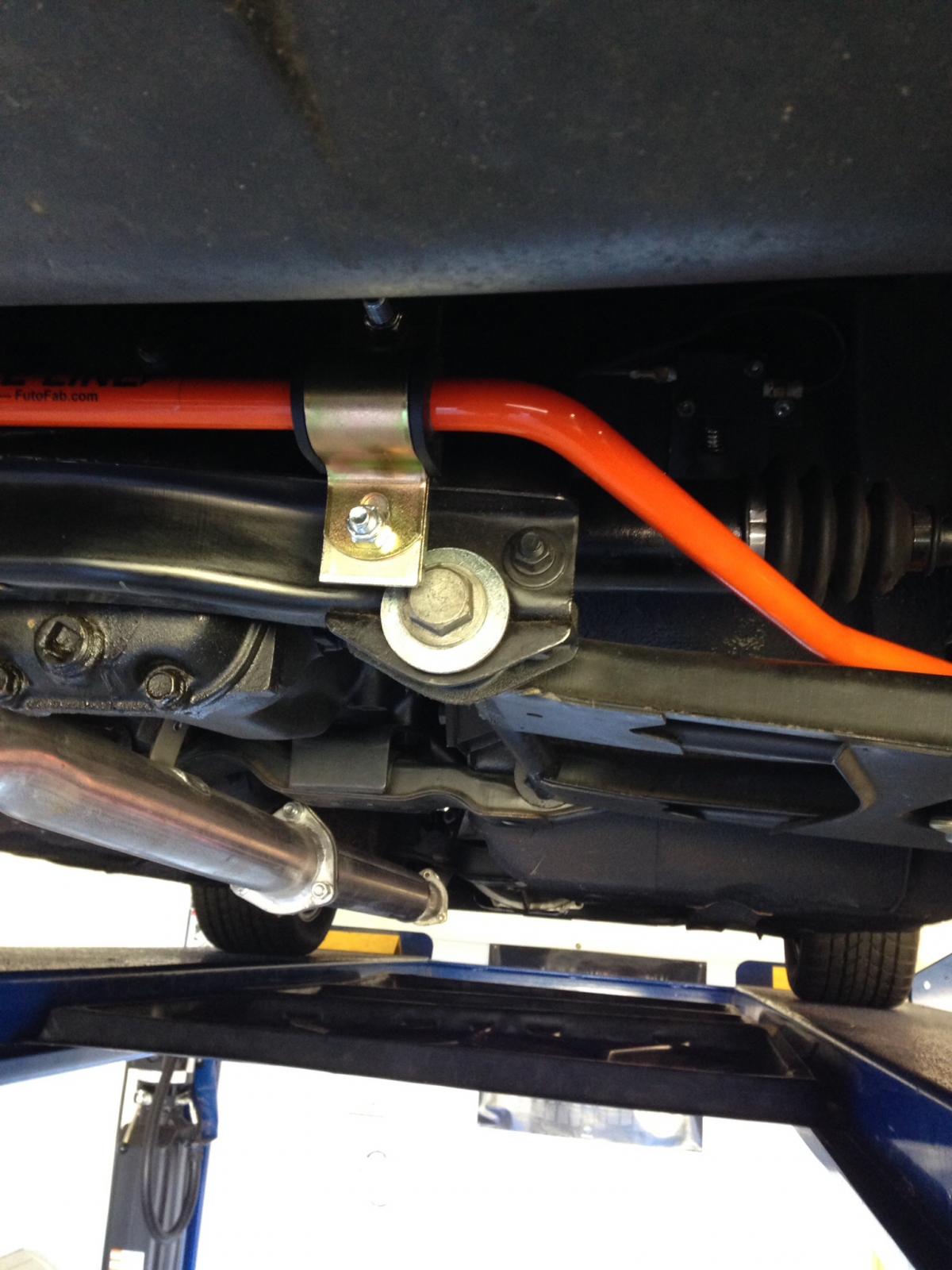

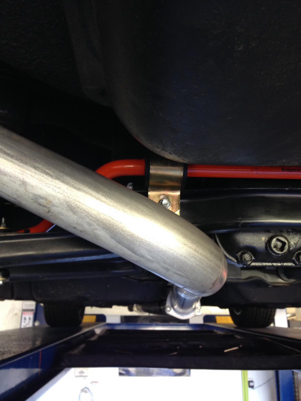

I read a lot of posts claiming these cars handle better without a rear bar. I'll be putting mine on next week hopefully. Did you need to drill any holes for mounting (assuming it wasn't equipped with one, prior)?
You have to drill two 3/8 inch holes. I bought a 9 inch drill extension to drill the holes. If you go on the Futofab site, they show the directions in the add. The whole installation only takes about 1 1/2 hours.
