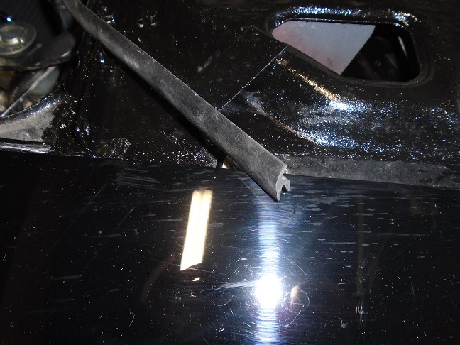

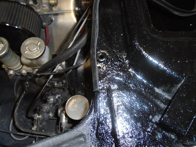

I am trying to figure out how to install the cowl weatherstrip. I take it, it gets glued down with it wrapping the metal strip? I was also wondering if it supposed to bend toward the engine or towards windshield. A photo would be much appreciated.
https://www.classiczcars.com/forums/topic/50776-hoodcowl-weather-strip/
It's really pretty simple.  The new replacement weatherstrip is glued with weatherstrip adhesive as opposed to the original which had a long metal clip underneath it.  On my 77, the cowl weather strip bends toward the windshield.  If you are removing an original be sure to remove any rust from the original metal clip.  Hope this helps.
