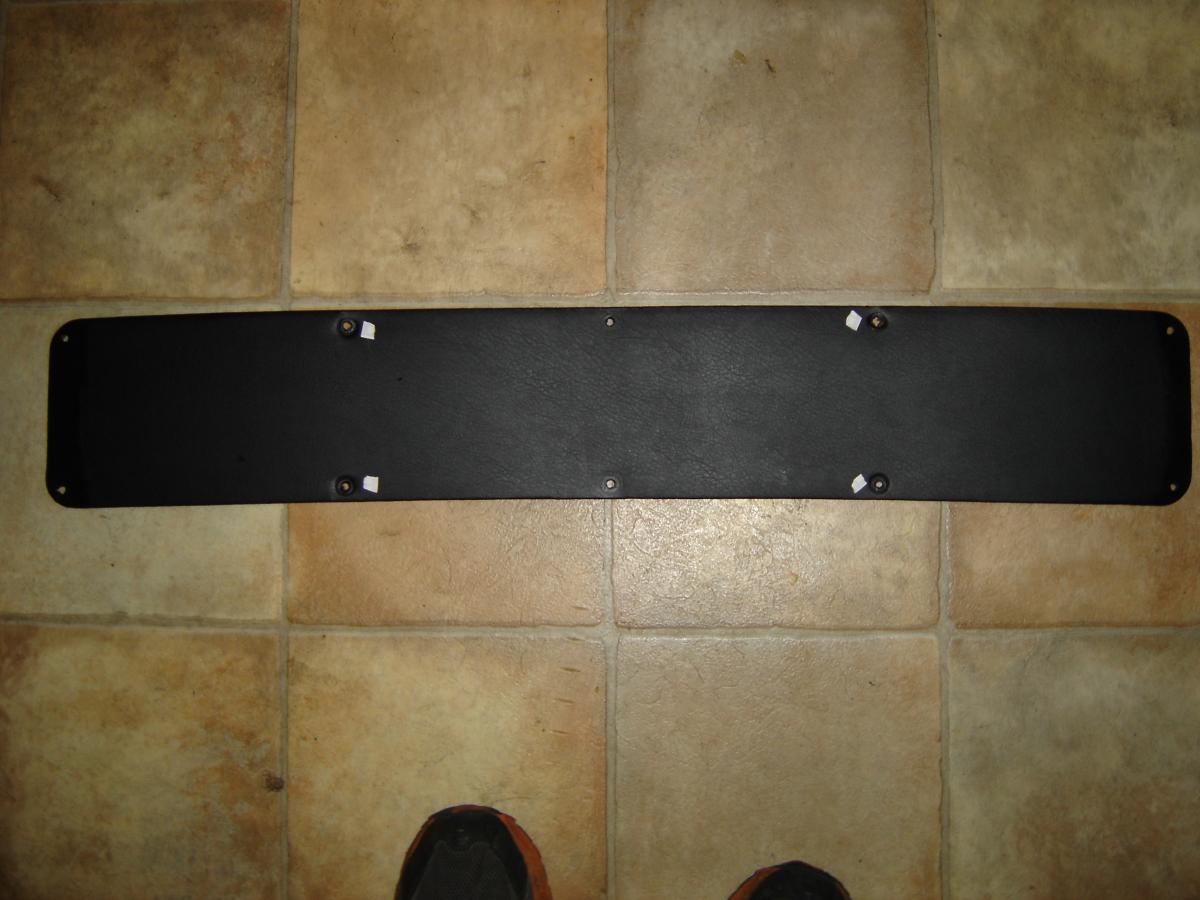

My 02/'72 has the four screws and the plastic shanked rivets.  The very center 2 are rivets the next 4 going towards the outer edge are the screws and the outermost 4 are rivets.
FWIW I'm the 2nd or 3rd owner and it has been off when new to install the rear spoiler.
The small pieces of paper are where the screws and cup washers are.
post-23570-0-94829000-1421287574_thumb.j
siteunseen has the correct sequence in the picture. The sheet metal style screws with cup washers thread into spring clips that go over the holes in the hatch.

My 4/71 one owner Z has not had the panel removed since it was originally installed in Japan.  The fasteners are six plastic rivets same as used to hold interior plastic panels (one in each corner and two in the middle edges as in the picture in an earlier post) and four black Philips head screws in black cup washers in the positions shown in the earlier picture.  I wonder why they used screws and rivets instead of one or the other - preferably screws as I've had three or four rivets pop out over the last 44 years.
