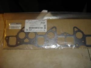

Finally found the head gasket that best fits. It is part number 11044-N4221.
It is stamped with the Nissan logo with the code NRZ 46F. NRZ stands for Nippon-Reinz and is made in Japan.
The firing oval ring measures 89.5mm x 87mm and features the same water passage holes that my original head gasket had.
This the best head gasket I have seen for having the same contours as the original.
Thanks for all your contributions!
Oddly enough I did not get it from Nissan, but it does have the Nissan logo on it, with the packaging labeled JMNR High Performance Engine Gasket Made In Japan.
The parts guy had 2 on the shelf, so I bought both. I am happy to give to the other one to you at cost if you want it.
