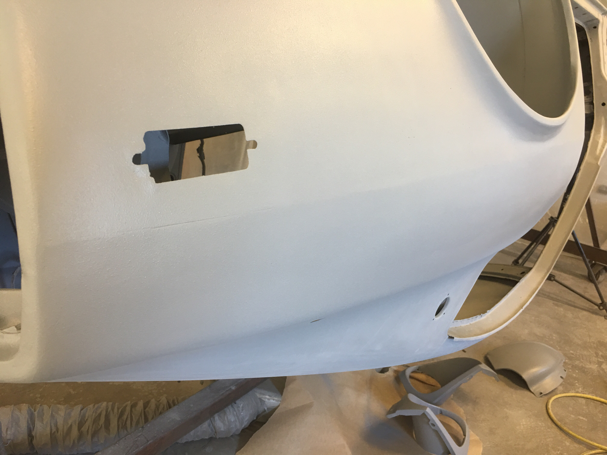

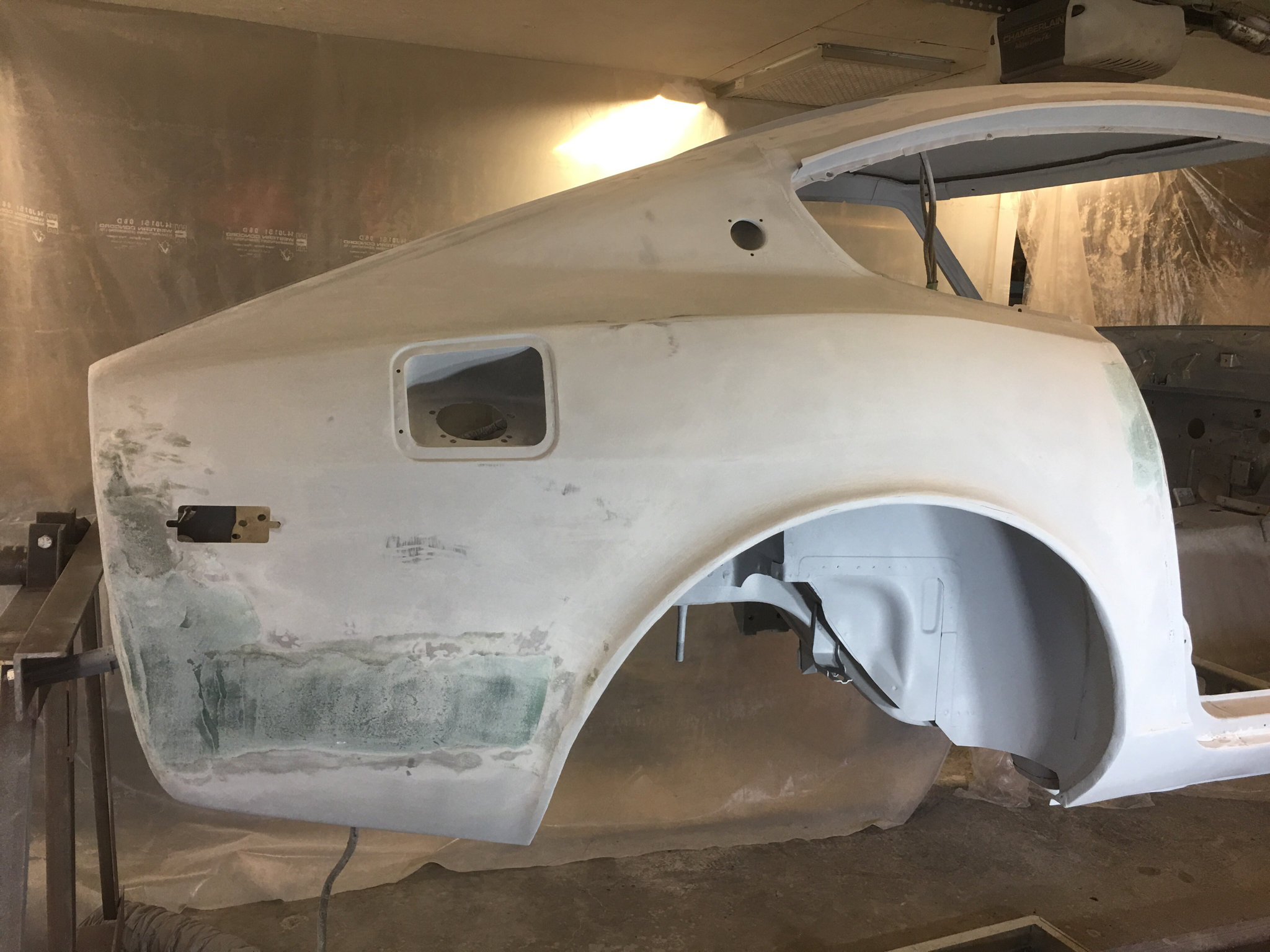

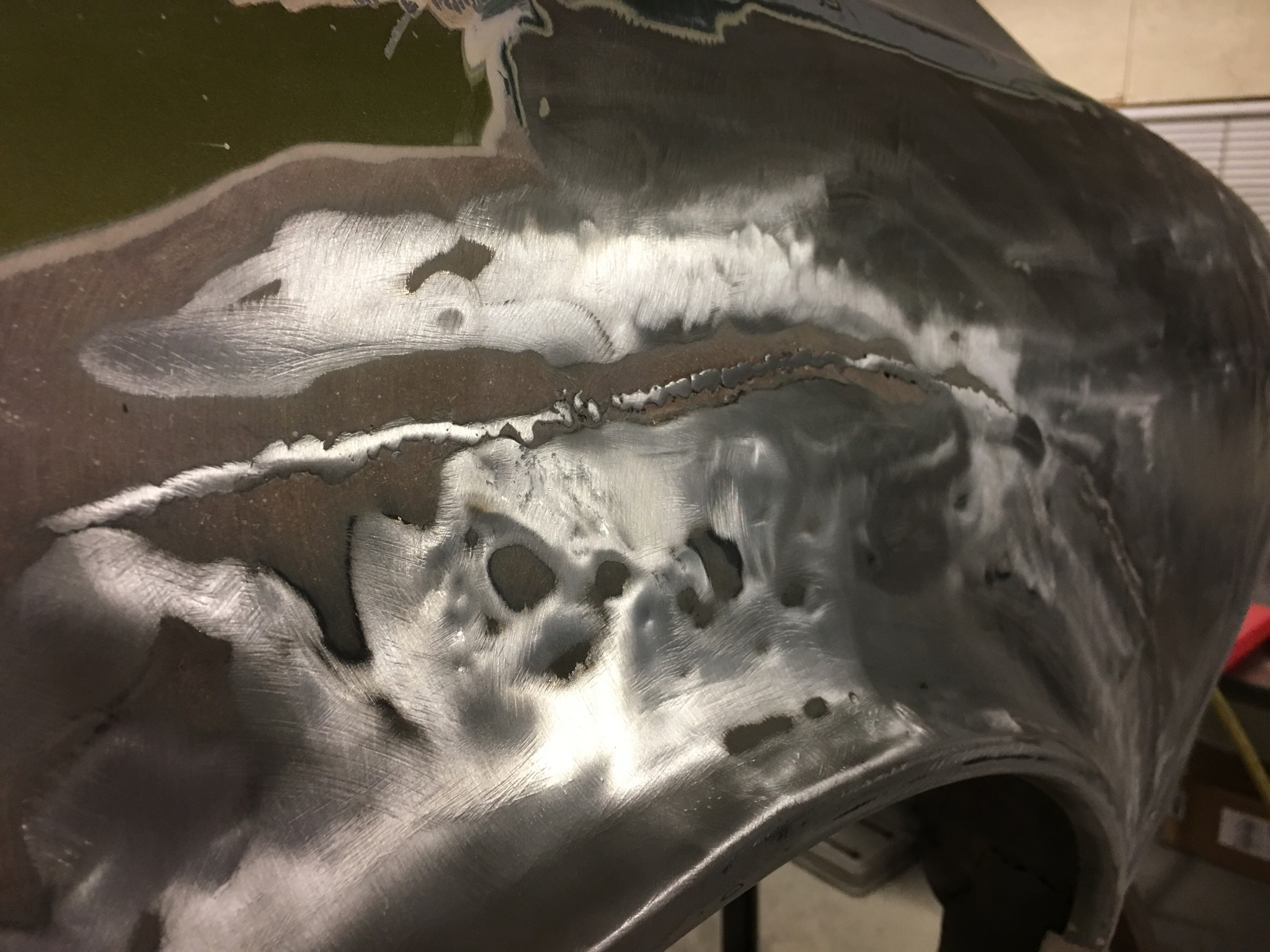

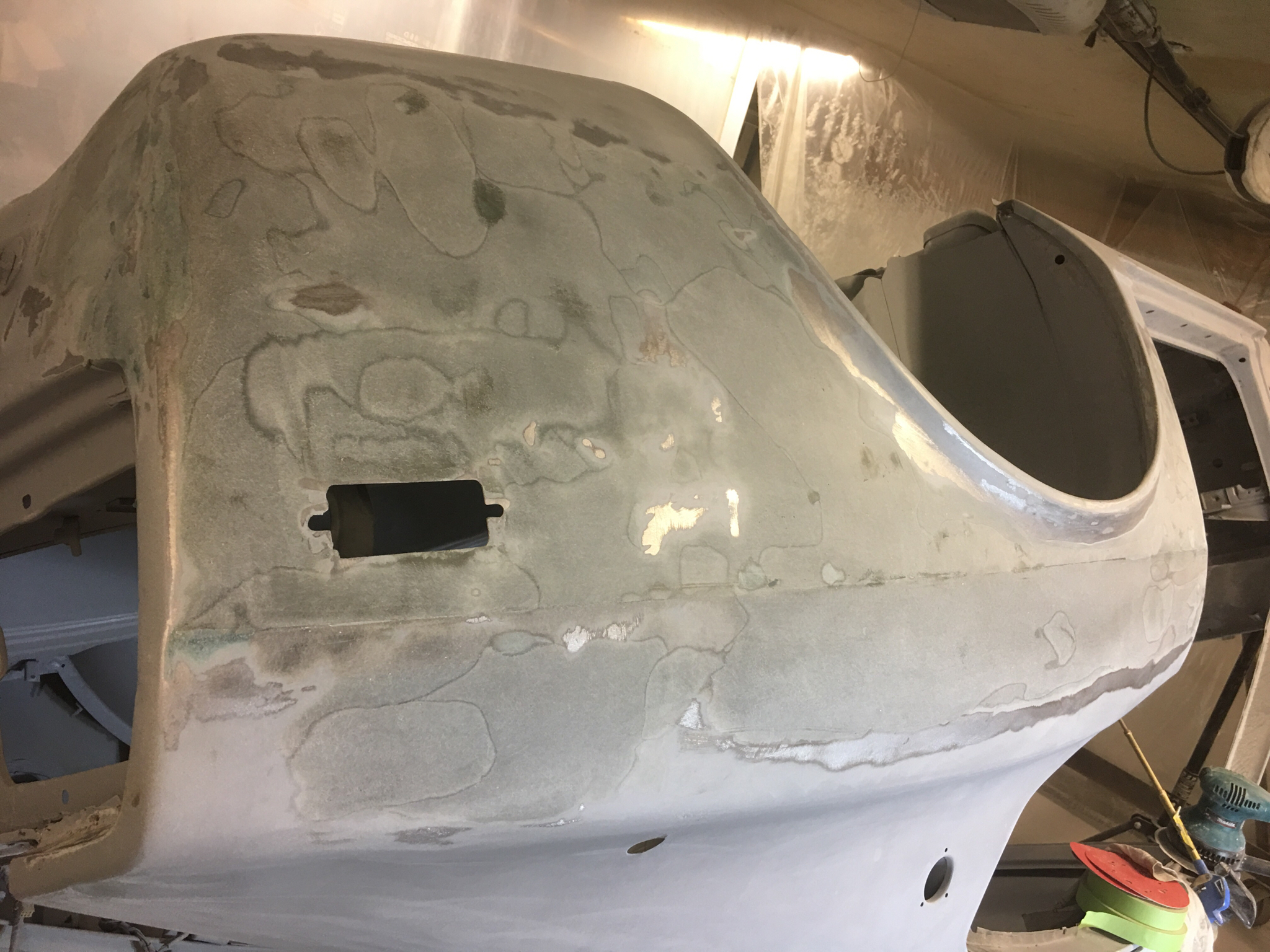

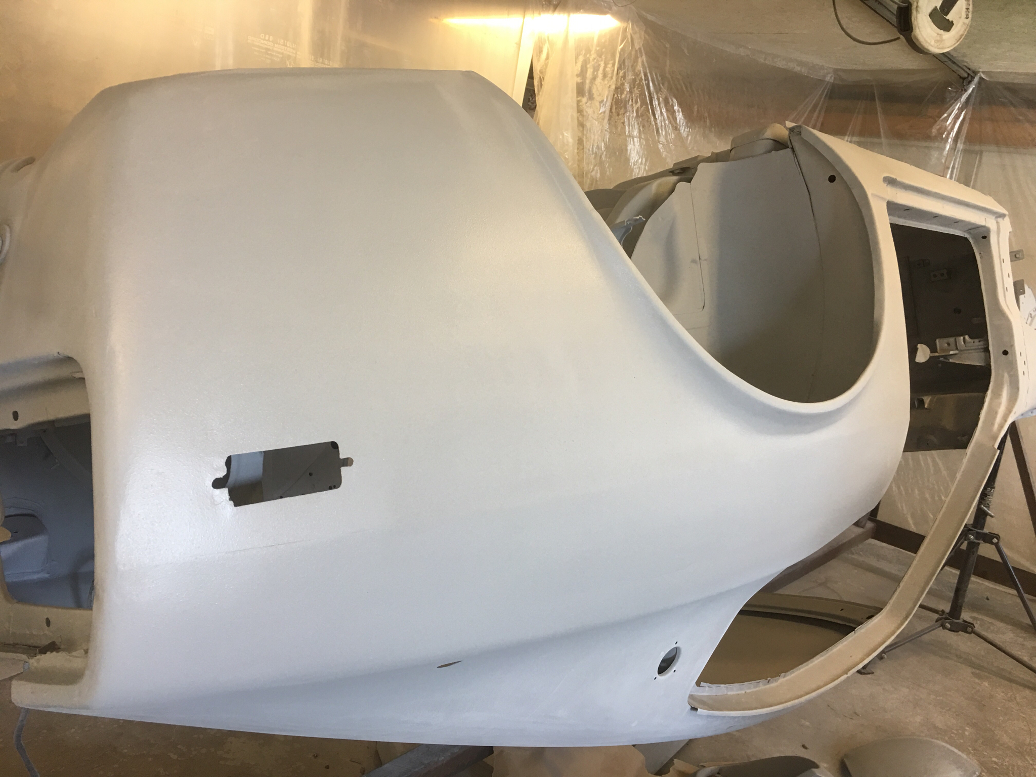

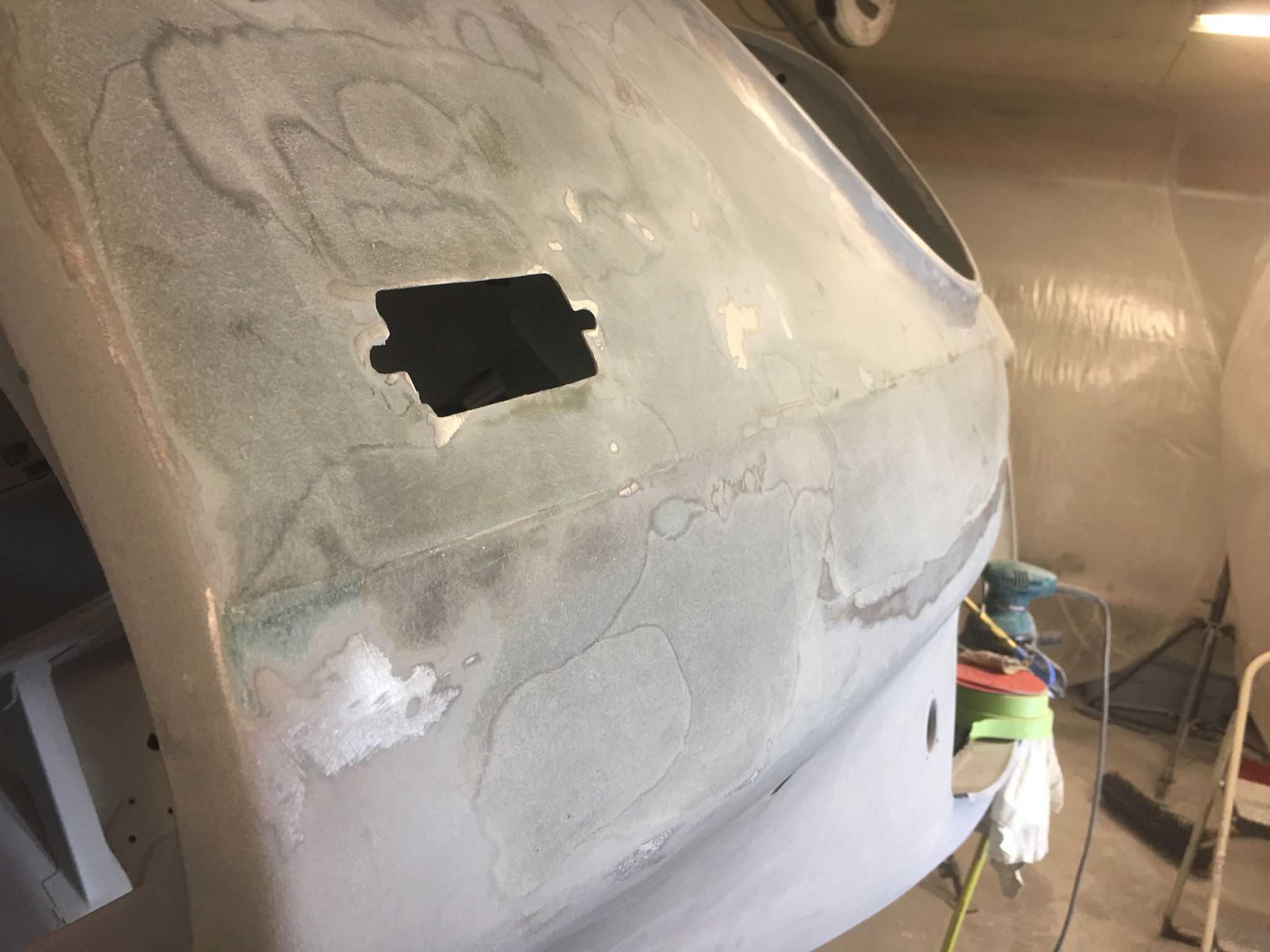

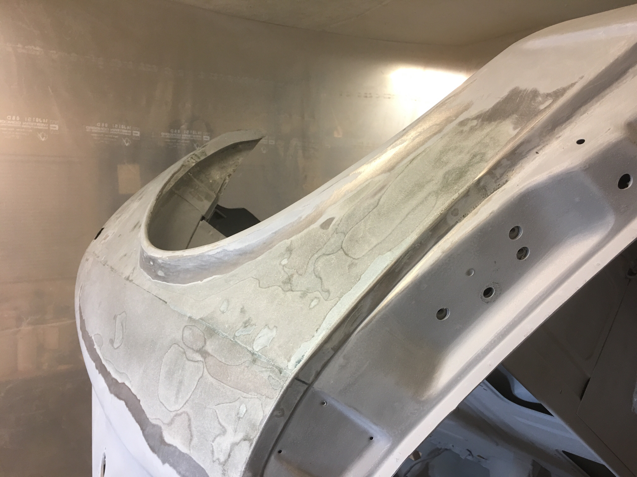

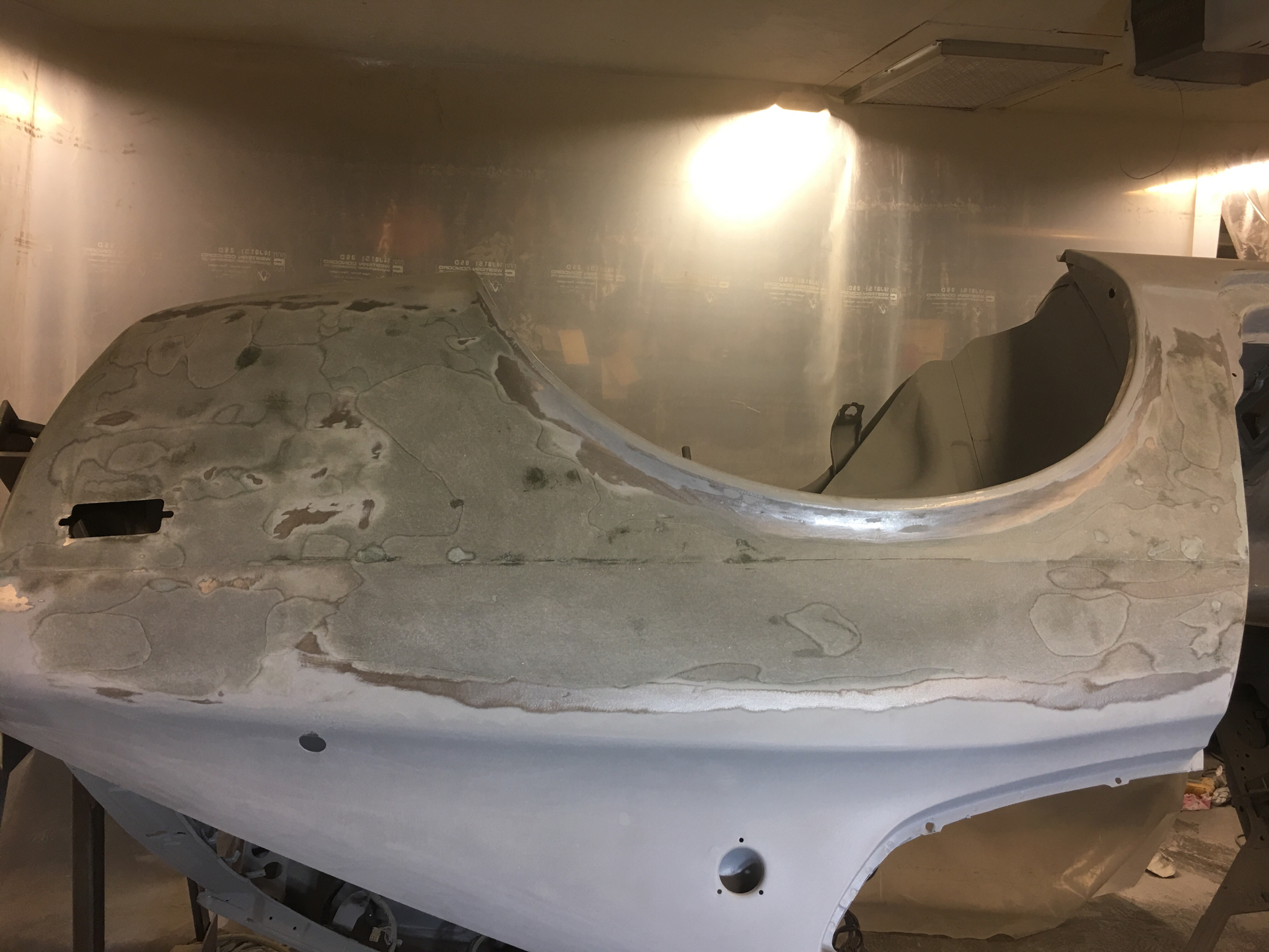

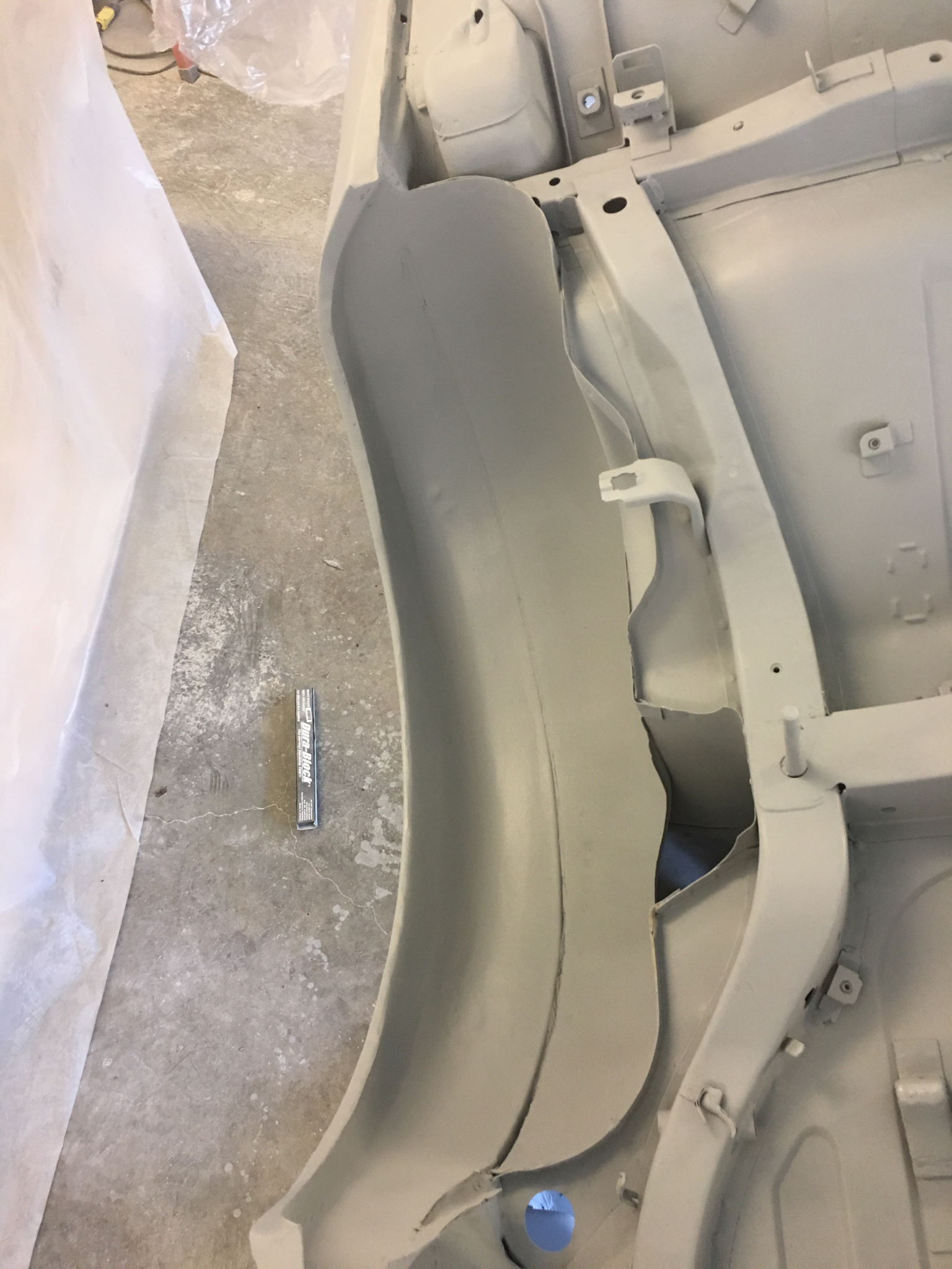

The reason for the fibreglas filler is that I wanted to ensure all weld points were sealed and waterproofed. After that, some welds were brutally done along with shoddy repairs to the quarter panel. I did not want to cut a new panel in so I am patching with fibreglas. The new products may be better than I remember, but I will do all the finish work with either a hi build spray filler or professional bondo.

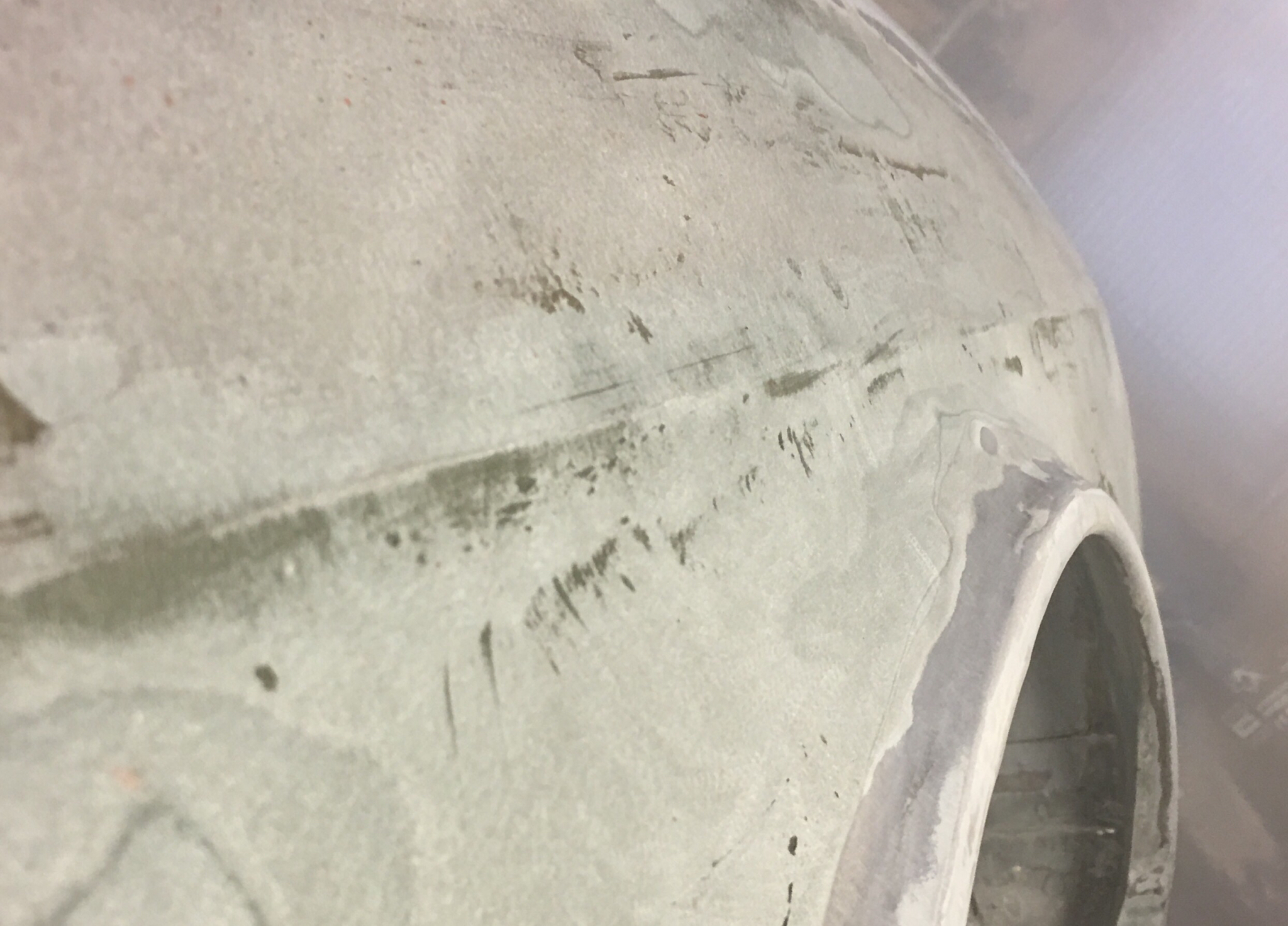

Sample PO repairs:

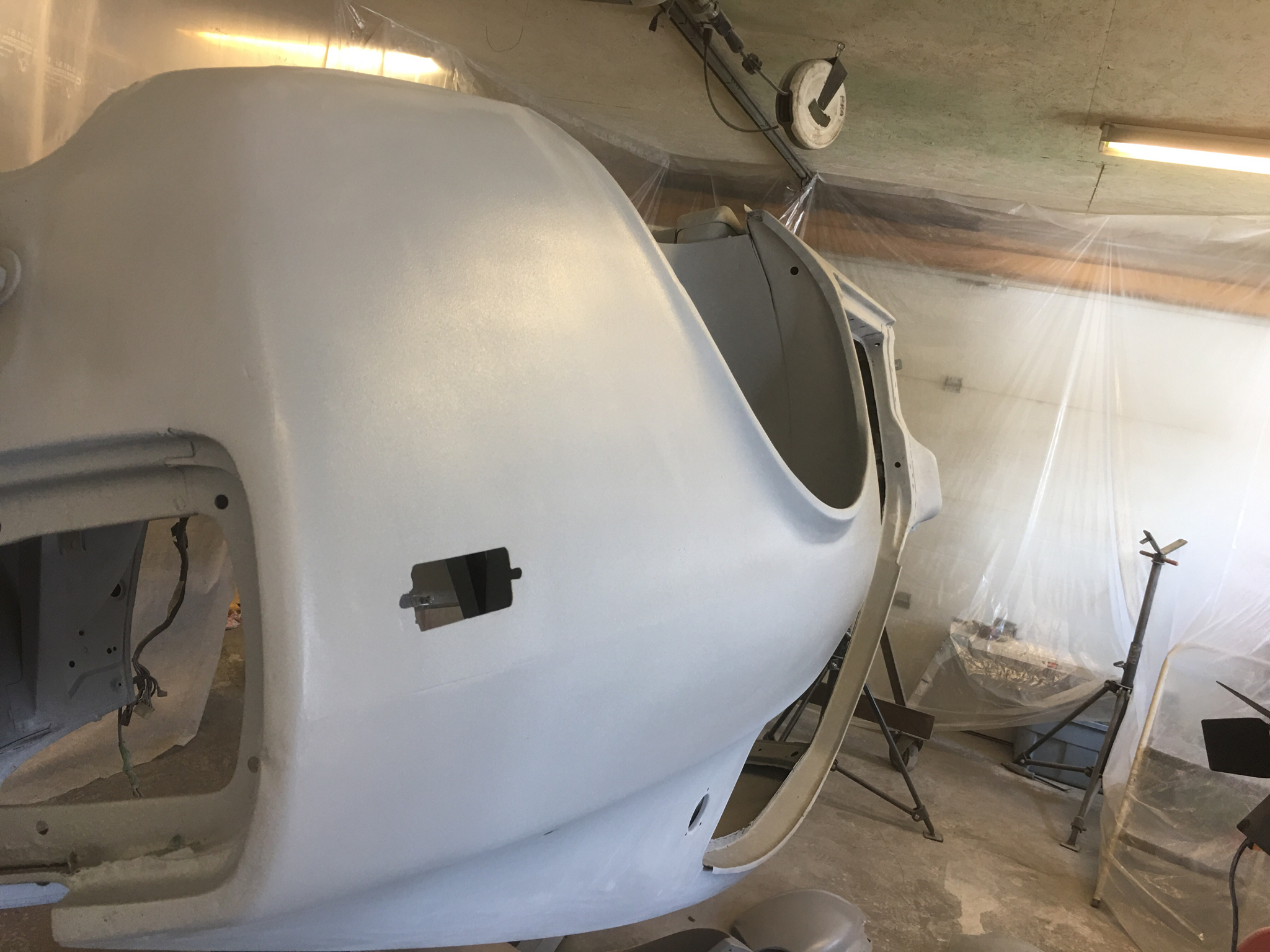

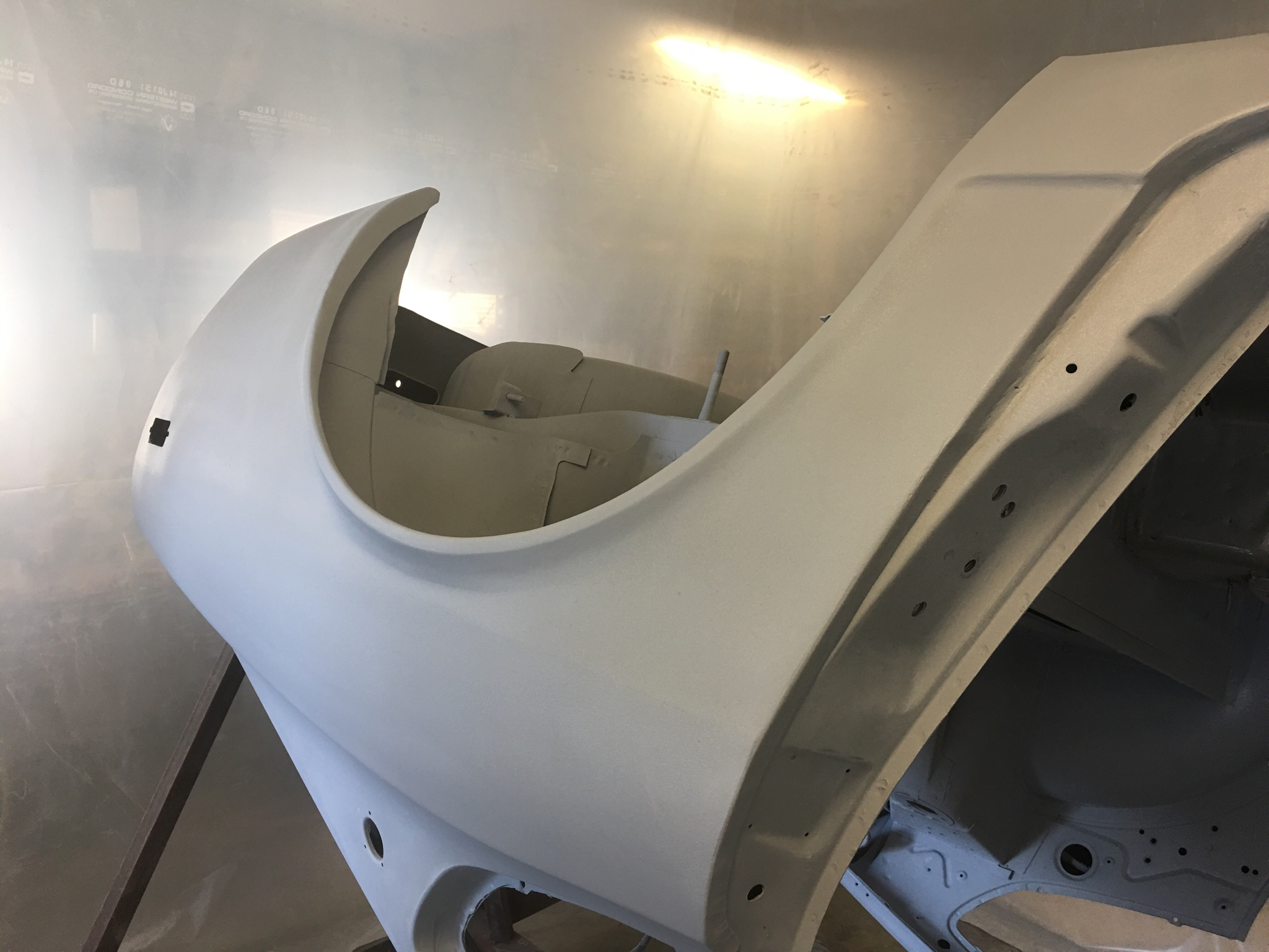

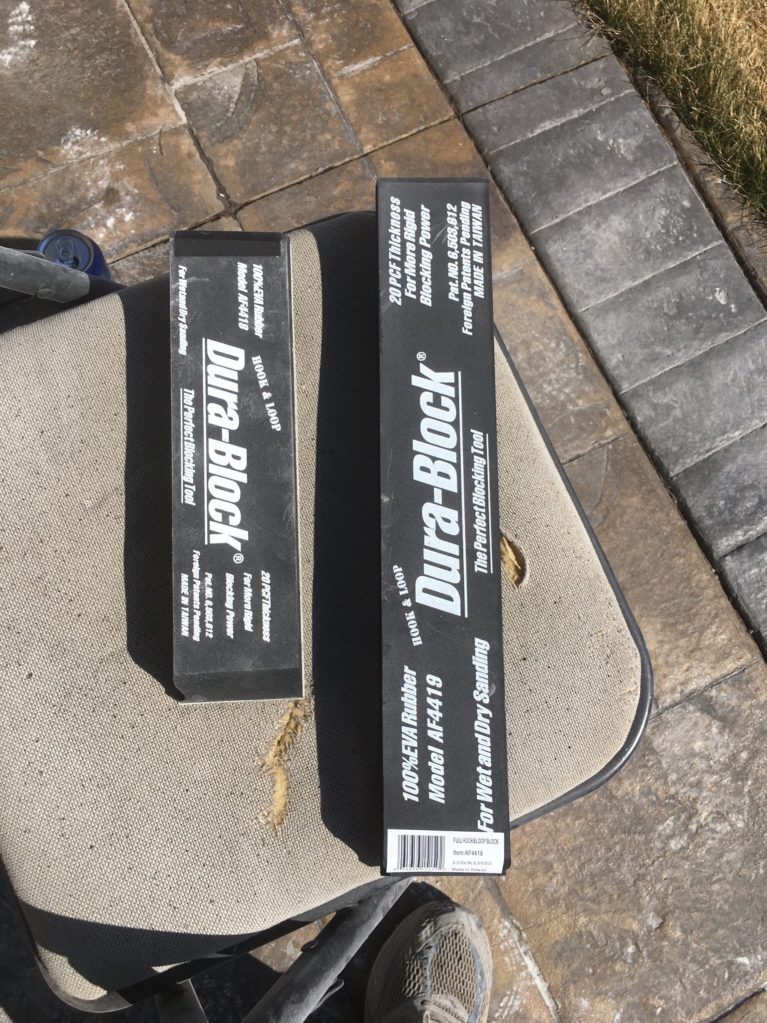

That looks really good.  I'm assuming you have some good long blocks for that line.  At this point you should put on a guide coat and see how things are coming.  It's hard to pick up detail with all the fill lines and general blotchiness.
