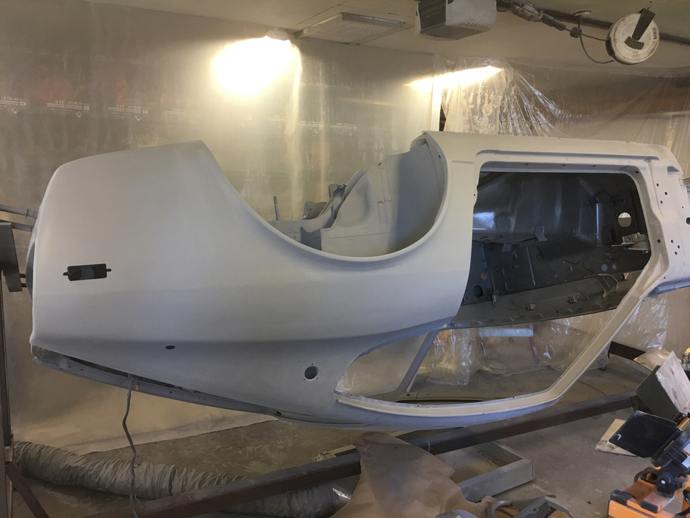

i dont know how the us dollar measures against your currency, but iirc, i paid about $30 for a container of guide coat. i used 1 and had too buy a second, but still have most of the second left.
Fresh air vent on the roof in the picture comes in from the eaves, not the rafters and you can see the filter on the roof in the pic. Exhaust air pan under the car pulls out the back of the garage.
Both units have an industrial puller motor/fan installed in line for a consistent low volume flow rate.
