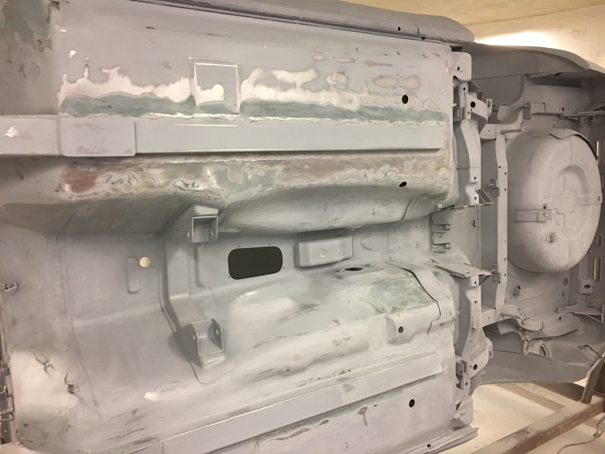

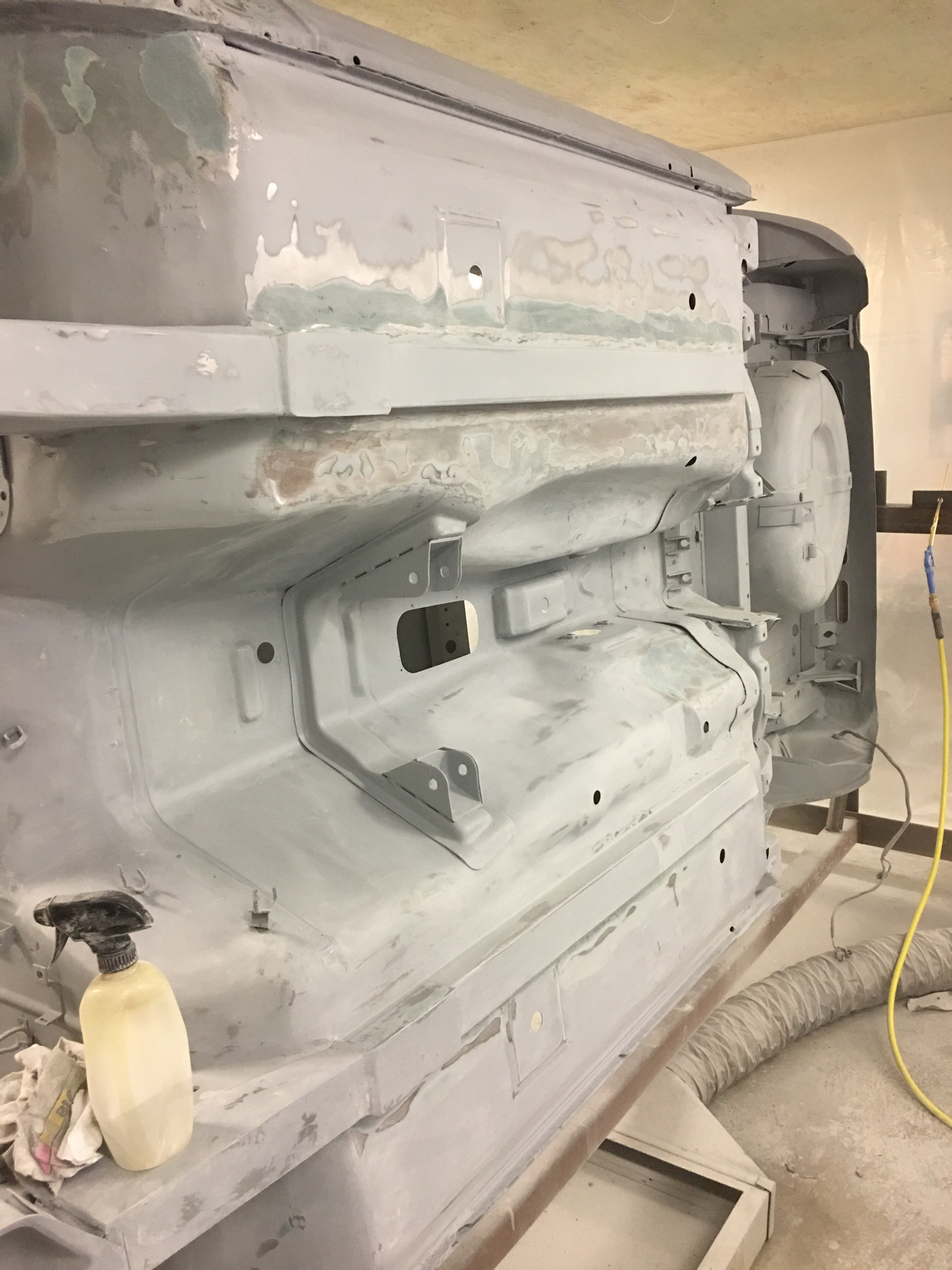

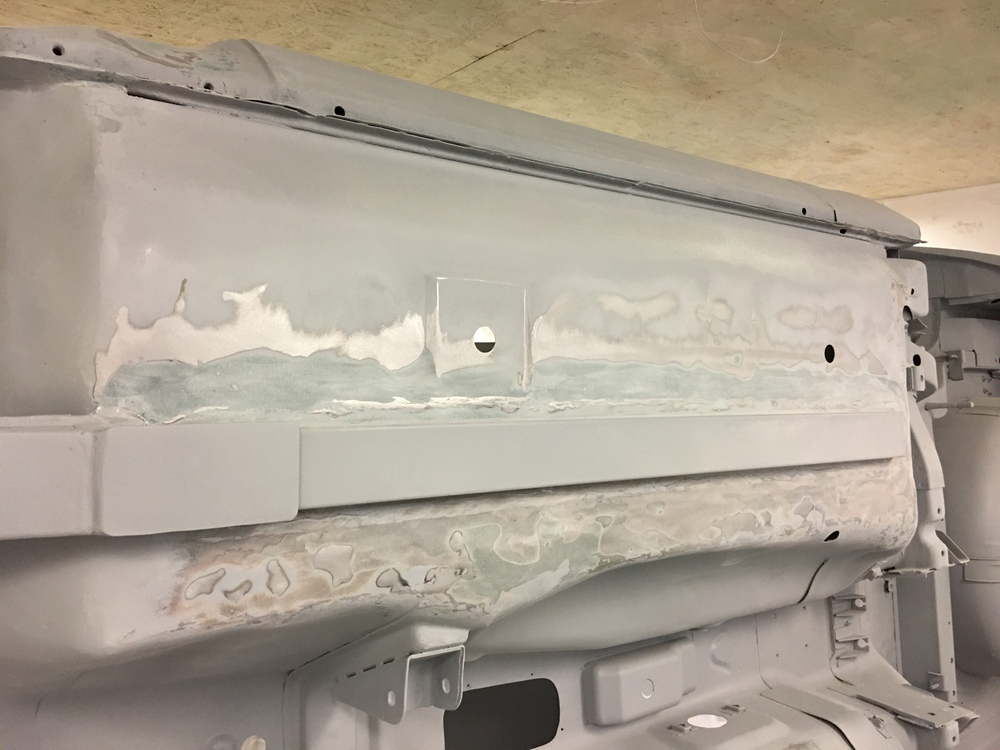

Flipped the car again tonight and did some more work on the frame rails. Decided to blend them in to the floor pans for a clean look. No reason other than OCD...! When I finish the blending, I will start the seam sealing and final prep sanding for the sealant coat of epoxy primer.
LOL The truth is, the DTM epoxy coat went on a little thick and left a fairly rough texture. I have to smooth it all out before I respray the DTM as a seal coat. I want that to go on nice and smooth so the base coat and clear look purty!
I still have some more fill work on the other side of the passenger frame rail, but nothing serious. I might do some minor pinholes with glaze to fill in the fibreglas. Way too OCD on this part of the car, I know....

I just was looking at my latest progress pictures and realized they looked the same as last time...! Doesn't look like any work has been done but I have done more sanding and added the putty coat to the floor panels along the frame rails. A little more sanding then on to the seam sealing. Then the sealer coat!
