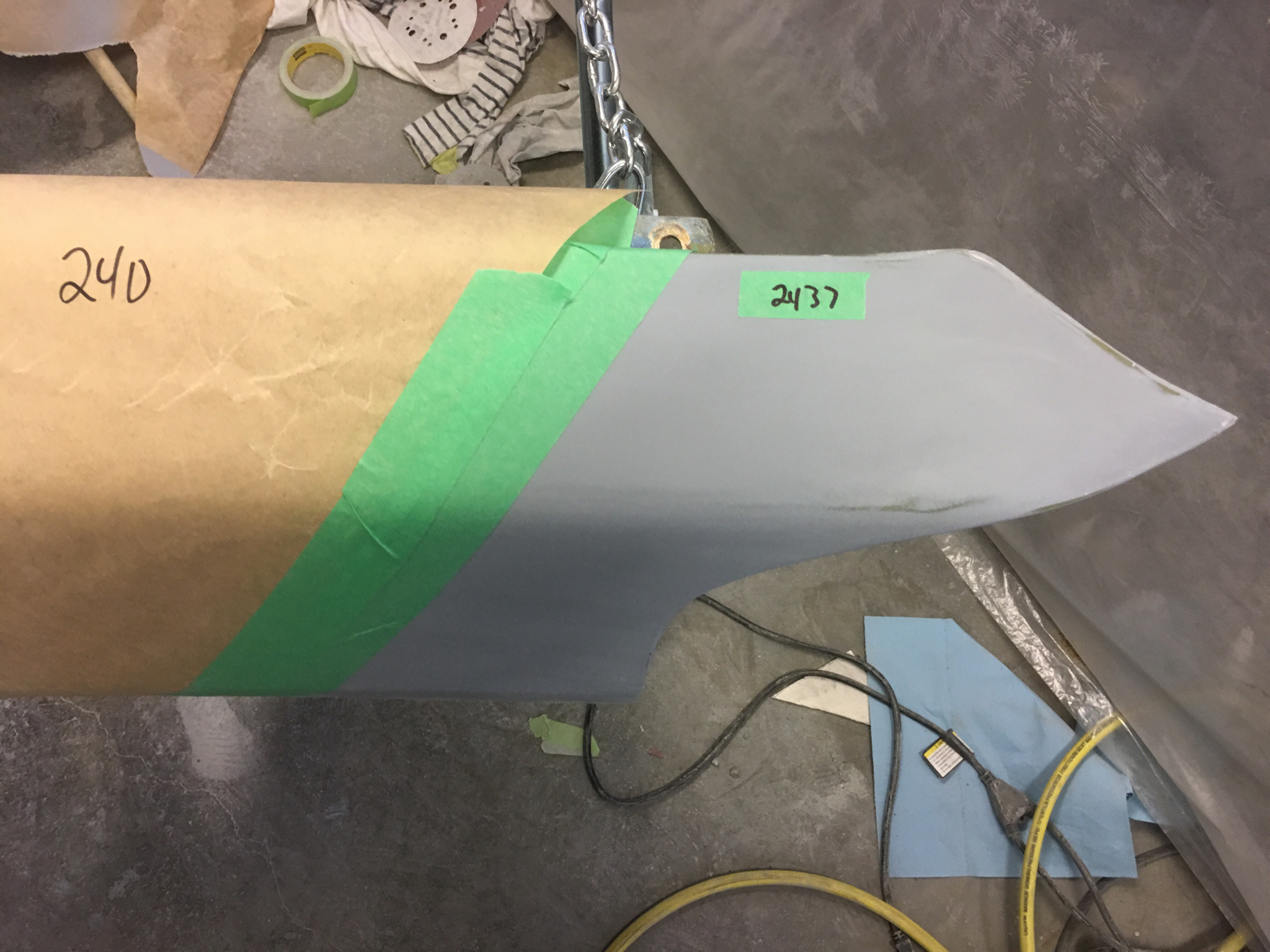

from experience, 95% of the outcome is in the prep work.

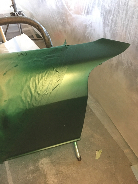

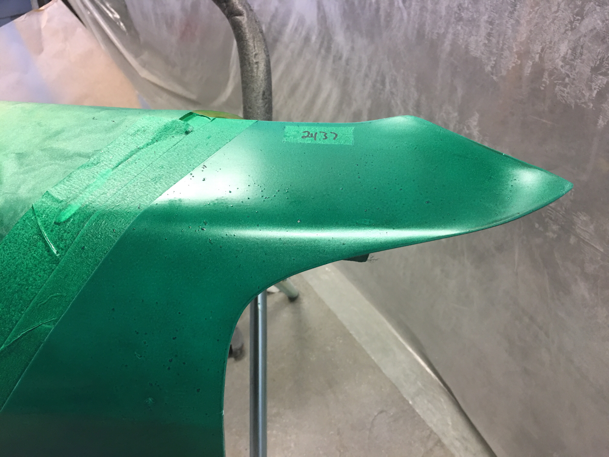

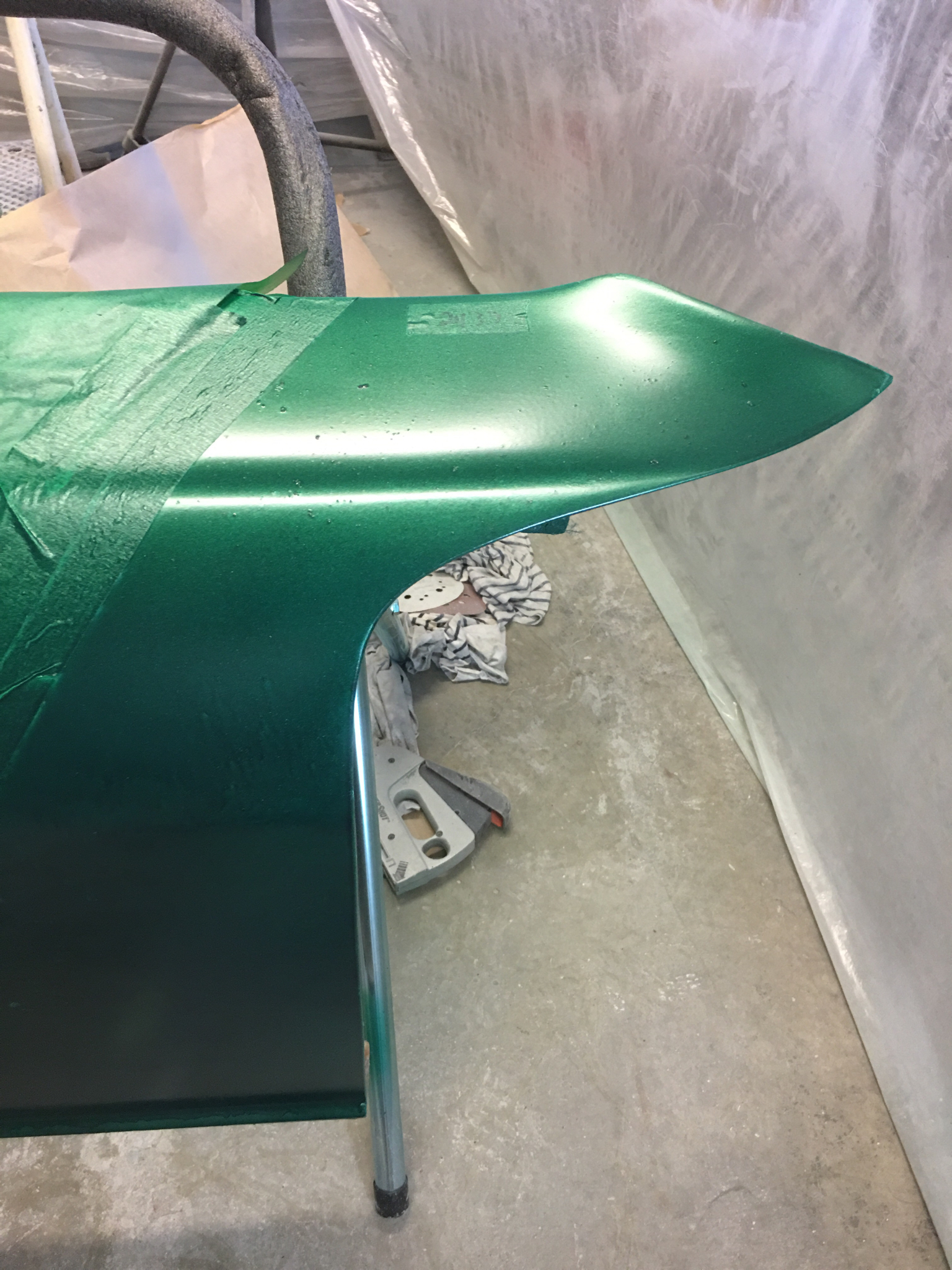

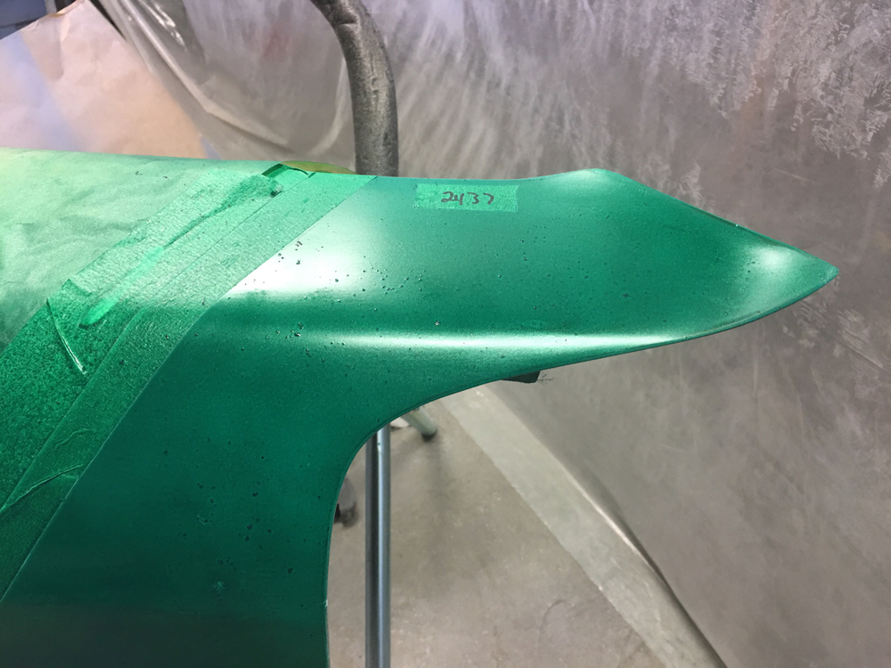

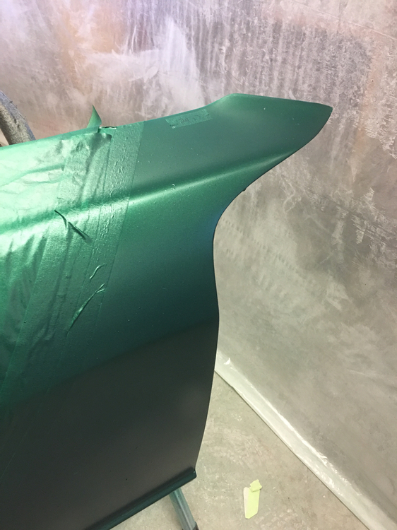

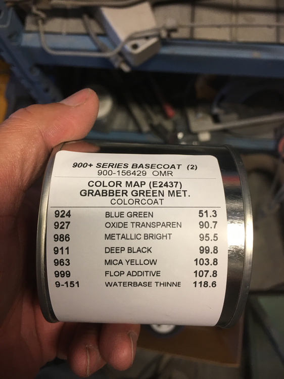

And with that, I admit a fail this evening. I prepped the panel with 600 grit, cleaned it, cleaned the gun (twice) and then decided to save a little money and not use a filter cartridge with the first paint colour. Big mistake. Blew chunks onto the panel halfway thru. Not really bad, just enough to teach me a lesson. Also had the air too high and the fan too wide. Water based sprays differently than epoxy... live and learn.
Splatter. Too much pressure and flow in the gun plus unfiltered paint (regular cup, not a 3M 125 micron cup). The finished dried panel look better but not great. I was going for colour and coverage rather than quality here. I also anticipated having to dial in the gun as I went so the following panels should get better! I didn't have enough paint to spray a lot of test patterns for the gun. Paint ain't cheap!
I'm surprised you got that much spatter.  Do you have an air dryer to take care of moisture?
