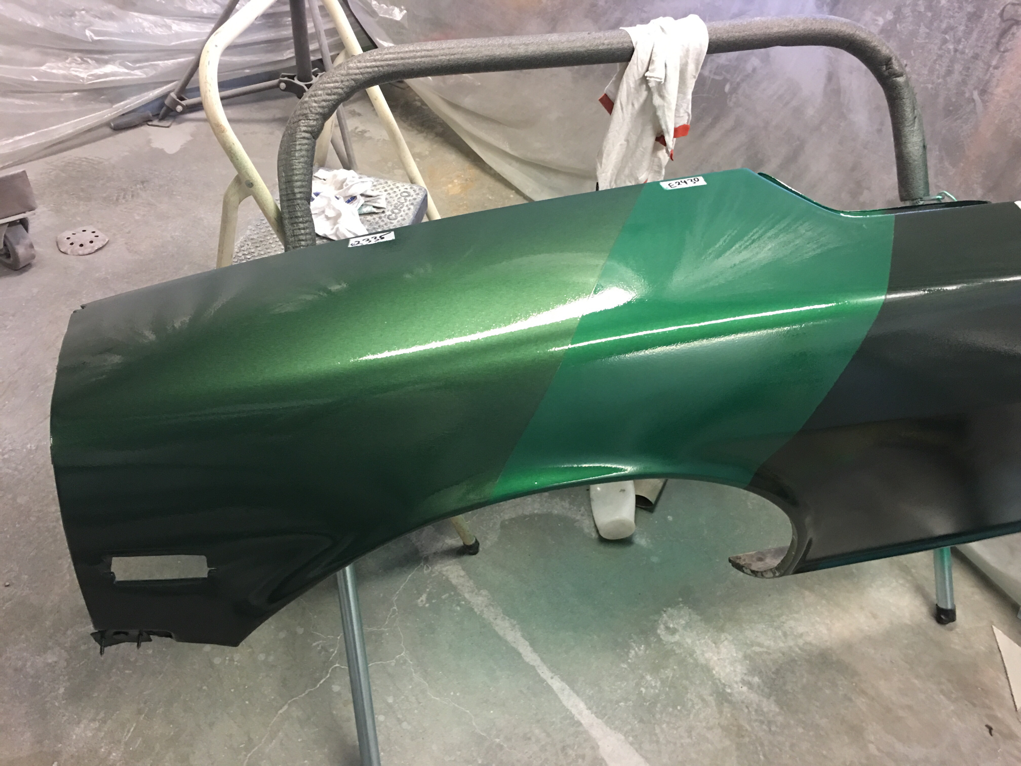

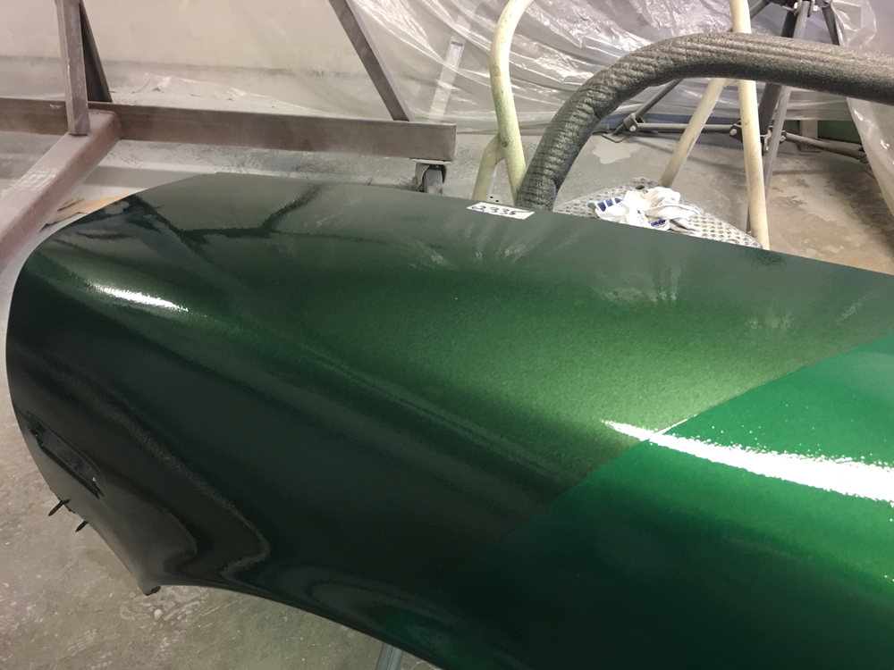

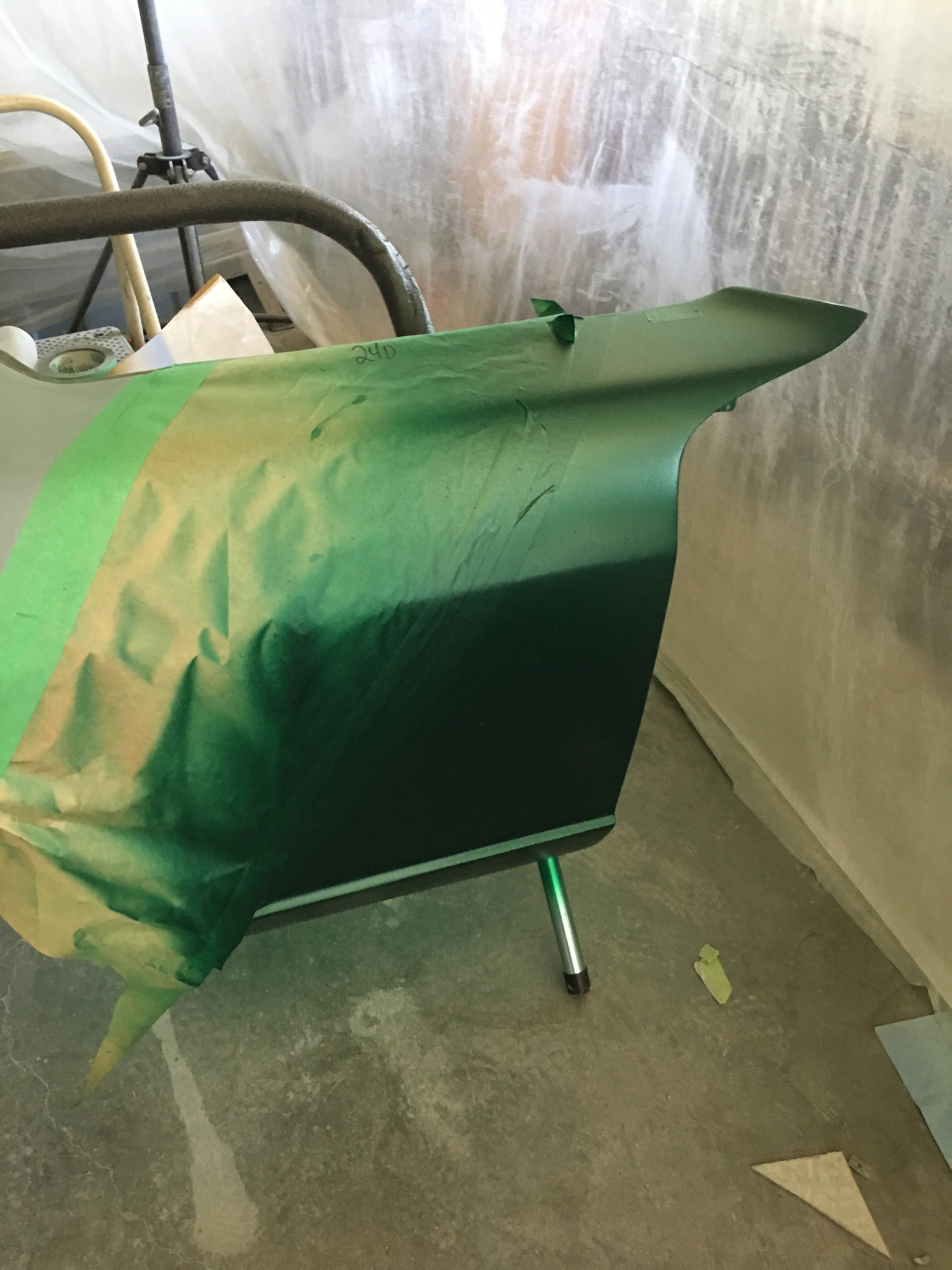

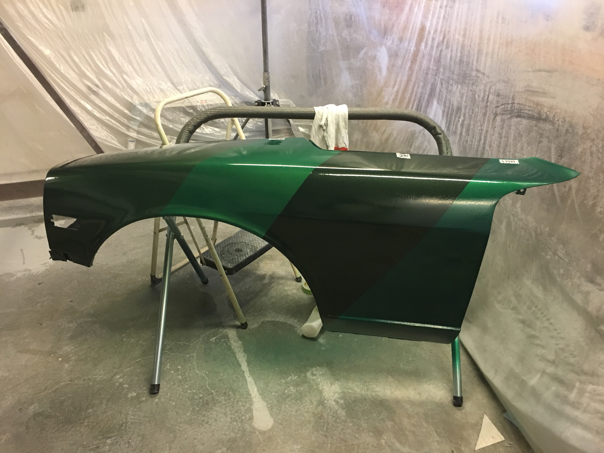

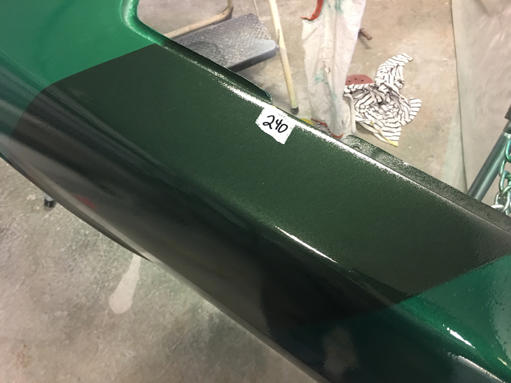

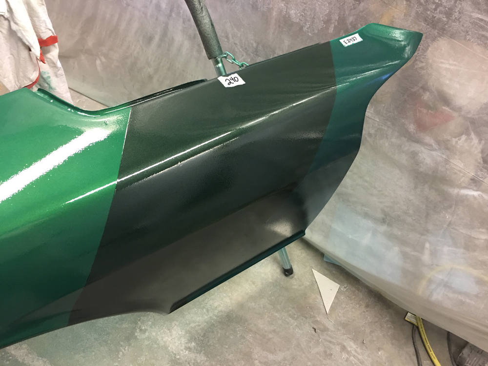

Sprayed the remaining three colours last night. Got the gun pressure dialled in and used the 3M PPS cups like I should have the first time. Paint went on smooth and blem free like expected. Painted three coats plus a fan coat at the end. Let the paint flash dry on each between coats. Wiped the panel down and shot two passes of lacquer clear coat with a 15 minute flash time between each. Will post more pics in sunlight when I get a chance. The clear needs sanding and buffing too. I will do this for practice and also to make the colours pop the most. Clear is still wet in these pics.

For what it's worth, the green on the nose/front of the fender is the "best". The dark one next.
Just say NO to anything turquiosy...
Thanks for the feedback Jim!
I agree... the nose colour is very attractive. The original 240 green is a close second. However, the wife has the final say and she wanted dark green....
Have to see what she says when she sees them. She might want more samples....
Maybe it's the lighting, but your 235 looks very much like my 240?  It looks like it has more depth. Direct sunlight makes a huge difference with metallic paint and that will be the tell of the tale.

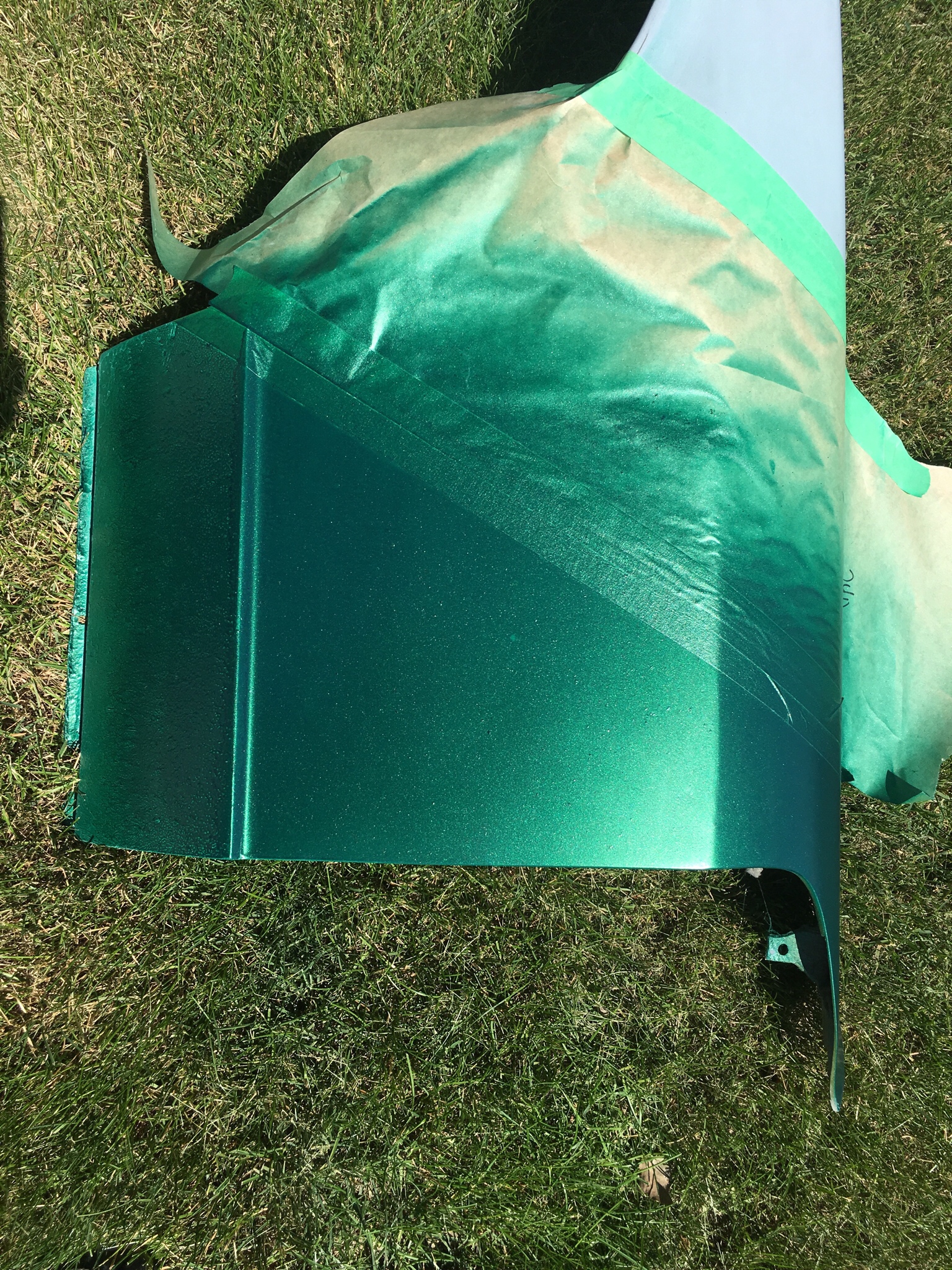

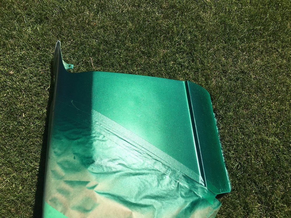

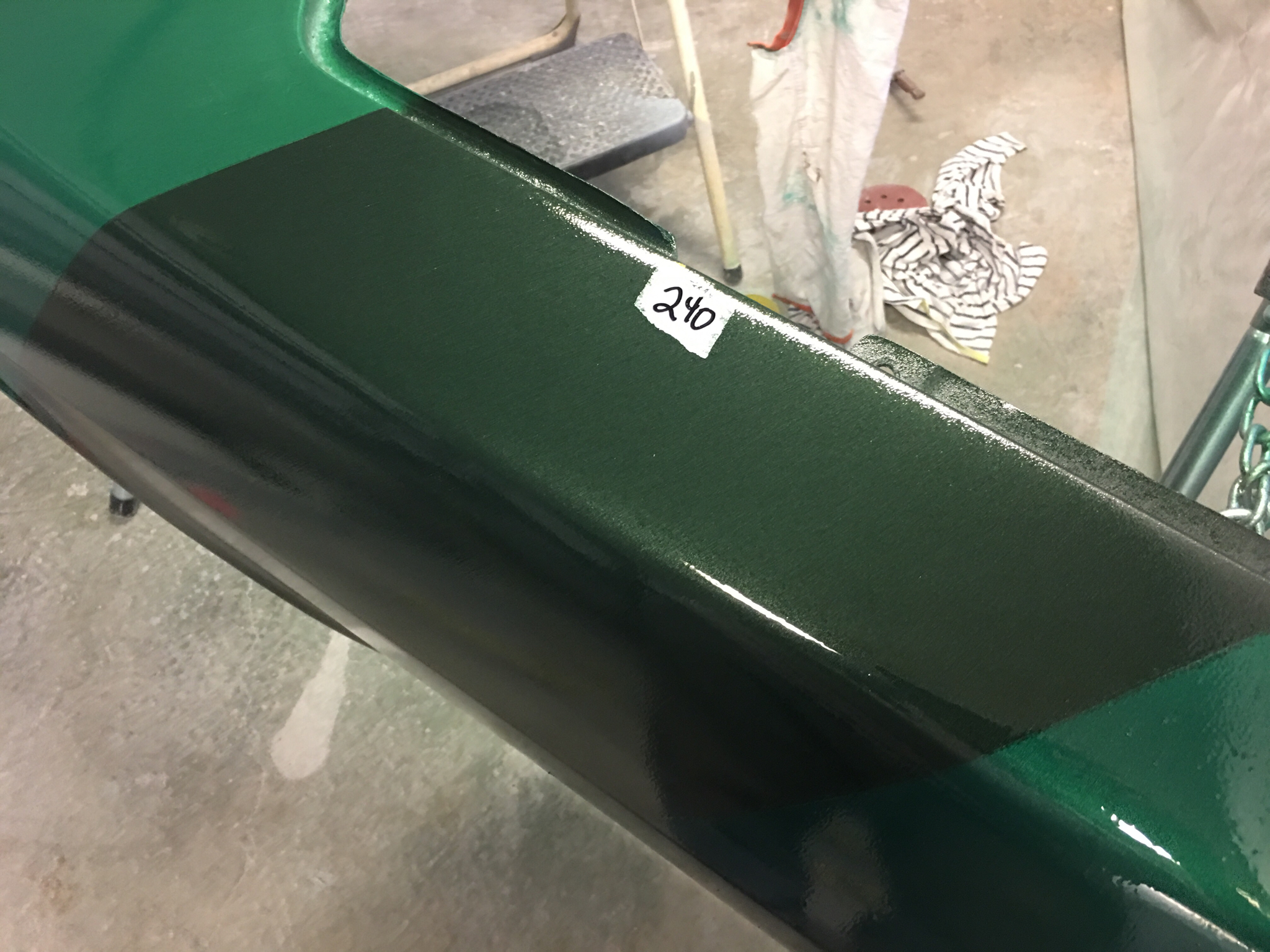

Couple of comparison photos for you.
I like your green very much, but it is the lightest version of 240 green I have ever seen... Again, mine is a water based mix so that may have some play here but I'm not sure. It DOES look very close to the 2335 on the nose of the fender (to which I am partial) The other colours I sprayed look nothing like their paint chip samples either!
