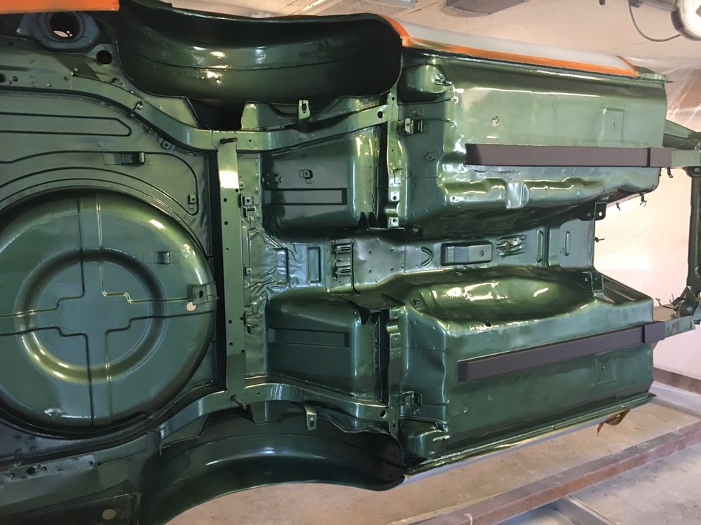

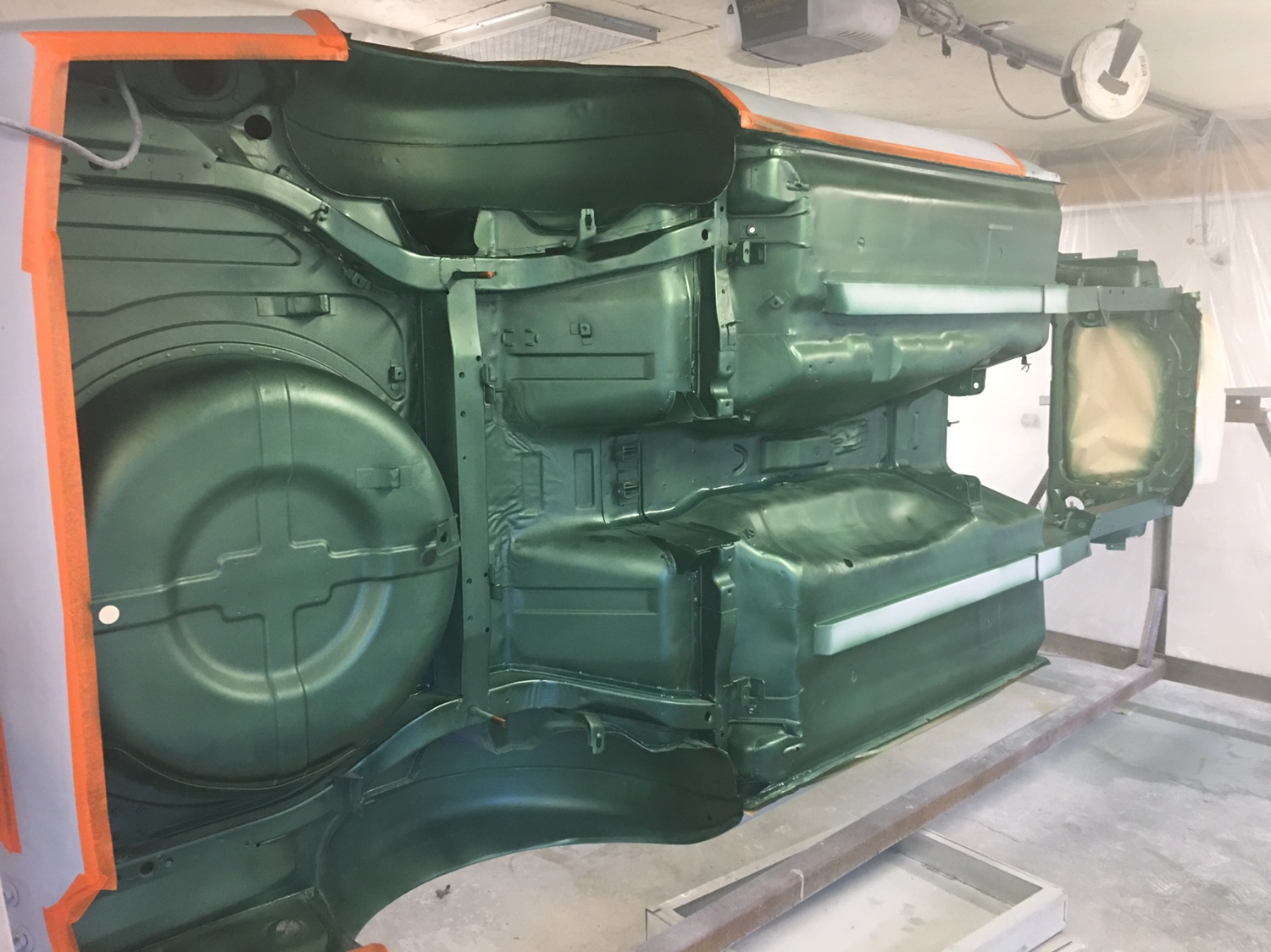

Thanks. I appreciate the feedback. I post a lot of pictures for my own reference later, but I remember how I lived vicariously through@hazmatt and all his posts too!
You have already far surpassed my build! Looking great Wheee! The body work looks amazing.
