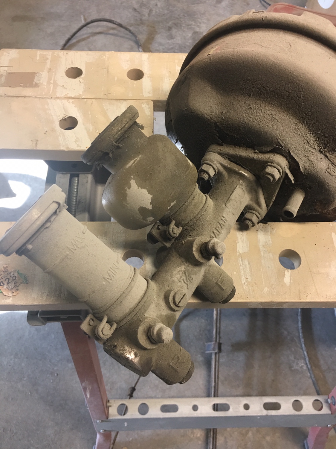

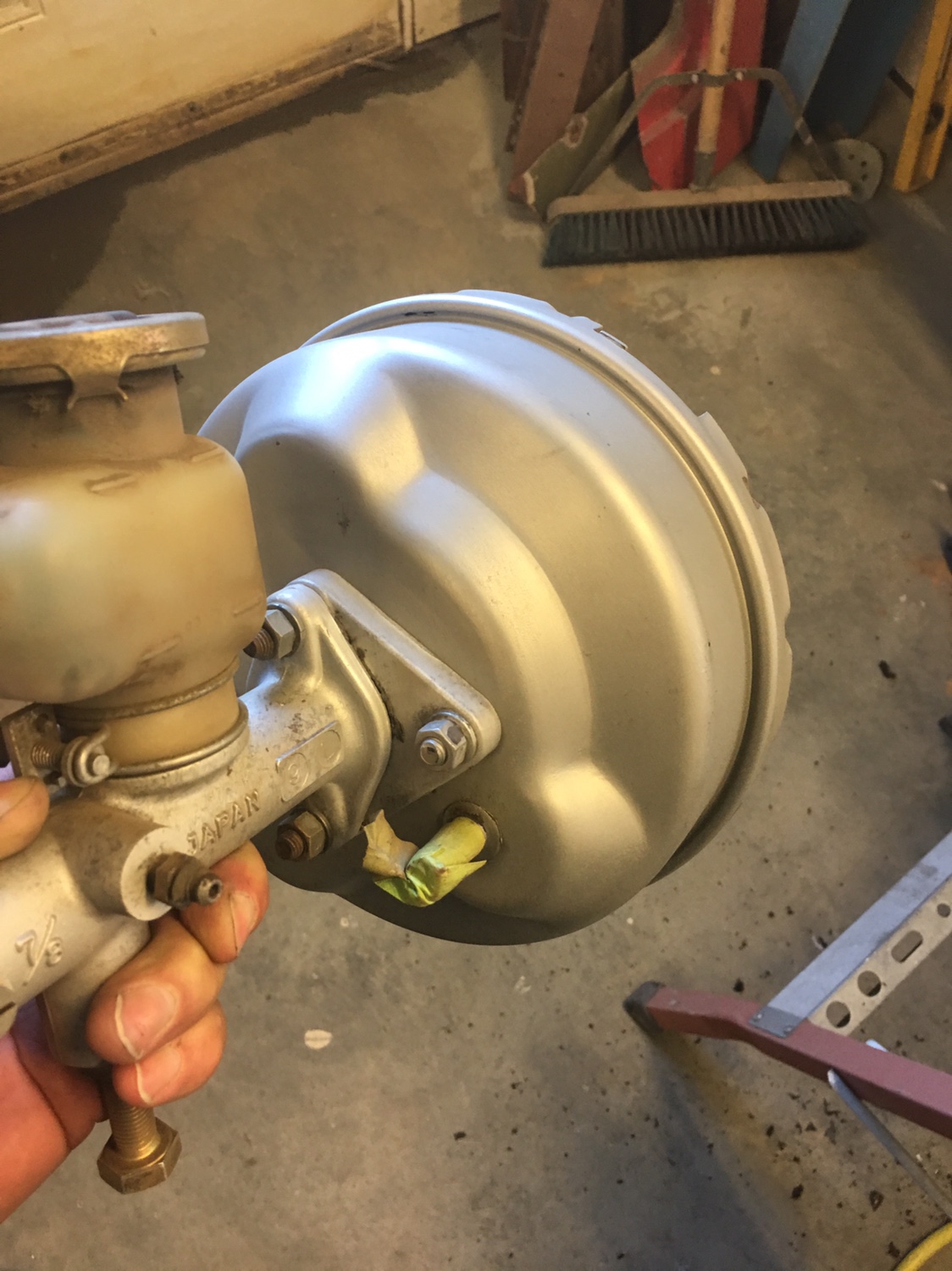

I have all of the above except the zinc plating system. Plus I have a powder coater. Some of my small parts I have already prepped, others I will do as I go. At least it feels like progress!
The brake distribution block and proportioning block are already restored and mounted. They were a day apiece...
