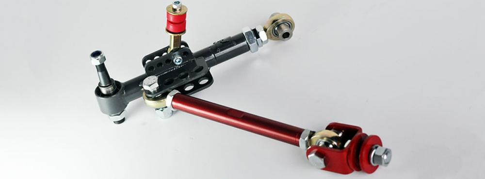

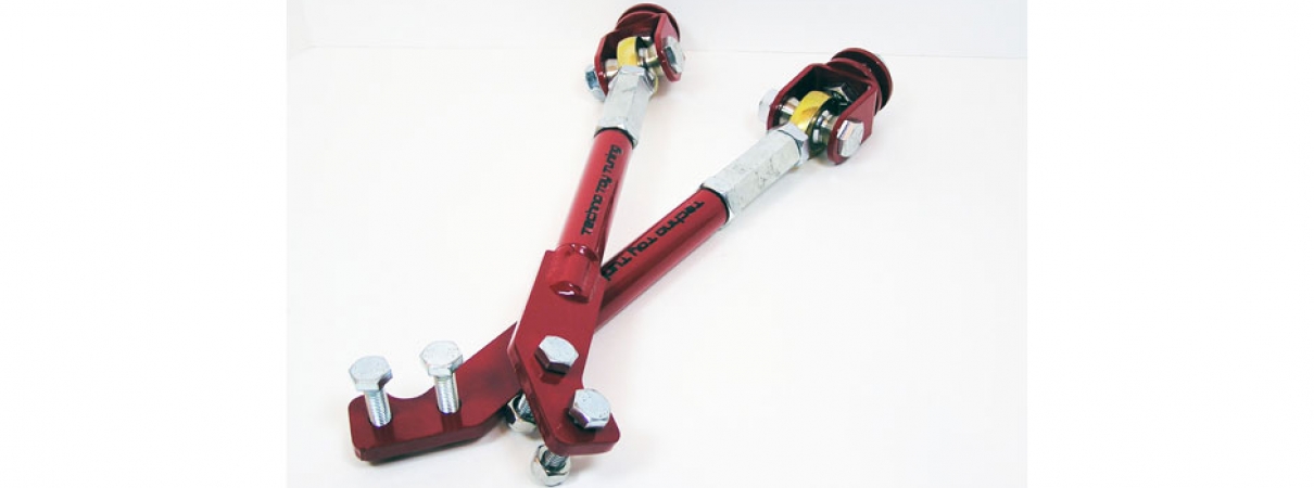

August 23, 20177 yr comment_528693 hey mark, are you planning on running TTT tension rods in the front? if so, be careful. The TTT front tension rods will not work with the AZC short steering knuckles. It will interfere with the steering travel. Knuckle will hit the tension rod before the steering rack reaches full travel.... I found this out myself Link to comment https://www.classiczcars.com/forums/topic/50908-1976-280z-restoration-project/?&page=128#findComment-528693 Share on other sites More sharing options...
August 23, 20177 yr Author comment_528694 hmmmm... I was indeed adding the GTX2 kit for the front LC's and tension rods... will these be an issue? I wasn't planning on using the stock TTT tension rod replacement. wasn't going to use this style... Edited August 23, 20177 yr by wheee! Link to comment https://www.classiczcars.com/forums/topic/50908-1976-280z-restoration-project/?&page=128#findComment-528694 Share on other sites More sharing options...
August 23, 20177 yr comment_528695 oh ok. The GTX model, I'm not sure. But their other version will have issues. By the looks of it, the GTX tension rod looks more similar to AZC. Should be ok Link to comment https://www.classiczcars.com/forums/topic/50908-1976-280z-restoration-project/?&page=128#findComment-528695 Share on other sites More sharing options...
August 23, 20177 yr Author comment_528696 Thanks Taka! I was hoping to reduce the steering travel and improve the ratio a bit. I am also going with the Silvermine Power Steering kit. Overall, steering should be dramatically improved. Link to comment https://www.classiczcars.com/forums/topic/50908-1976-280z-restoration-project/?&page=128#findComment-528696 Share on other sites More sharing options...

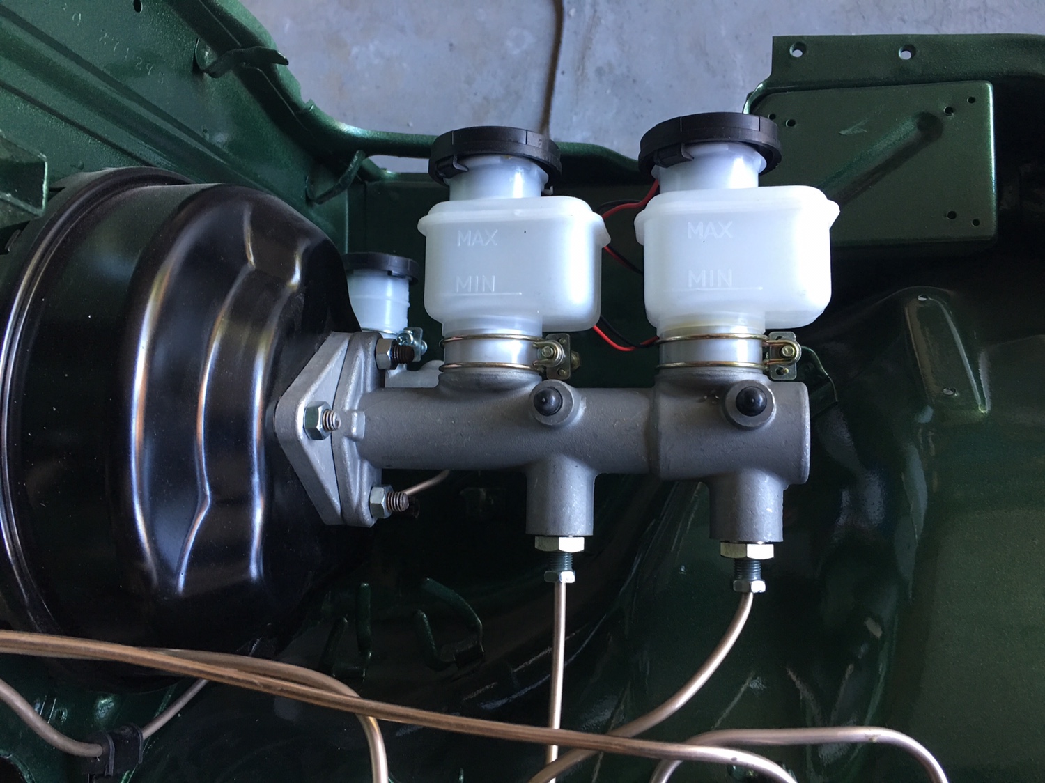

September 4, 20177 yr Author comment_529602 Playing around... waiting for some bolts and nuts to attach things properly. Bolted up the 15/16" master cylinder. Link to comment https://www.classiczcars.com/forums/topic/50908-1976-280z-restoration-project/?&page=128#findComment-529602 Share on other sites More sharing options...
September 5, 20177 yr comment_529623 Damn, I can't wait to see this one done. It's going to be a beaut! Link to comment https://www.classiczcars.com/forums/topic/50908-1976-280z-restoration-project/?&page=128#findComment-529623 Share on other sites More sharing options...
