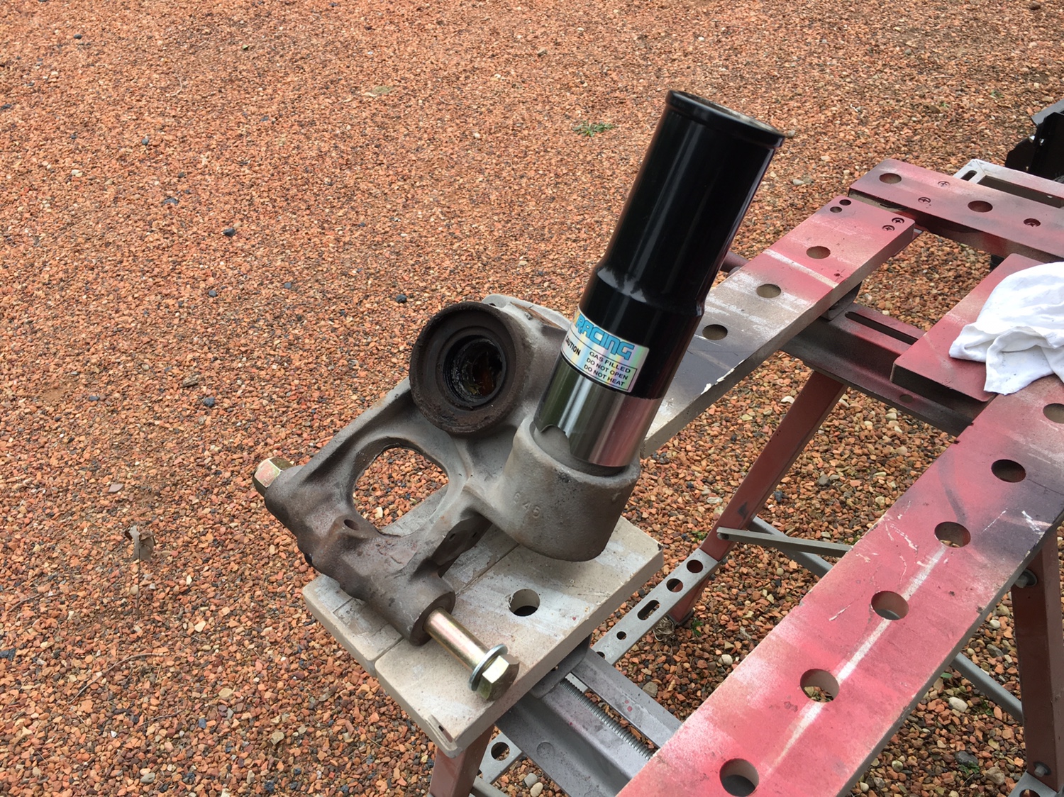

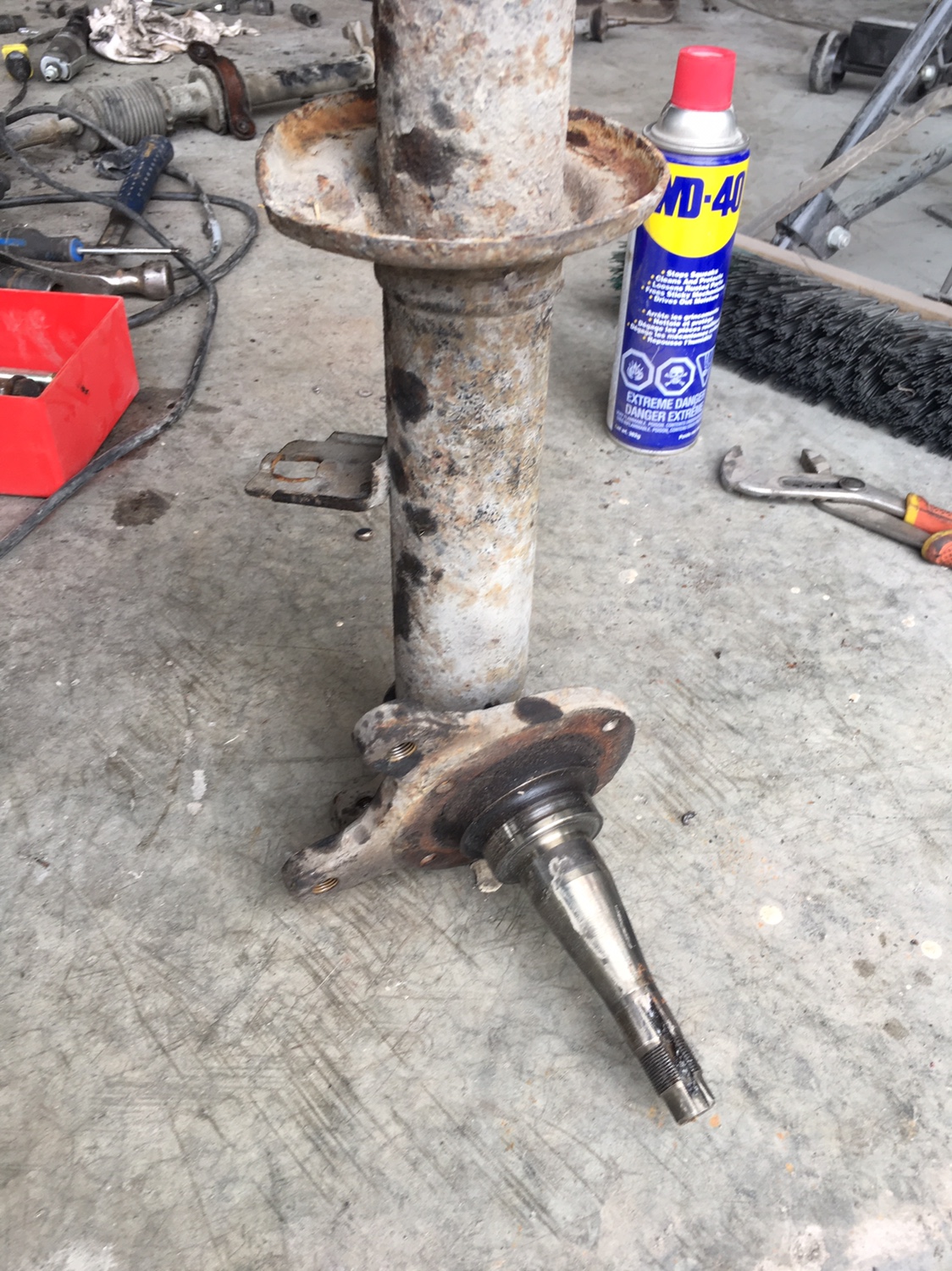

First up, I drilled two opposite holes near the top of the strut to drain the oil. The gland nuts are rusted and seized and I don't plan on saving these anyways. Drained the oil to make it safe to cut with the angle grinder/cutoff tool.
Then I removed all the hub and rotor components off the front spindle.
For the rears, I pushed the spindles out with the press before removing the backing plates. That gave me something to push against.

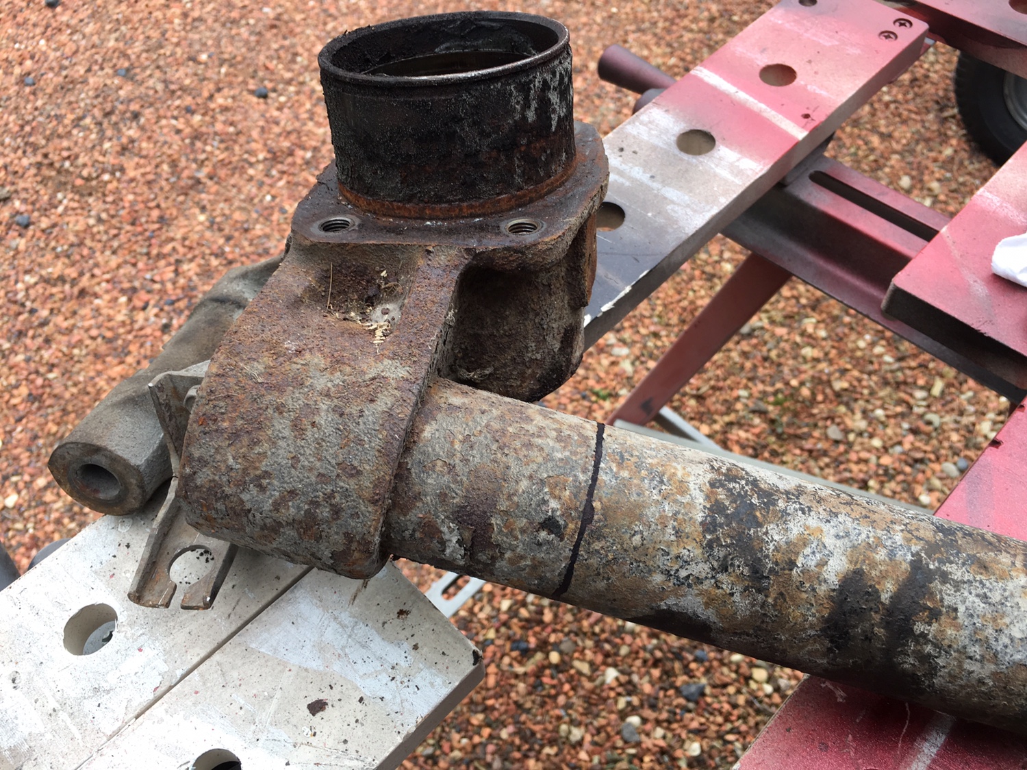

Removed the backing plates and then marked out the cutoff point at 2" from the bottom.

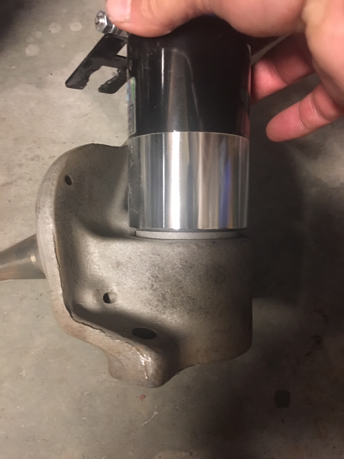

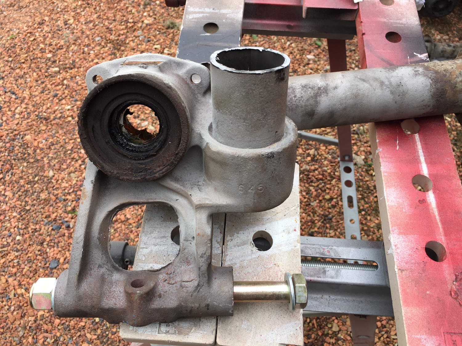

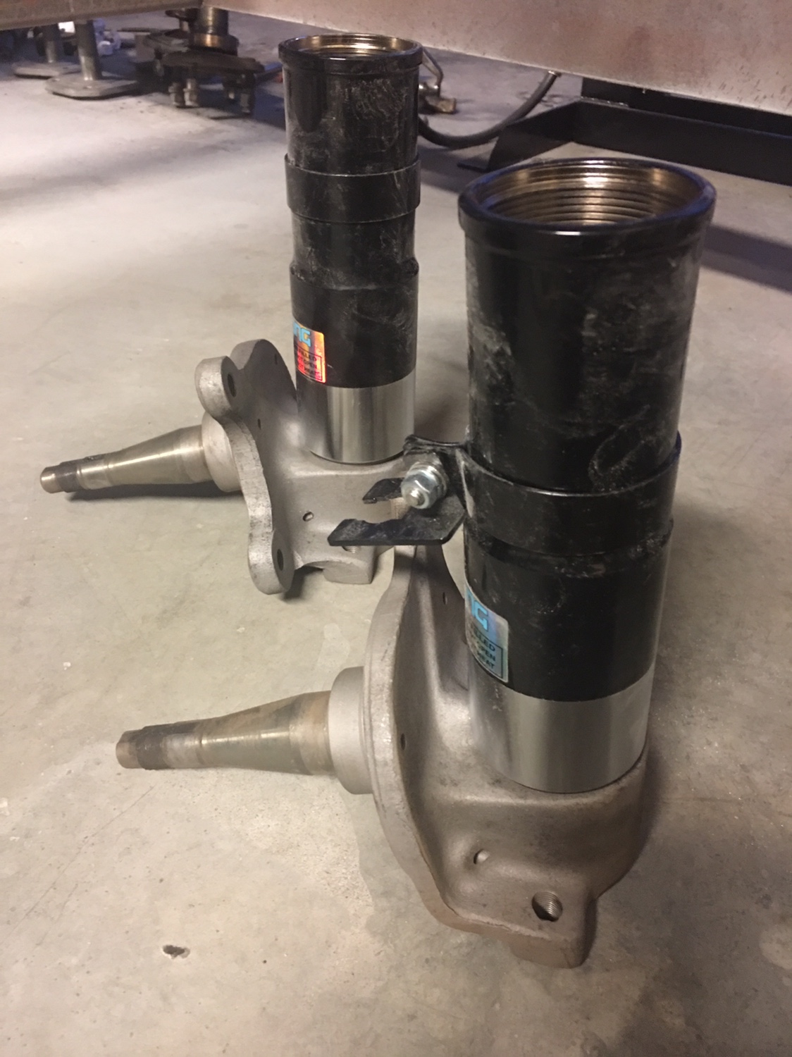

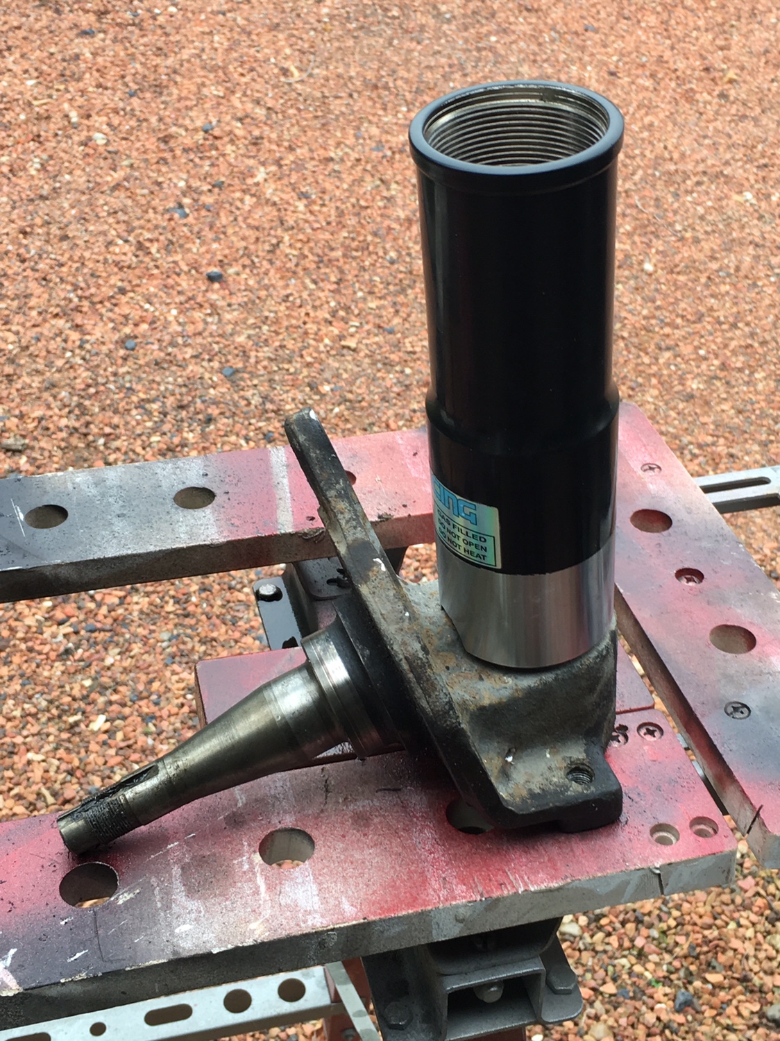

Cut off the strut and test fit the collar. I may remove a little more material for a more flush fit.

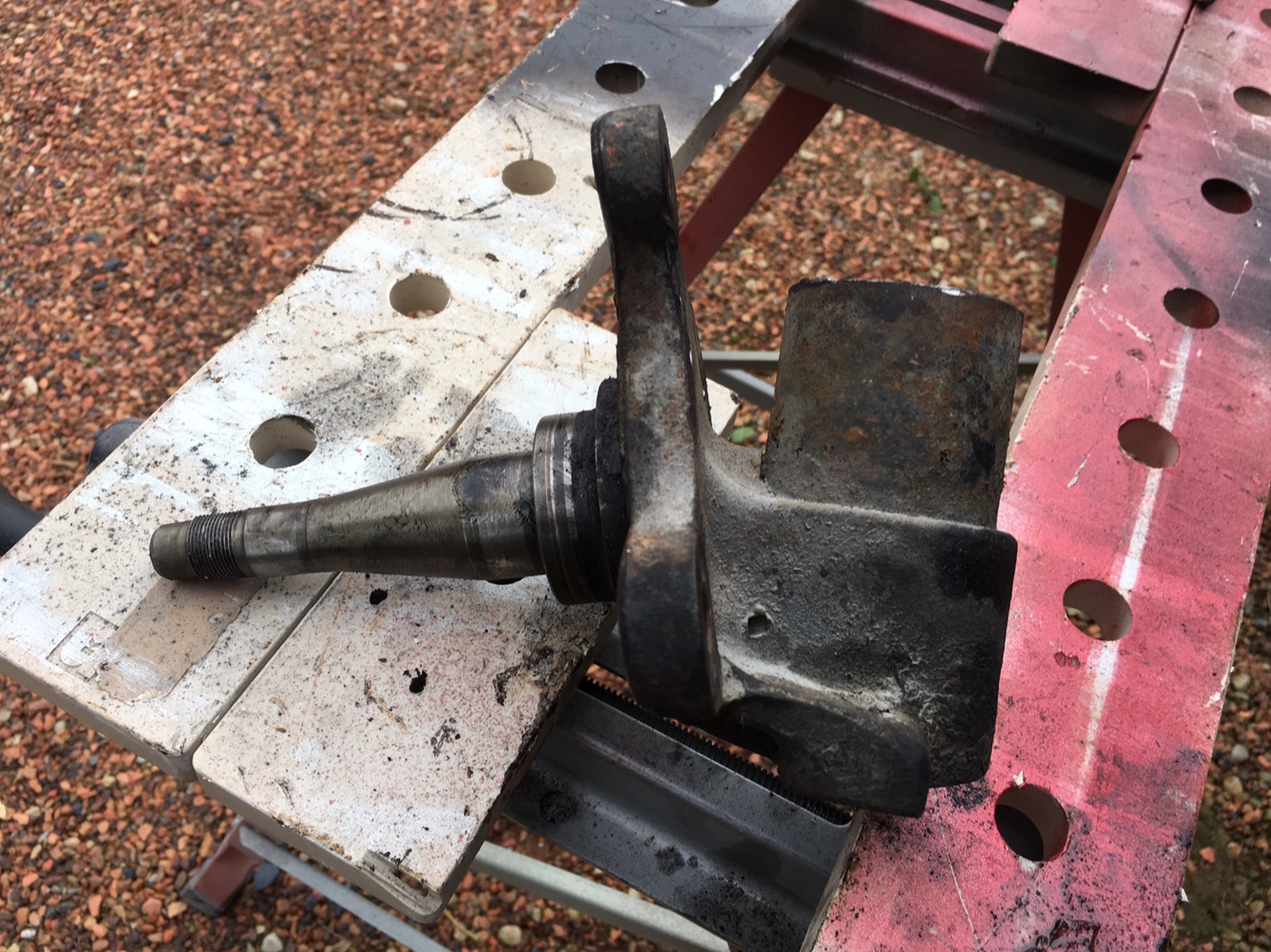

Did the same to the fronts. A little more creative cutting is needed to clear the spindle hub. Not impossible but the casing needs to be cut up a bit more to get the grinder in there.
