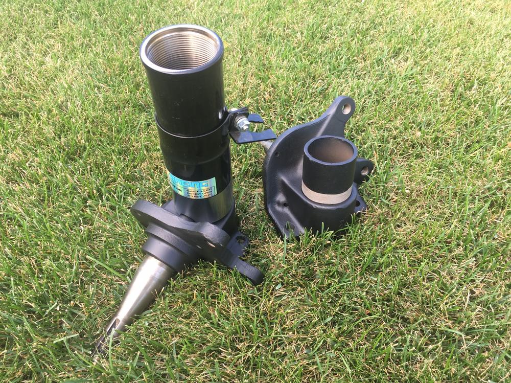

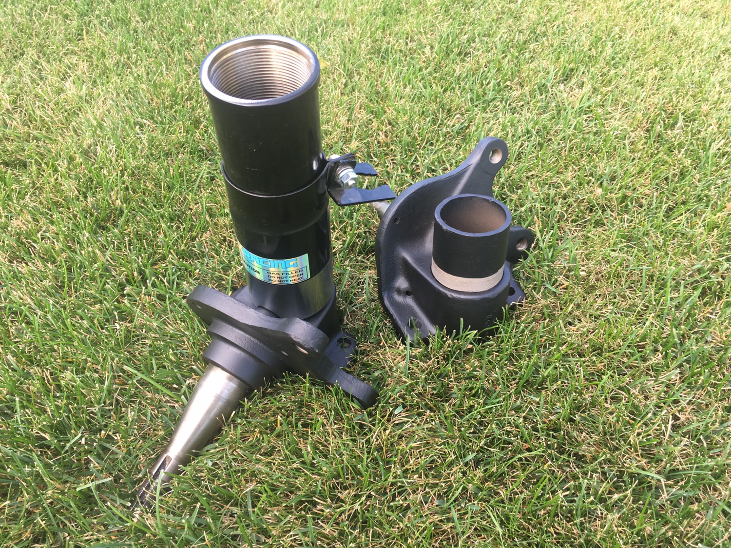

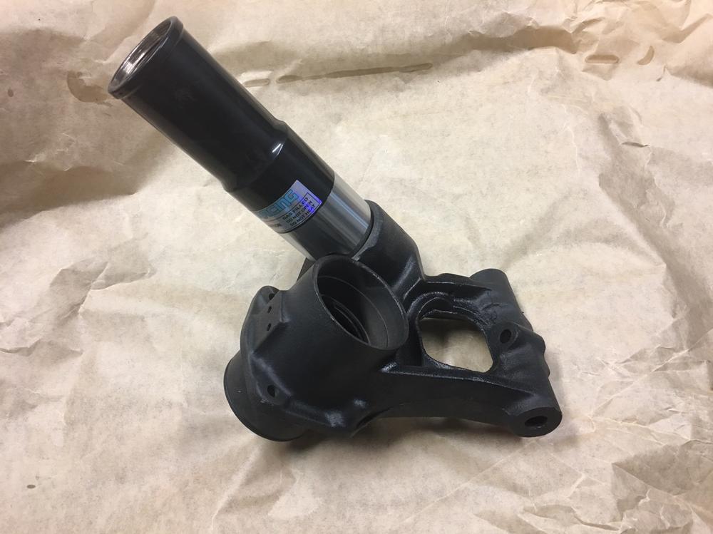

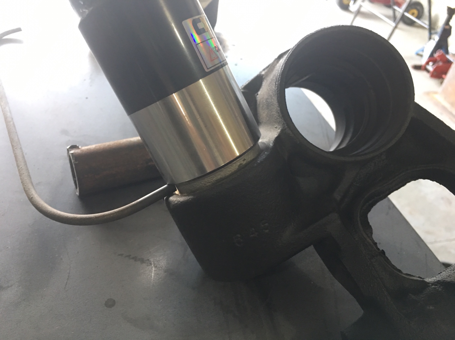

September 25, 20177 yr Author comment_531011 Some shots of the front spindles before welding. Powder coated all over except the spindles and the band around the strut that will receive the weld. Link to comment https://www.classiczcars.com/forums/topic/50908-1976-280z-restoration-project/?&page=132#findComment-531011 Share on other sites More sharing options...

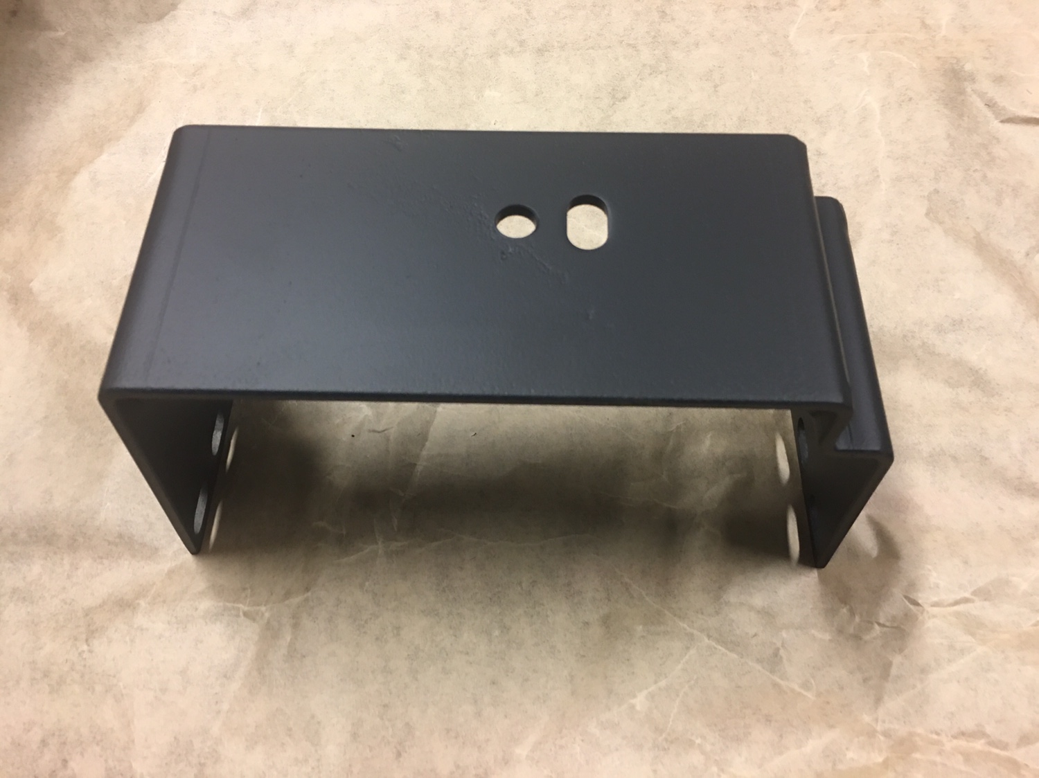

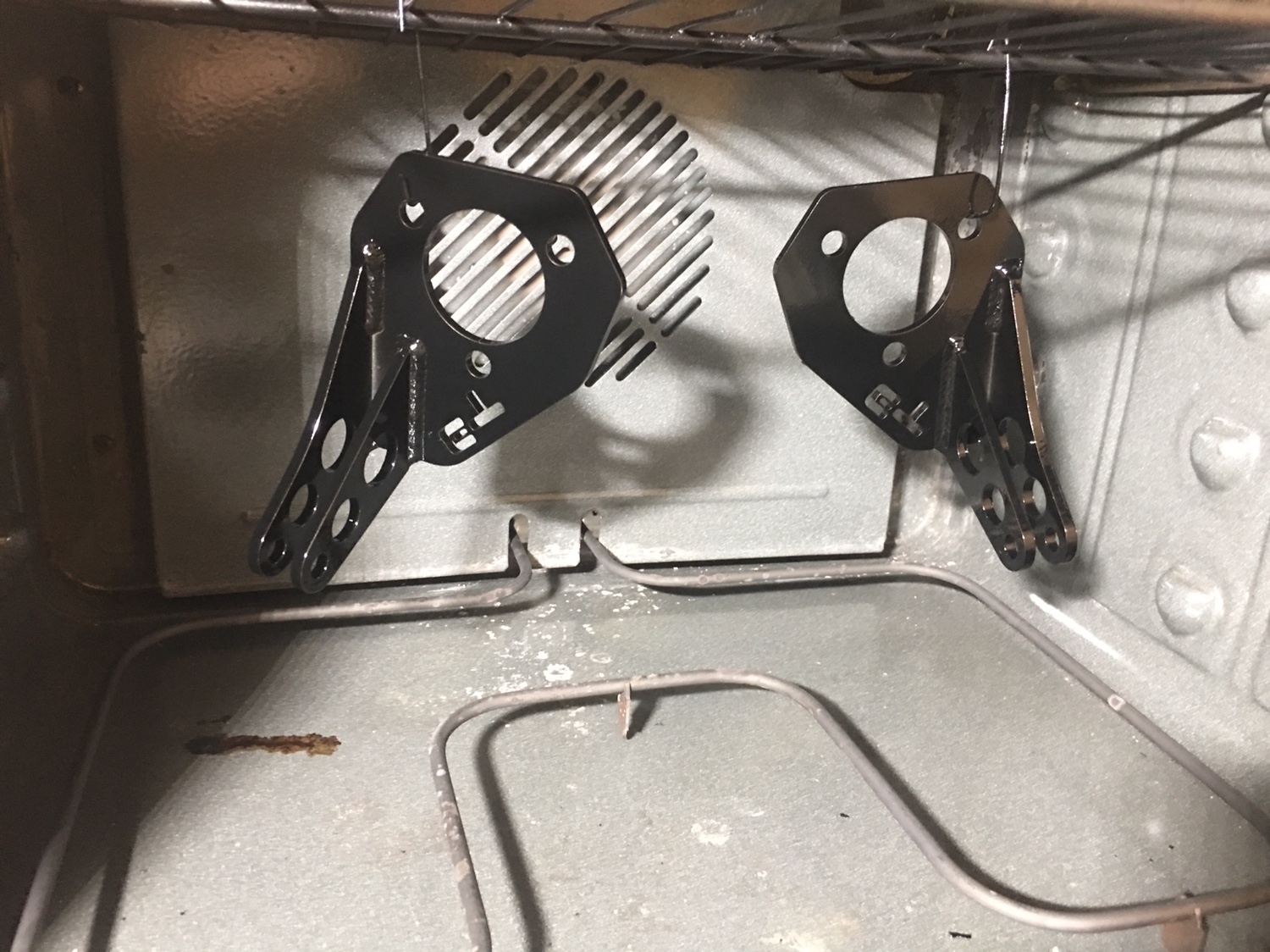

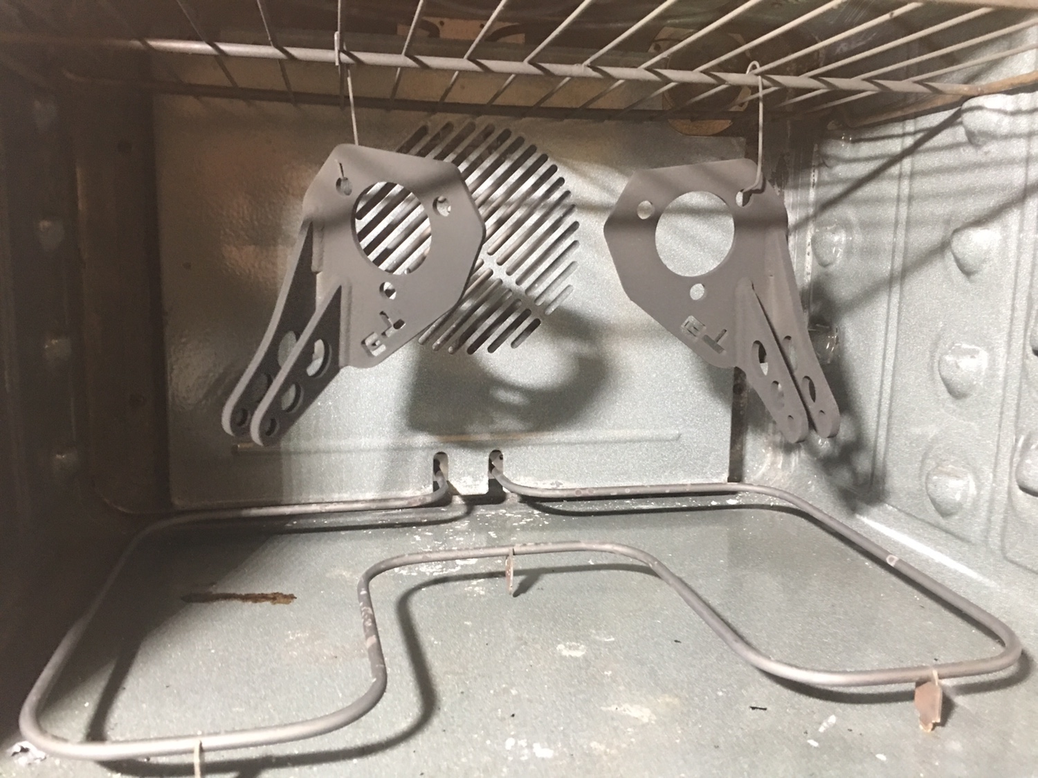

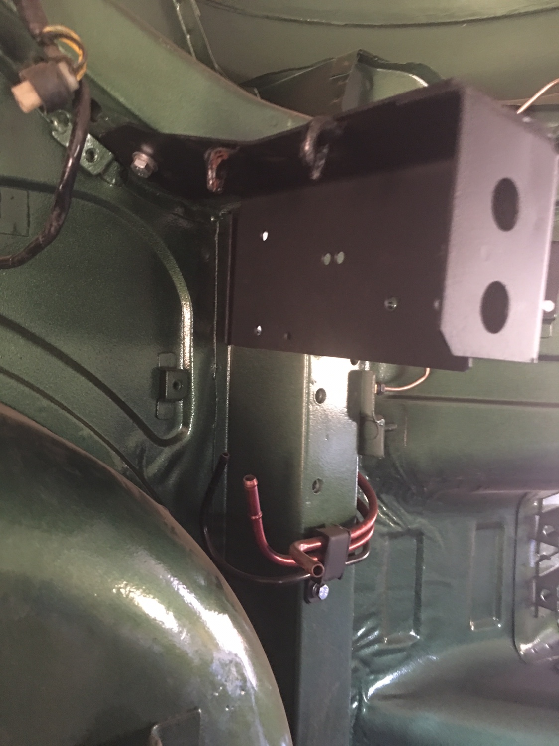

September 25, 20177 yr Author comment_531012 Mounted the freshly powder coated fuel pump bracket. The rubber covered wire wraps did not fair well in the oven but I will strip them and recoat them in plastidip before I'm done. Link to comment https://www.classiczcars.com/forums/topic/50908-1976-280z-restoration-project/?&page=132#findComment-531012 Share on other sites More sharing options...

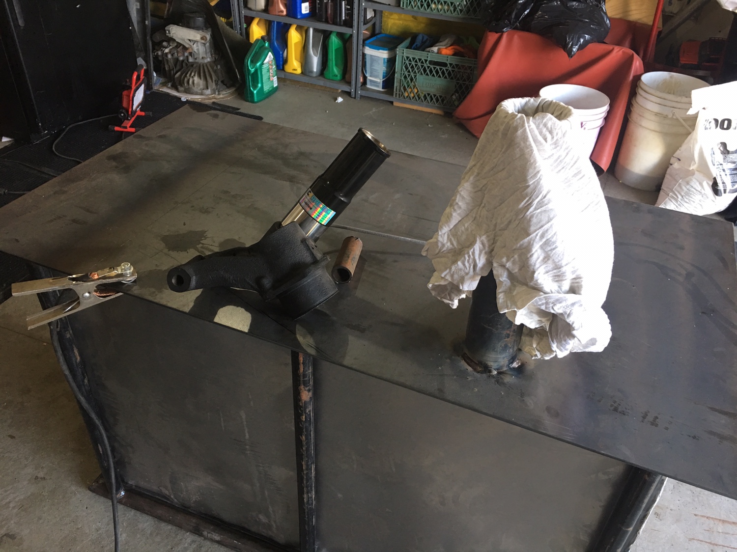

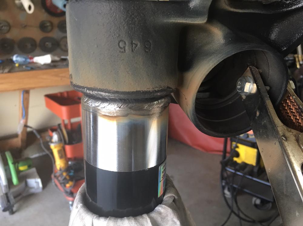

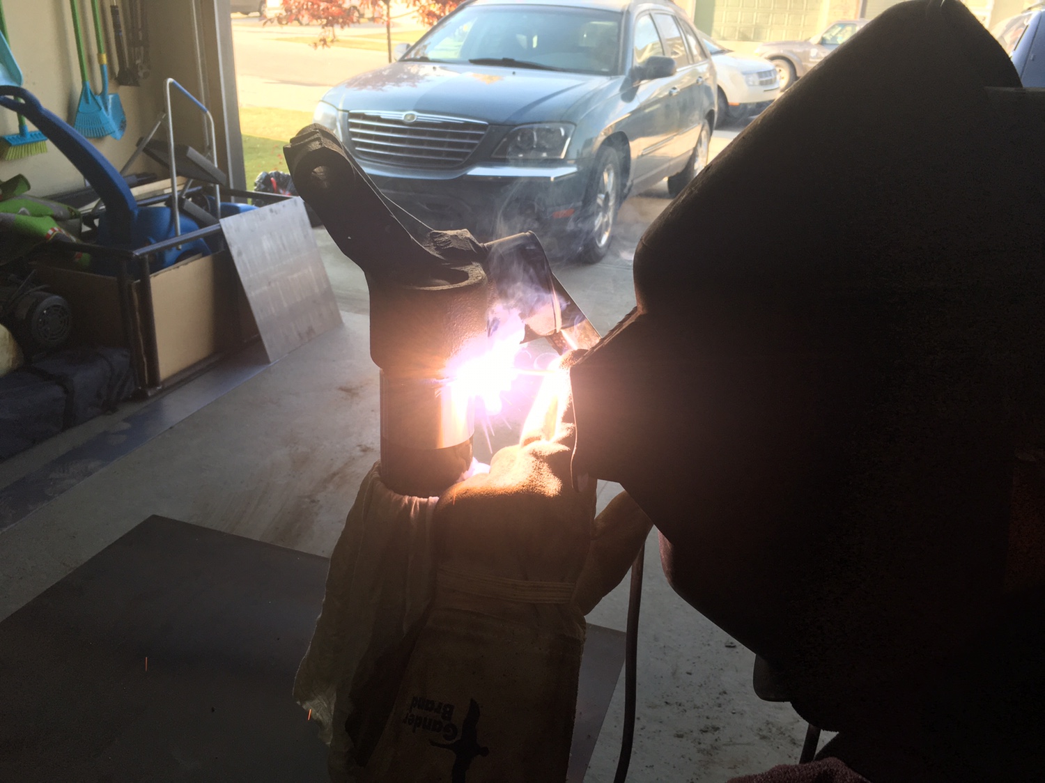

September 26, 20177 yr comment_531018 Won't the welding burn the plastic of the coating? Link to comment https://www.classiczcars.com/forums/topic/50908-1976-280z-restoration-project/?&page=132#findComment-531018 Share on other sites More sharing options...
September 26, 20177 yr Author comment_531022 Won't the welding burn the plastic of the coating?The powder coat is cured at 450 degrees. The welding will be done with wet rags around the spindles and anti splatter spray on the exposed parts. Shouldn't be an issue. Link to comment https://www.classiczcars.com/forums/topic/50908-1976-280z-restoration-project/?&page=132#findComment-531022 Share on other sites More sharing options...

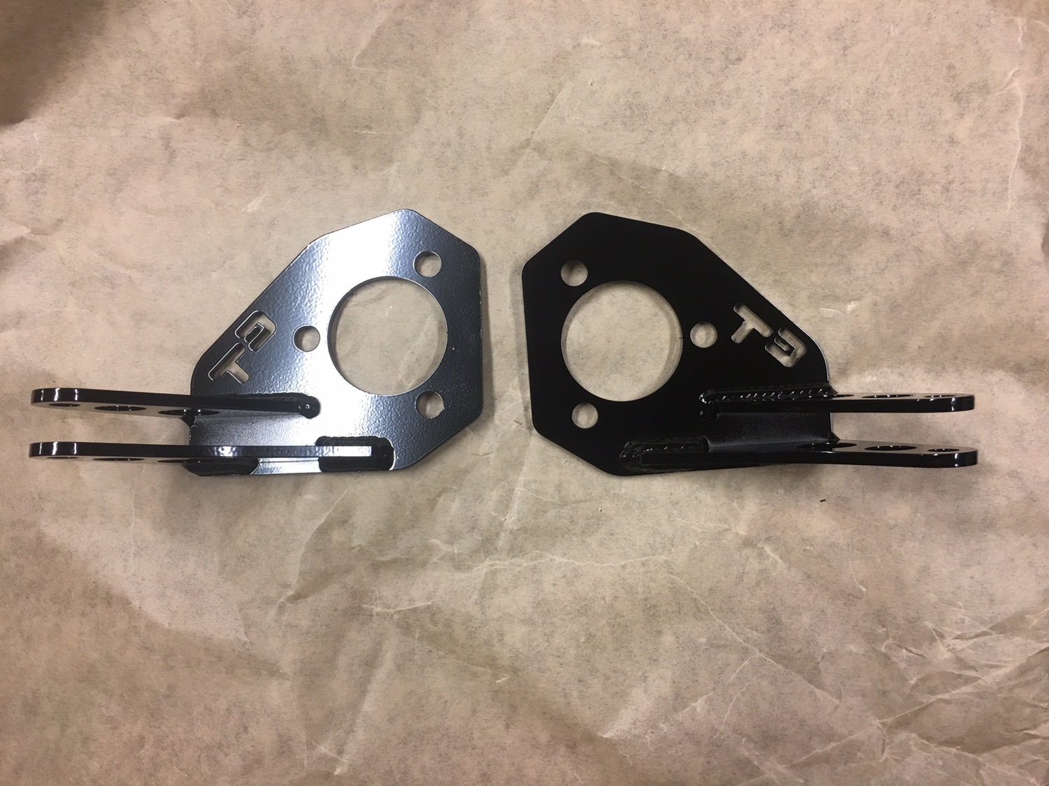

September 27, 20177 yr Author comment_531117 Got the rear hub assemblies powdercoated as well as the RT diff mount. No pics tonight sorry. Will get some good shots of the welding when I get that done though! Link to comment https://www.classiczcars.com/forums/topic/50908-1976-280z-restoration-project/?&page=132#findComment-531117 Share on other sites More sharing options...

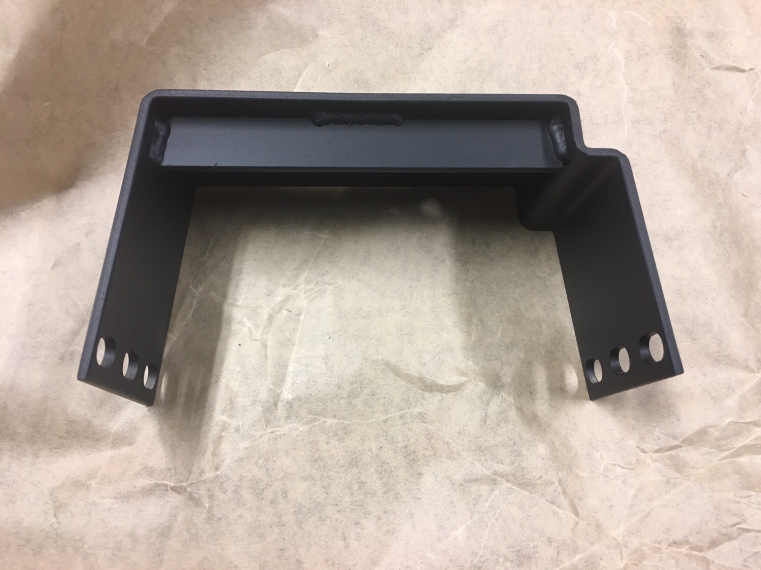

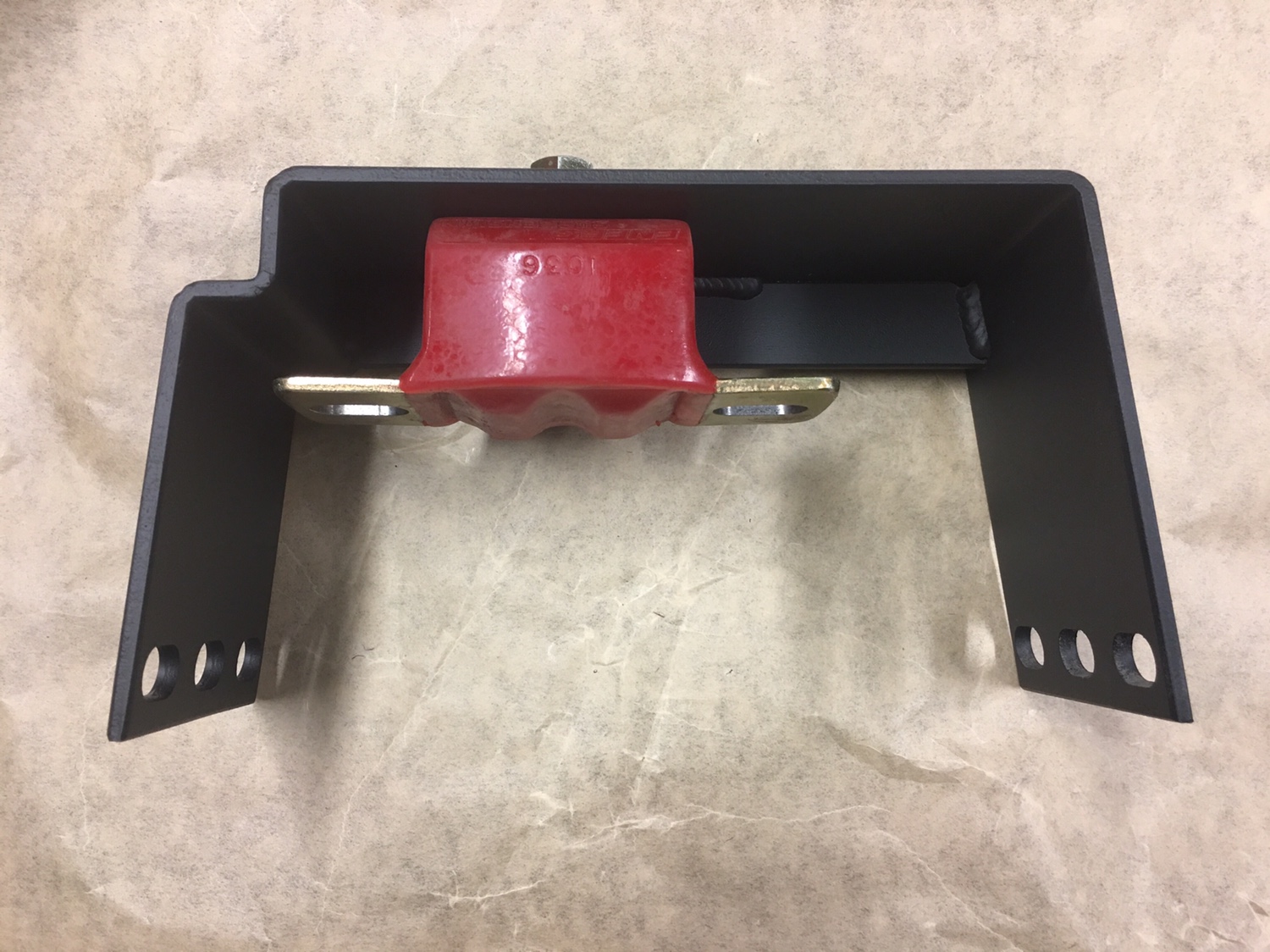

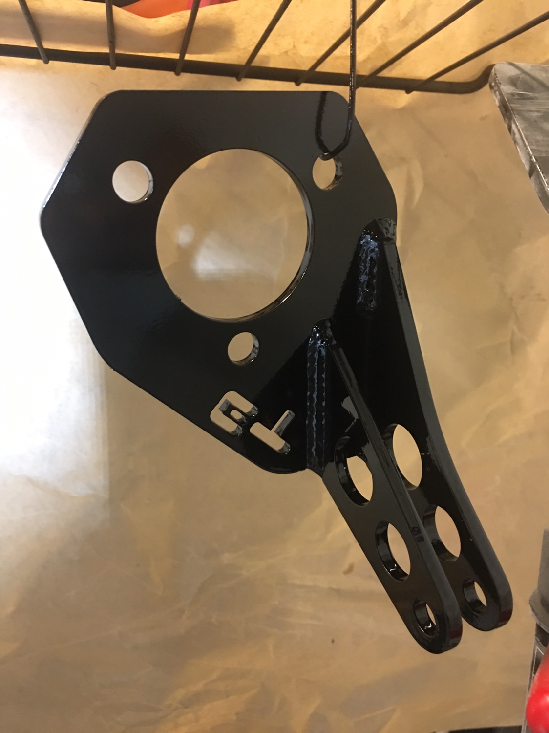

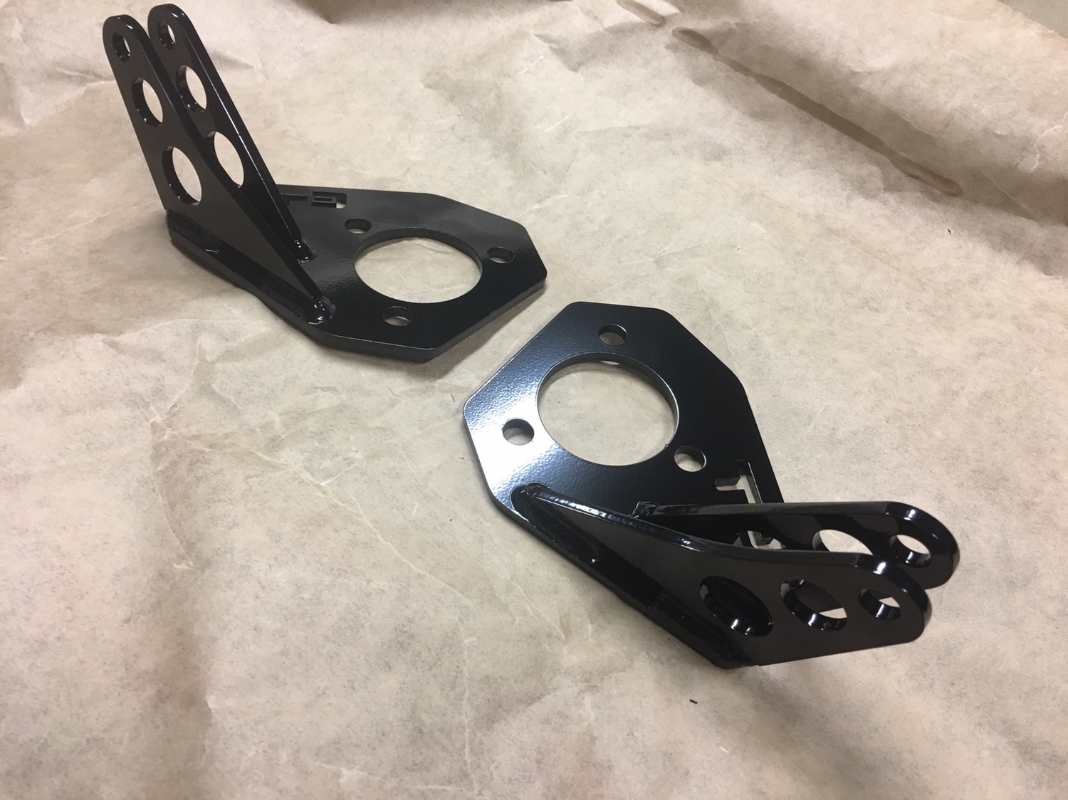

September 28, 20177 yr Author comment_531203 Techno Toys arrived today. Powder coating the raw strut mounts black. Didn't want blue... The gloss black looks great!! Link to comment https://www.classiczcars.com/forums/topic/50908-1976-280z-restoration-project/?&page=132#findComment-531203 Share on other sites More sharing options...
September 28, 20177 yr Author comment_531204 The RT Diff mount Link to comment https://www.classiczcars.com/forums/topic/50908-1976-280z-restoration-project/?&page=132#findComment-531204 Share on other sites More sharing options...
September 28, 20177 yr Author comment_531207 Shot of the pre welded rear hub in powder coat. Link to comment https://www.classiczcars.com/forums/topic/50908-1976-280z-restoration-project/?&page=132#findComment-531207 Share on other sites More sharing options...

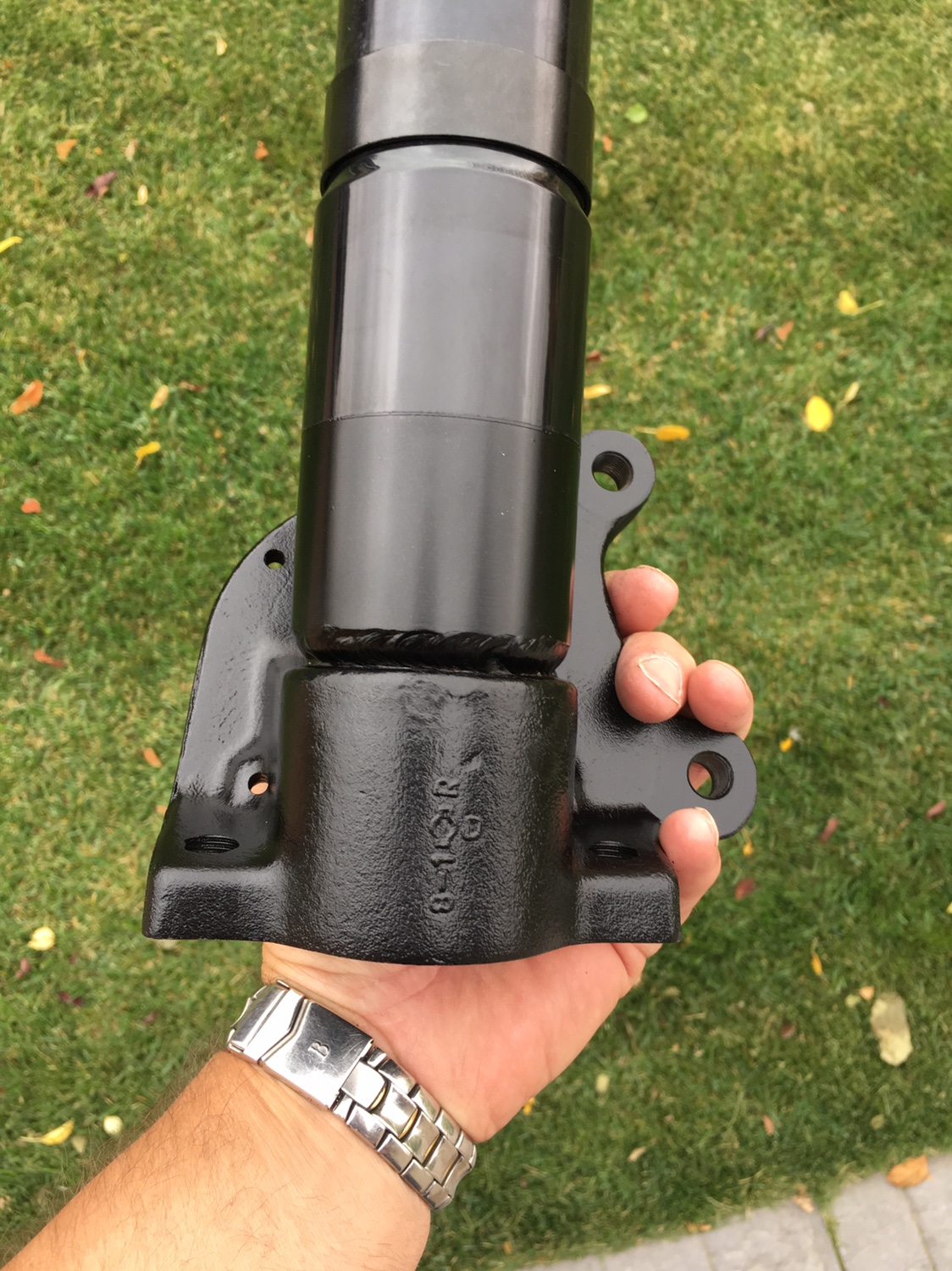

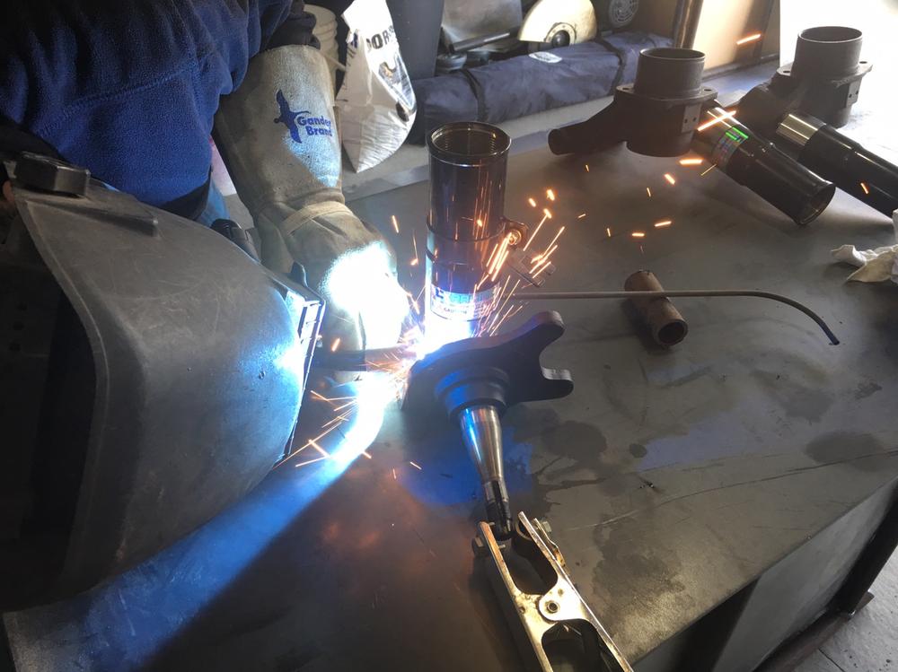

October 1, 20177 yr Author comment_531445 Welding day yesterday...First we MIG'd the struts with a tack to get the right offset from the collars. I wanted a good clean bite for the stick welds. Then a solid bead around the collars. Next step, clean up the welds and paint the exposed metal. Link to comment https://www.classiczcars.com/forums/topic/50908-1976-280z-restoration-project/?&page=132#findComment-531445 Share on other sites More sharing options...

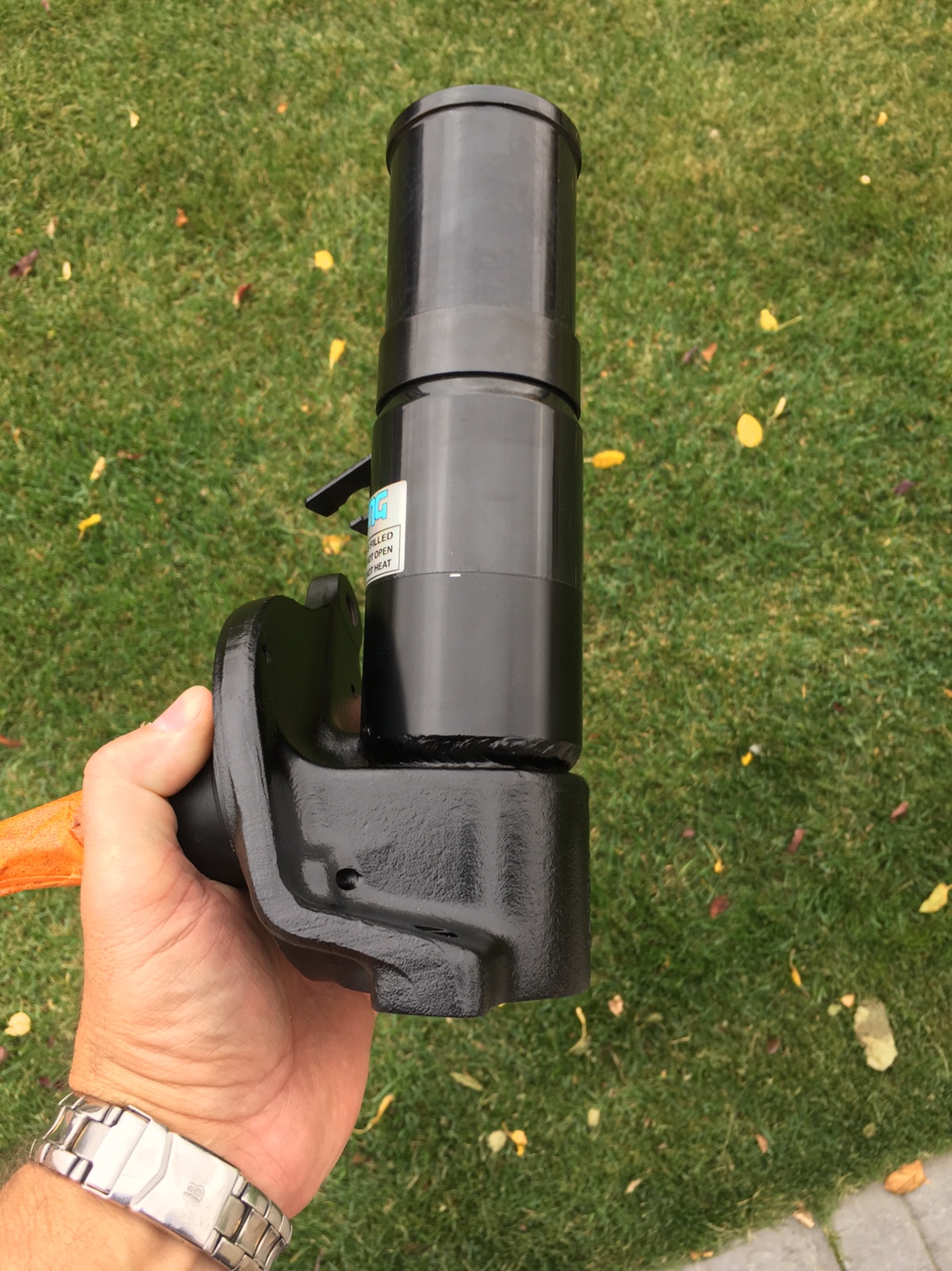

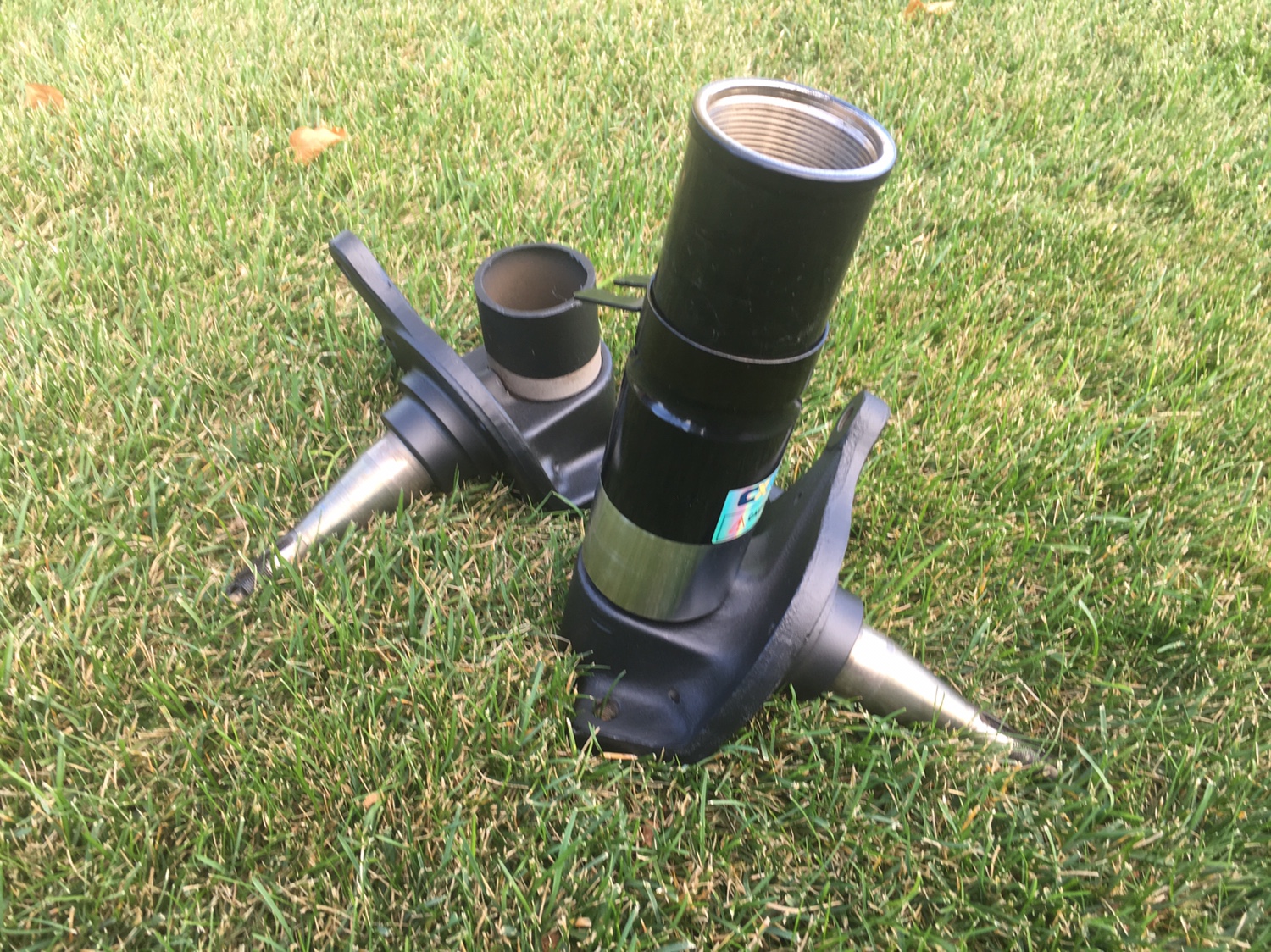

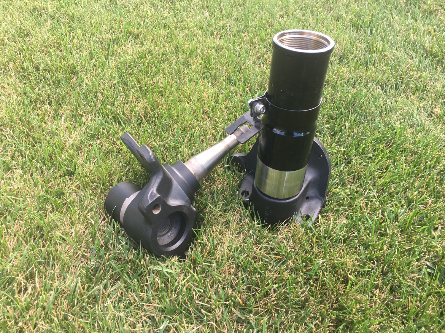

October 1, 20177 yr Author comment_531446 Finished front spindle! Link to comment https://www.classiczcars.com/forums/topic/50908-1976-280z-restoration-project/?&page=132#findComment-531446 Share on other sites More sharing options...

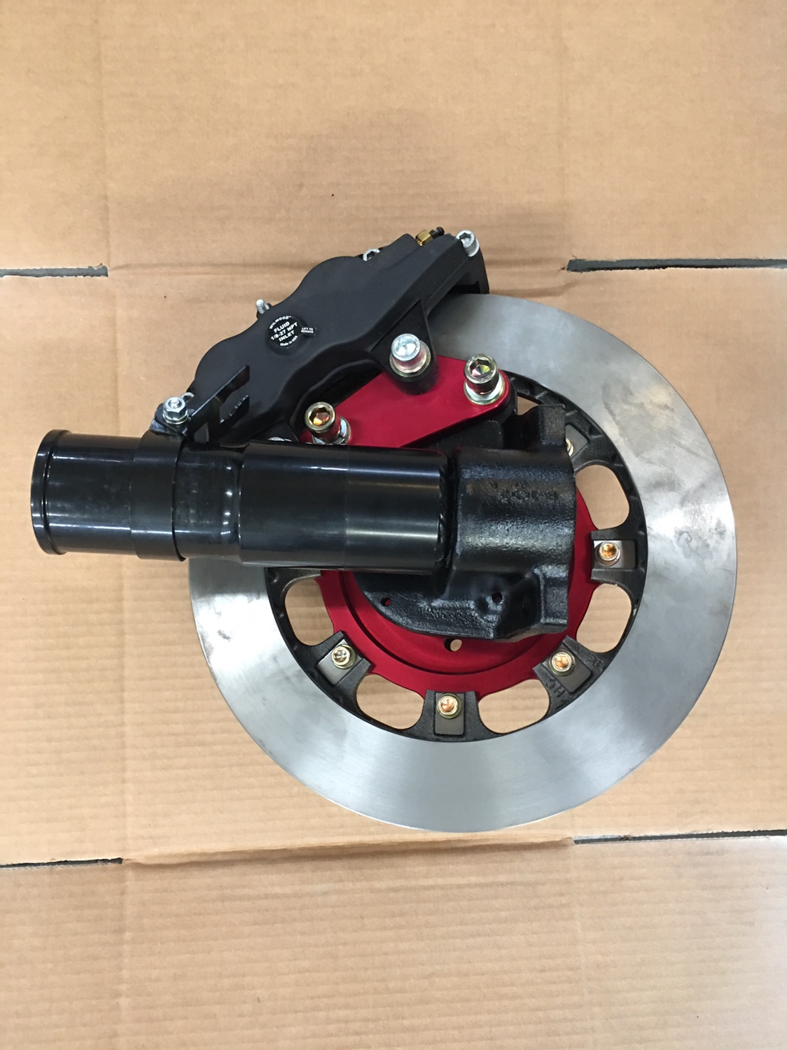

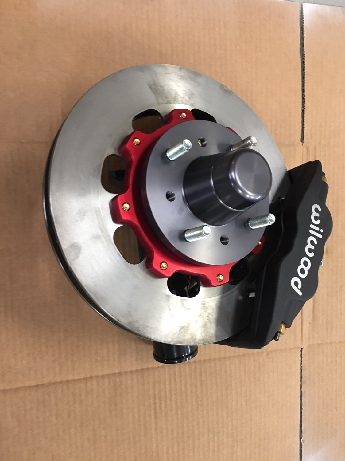

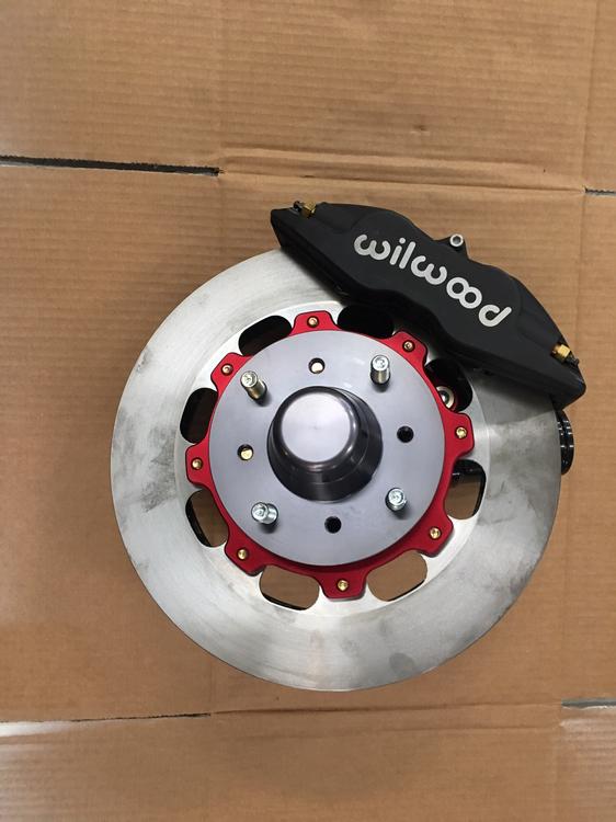

October 1, 20177 yr Author comment_531447 Partially assembled front rotor and spindle assembly. This is the brand new Techno Toy Tuning billet front hub! A work of art with a billet grease cap with o-ring. Link to comment https://www.classiczcars.com/forums/topic/50908-1976-280z-restoration-project/?&page=132#findComment-531447 Share on other sites More sharing options...
