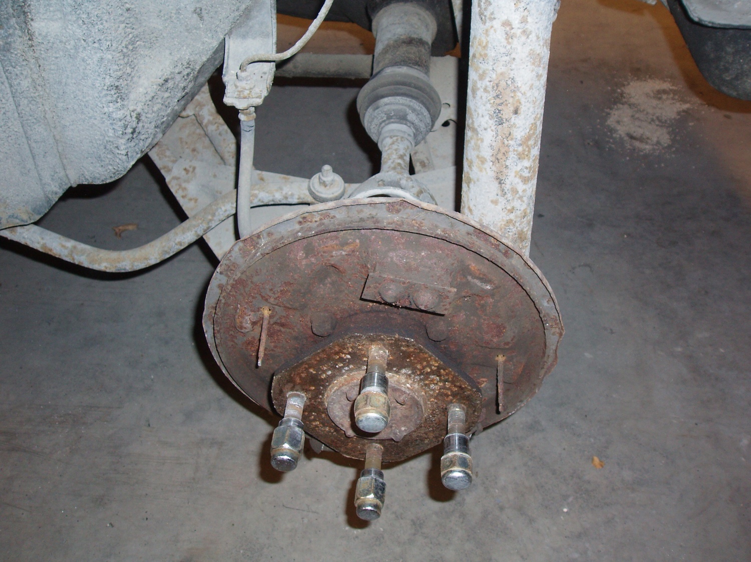

Working on the park brake linkage. I will not have park brakes on the rear discs (until AZC makes them again!) so I am installing the system minus the old cable that needed replacing anyways. I will figure out the remaining linkage when I finally get park brakes.

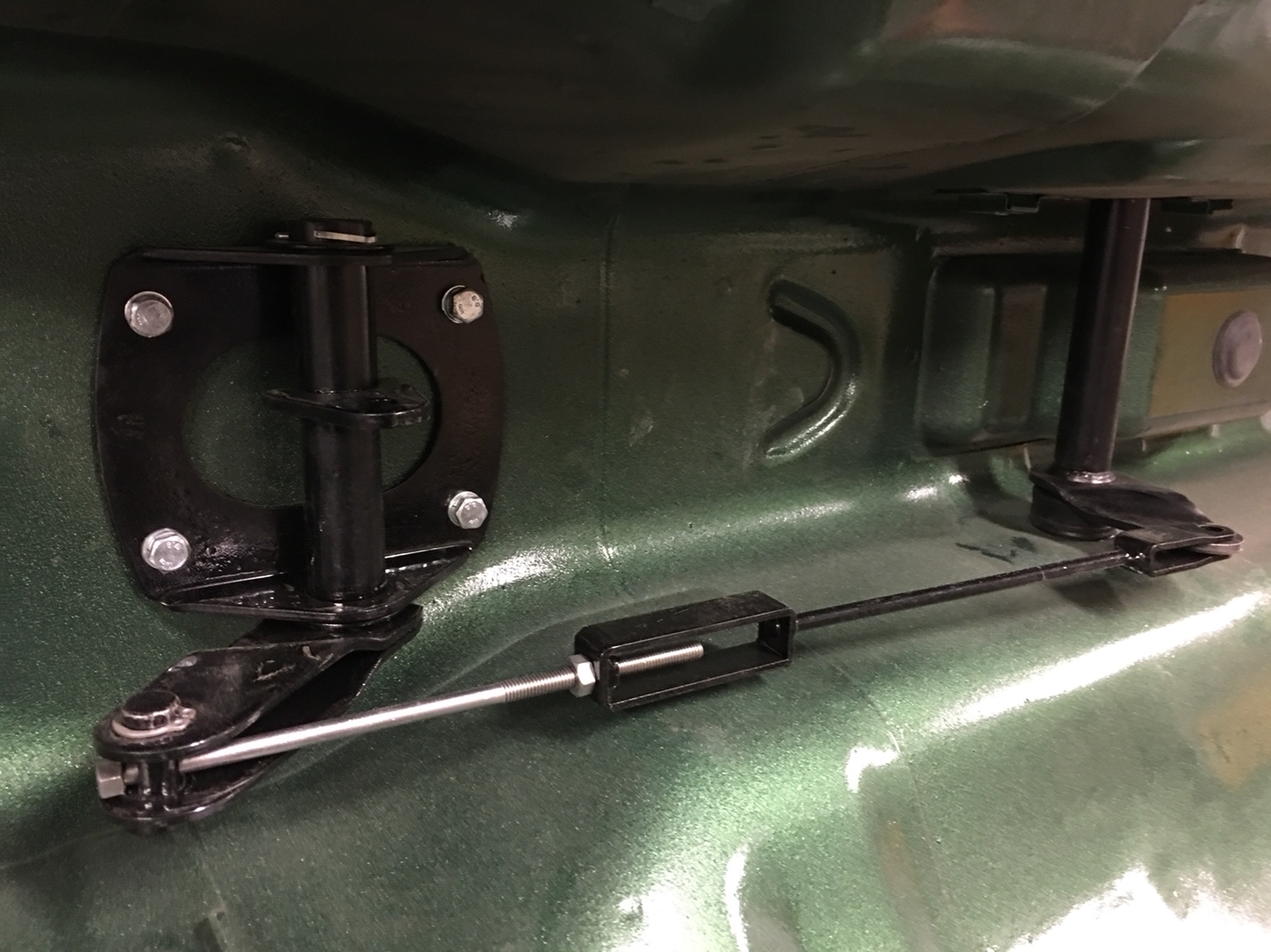

I didn't like my parking brake handle flopping around either so I added a spring. But I put mine topside.
Details in this thread (which I just updated with replacement pics): http://www.classiczcars.com/topic/49952-parking-brake-handle-return-spring/

My relatively weak topside spring is just enough to load the handle itself so it's held positively at the bottom of travel even when I have a little slack in the rest of the linkage.
Well that makes sense... my car did not come with any spring in that position as the rear brakes were all but completely missing inside the drums. The cables were slack and the mechanism clogged with asphalt underspray.... I will look at this again.

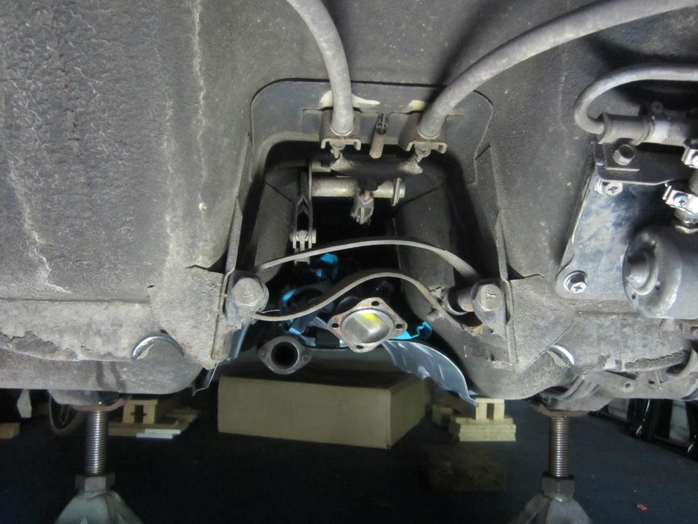

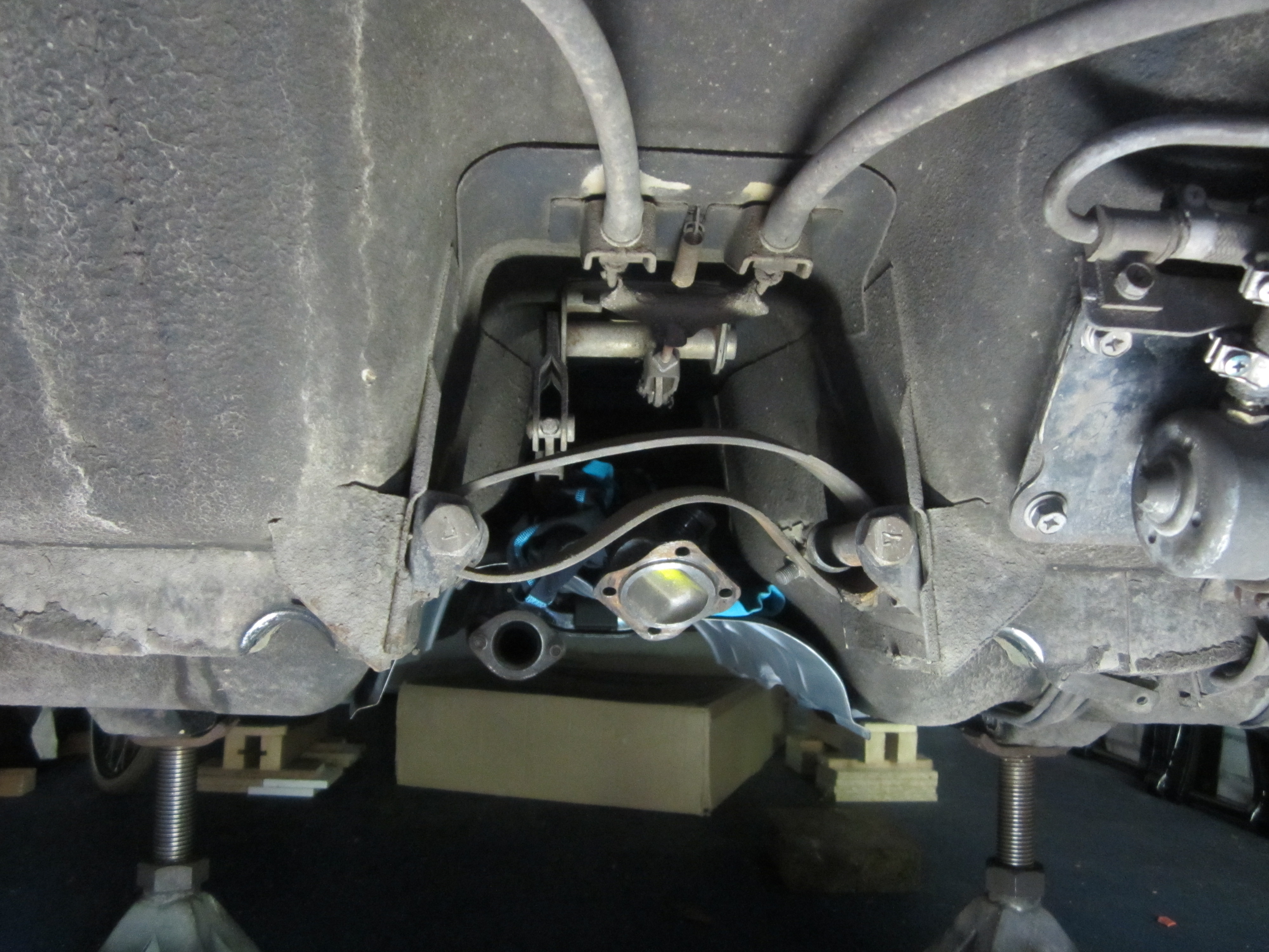

Without crawling under my car for confirmation, I believe that rear mounted spring connects between the tab on the body (with the small hole in it) and the yoke that pulls on the cables. I took a quick look in the FSM and couldn't find a pic of it, but I did have this pic. Pic was intended to show hard line routings of fuel pump, etc, but if you squint a little and **** your head to the side a little like a confused dog, you can see a spring in there between the yoke and the body:
So the question would be... Do you already have a corresponding small hole in the yoke?
Your pic didn't load, but I remember seeing a small notch in the yoke of the cable pull that would accommodate the other end of the spring... makes sense now.
