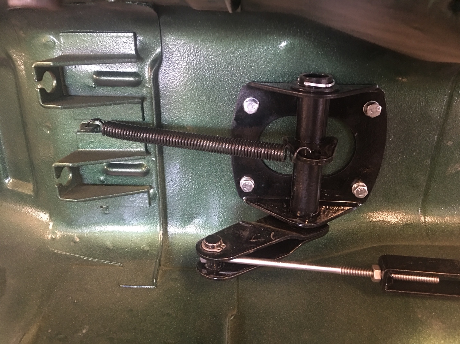

December 9, 20177 yr Author comment_537043 Added a spring for tension until I find a solution to my park brake issue. The second picture shows the notch in the yoke assembly for the factory tension spring. Link to comment https://www.classiczcars.com/forums/topic/50908-1976-280z-restoration-project/?&page=140#findComment-537043 Share on other sites More sharing options...

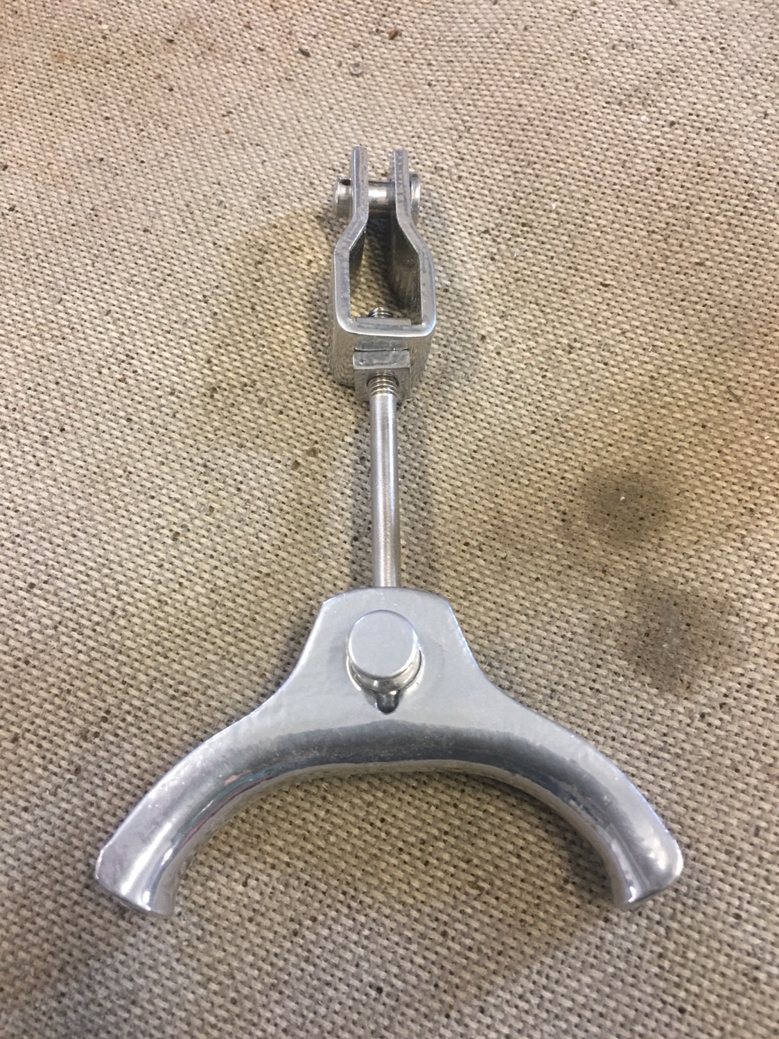

December 10, 20177 yr comment_537102 On 9-12-2017 at 3:57 PM, Captain Obvious said: Chas, Thanks for that closer-up pic of the spring. I think the pic I posted is of your car as well. I had "hoovered" some pics of cars when I was working on fuel line routing and piping, and you had posted a bunch that were quite helpful to figure out how things should be routed. Thanks!! Well I'll be damned. Looking at your photo I didn't realise thats my car. Had a quick look through the photos and this one shows the spring connecting to cable yoke a little better. Link to comment https://www.classiczcars.com/forums/topic/50908-1976-280z-restoration-project/?&page=140#findComment-537102 Share on other sites More sharing options...
December 10, 20177 yr comment_537103 On 9-12-2017 at 7:11 PM, wheee! said: Added a spring for tension until I find a solution to my park brake issue. The second picture shows the notch in the yoke assembly for the factory tension spring. Mark, I think the spring connecting to the yoke will give you the best result. That way all the "loose" components will be under spring tension and not rattle. With the spring connecting to the lever, the yoke will hang loose and rattle like mine did. Talking for experience here..... Link to comment https://www.classiczcars.com/forums/topic/50908-1976-280z-restoration-project/?&page=140#findComment-537103 Share on other sites More sharing options...
December 10, 20177 yr Author comment_537109 I agree Chas, but I am not adding the yoke yet as I do not have a good cable or the right cable for the park brakes yet. This will keep things tight for now. Link to comment https://www.classiczcars.com/forums/topic/50908-1976-280z-restoration-project/?&page=140#findComment-537109 Share on other sites More sharing options...
