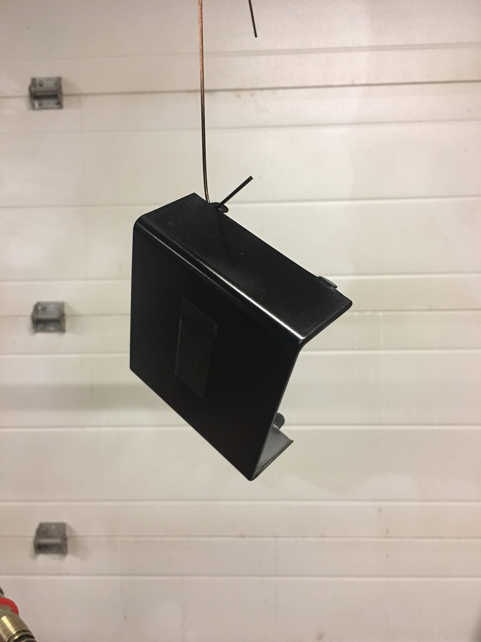

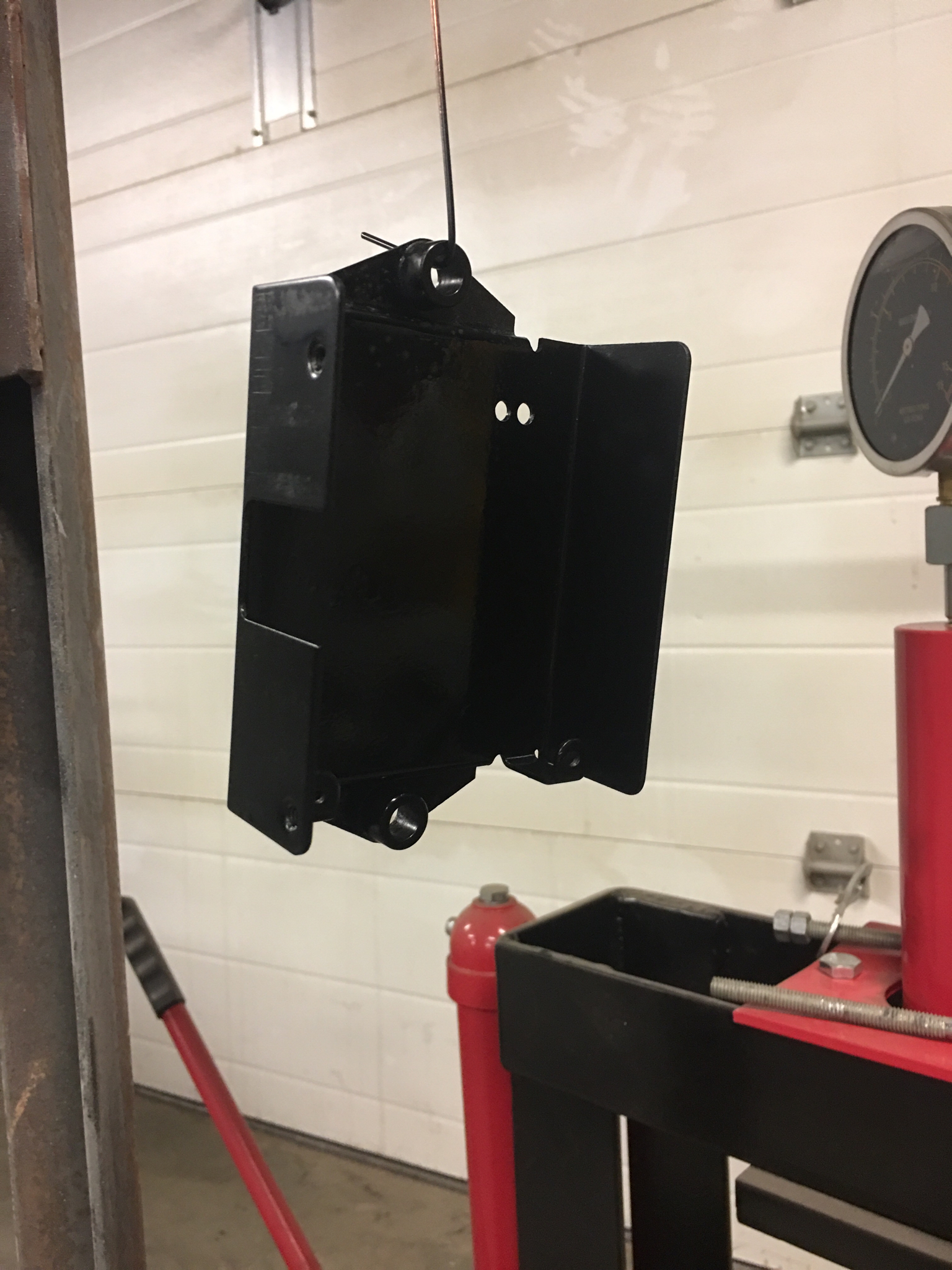

December 15, 20177 yr Author comment_537505 Wired up my carbon fibre heat lamp today. Now I can powder coat large items. The lamp head moves up and down the pole. I will hang large objects in front of the lamp and then move the lamp around the object to cure the powder. Close up of the carbon fibre elements. Link to comment https://www.classiczcars.com/forums/topic/50908-1976-280z-restoration-project/?&page=141#findComment-537505 Share on other sites More sharing options...

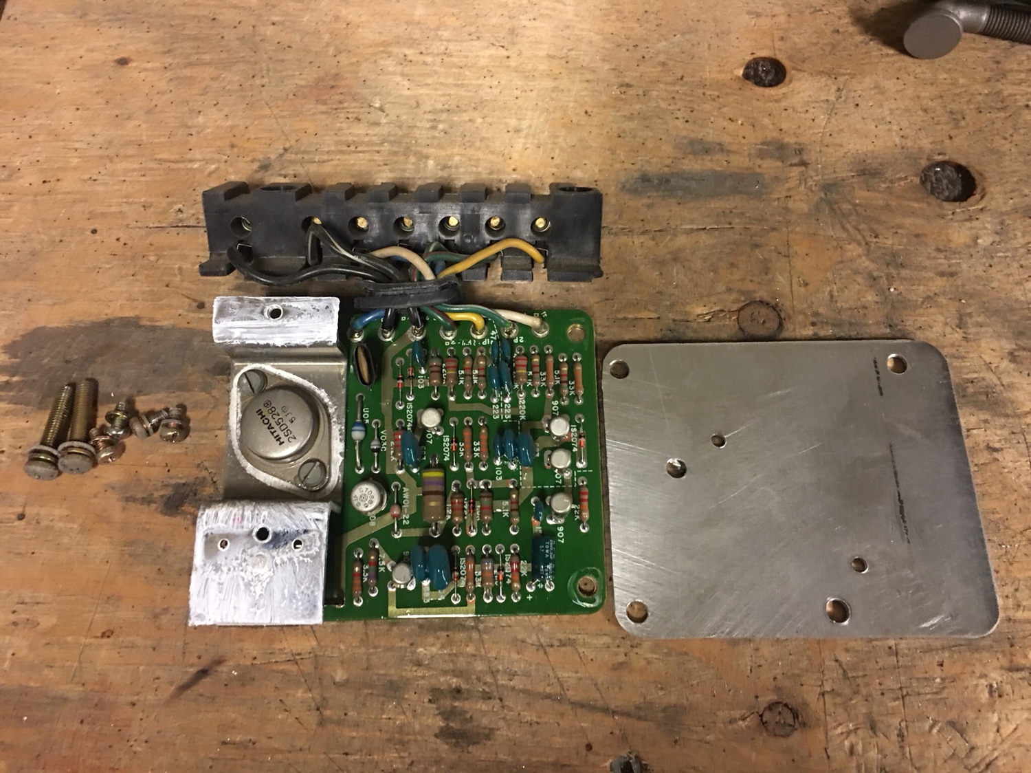

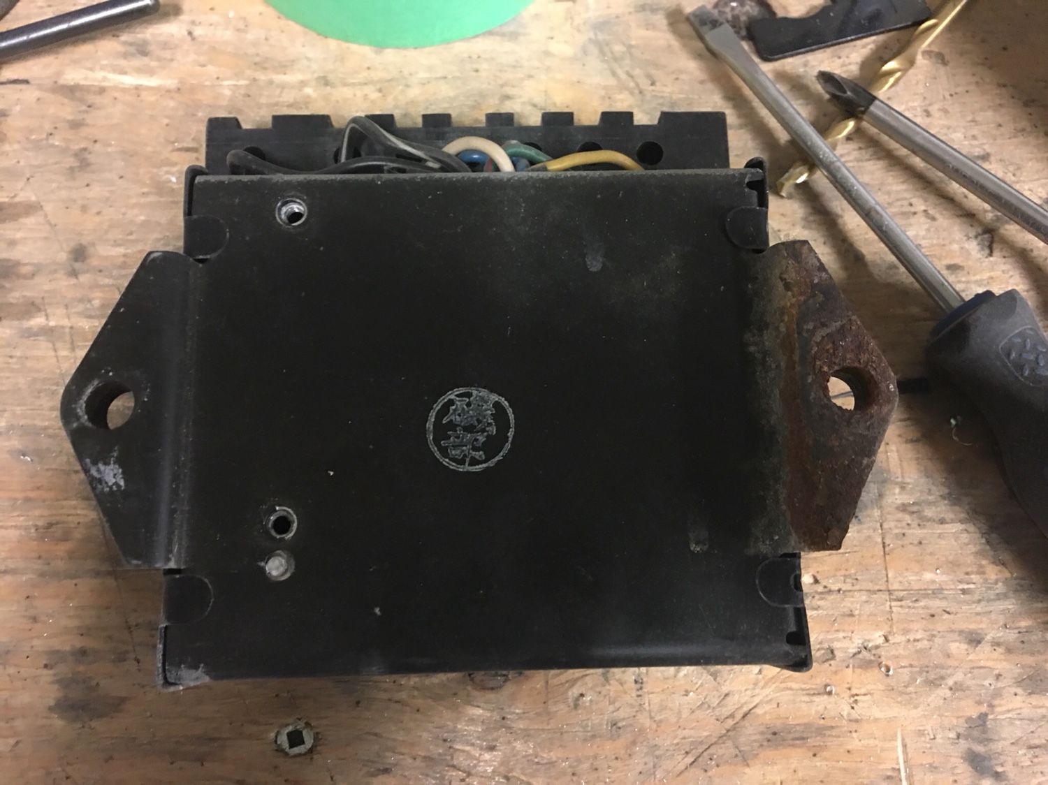

December 15, 20177 yr Author comment_537507 Also started work on the HEI ignition upgrade for the GM 4 pin moduleOpened the case, drilled out the new aluminum heat sink, and stripped and painted the case to get rid of the little bit of rust on the mounting tabs. Link to comment https://www.classiczcars.com/forums/topic/50908-1976-280z-restoration-project/?&page=141#findComment-537507 Share on other sites More sharing options...
December 15, 20177 yr comment_537514 Mark. When you cut the wires of the circuit board, cut them as close as possible to the board. That will give you move room to move during the assembly. My experience...... Link to comment https://www.classiczcars.com/forums/topic/50908-1976-280z-restoration-project/?&page=141#findComment-537514 Share on other sites More sharing options...
