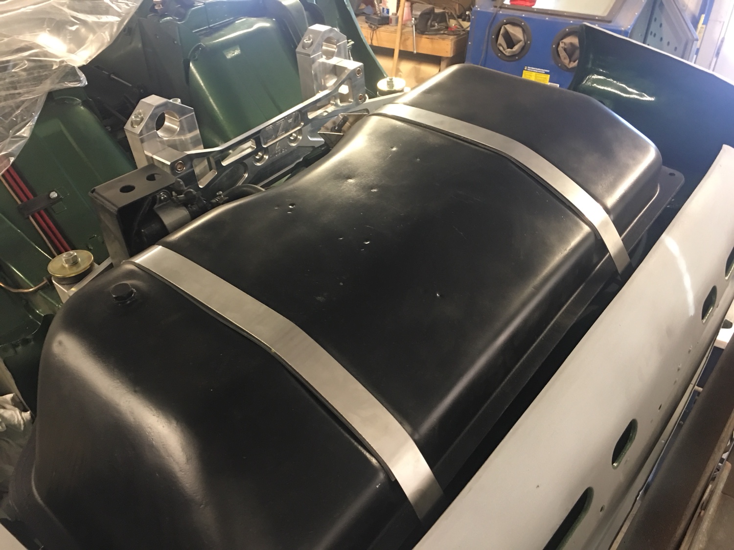

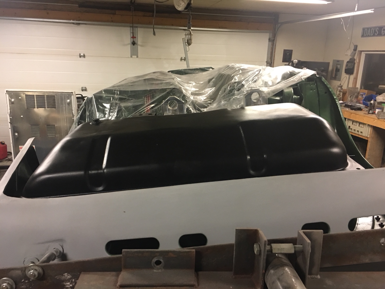

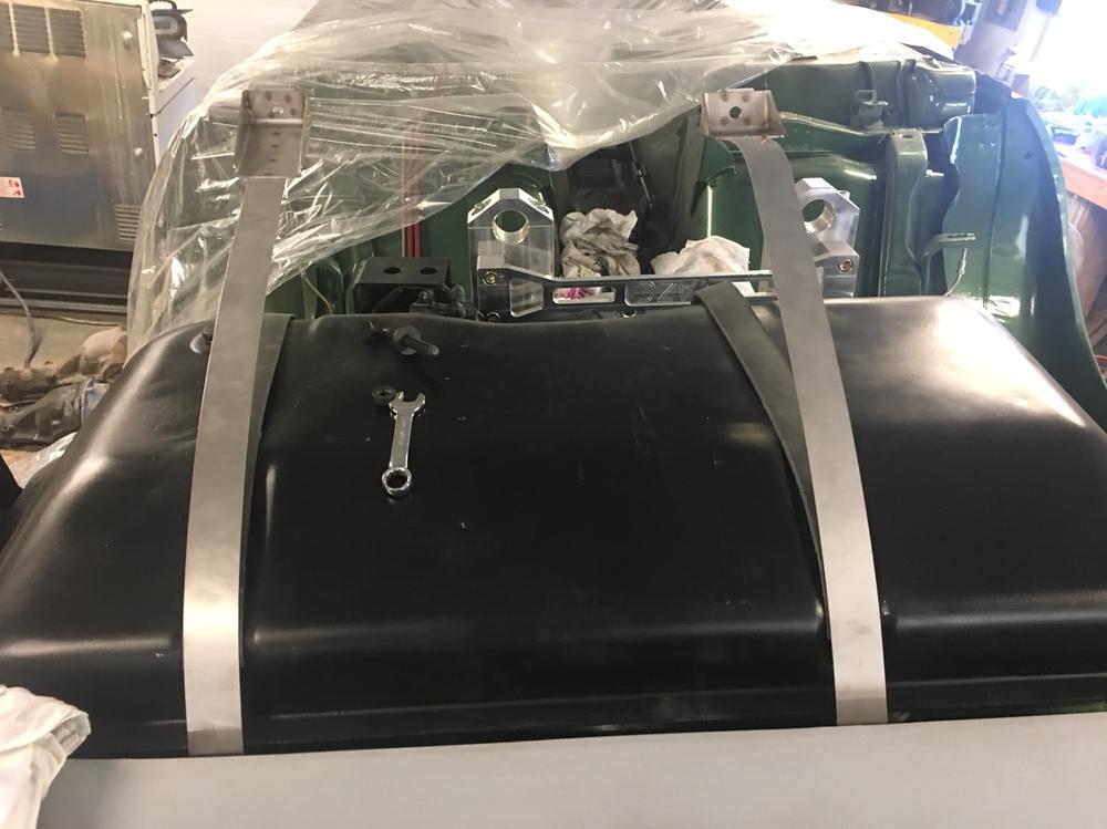

Pushed away from the table, put the turkey down and came back out to the shop today.
Using baseboard material to insulate the Skillard tank straps to the tank. Cut to 1 3/8”
Then assembled the tank with the restored J bolts.

Nice work.  I can't wait to see this one done.  I insulated my straps with bicycle inner tubes.  I like your solution better.
Hey, quick thought.  When you sealed your tank did you remember to poke through the pickups to ensure you didn't seal them?  Ask me why I said that! ;-)
Edited by ksechler
I looked at bicycle tubes and was not happy with the way they would lay on the tank. Plus the vinyl baseboard was really cheap and thicker (about 1mm). It also lays extremely well on the tank and is easy to cut in a perfect straight line.
As for the tank, I coated it and then carefully blew out all the vent and pump lines with my air compressor. They all seem to have good flow so I am happy.
I still have to connect the neck line from the tank to the filler door, but I don’t want it in place while I’m doing body work and paint. Hopefully it won’t be too hard to install later.
