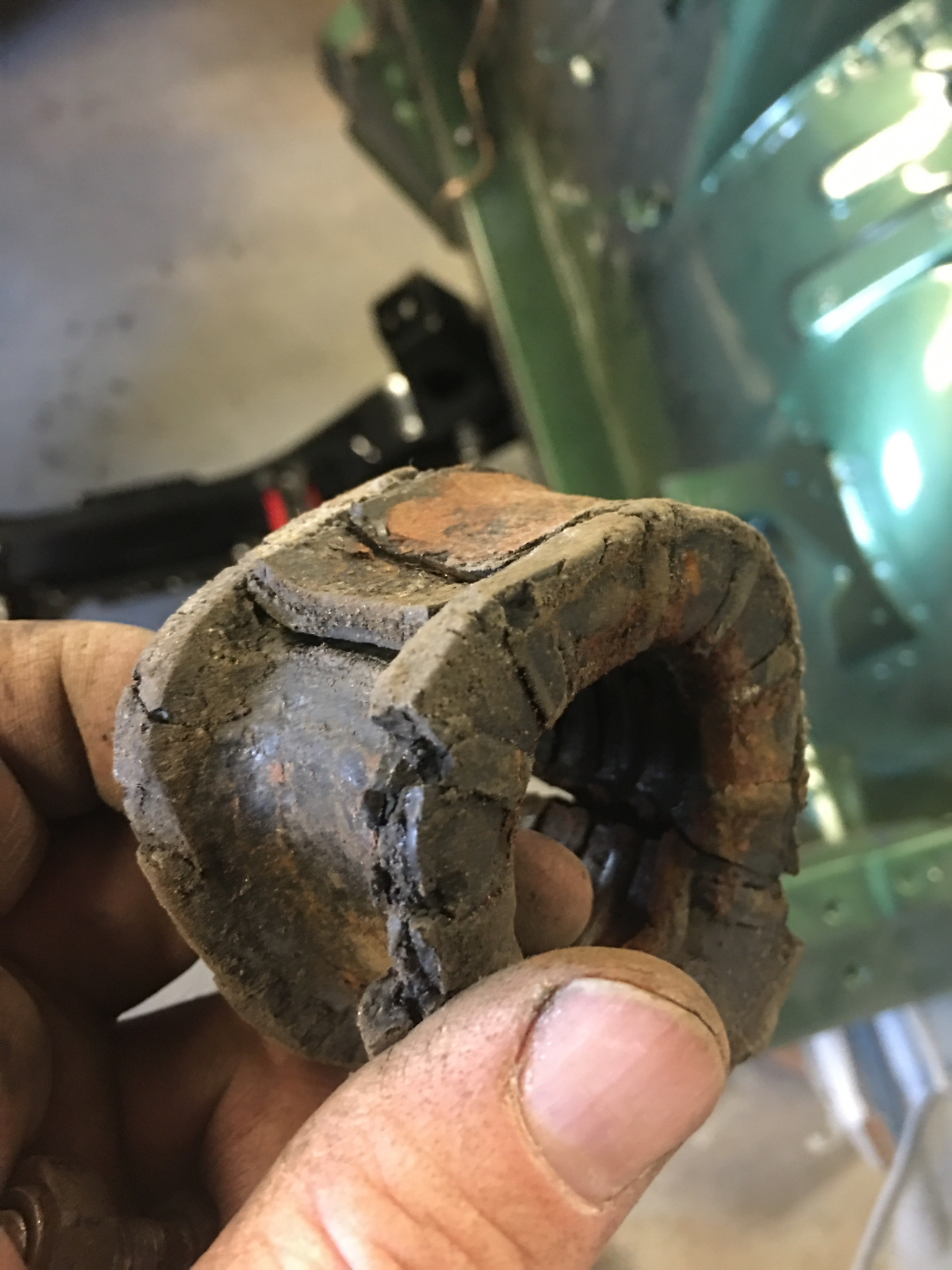

9 hours ago, wheee! said:
Previous owner obviously had some play in the steering rack...
Ouch, thatlooks nasty. Looks like the rubber was falling apart in the end.

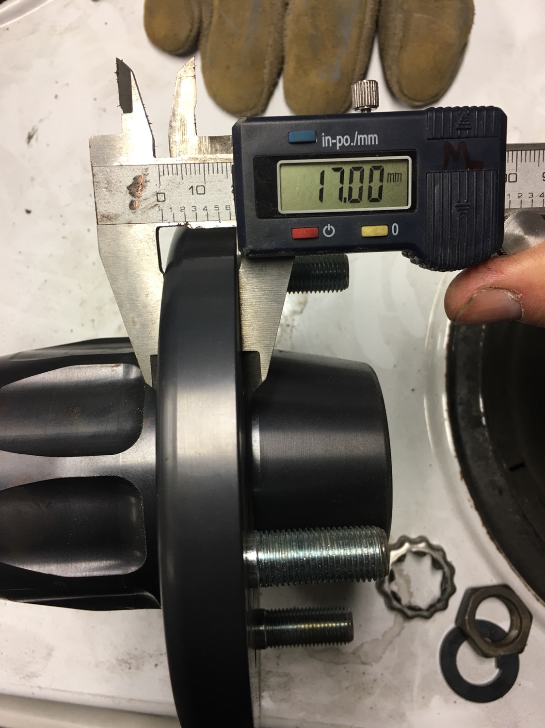

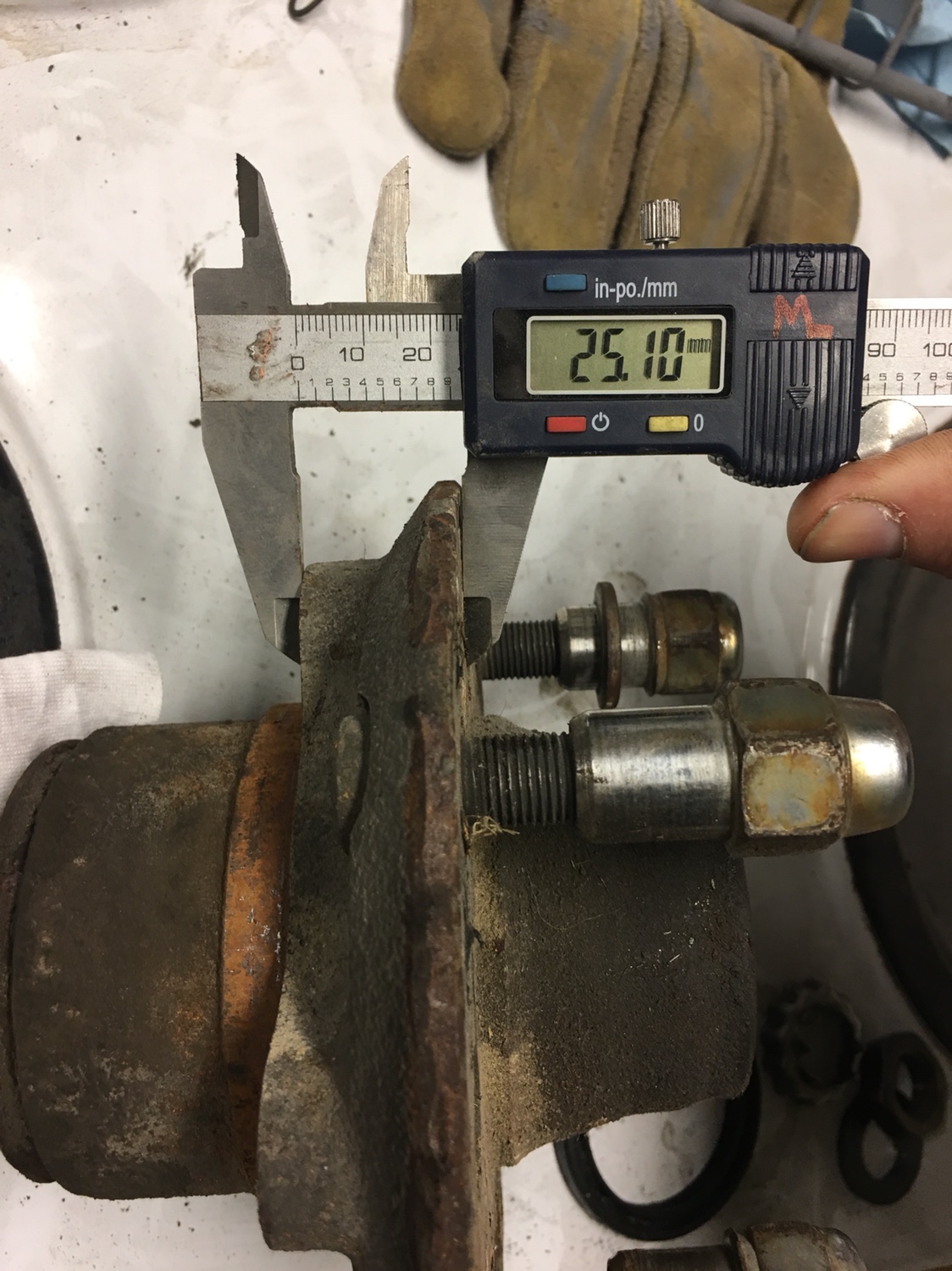

Learned something else yesterday too. The Techno Toy Tuning custom hubs are beautiful BUT they are only manufactured in the 240Z offset. They are supposed to come with spacers for the 280Z application. Needless to say, my package shipped without the spacers and I discovered the issue as I was trying to mount my BBK without luck. 8mm difference in offset means nothing lines up. Good news is they are shipping out the adapter plates for me today.

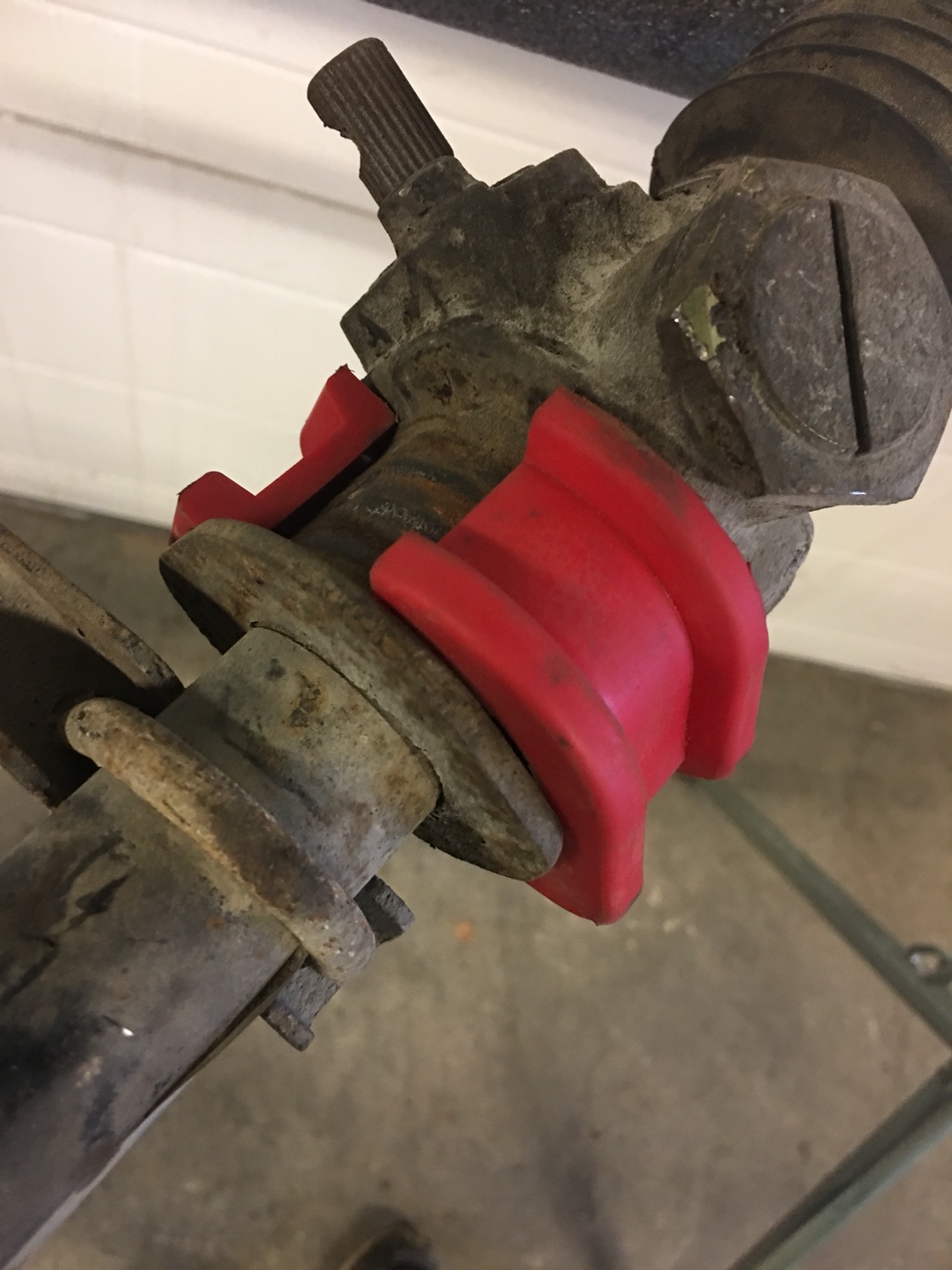

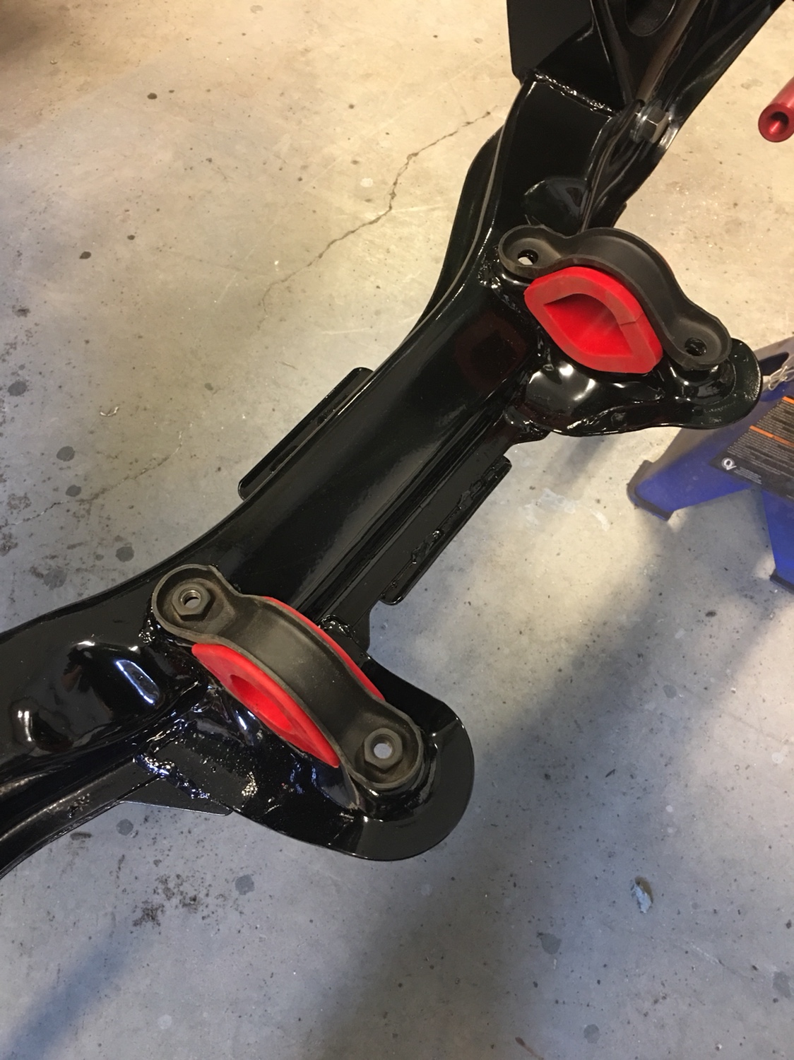

Nice job on the crossmember. Looks neat and I agree with the gloss finish being easier to clean.

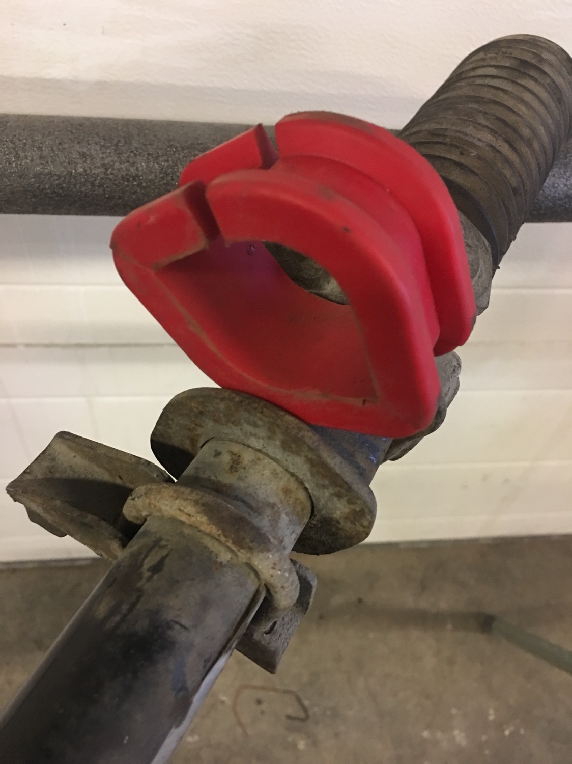

Thanks Chas! The replacement poly bushing kit for the 280Z is very nice, but the driver side bushing is too wide for the rack and needs to be trimmed down to fit. Not too happy about that. It is also almost a little small for the circumference as well. Might be the wrong part in the energy suspension kit but it is labeled as a 280Z part.
The passenger side fits great.
Edited by wheee!
240 racks have a narrower driver's side flange on the racks, so maybe your rack is 240 but the bushing is 280? I need to go measure each of them. Hang on.
All that said, the poly bushings are a very very tight fit. Many have trimmed the inside edge to match the chamfered/rounded rack casting down at the bottom of the flanges and I've had to use hose clamps and grease to squeeze those suckers in place. Usually have to use longer M8 bolts to catch the caps without the bushings fully seated then tighten them down to squeeze everything together. Later you can change out the bolts to the right length.
