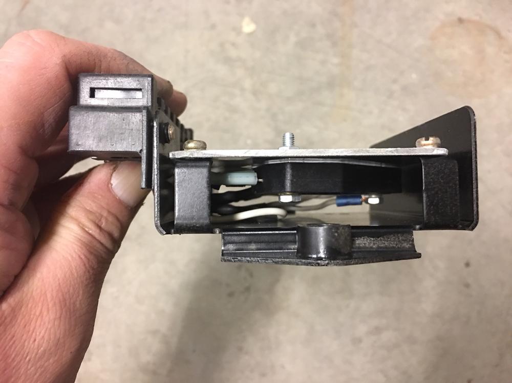

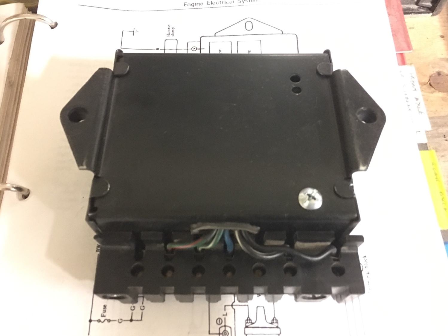

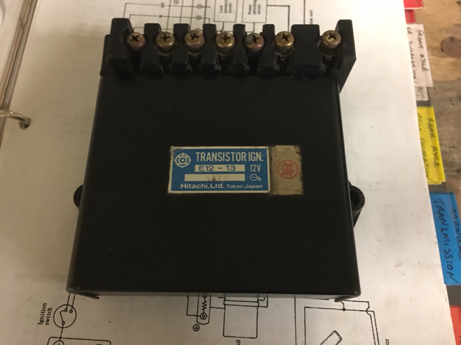

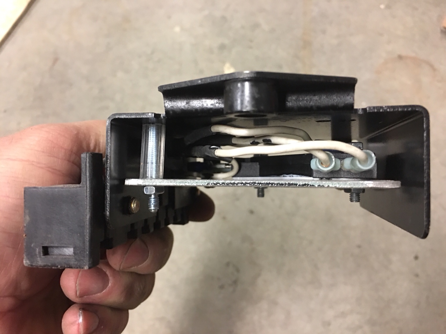

January 16, 20187 yr Author comment_539846 Finally finished up the ignition unit. Looks nice and neat now! Link to comment https://www.classiczcars.com/forums/topic/50908-1976-280z-restoration-project/?&page=152#findComment-539846 Share on other sites More sharing options...

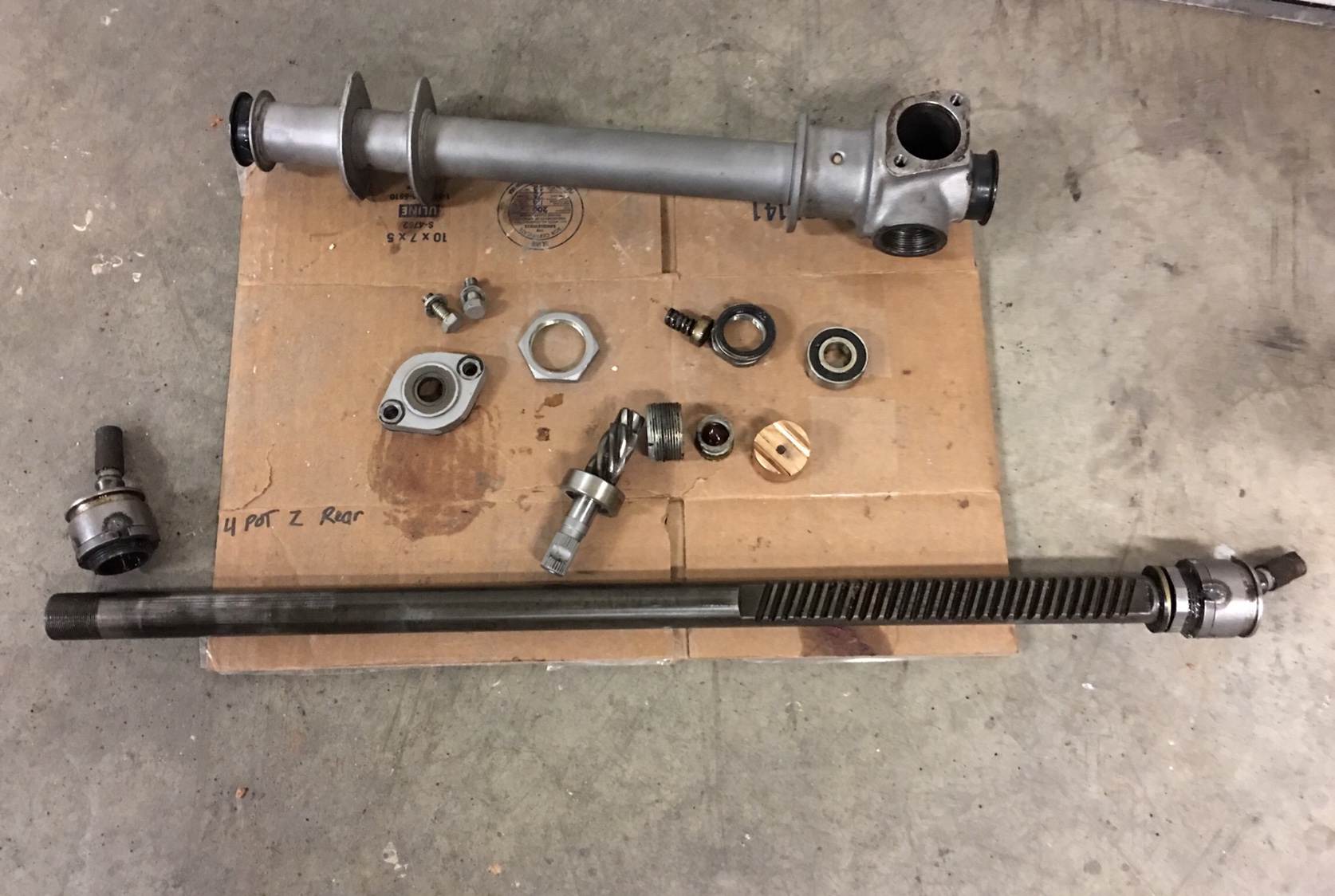

January 16, 20187 yr Author comment_539854 And got the steering rack apart. Now to clean the sucker! Link to comment https://www.classiczcars.com/forums/topic/50908-1976-280z-restoration-project/?&page=152#findComment-539854 Share on other sites More sharing options...
January 16, 20187 yr Author comment_539857 Surprisingly, the lower pinion bearing came out without a fight. It was not pressed completely to the bottom so I was able to lift it out with a bolt head! Link to comment https://www.classiczcars.com/forums/topic/50908-1976-280z-restoration-project/?&page=152#findComment-539857 Share on other sites More sharing options...

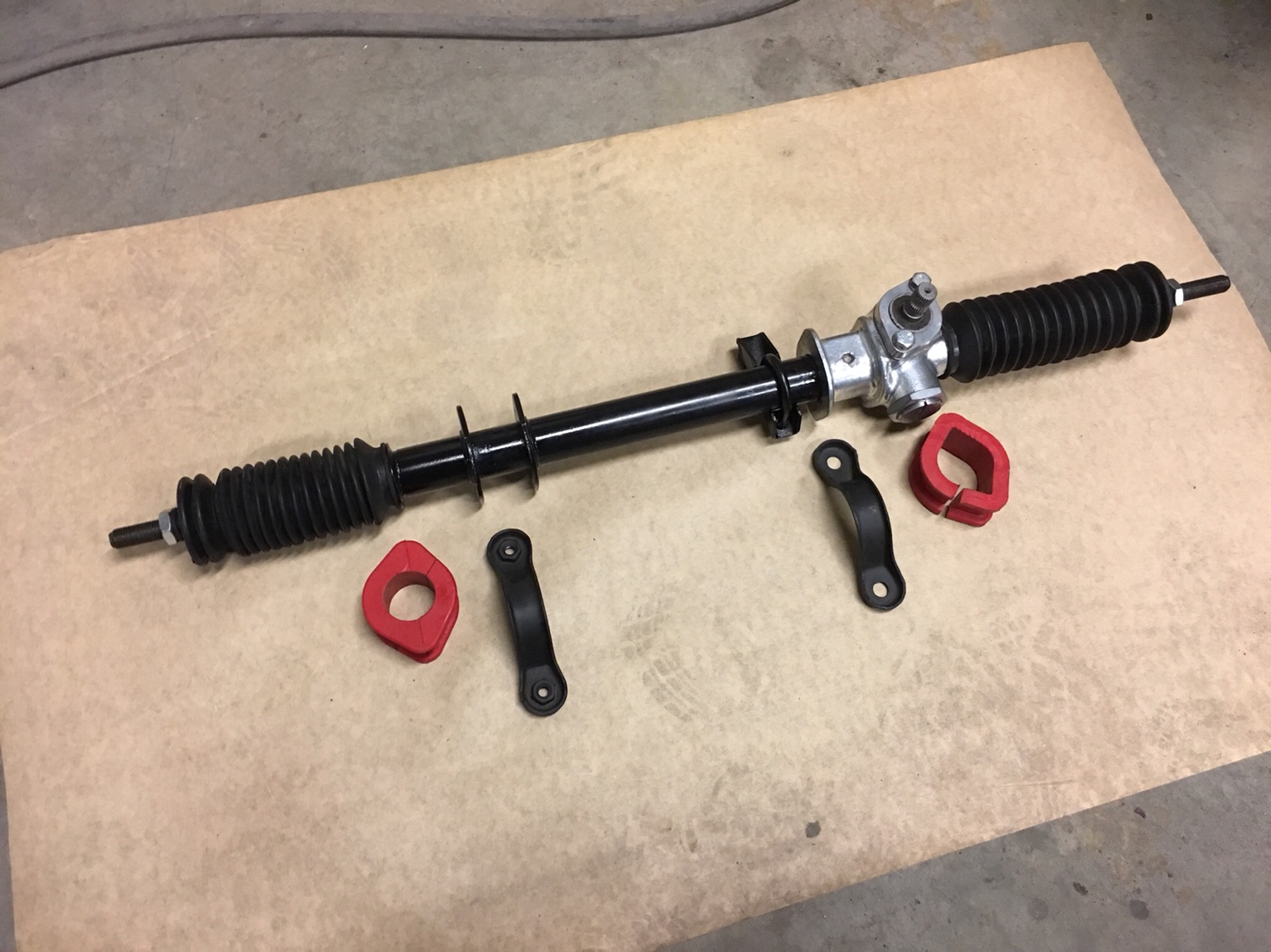

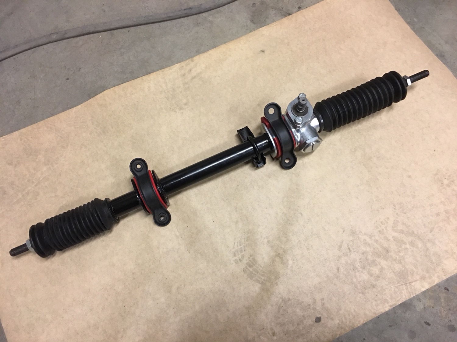

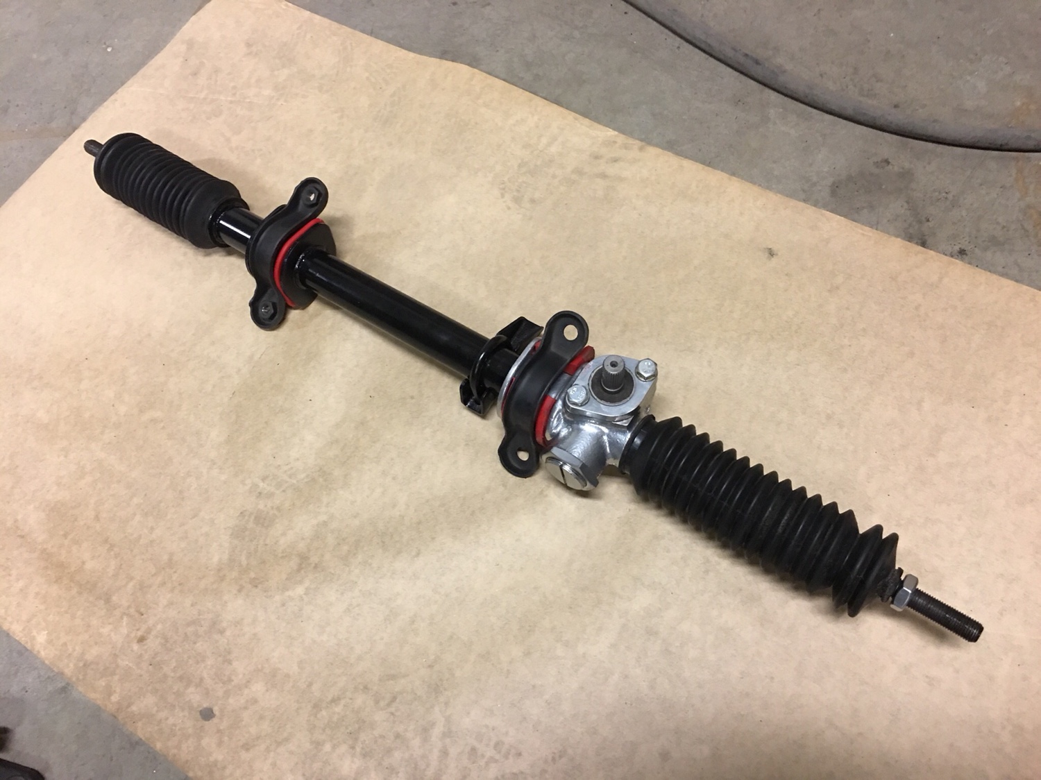

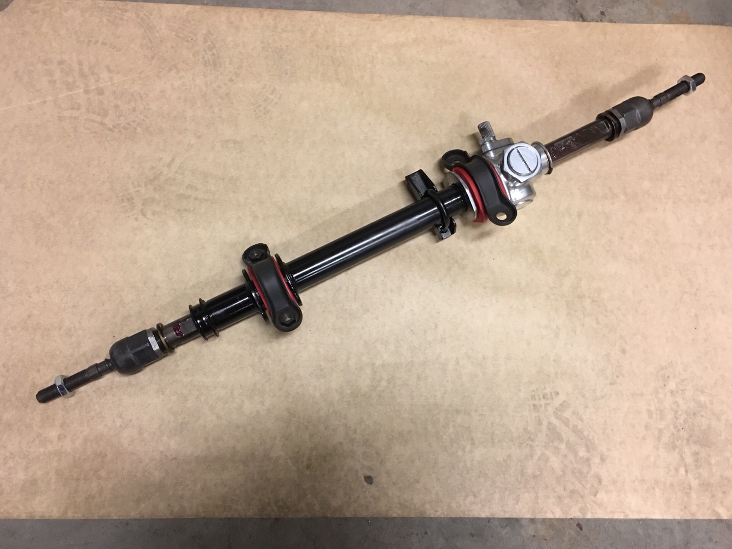

January 19, 20187 yr Author comment_540202 Rack is done! What do you think of my colour scheme? Link to comment https://www.classiczcars.com/forums/topic/50908-1976-280z-restoration-project/?&page=152#findComment-540202 Share on other sites More sharing options...
January 19, 20187 yr comment_540220 Looks really good. I like that color combo. Do you have the part numbers for the bushings you used? Link to comment https://www.classiczcars.com/forums/topic/50908-1976-280z-restoration-project/?&page=152#findComment-540220 Share on other sites More sharing options...

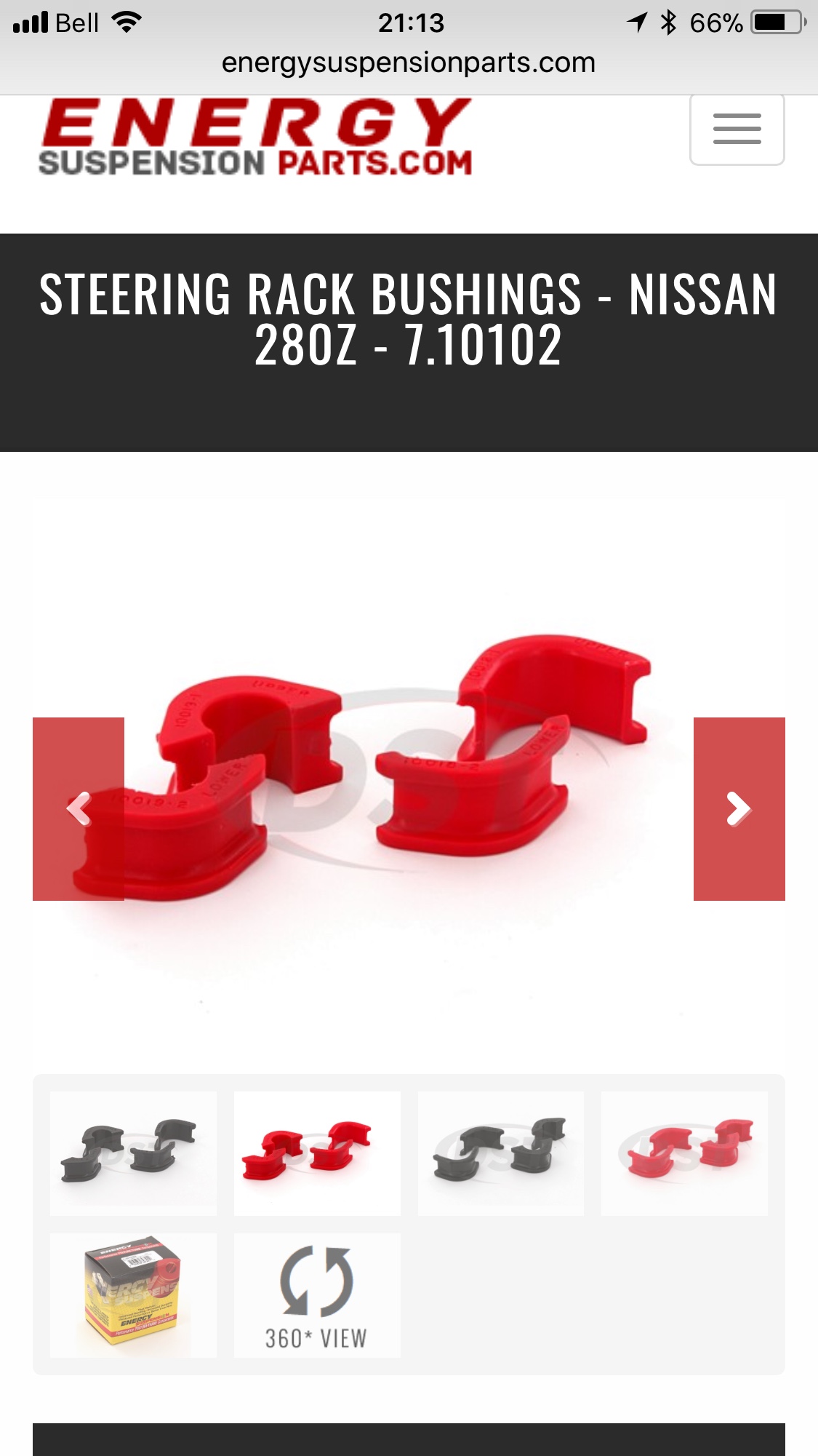

January 19, 20187 yr Author comment_540221 I bought the prothane bushings from Techno Toy Tuning and they DO NOT fit. I have to order the energy suspension ones. Link to comment https://www.classiczcars.com/forums/topic/50908-1976-280z-restoration-project/?&page=152#findComment-540221 Share on other sites More sharing options...
January 19, 20187 yr comment_540222 Yeah, I was gonna say... The paint scheme looks great, but those bushings still look like they are trouble. Here's to hoping the new bushings are a better fit. And don't forget to address that big gap on the end by the steering box. It won't get any better if you try to install it the way you have it. I'm not sure if all the mfgrs have the same sharp internal corner or not. Link to comment https://www.classiczcars.com/forums/topic/50908-1976-280z-restoration-project/?&page=152#findComment-540222 Share on other sites More sharing options...
January 19, 20187 yr Author comment_540224 I totally agree. The bushings will be replaced with correct fitting ones. These pics were more to give an idea of the finished look and colour scheme. The feedback I got was to minimize the red in the rack, so I went this way with the colours. Even in the picture of the Energy Suspension bushings, you can see how the two part bushing is going to be a better fit. Link to comment https://www.classiczcars.com/forums/topic/50908-1976-280z-restoration-project/?&page=152#findComment-540224 Share on other sites More sharing options...
January 19, 20187 yr comment_540260 Are those new inner tie rods or just the old ones cleaned up? Look new to me. Link to comment https://www.classiczcars.com/forums/topic/50908-1976-280z-restoration-project/?&page=152#findComment-540260 Share on other sites More sharing options...
January 19, 20187 yr Author comment_540262 Brand new from TTT. They are right right for future ease of replacement. Not that I should have to with the TTT outers... Link to comment https://www.classiczcars.com/forums/topic/50908-1976-280z-restoration-project/?&page=152#findComment-540262 Share on other sites More sharing options...

January 20, 20187 yr Author comment_540270 I was surprised how easy it was really. Even the bearing removal went easy for me. Link to comment https://www.classiczcars.com/forums/topic/50908-1976-280z-restoration-project/?&page=152#findComment-540270 Share on other sites More sharing options...
