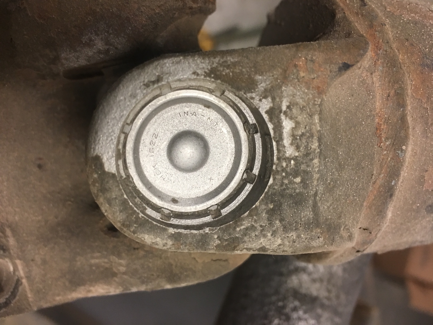

wheee! Posted February 13, 2018 Author Share #1837 Posted February 13, 2018 Okay. What kind of witchcraft is this??How the heck do I remove the u joints from the prop shaft? Link to comment Share on other sites More sharing options...
Zed Head Posted February 13, 2018 Share #1838 Posted February 13, 2018 They're meant to be permanent. "Staked" is the term to describe them. Some driveshaft shops will machine out the stakes and make a circlip groove, or replace the joint and and restake it. It's a bummer. Link to comment Share on other sites More sharing options...
wheee! Posted February 13, 2018 Author Share #1839 Posted February 13, 2018 Well that is not cool. My u joints are toast. Link to comment Share on other sites More sharing options...
Zed Head Posted February 13, 2018 Share #1840 Posted February 13, 2018 (edited) Apparently they started staking in 1975. So a 74 or older shaft will have replaceable joints. The very early 1971 shafts, which are shorter, won't fit though. But if you want the really good Nissan high-precision u-joints, they're about $70 each. Edited February 13, 2018 by Zed Head though placement Link to comment Share on other sites More sharing options...

Captain Obvious Posted February 13, 2018 Share #1843 Posted February 13, 2018 Well I have great faith in you that if you really wanted that old U-joint out of the shaft, you could accomplish that task. Complete confidence. So a question for the collective... On the driveshaft's with the staked in U-joints. If you DO manage to get the old U-joint out, are new replacements available? Link to comment Share on other sites More sharing options...
wheee! Posted February 13, 2018 Author Share #1844 Posted February 13, 2018 From what I understand, the prop shaft needs to be machined to include a groove for the c clips after the staked u joints are pressed out. Doesn't seem like its worth it versus sourcing an older shaft to replace it with. Not interested in the hi performance aluminum versions or the ridiculously expensive offerings from re sellers for stock units. Link to comment Share on other sites More sharing options...
Mike W Posted February 13, 2018 Share #1845 Posted February 13, 2018 As I recall when I replaced the U Joints on my half shafts as well as the driveshaft, the C clips are actually installed on the U joints themselves (on the inside of the yoke) and so I don't really understand the need for a groove to be cut. As long as the U Joints are of the same size I believe you should be able to just install new ones. Perhaps I'm missing something but this seems like it would work to me. Does anyone know if the U Joint sizes are the same between the serviceable driveshafts and the newer non-serviceable ones? Mike. 1 Link to comment Share on other sites More sharing options...

EuroDat Posted February 13, 2018 Share #1848 Posted February 13, 2018 (edited) 1 hour ago, Mike W said: As I recall when I replaced the U Joints on my half shafts as well as the driveshaft, the C clips are actually installed on the U joints themselves (on the inside of the yoke) and so I don't really understand the need for a groove to be cut. As long as the U Joints are of the same size I believe you should be able to just install new ones. Perhaps I'm missing something but this seems like it would work to me. Does anyone know if the U Joint sizes are the same between the serviceable driveshafts and the newer non-serviceable ones? Mike. Mike, If you try this you will come across several problems, or should I say challenges to some of us here 1. The uni-joints on the propeller shaft after 7/75 are much smaller than the earlier units. You can't use the early style/half shaft uni-joints. 2. You need to find uni-joints of the smaller size with grooves in the cups for circlips. Not many of the smaller ones do. They are out there. I did find some and noted the part numbers. Ill look them up and post them later. That brings up the next problem. 3. Finding a uni-joint with circlip grooves the right distance apart of 36mm. Lets face it, parts are getting scarce. It would be nice to have this option. Edited February 13, 2018 by EuroDat Link to comment Share on other sites More sharing options...
