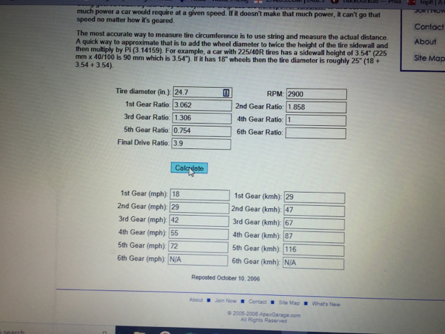

I do not put on many long runs on highway at speeds over 75. Very happy with it. IMG_6117.JPGIMG_6118.JPG
72 body and block, everything else 71, Tokico springs, Illumina, R180 CLSD, 83 close ratio, 3.90 gears, Ztherapy SUs, BRE 15X7 Libre wheels and BRE front spoiler.

Do you have a link to the calculator you used? The gear ratios in the first calc for the 3.90 are a little off for 3rd and 5th. Should be 1.308 and .745
