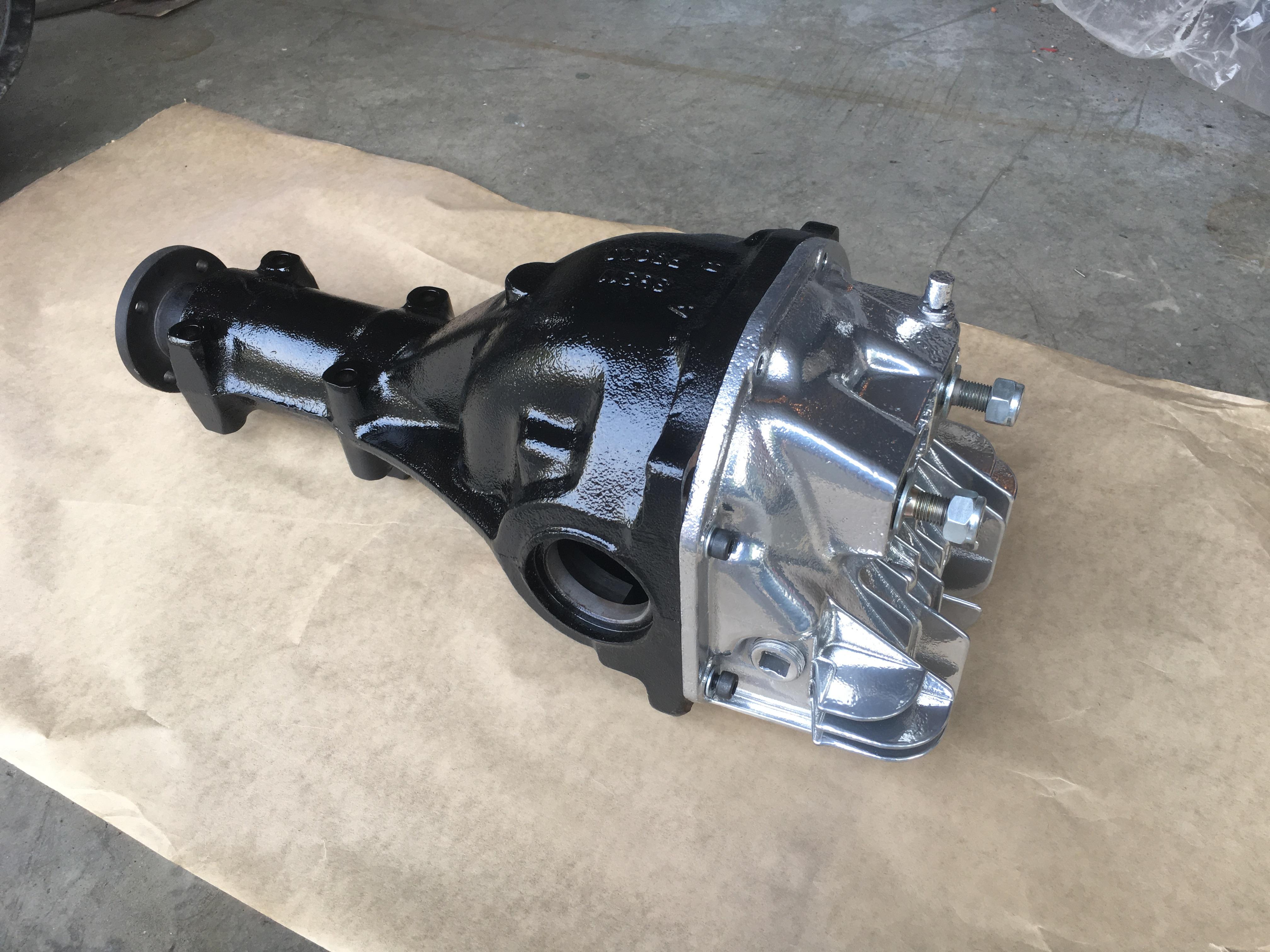

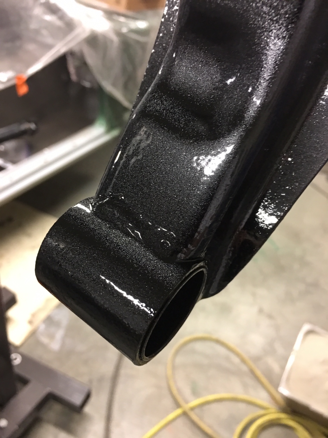

August 31, 20186 yr Author comment_556556 Powder coat is done on the diff case and cover. Looks good sitting together! Now to complete the rebuild and reinstall the seals and gears. Link to comment https://www.classiczcars.com/forums/topic/50908-1976-280z-restoration-project/?&page=173#findComment-556556 Share on other sites More sharing options...
August 31, 20186 yr comment_556557 Looking sharp! Going to be a nice restomod when you're done. Link to comment https://www.classiczcars.com/forums/topic/50908-1976-280z-restoration-project/?&page=173#findComment-556557 Share on other sites More sharing options...

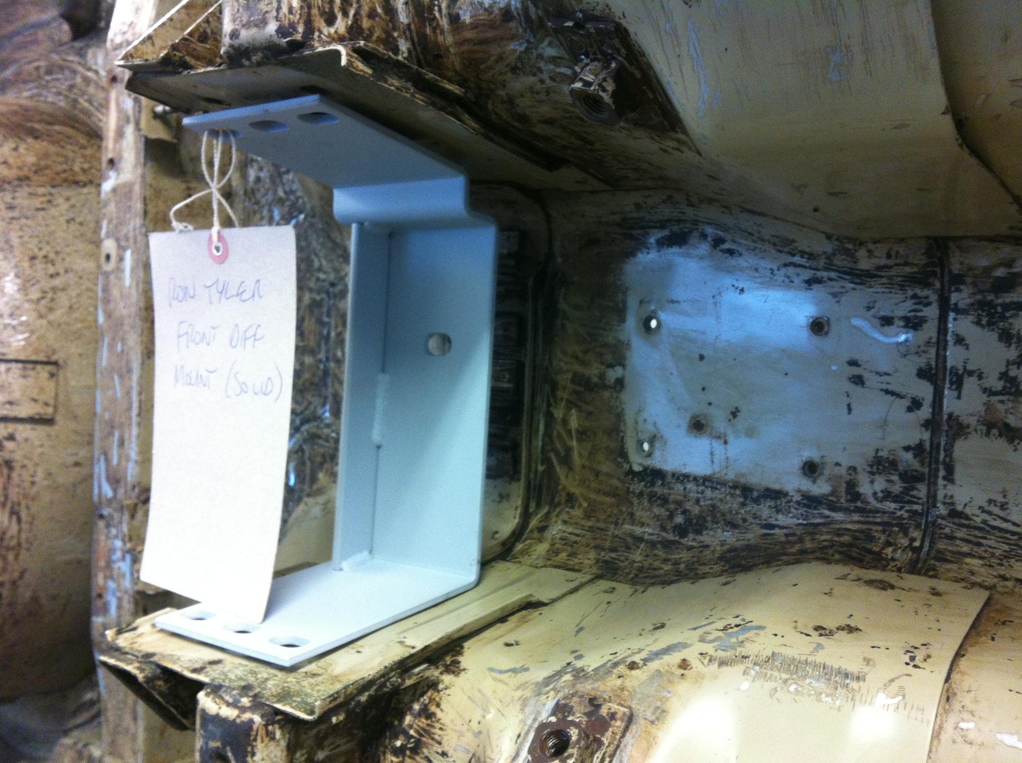

September 4, 20186 yr Author comment_556811 Diff complete! Preload and gear swipe is on target. All seals and hardware replaced. Ron Tyler diff mount installed and ready to bolt up in the car! Link to comment https://www.classiczcars.com/forums/topic/50908-1976-280z-restoration-project/?&page=173#findComment-556811 Share on other sites More sharing options...

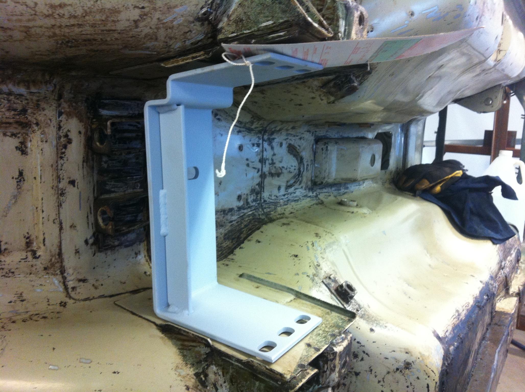

September 4, 20186 yr comment_556820 Have you pre fitted the R/T mount and know that it will slide up into place? I ask because I have had to do some major hammering to get one in and the bolts a lined. The diff looks great. Link to comment https://www.classiczcars.com/forums/topic/50908-1976-280z-restoration-project/?&page=173#findComment-556820 Share on other sites More sharing options...
September 4, 20186 yr Author comment_556824 11 hours ago, grannyknot said: Have you pre fitted the R/T mount and know that it will slide up into place? I ask because I have had to do some major hammering to get one in and the bolts a lined. The diff looks great. What? You don’t remember 45 pages back that we test fit the r/t mount in the tunnel when you asked the same question?? EDIT: Actually looked, and the test fit question was back on page 8 of this thread! yeesh how time flies! Edited September 4, 20186 yr by wheee! Link to comment https://www.classiczcars.com/forums/topic/50908-1976-280z-restoration-project/?&page=173#findComment-556824 Share on other sites More sharing options...
September 4, 20186 yr comment_556863 10 hours ago, wheee! said: What? You don’t remember 45 pages back that we test fit the r/t mount in the tunnel when you asked the same question?? Listen ya young whipper snapper, one of these days you will start having senior moments then we'll see who's laughing. Link to comment https://www.classiczcars.com/forums/topic/50908-1976-280z-restoration-project/?&page=173#findComment-556863 Share on other sites More sharing options...
September 4, 20186 yr Author comment_556868 I actually had to look for spacers to fit the diff mount so it doesn’t stretch when I bolt it up. About 5mm a side of clearance between the tunnel and the diff mount. Too MUCH space! Link to comment https://www.classiczcars.com/forums/topic/50908-1976-280z-restoration-project/?&page=173#findComment-556868 Share on other sites More sharing options...
September 5, 20186 yr comment_556876 But your R/T mount was not made by Technoversions, right? The 2 R/T mounts that I had trouble were from Technoversions. Link to comment https://www.classiczcars.com/forums/topic/50908-1976-280z-restoration-project/?&page=173#findComment-556876 Share on other sites More sharing options...
September 5, 20186 yr Author comment_556877 I can’t confirm if it is an original techno version or not. It was from another member on the forum. Probably a knockoff... Edit: Looking at the TechnoVersions website, my diff mount is a copy of their design. A tighter fit would actually be preferable in my case... Edited September 5, 20186 yr by wheee! Link to comment https://www.classiczcars.com/forums/topic/50908-1976-280z-restoration-project/?&page=173#findComment-556877 Share on other sites More sharing options...

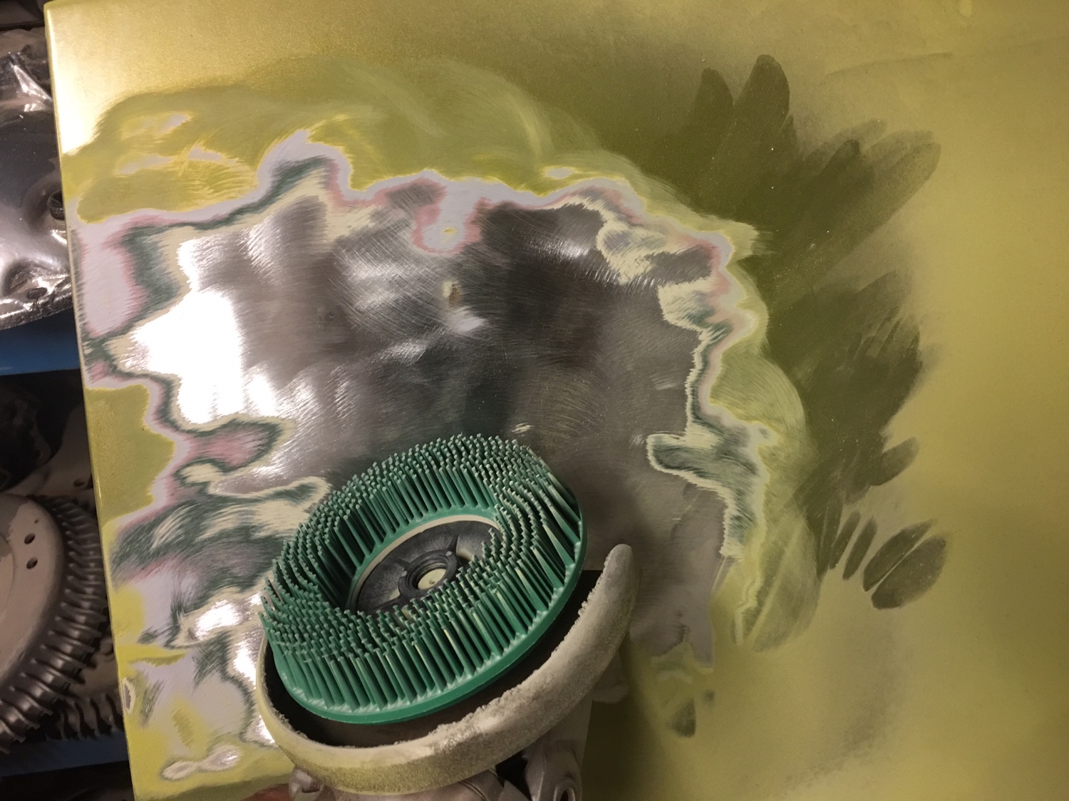

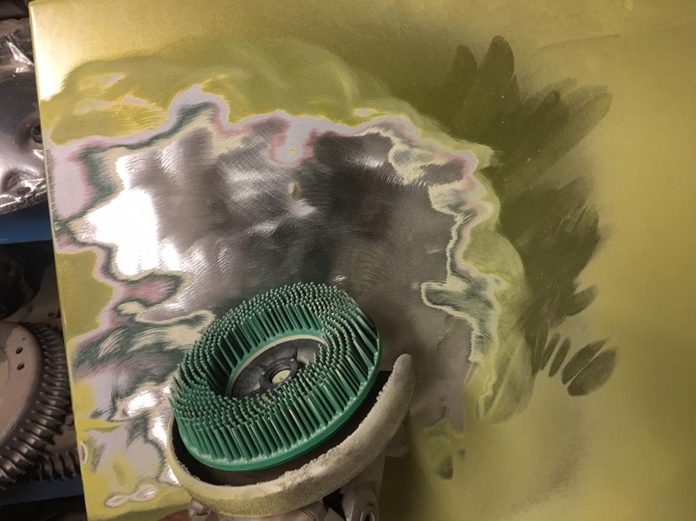

September 12, 20186 yr Author comment_557362 Tested out the new plastic stripper wheel from Eastwood tonight. A small patch to see how effective it was and I was pleasantly surprised. Not much heat buildup and strips quickly through aftermarket paint, two layers of primer, one layer of factory paint and a factory primer to bare metal. Link to comment https://www.classiczcars.com/forums/topic/50908-1976-280z-restoration-project/?&page=173#findComment-557362 Share on other sites More sharing options...

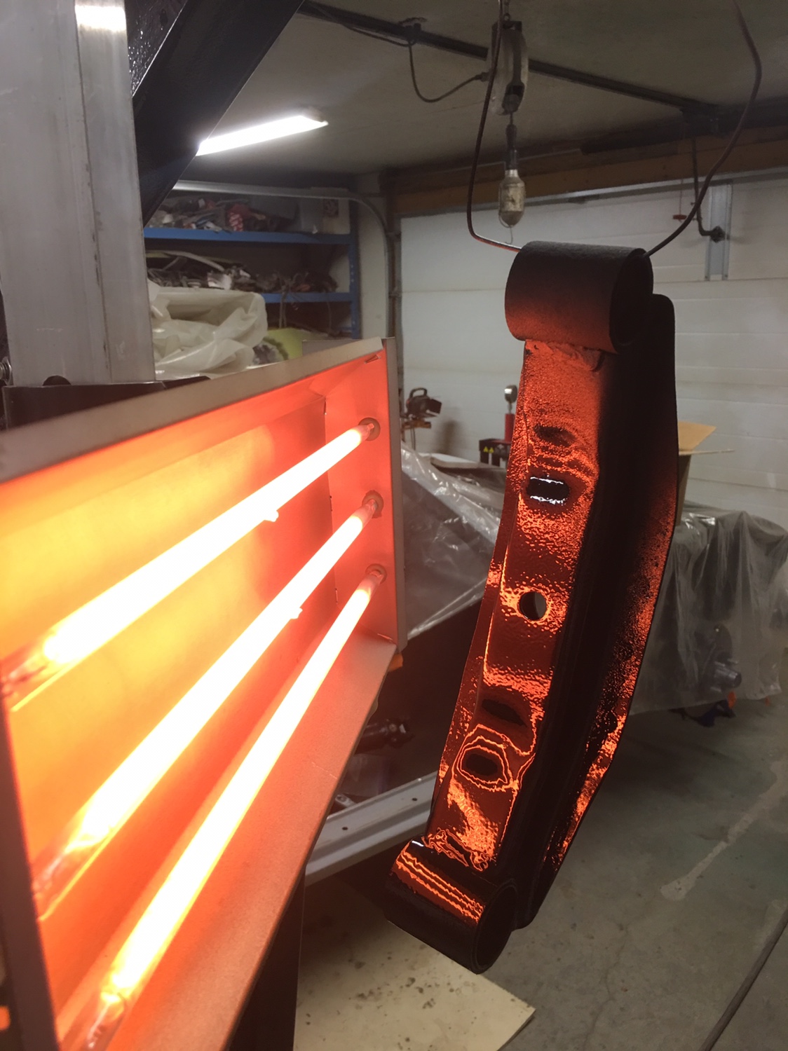

September 12, 20186 yr Author comment_557365 Playing with the Mirror Black powder coat too. Has a nice metallic sparkle in it. No idea why I bought it other than it looked cool! Link to comment https://www.classiczcars.com/forums/topic/50908-1976-280z-restoration-project/?&page=173#findComment-557365 Share on other sites More sharing options...
September 12, 20186 yr comment_557366 1 hour ago, wheee! said: Tested out the new plastic stripper wheel from Eastwood tonight. A small patch to see how effective it was and I was pleasantly surprised. Not much heat buildup and strips quickly through aftermarket paint, two layers of primer, one layer of factory paint and a factory primer to bare metal. How long did it take to do that square foot? Link to comment https://www.classiczcars.com/forums/topic/50908-1976-280z-restoration-project/?&page=173#findComment-557366 Share on other sites More sharing options...
