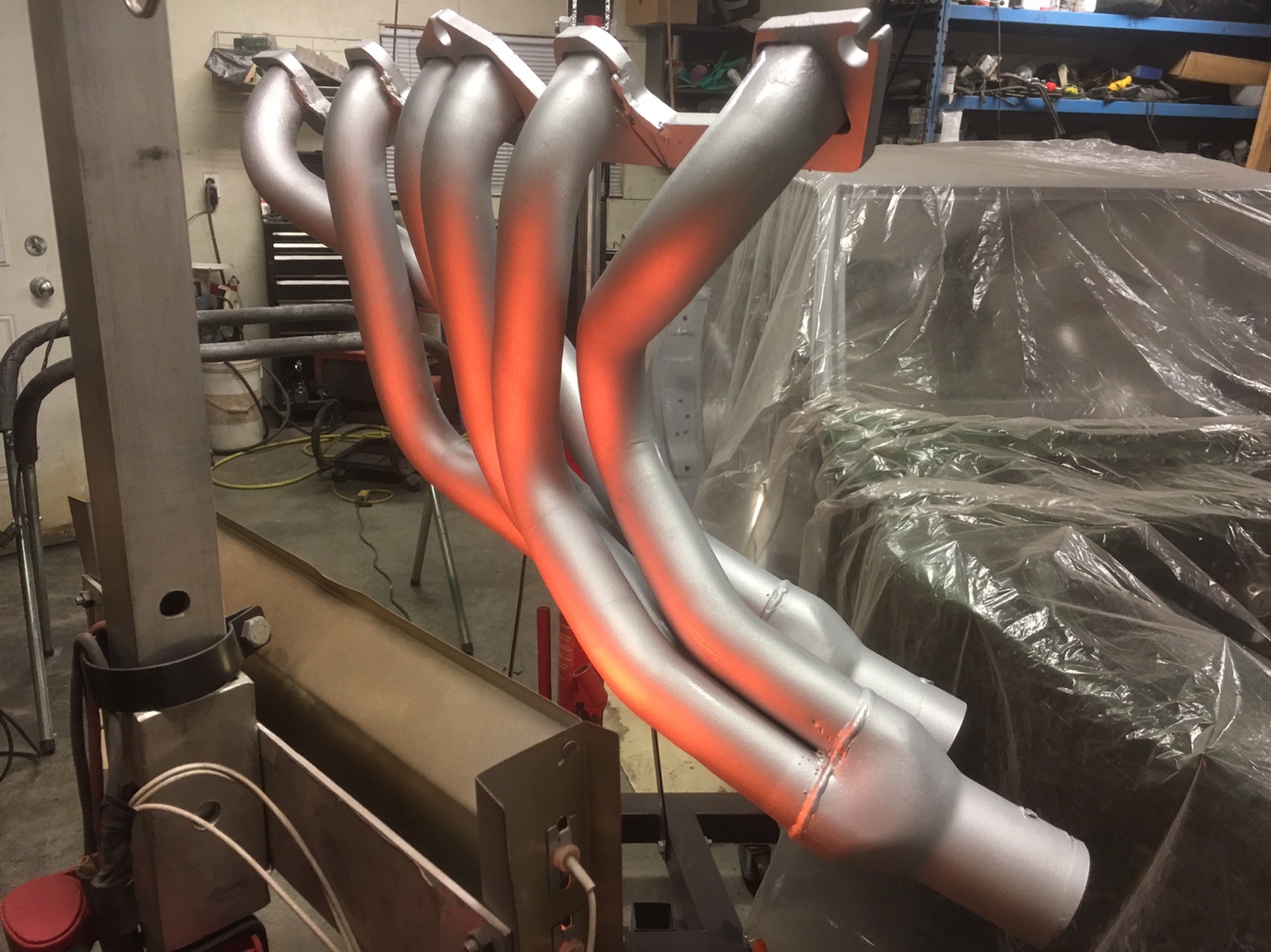

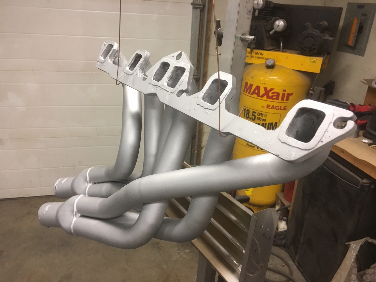

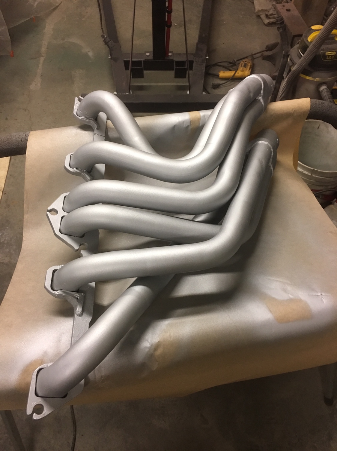

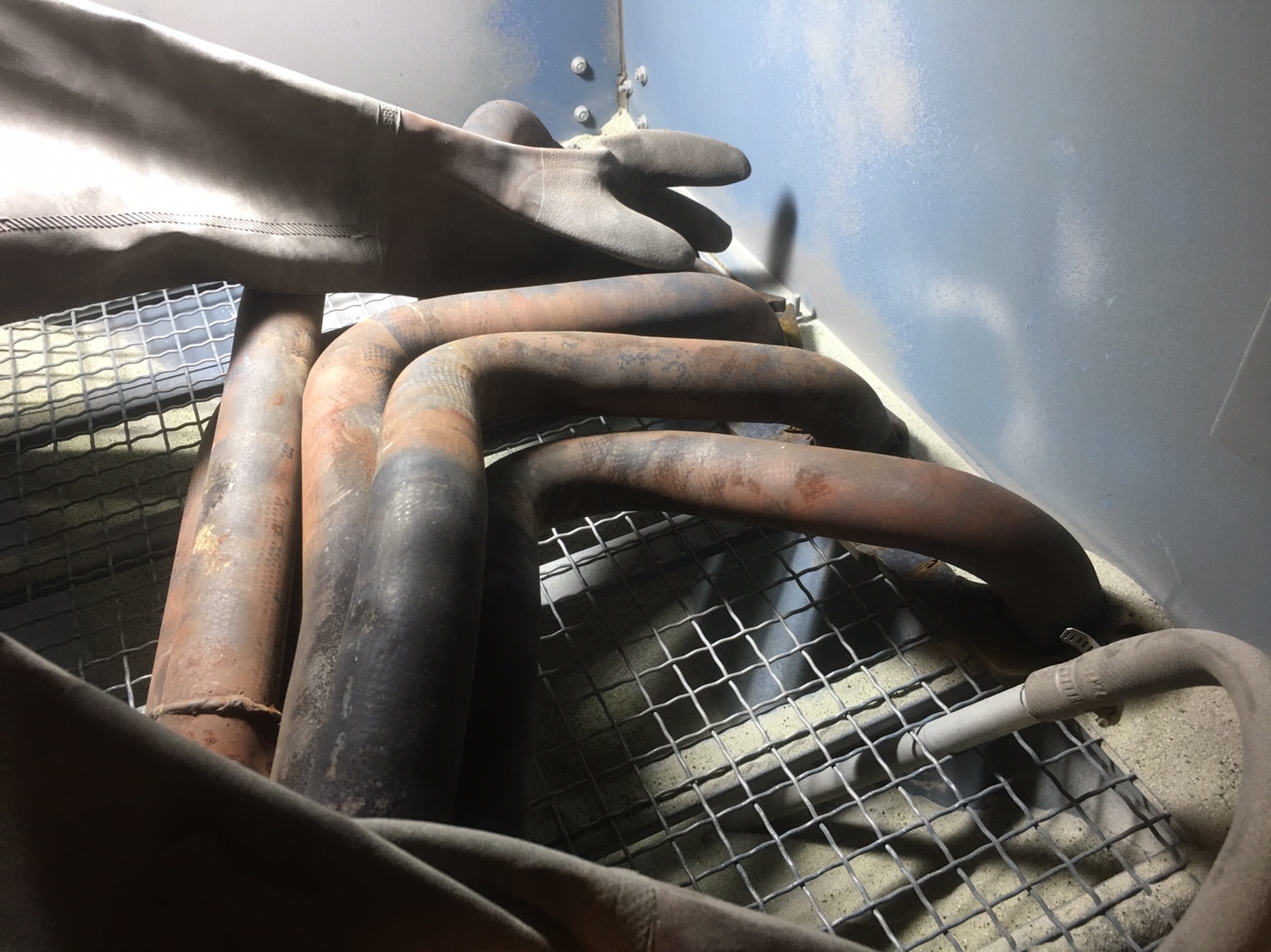

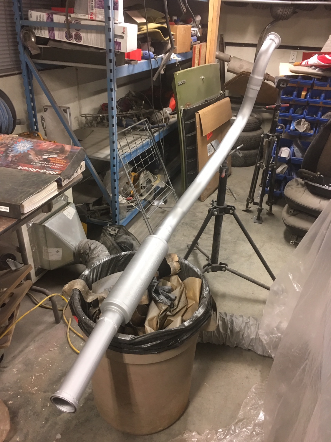

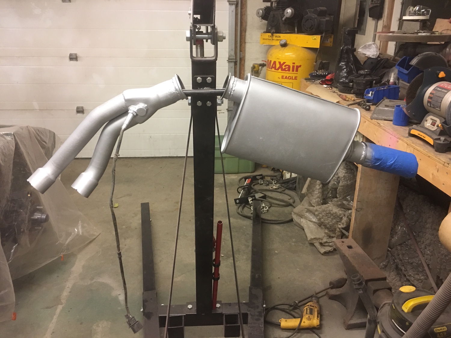

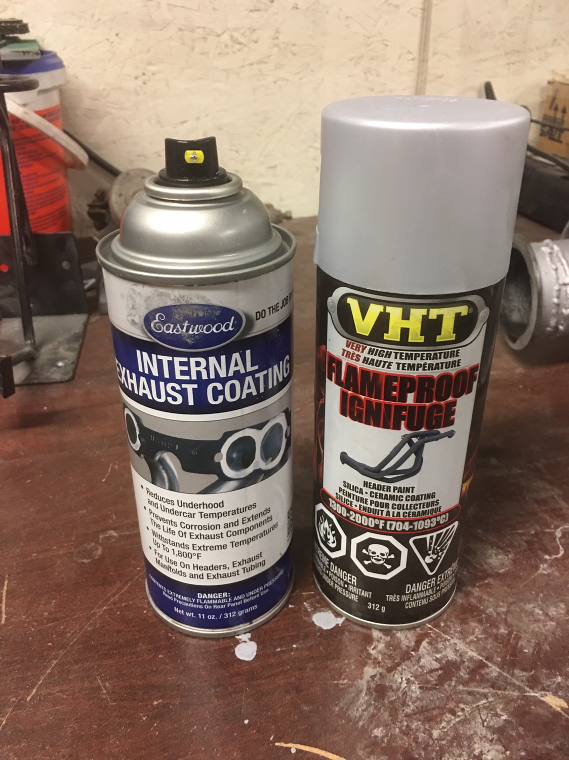

Thought I’d tackle the exhaust system tonight. I bought the Eastwood internal header coating and some 2000 degree header paint.
Sandblasted the header and sprayed it down with the outer coating, then sprayed down the insides with the Eastwood product. Hung it up to bake and cure a bit. Otherwise it stays soft and scratches. This should make it last a while in the shop till I can mount it.
