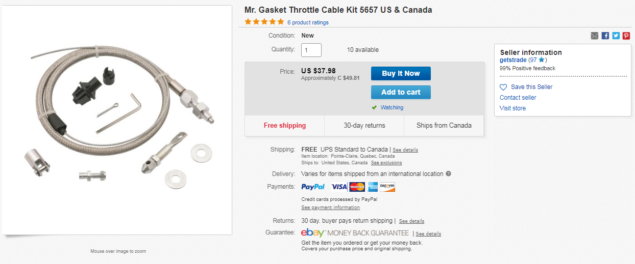

The Mr. Gasket universal kit might be a good start point. The rest of the roller linkage will need to be sourced from the junk yard probably
 Oooohhhh, that cable is quite a bit cheaper than the Lokar cables I've used for cable throttle conversions. Will have to get one and see what the difference is.
