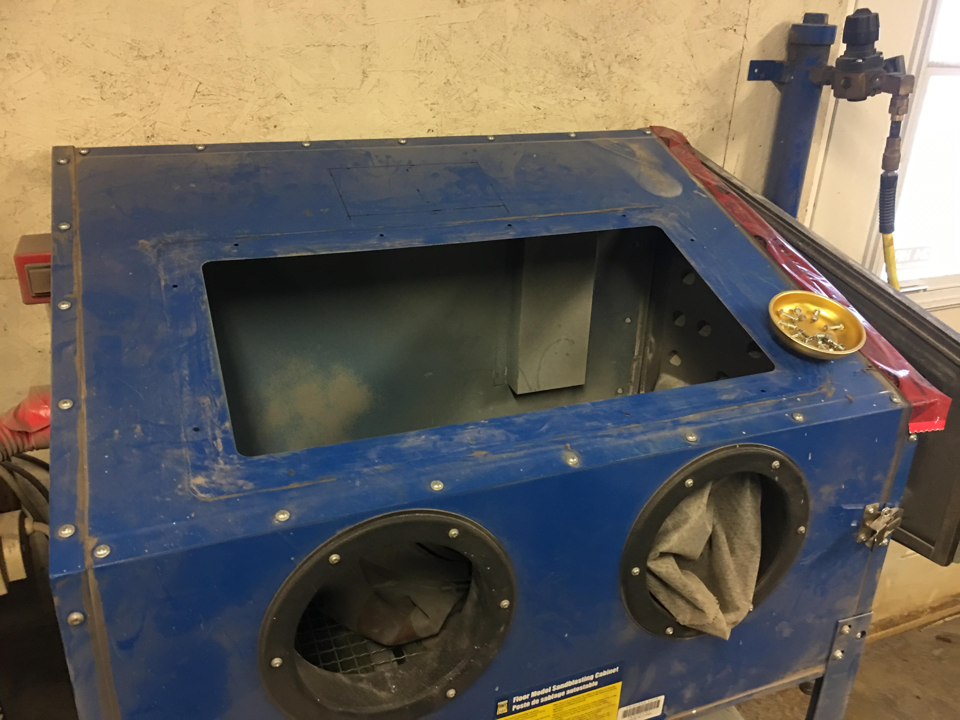

i decided to rebuild my sand blasting cabinet instead!

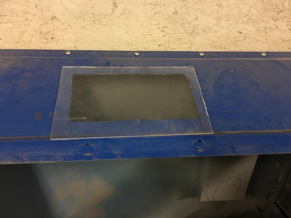

Bought new plexiglas and glass to replace the etched old stuff.  Cut out a hole to place the led light in a better spot for more even illumination. Turned out pretty good!

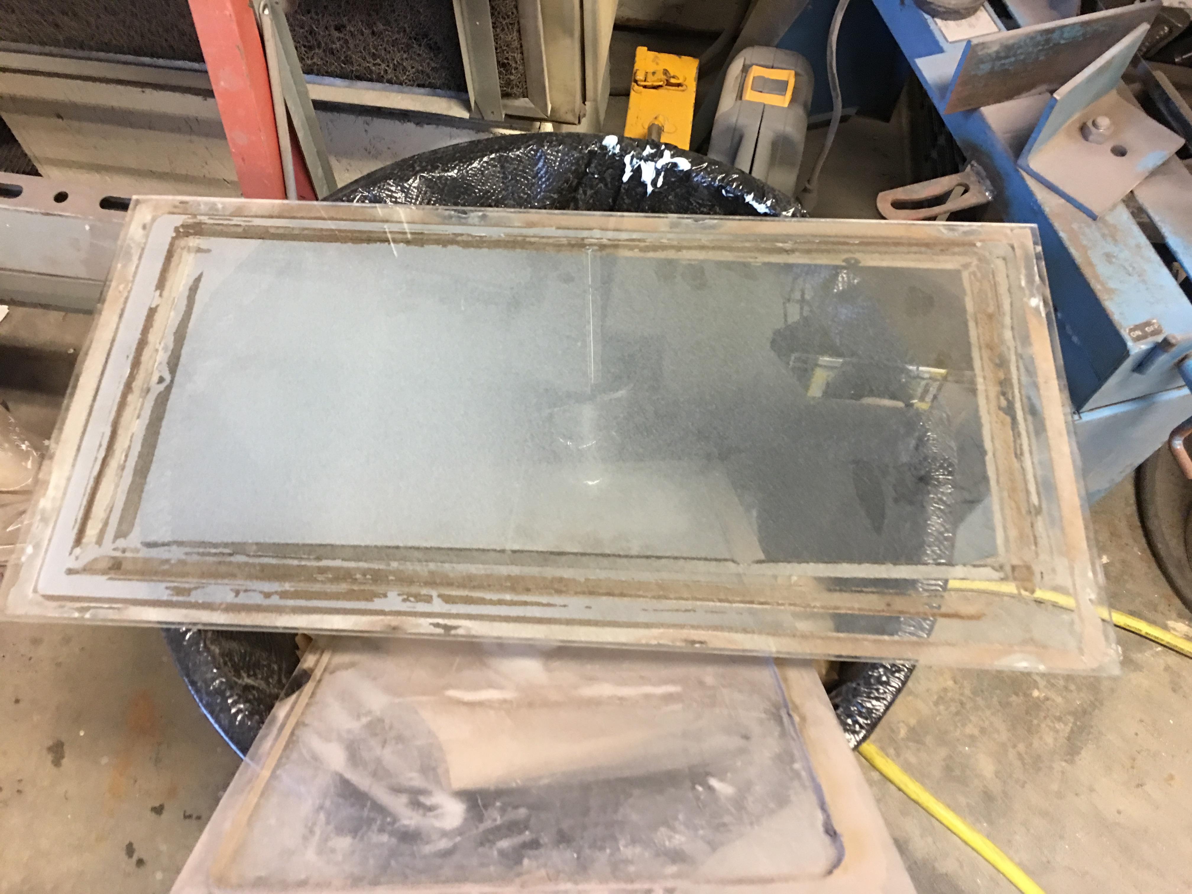

First I pulled out the old glass and plexi

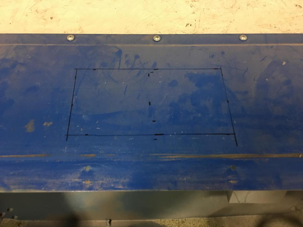

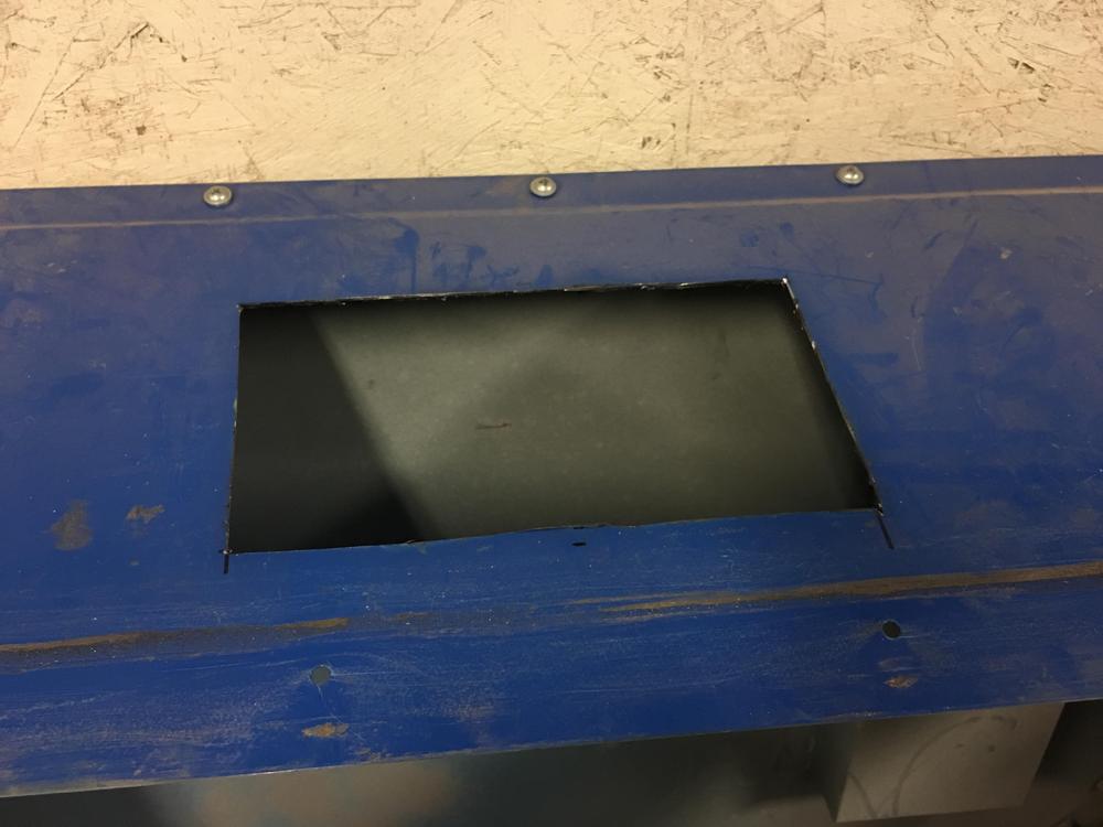

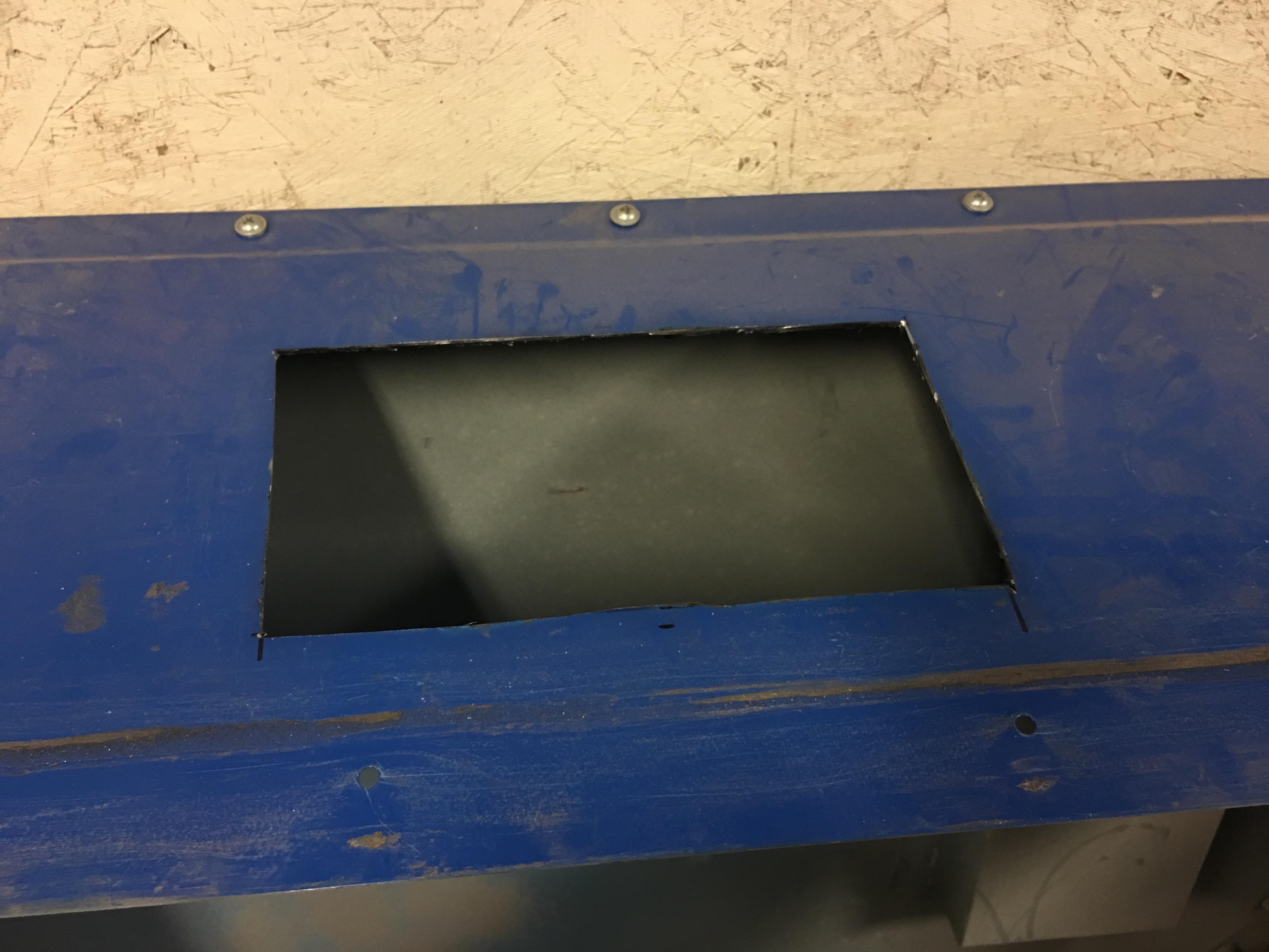

then I marked a hole for the light

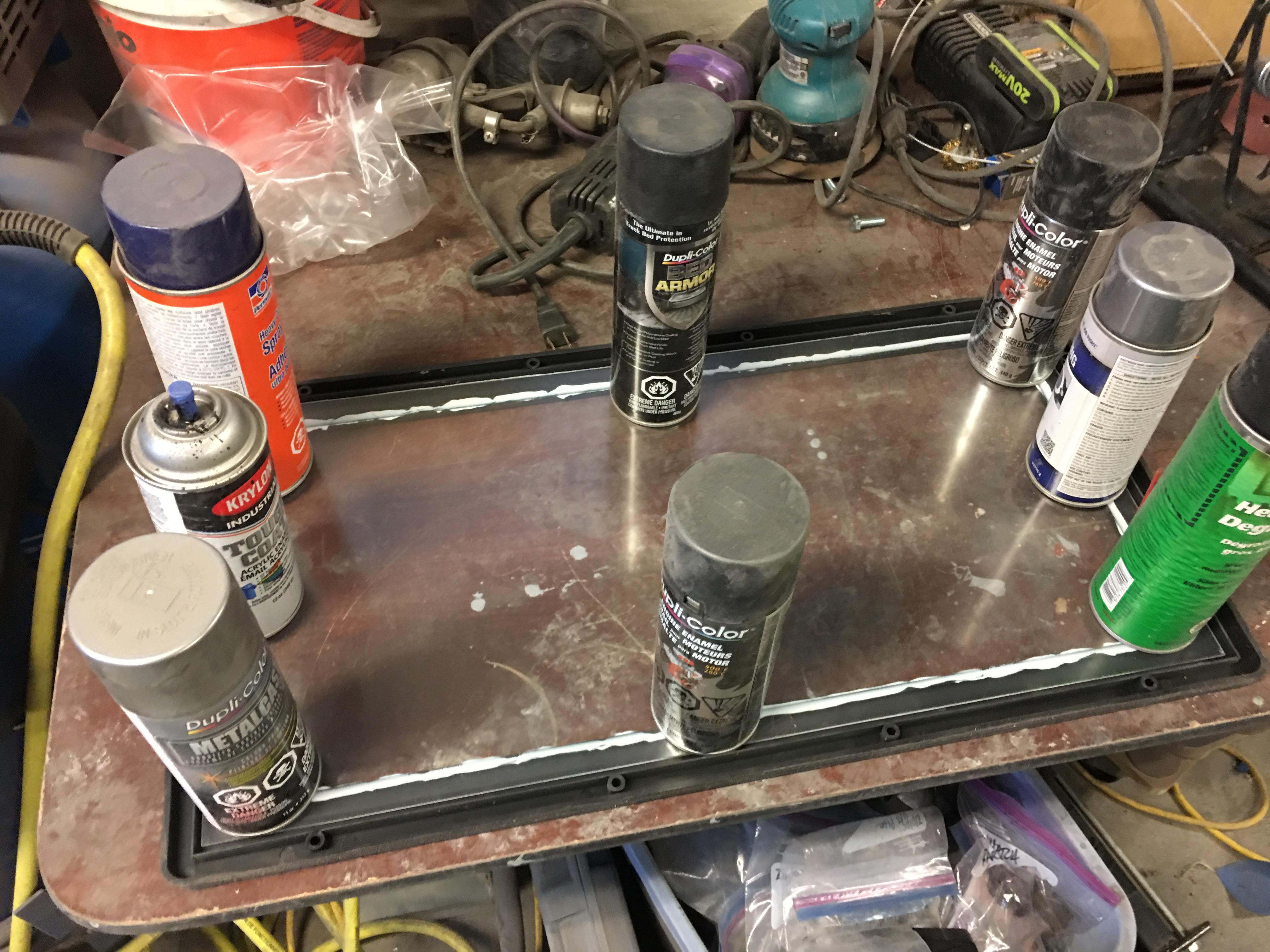

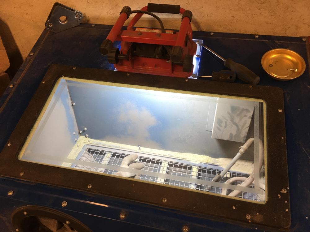

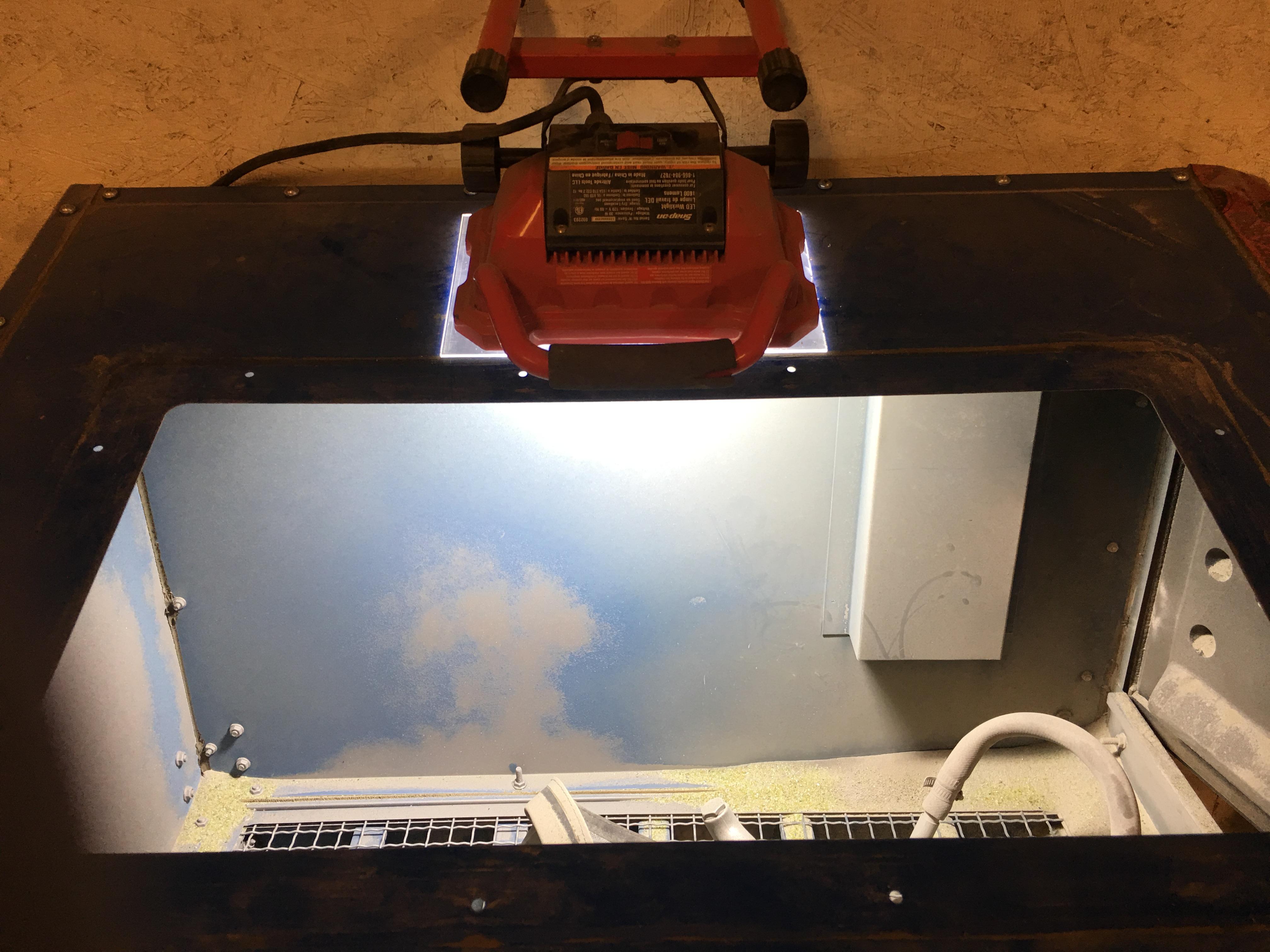

I then screwed the plexi down along with some sealant to seal it.
and then replaced the glass and plexi lid. So much brighter!
Edited by wheee!

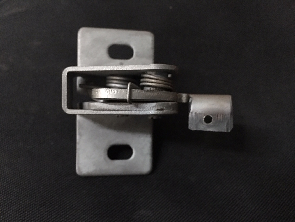

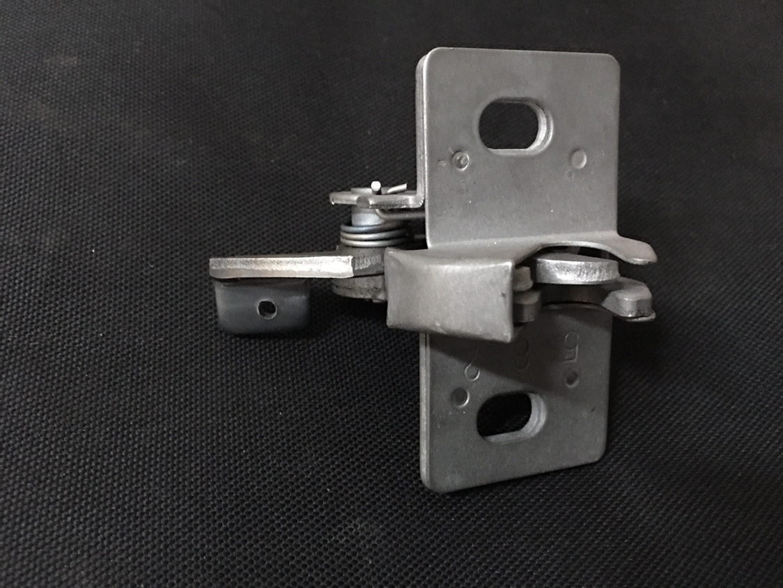

Another side project... I managed to get the rear hatch opening mech drilled in preparation for the remote trunk release mod. This is hardened steel and is much harder to drill than you would think. I broke several bits and even my cobalt bits wouldn’t touch it till I heated it up to remove the hardening.
Now I will countersink it a bit for the pull wire to sit in. More to come later!

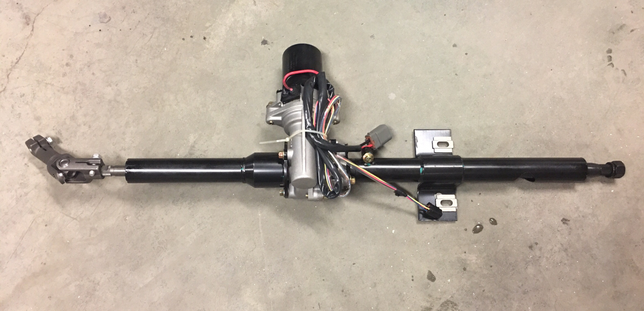

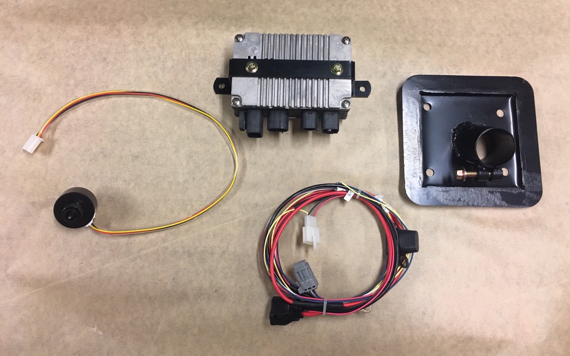

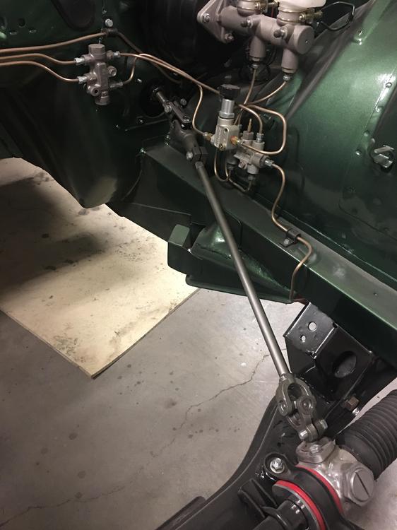

Silvermine delivered the power steering system today. Prices have gone up but Edan squeaked me in under the wire for last years price. Still with shipping and taxes/duty it was over $1500 Cdn! Ouch. Hope it’s all I expect it to be...
