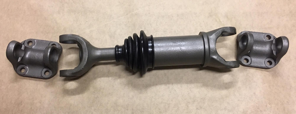

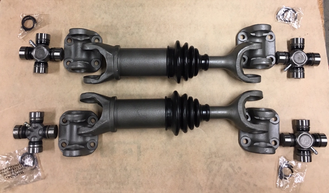

We 'know' the distance from the flange faces inner/outer on each side of the diff are different, as the Rxxx diffs are intrinsically wider on one side. The modern world (1980 and later) knows only of CV style joints that have very little in/out slop and have to be carefully sized to fit. Thus it was natural to assume that our lowly old school shafts would 'have to' be different lengths to 'work' in our unbalanced ancient hot rods. Wrong. Even when directed to the Z parts manual, where never the words 'left and right' could be found in the listings, they still disbelieved.
What was never properly understood was the massive (by comparison) length variance our marvelous half shafts are able to supply. They do gum up, and often true that you can't compress them by hand all to the same length, or perhaps expand them to maximum for the same reason, which only added to the 'they are different' myth.
And I've never heard of one breaking anywhere but at the u-joints themselves. Marvelous engineering indeed.

If I hadn't seen those pics I wouldn't have believed either, the measurements that I have done always showed the P/S was longer than the D/S.
I guess the grease inside packed up and hardened into the limits of travel and that's what gave the different lengths, anyway it's nice to see that settled once and for all, at least for all of us non believers.

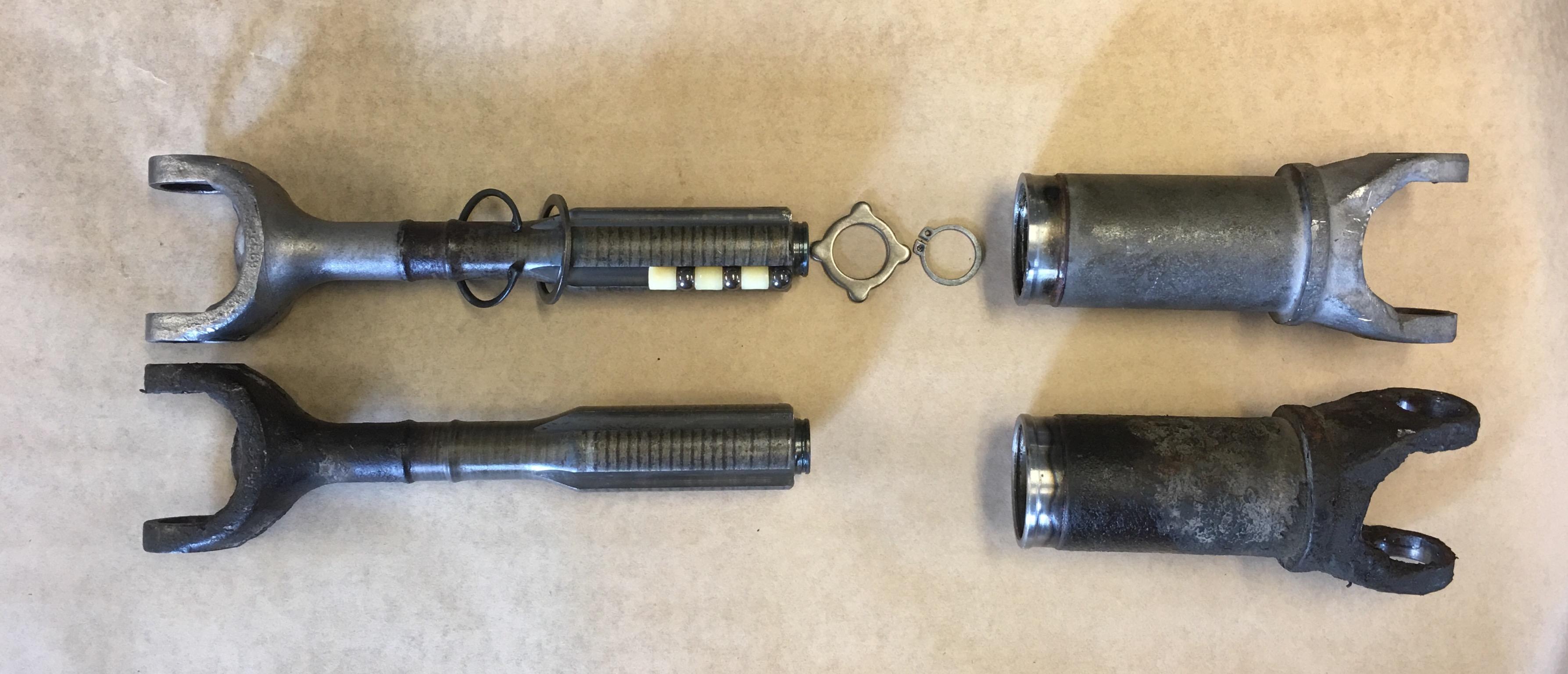

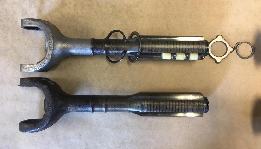

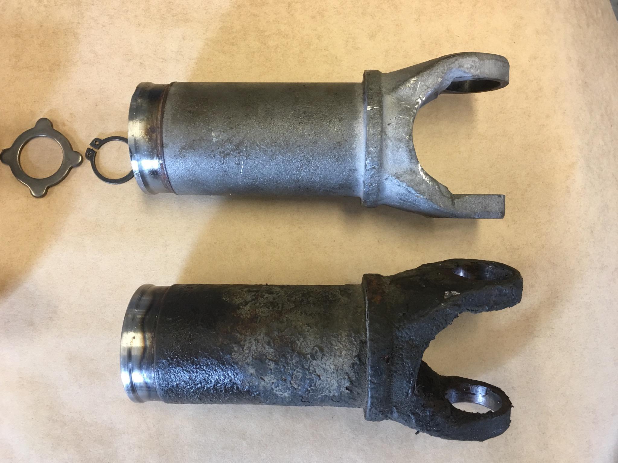

Well, that’s one restored! I added the 10g of grease to each of the ball tracks and another 30g in the top section beneath the snap ring. The manual has no info on adding grease to the boot itself so I assume that is left dry? Catches the oversling later?
The 280Z FSM is pretty explicit about the places where grease should be applied... and the dust boots are not one of those places.  I guess it's tempting to think of the boots as grease reservoirs that will help to replenish the spline and roller regions over time, but centrifugal force will keep that 'reserve' grease trapped up in the outer boot folds, well away from places where it might do any good.  Maybe just a light smear to lubricate the boot surfaces in case they rub against each other at extreme axle deflections?

So there is no need to put grease anywhere but directly on the parts that touch and move. Once there, it does not move or migrate away. Any grease you put in that axle boot will stay right there and never contribute to the sliding joint. Might keep the boot soft and snuggly, but that's it.
That's what I was thinking! But the boots both came apart full of the cruddy yellow goop that was also inside the shafts themselves. There is no o-ring or seal between the boot and the shaft, just the snap ring and collar. There is a small amount of "residual" grease in the boot from sliding it onto the shaft and being handled with greasy gloves, but nothing excessive. I will seal up the boots with the cv bands when they arrive and be done.
