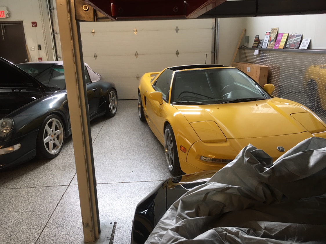

Paid homage to Big Bertha while I was there.
Ogled the various 240 project cars. Mr. Modest didn’t even mention the gem tucked away in the corner awaiting its spa treatment.
Numbers matching early 70 with vertical defrost lines and air conditioning!
Plus the other nice candidate in the other room
Let’s just say that @ConVerTT is a true connoisseur of fine automobiles. Just an ordinary guy with skill and passion. A lot of skill...

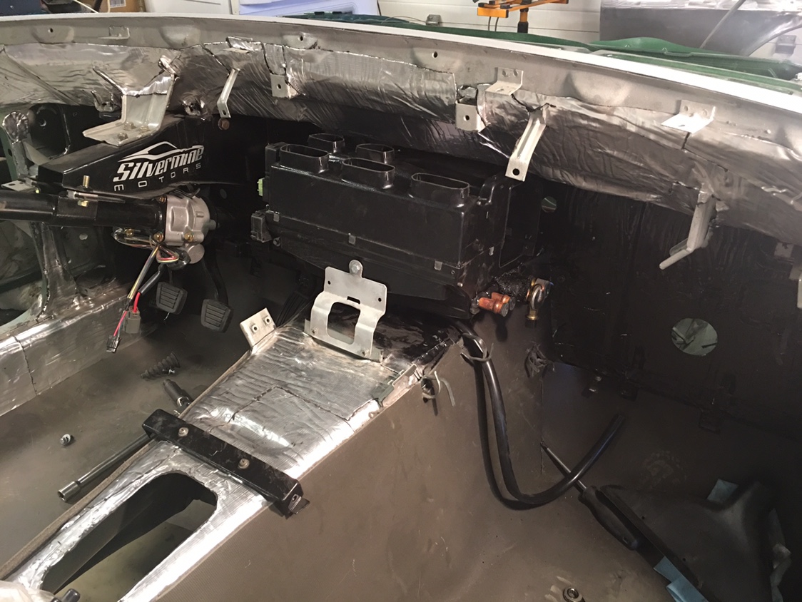

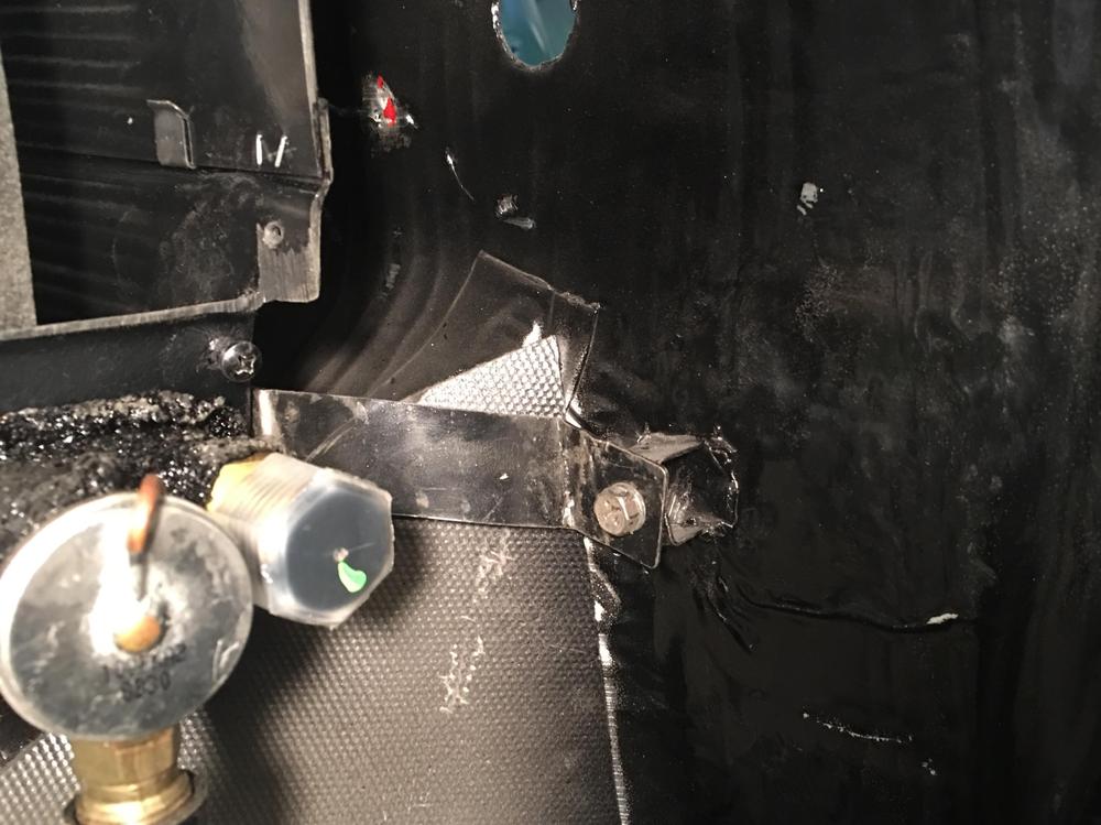

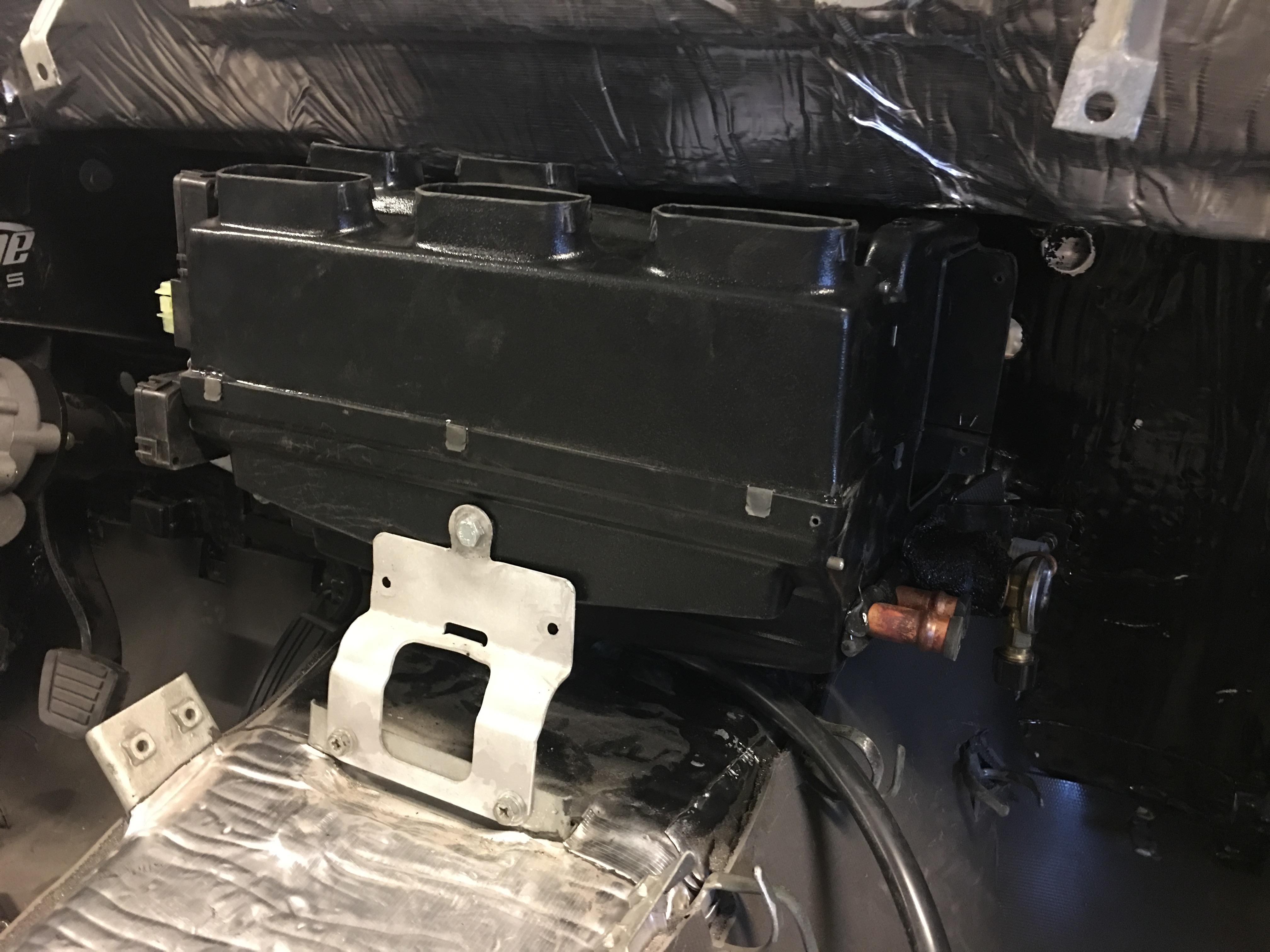

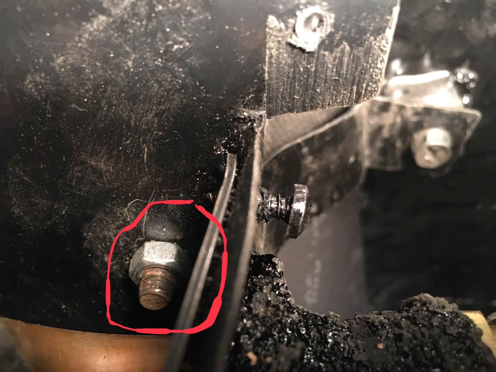

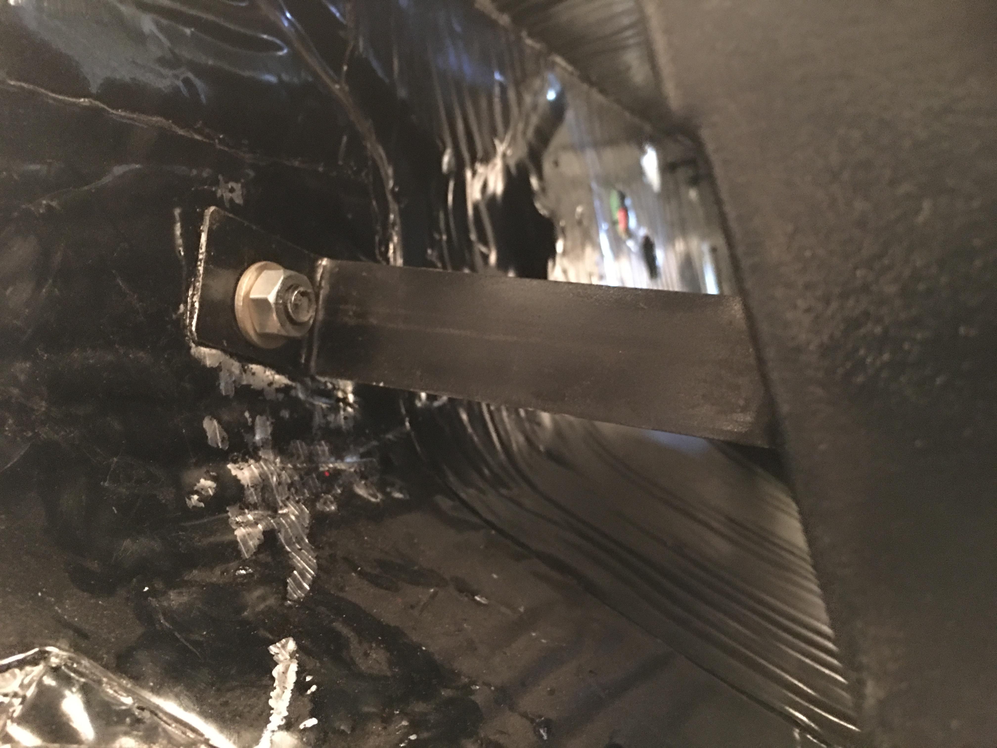

While I’m waiting for the new fan box, I got the main evaporator bolted in with strapping.
I used the front stock mounting plate with a few mods. Cut off some capture nuts and some tabs then I welded a washer to the top to give me a mounting point for the front. This stabilized the bottom nicely and offset the floor vents from the tunnel the max amount.
I then used one stock firewall pass-through hole on the driver side to the factory capture nut in the evaporator unit. Then I drilled a hole in the ABS case on the passenger lower opening to bolt a strap to the stock fan box firewall mount.
I will clean up the brackets and powder coat etc. Whew!
