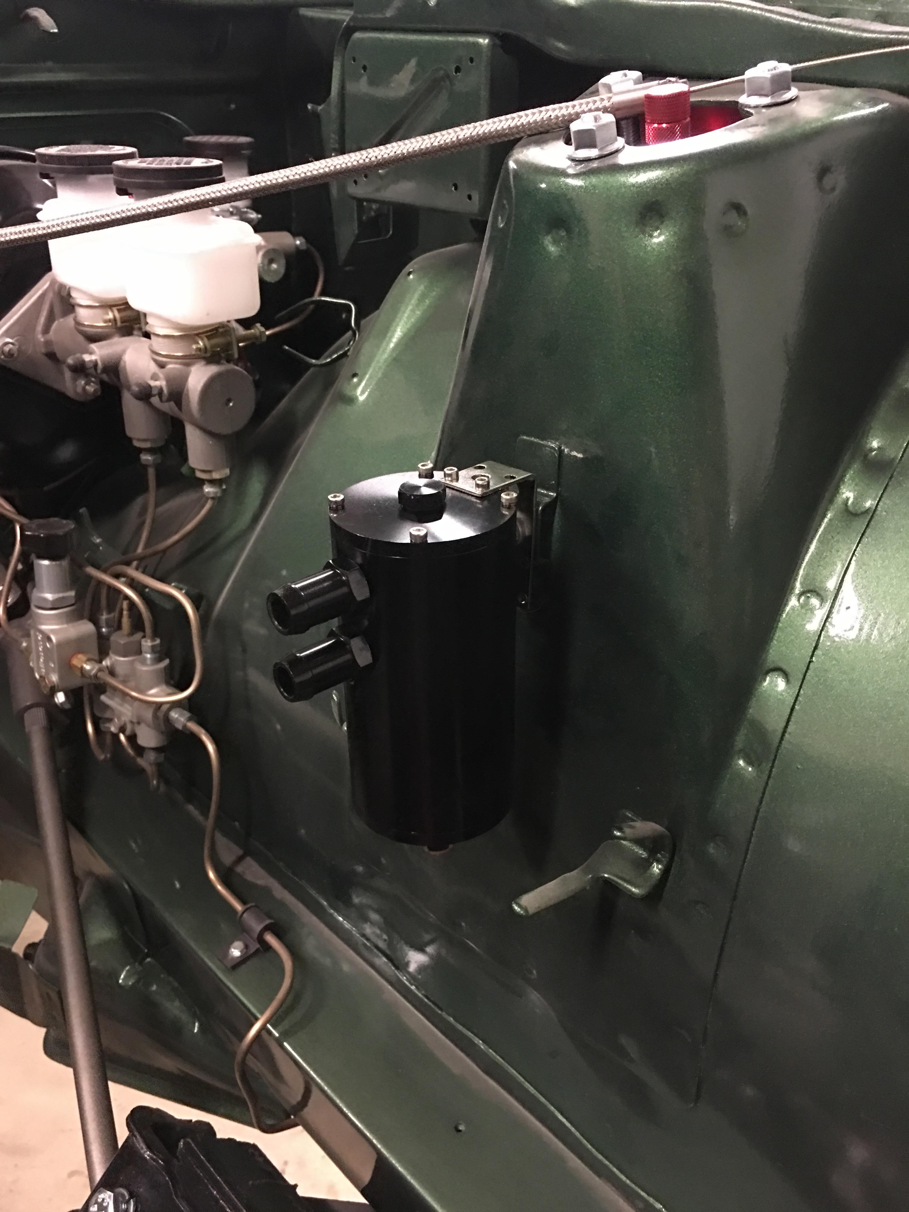

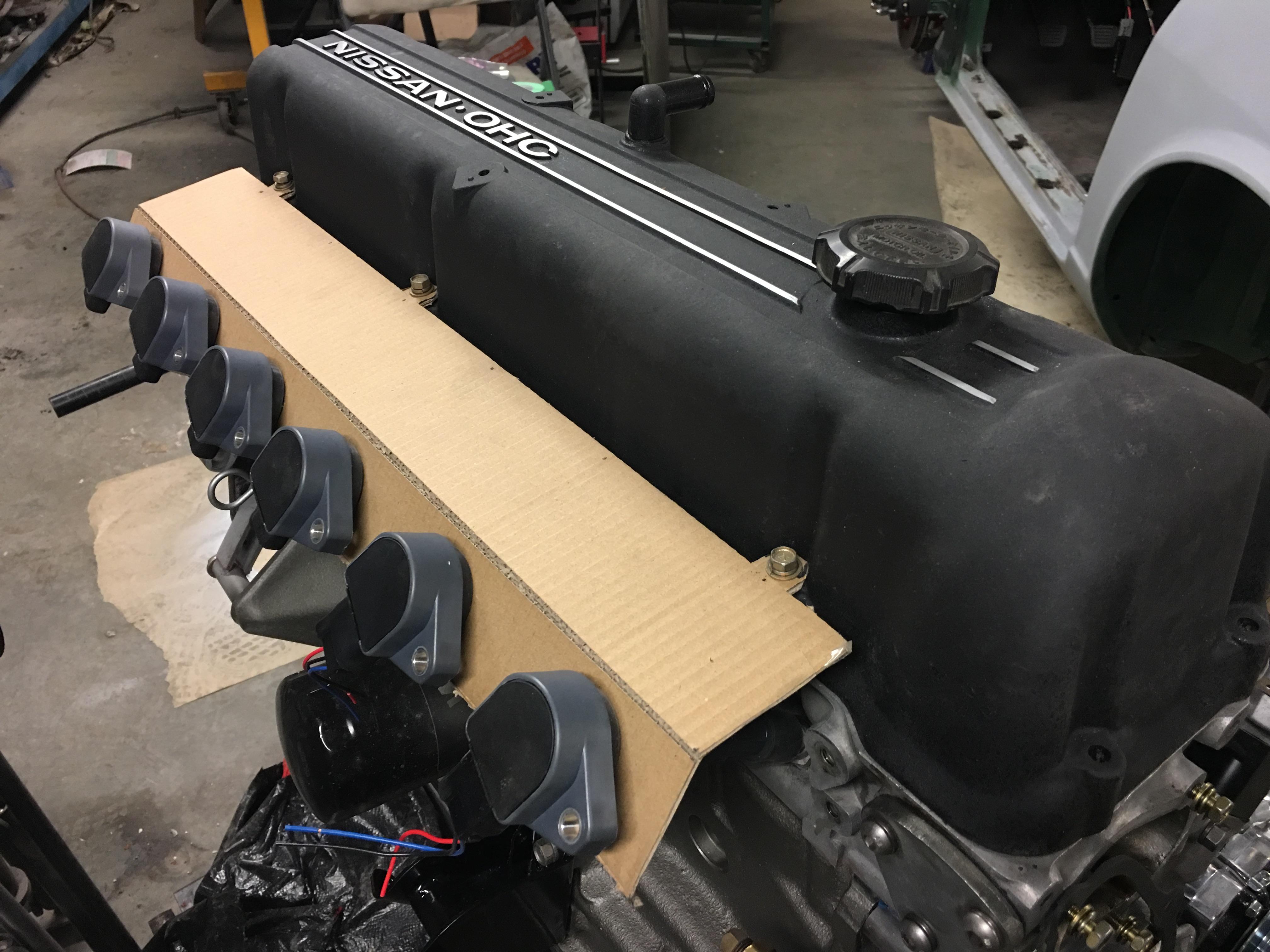

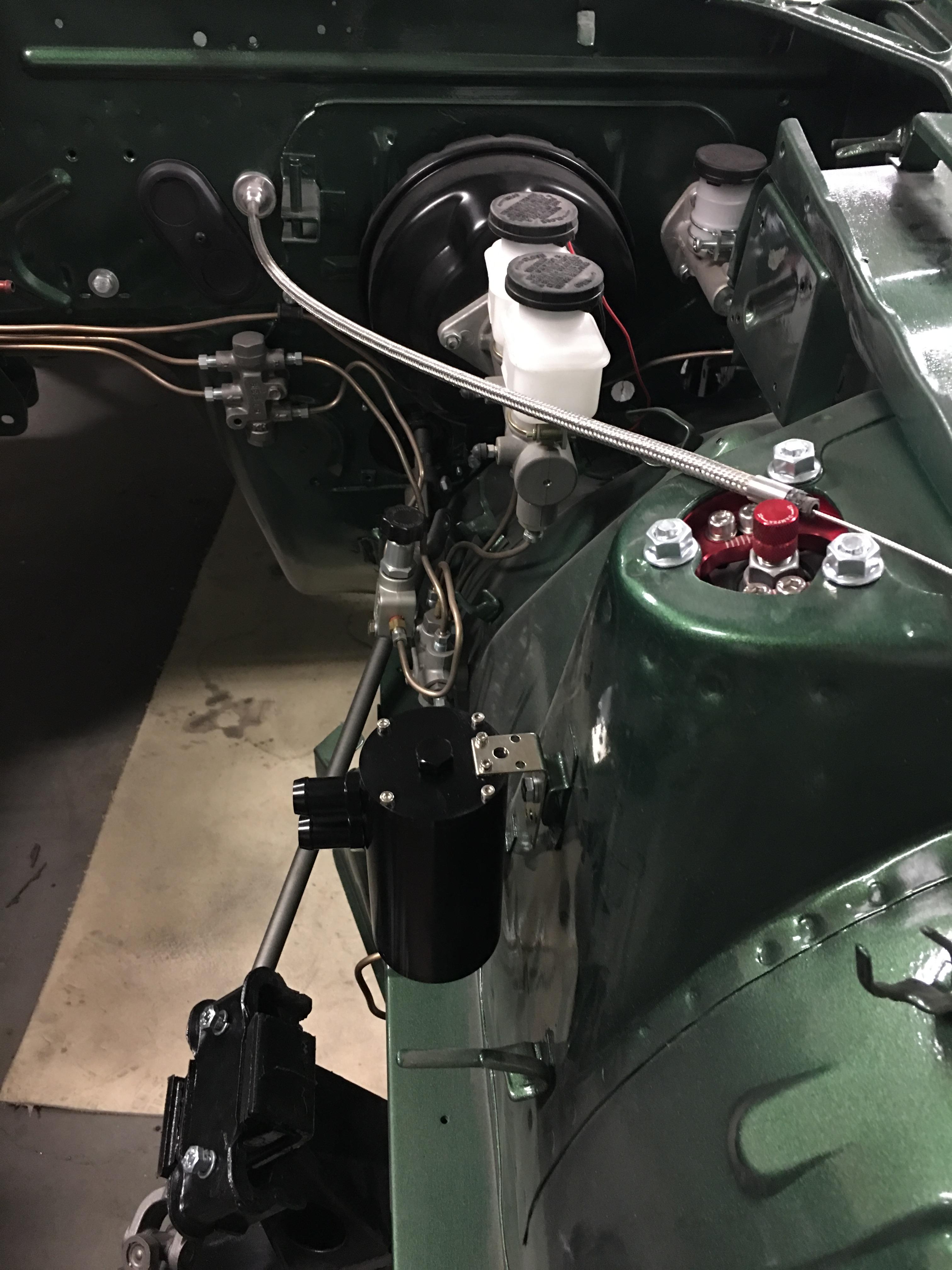

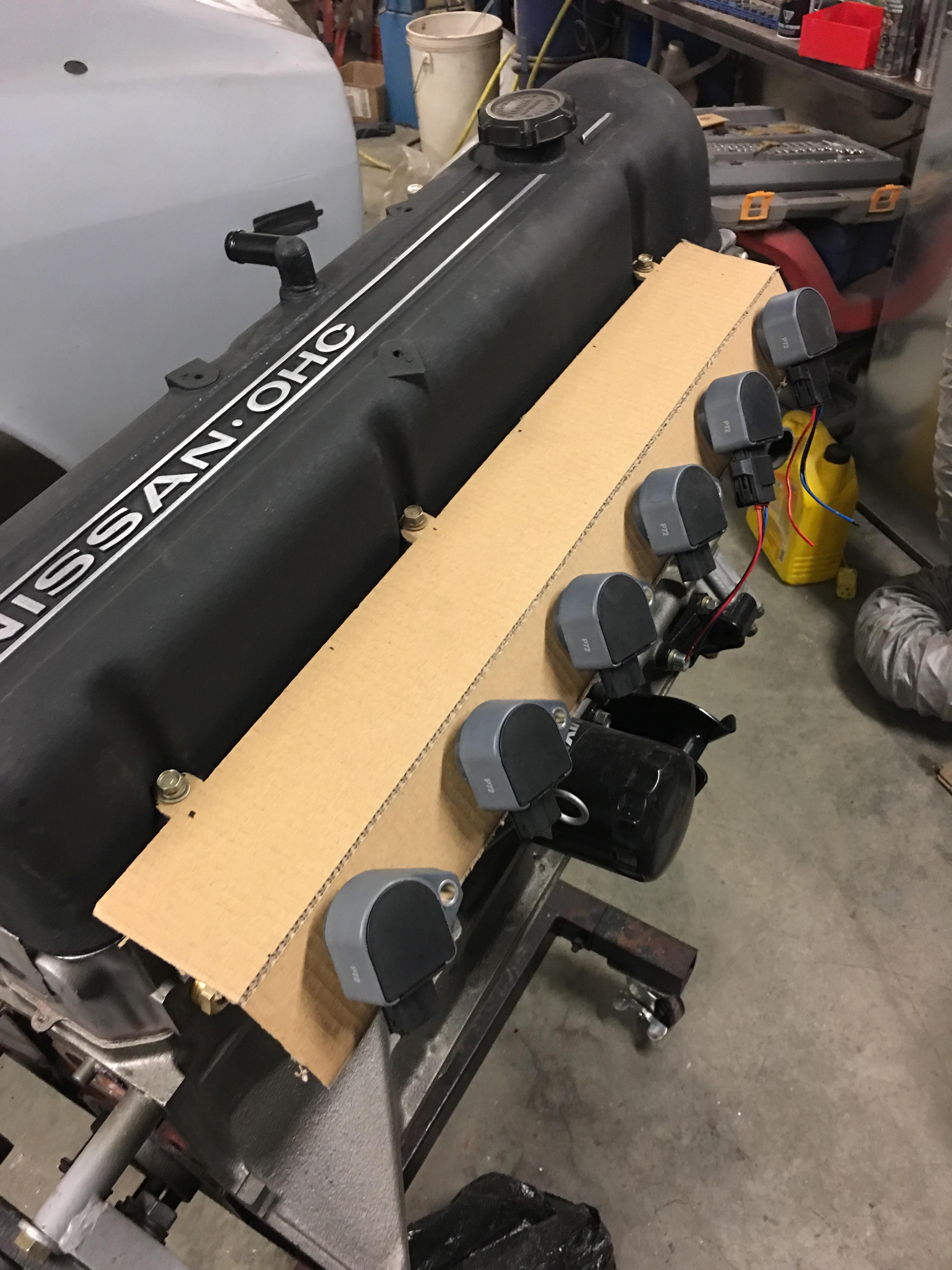

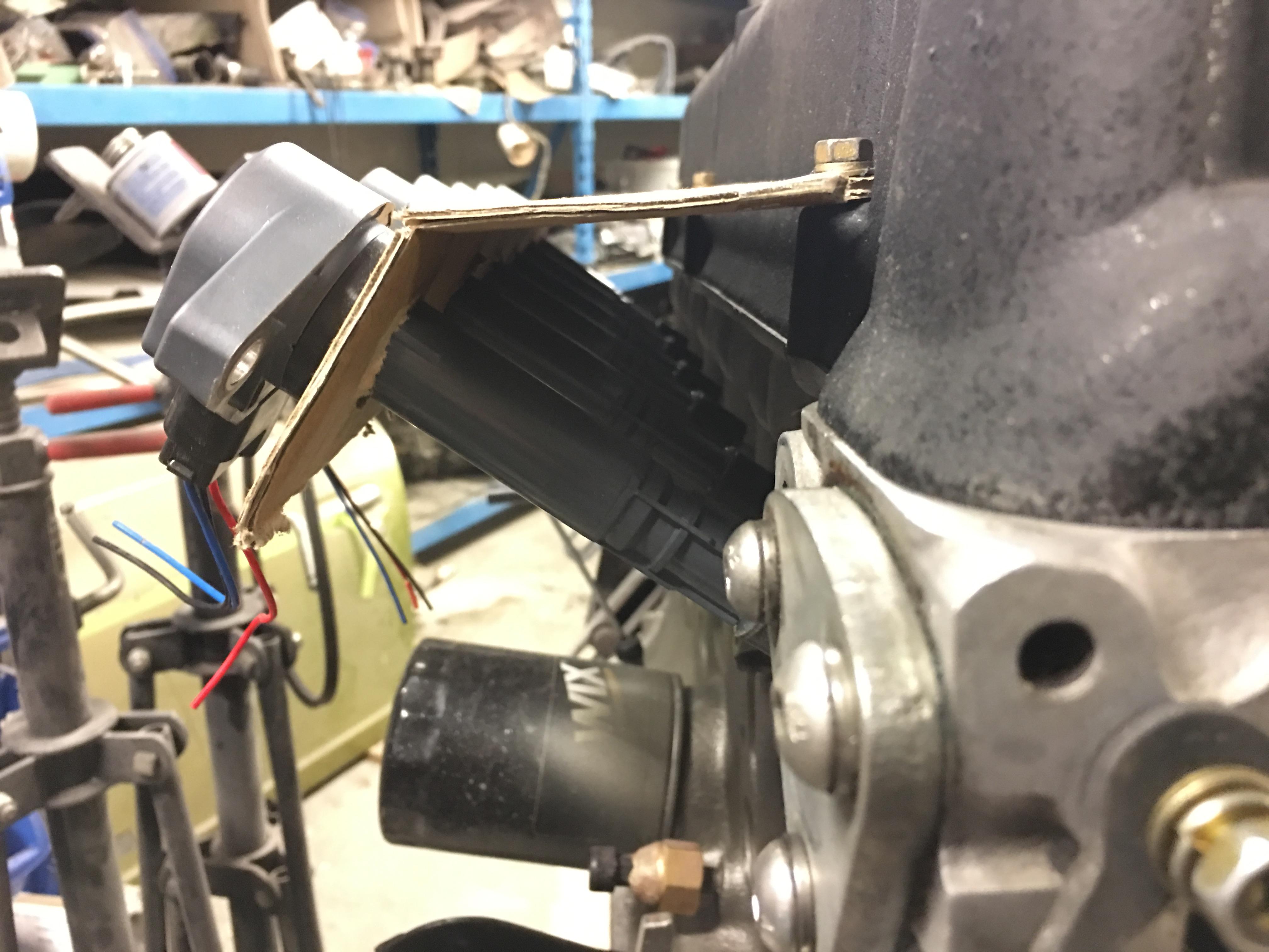

wheee! Posted March 3, 2019 Author Share #2428 Posted March 3, 2019 Bolted in the oil catch can. Perfect position to where the crankcase vents. Also mocked up the COP support. This will work just right I think. The COPs will be bolted to the aluminum plate and the six of them will anchor each other. There should be minimal stress on the top three valve cover tabs Link to comment Share on other sites More sharing options...
grannyknot Posted March 3, 2019 Share #2429 Posted March 3, 2019 That COP support is going to look smart, is there anyway to put a 1" radius on that bend? Does the catch can have a breather on it? Link to comment Share on other sites More sharing options...
zKars Posted March 3, 2019 Share #2430 Posted March 3, 2019 At first I wasn't sure I'd like that bracket, but I think with some radius bends as suggested and some cut-outs on the horizontal blank face to 'lighten' the look (maybe some nice laser cut graphics) it will be pretty cool. 1 Link to comment Share on other sites More sharing options...
ConVerTT Posted March 3, 2019 Share #2431 Posted March 3, 2019 Very nice work! A couple of thoughts on the brace.... Adding a 90 degree (down) bend with about a 1/2” flange along the edge between the bracket and the valve cover will add stiffness to the whole brace and minimize any stress on the valve cover bolts and the COPs. You may want to consider bending similar edges at each endof the bracket as well for even more stiffness. I hope this helps .. 1 Link to comment Share on other sites More sharing options...
wheee! Posted March 3, 2019 Author Share #2432 Posted March 3, 2019 That COP support is going to look smart, is there anyway to put a 1" radius on that bend? Does the catch can have a breather on it?The catch can comes with a breather but I will be sending the cleaned gases back to the intake like factory. The breather is not needed if you are recirculating. I will be using a breather on the valve cover. I didn’t want to at first, but I think it has been proven to work with no ill effect. It needs to draw air and vent air as needed. If I route it in with the crankcase vent there is the danger it would “draw” from that same line and contaminate the valve cover. The recirc’d crankcase line will have vacuum from the intake to draw out the vapours from the block. Link to comment Share on other sites More sharing options...
wheee! Posted March 3, 2019 Author Share #2433 Posted March 3, 2019 Very nice work! A couple of thoughts on the brace.... Adding a 90 degree (down) bend with about a 1/2” flange along the edge between the bracket and the valve cover will add stiffness to the whole brace and minimize any stress on the valve cover bolts and the COPs. You may want to consider bending similar edges at each endof the bracket as well for even more stiffness. I hope this helps ..If only I knew someone with massive fabbing skills...I’ll be down end of March, have it ready! 2 1 Link to comment Share on other sites More sharing options...
