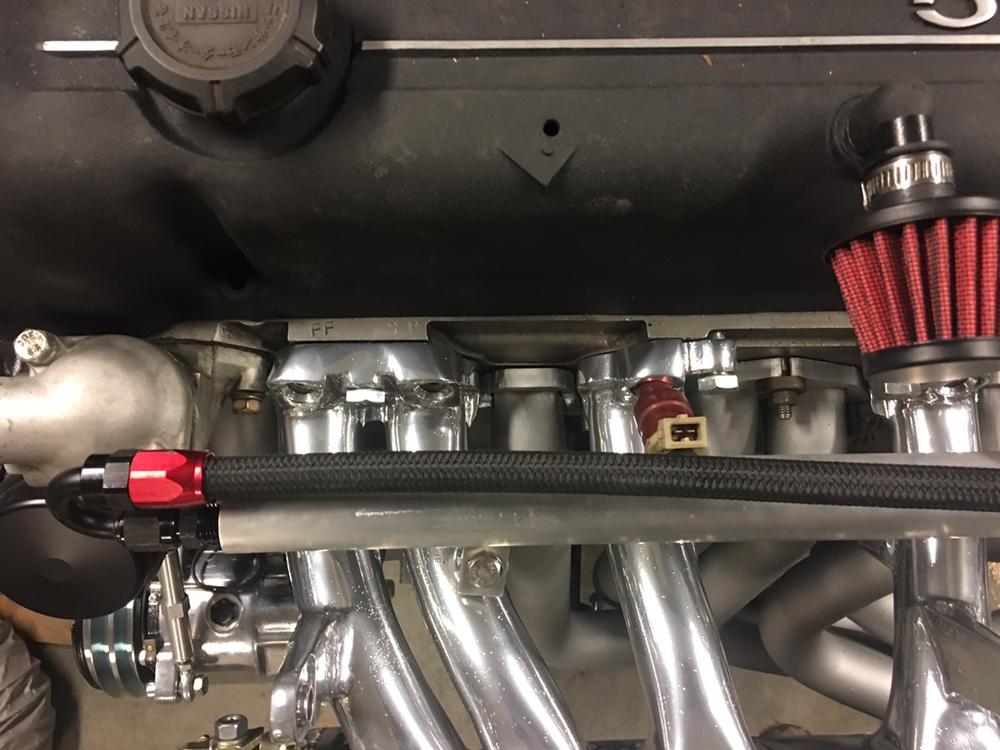

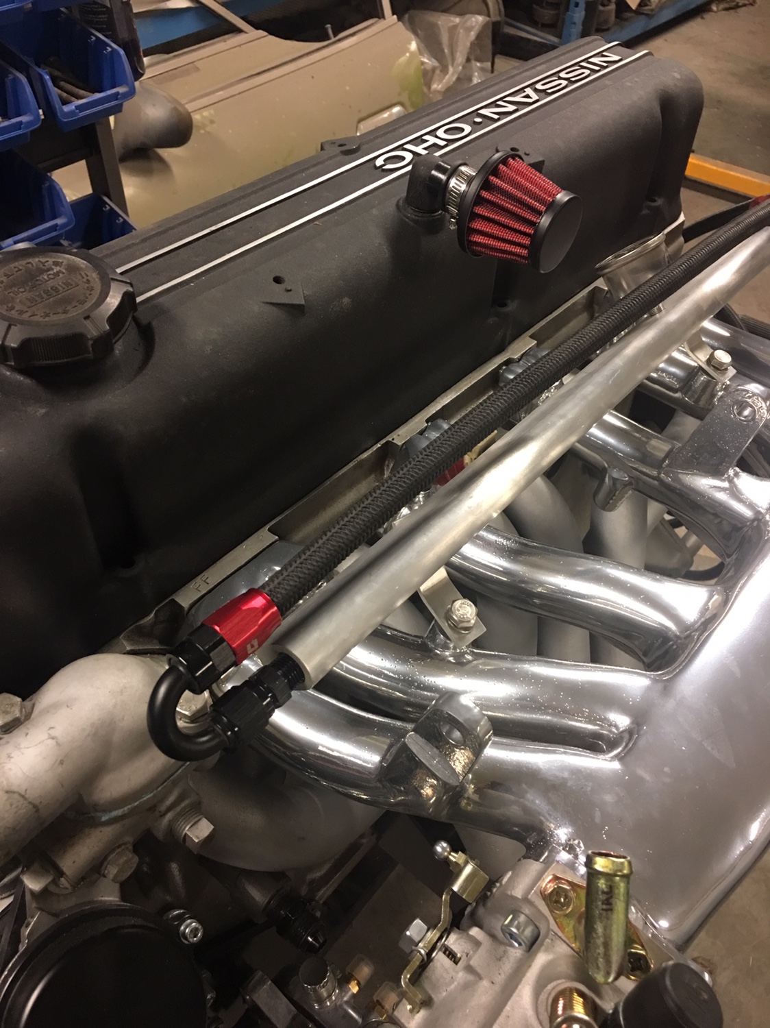

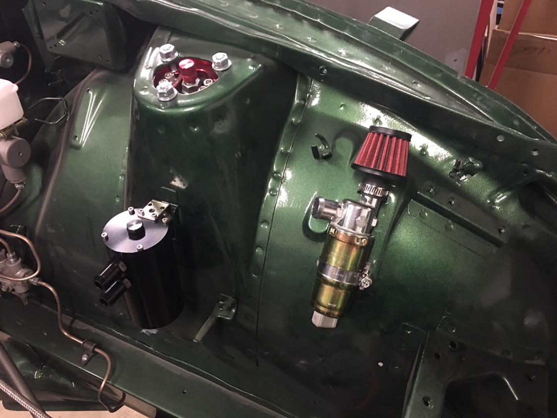

March 11, 20196 yr Author comment_570650 Found a home for the IAC along with some blingy breather filters for it and the valve cover. Link to comment https://www.classiczcars.com/forums/topic/50908-1976-280z-restoration-project/?&page=207#findComment-570650 Share on other sites More sharing options...

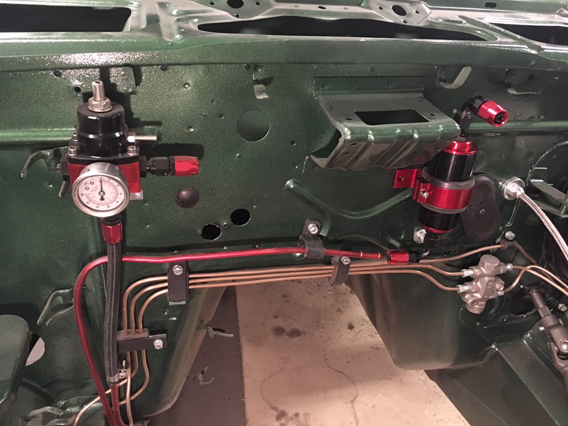

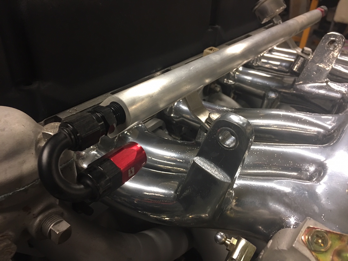

March 11, 20196 yr Author comment_570655 Looks like the fuel filter will fit just perfect here too! Should line up almost perfect to the fuel rail. The return line will route in below the top 90 and back to the pressure regulator. Link to comment https://www.classiczcars.com/forums/topic/50908-1976-280z-restoration-project/?&page=207#findComment-570655 Share on other sites More sharing options...

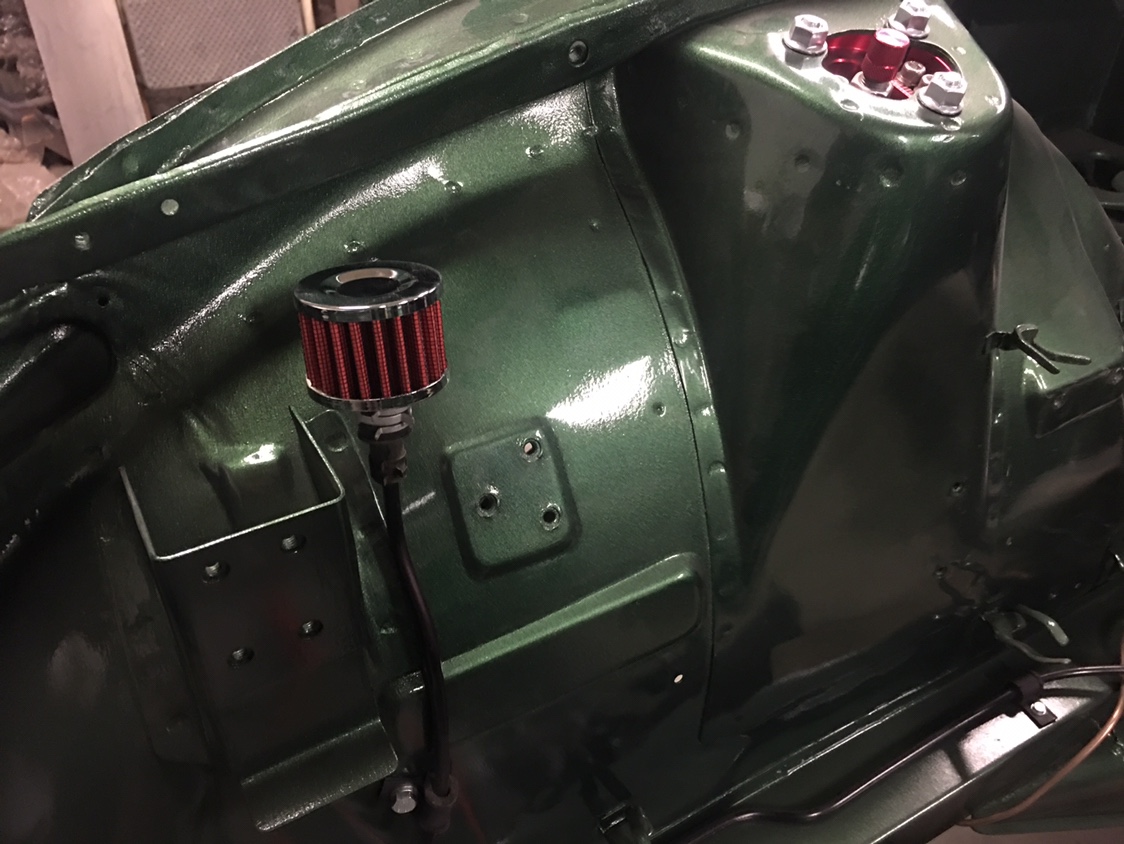

March 11, 20196 yr Author comment_570657 Why hello there tank breather filter! Link to comment https://www.classiczcars.com/forums/topic/50908-1976-280z-restoration-project/?&page=207#findComment-570657 Share on other sites More sharing options...
March 11, 20196 yr Author comment_570661 The feed line will go to the front of the engine and push out the back of the rail near the firewall. This will also allow me to wire tuck the injector lines beneath the fuel line! Link to comment https://www.classiczcars.com/forums/topic/50908-1976-280z-restoration-project/?&page=207#findComment-570661 Share on other sites More sharing options...
March 11, 20196 yr comment_570680 On 3/11/2019 at 2:47 AM, wheee! said: Why hello there tank breather filter! The engine bay is really looking sharp, love the coordinated colours, but why are you putting the tank breather up front? Your just going to smell it a lot more than if you mounted it some where at the back of the car. Link to comment https://www.classiczcars.com/forums/topic/50908-1976-280z-restoration-project/?&page=207#findComment-570680 Share on other sites More sharing options...
March 11, 20196 yr Author comment_570683 Having never experienced the joy of driving these cars, I am unsure as to what to expect from the gas smell. It may be present or may not... The tank evap unit will be removed and the hoses recirc'd back in the rear quarter. The existing vapour return line is theoretically a feed to the tank. It will still have some fumes, but would they present a problem so far forward? I don't know. It is an easy fix at the rear if I remove it. Even if I vent in the rear of the car, under the body let's say, I may not remove the return line that I installed. The filter may end up being window dressing serving no real purpose. Link to comment https://www.classiczcars.com/forums/topic/50908-1976-280z-restoration-project/?&page=207#findComment-570683 Share on other sites More sharing options...
March 11, 20196 yr comment_570690 On 3/11/2019 at 1:53 PM, wheee! said: Having never experienced the joy of driving these cars, I am unsure as to what to expect from the gas smell. It may be present or may not... The tank evap unit will be removed and the hoses recirc'd back in the rear quarter. The existing vapour return line is theoretically a feed to the tank. It will still have some fumes, but would they present a problem so far forward? I don't know. It is an easy fix at the rear if I remove it. Even if I vent in the rear of the car, under the body let's say, I may not remove the return line that I installed. The filter may end up being window dressing serving no real purpose. You could aways put the charcoal cannister back in and re-attach the vacuum line to the intake that will handle the fumes properly. Edited March 11, 20196 yr by zKars Link to comment https://www.classiczcars.com/forums/topic/50908-1976-280z-restoration-project/?&page=207#findComment-570690 Share on other sites More sharing options...
