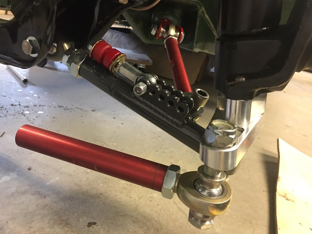

My car hasn’t even hit the road and I am already changing parts! The outer tie rods I bought from TTT a couple of years ago are great, but they have improved the design to include high clearance bolts. This is great as they run VERY close to the rims. I of course had to order the new bolt set...
Old:
New:
