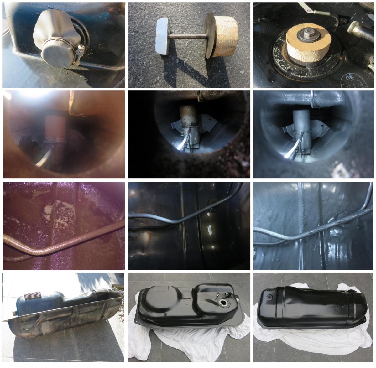

My fuel tank had a threw dings in it too. Like ksechler said, they are hard to find and over here darn near impossible. I ended up leaving what looked like a slight forklift fork impression (looks worse on the photos) because it was close too spotwelds and it didn't leak.
Inside looked grotty when I started rolling it around with a mild muriatic acid mix and a hand full of old m6 nuts. I weighed them before I started so I could check that I got them all out when I finished and none were wedged in their somewhere.
It was my first tank this size, and its not good for your back. I think I was on my kids "most wanted list" for a while after making them help me for a couple of hours.

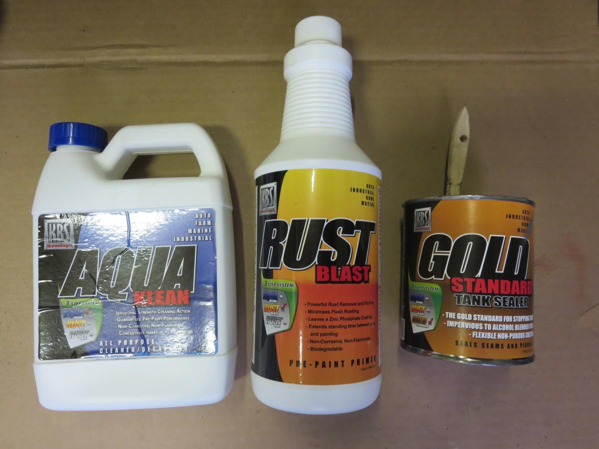

I sealed it with a kit for motorcycle tanks from KBS Coatings. The shop said it was enough for a car tank especially with the acid treatment I already did.
It took about a week to do, with all the treatments and drying between and after.
Here are some photo's of my hobbiest effort.
