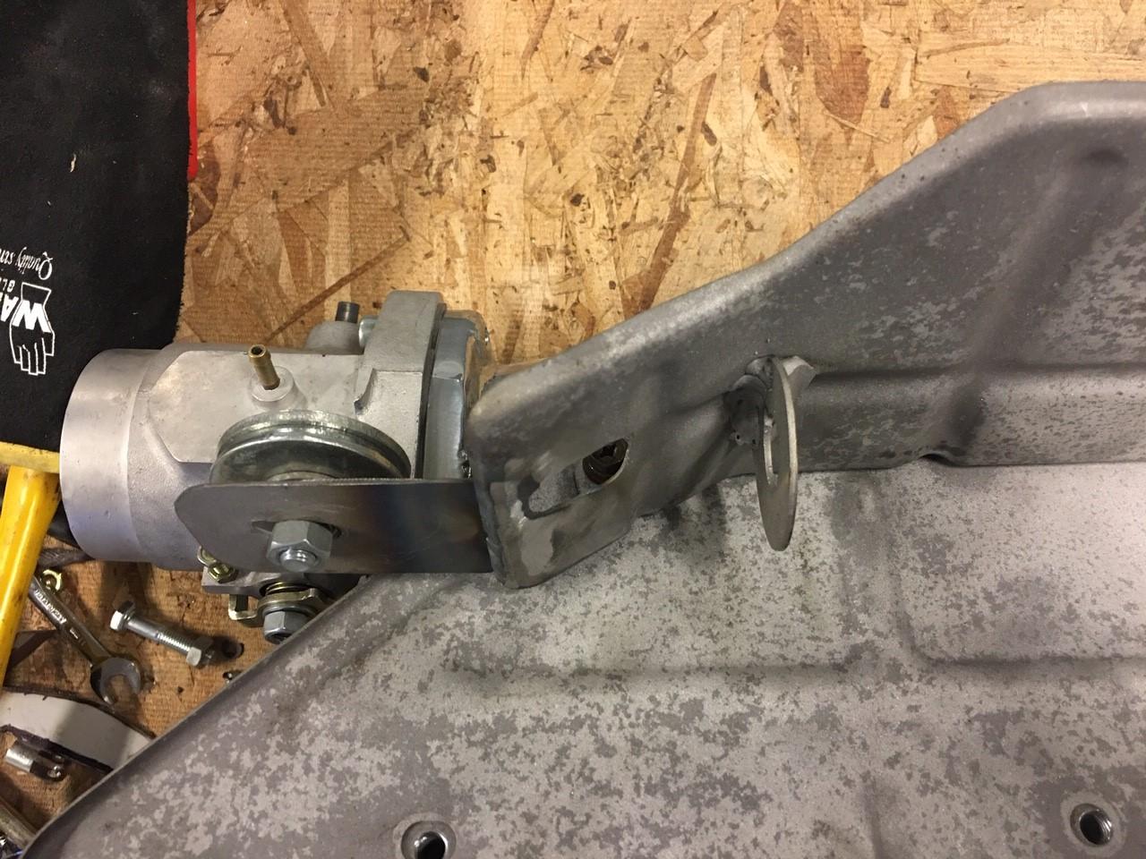

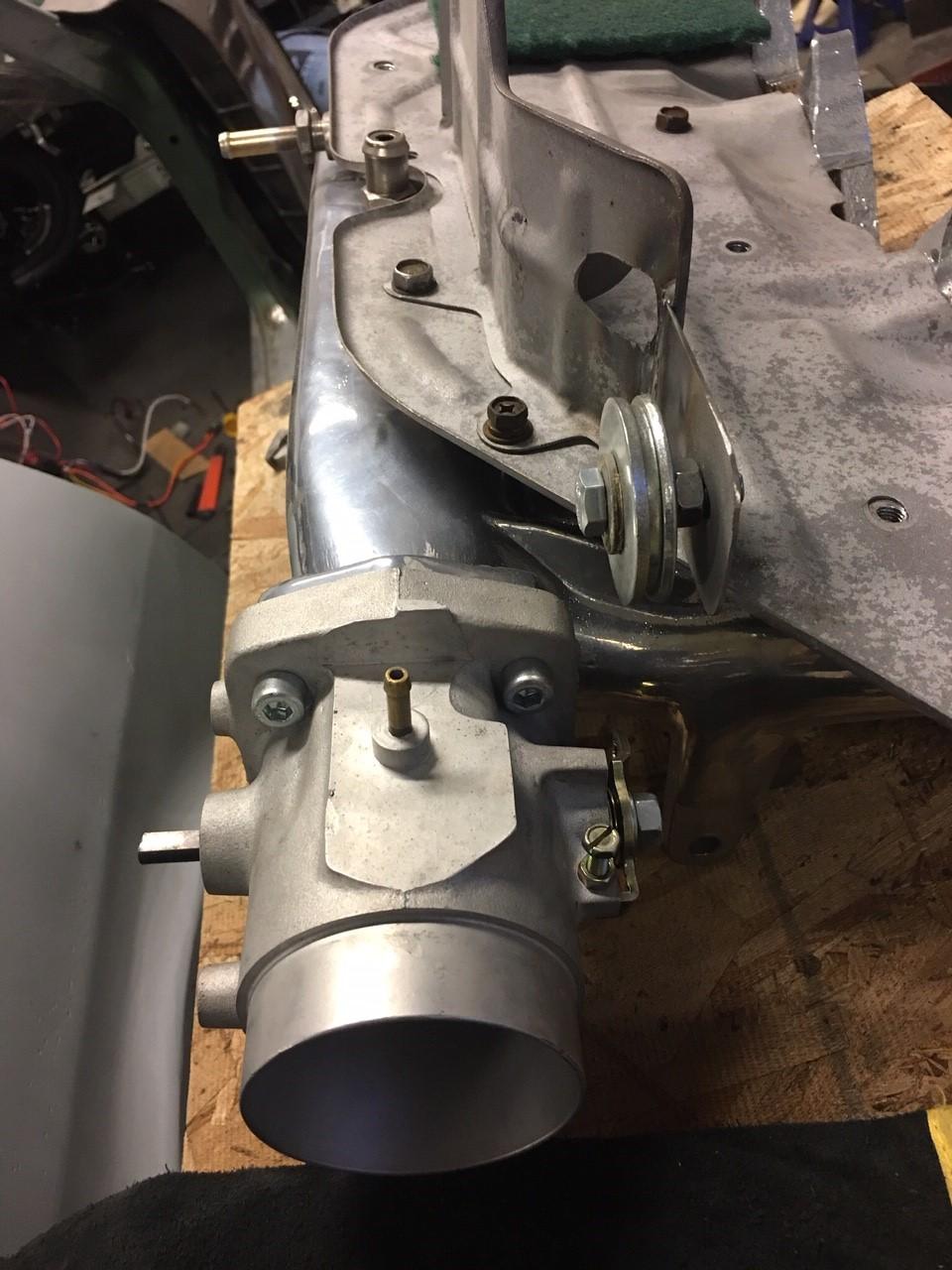

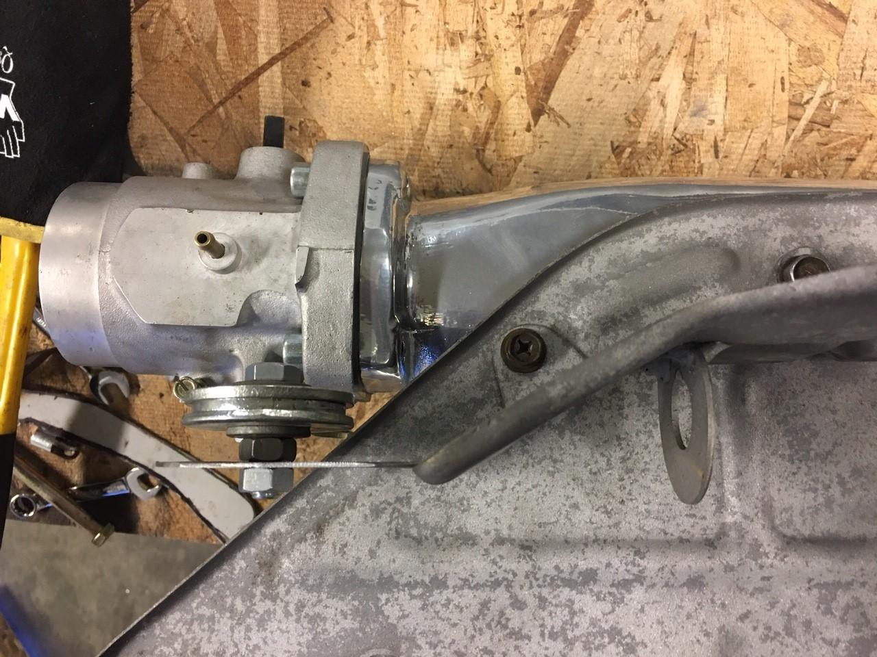

Some more work modifying the lower heat shield to align the throttle cable linkage. I think I should have enough distance for the SS cable to be safe from any heat related damage.
This pic shows the hole I opened in the heat shield for the cable to pass through to the "wheel guide" I made. The heat shields will be powder coated when complete.
This pic shows the side view and the washer I welded into place to retain the cable and locking collar for tension on the cable. You can also see the slotted hole which will serve as the tensioner on the wheel guide.
From here, you can see the path of the cable will align to under the throttle body to allow the cable to "pull" the butterfly open in a smooth arc.

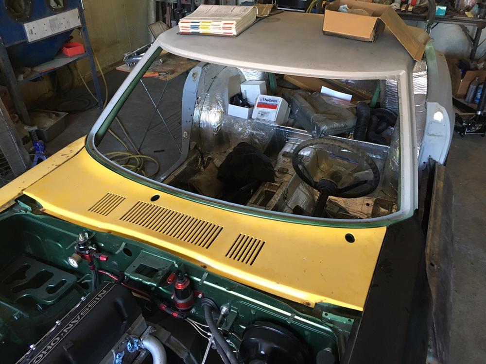

2 hours ago, wheee! said:
Thanks to @Convertt, I also have a very nice cowl piece. It was originally a lime yellow part which is kinda cool.
Do you ever sleep?
J/k - your project is coming along fantastically!  Great to finally see it in person.  Great work!
